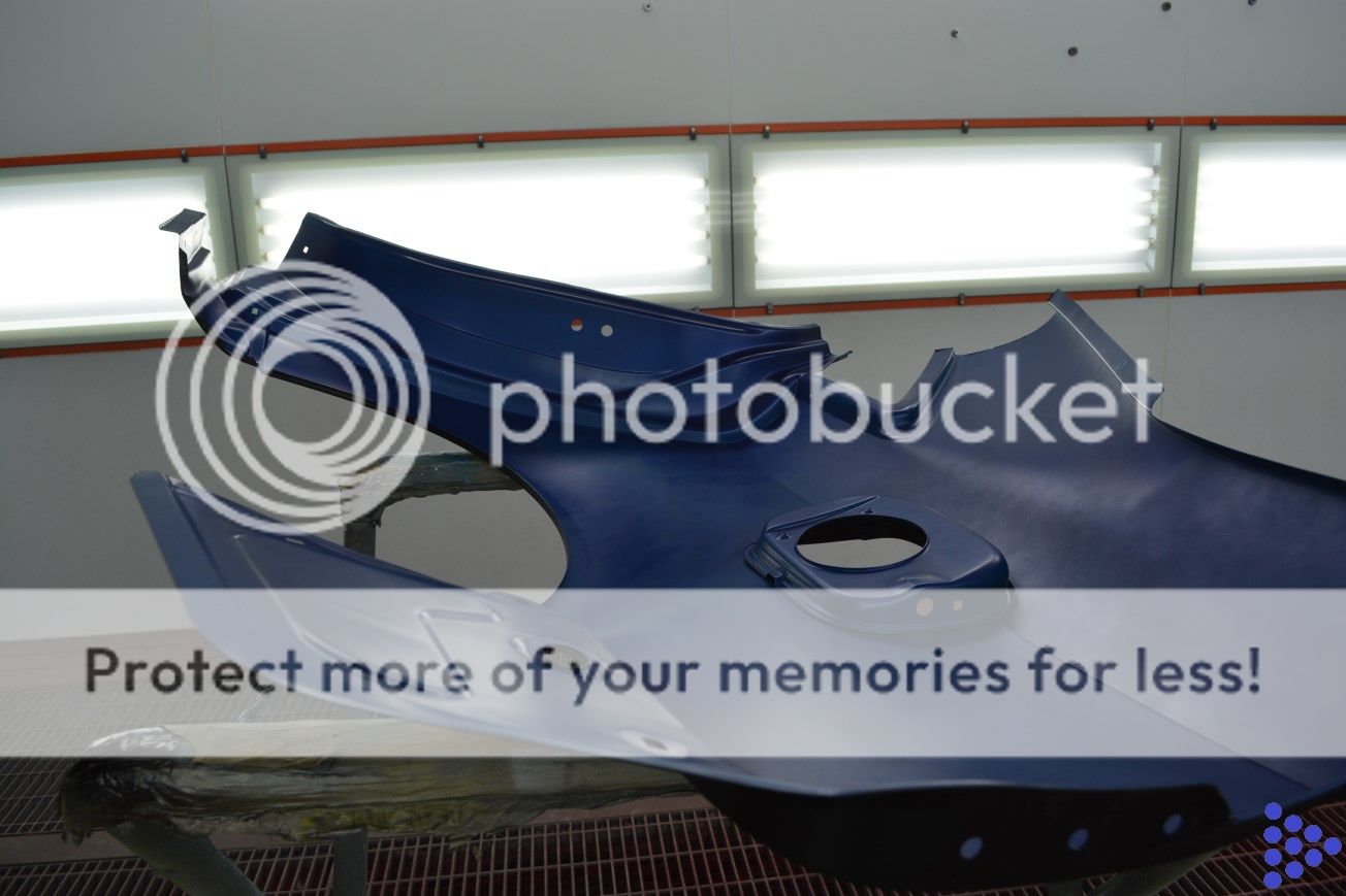

            RS4 fender cut and ready to be test-fitted
            Looking good even on first attempt
            Inner side primed

            The painter left me outside his booth
            To put a coat of colour
            And then played with this
