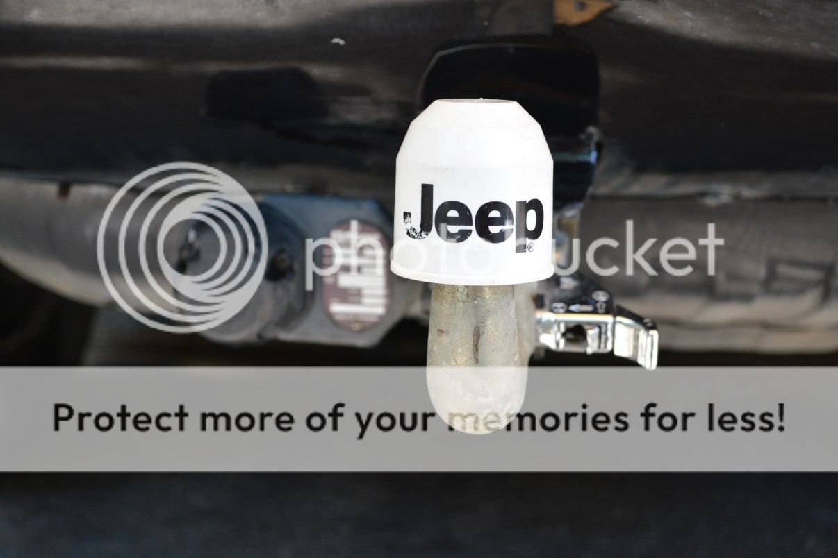

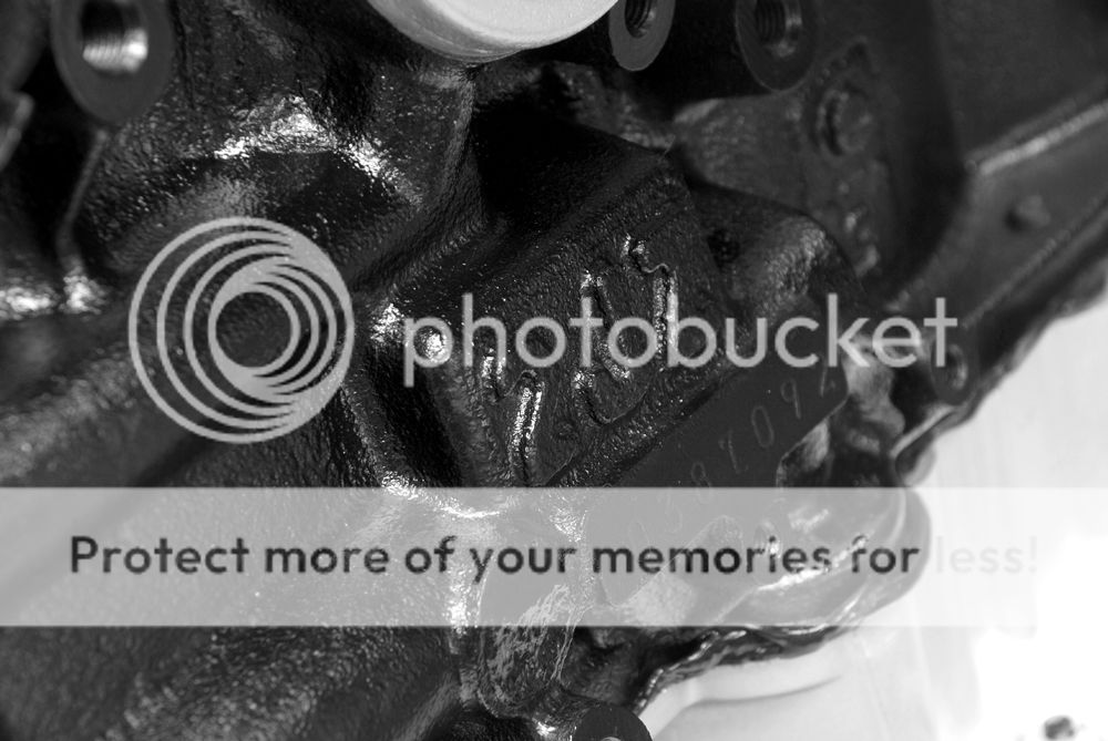

    First of all I managed to source a nice tool for my needs . . . 4700cc can come in handy some times
    And with the help of Mopar . . .
    This happened

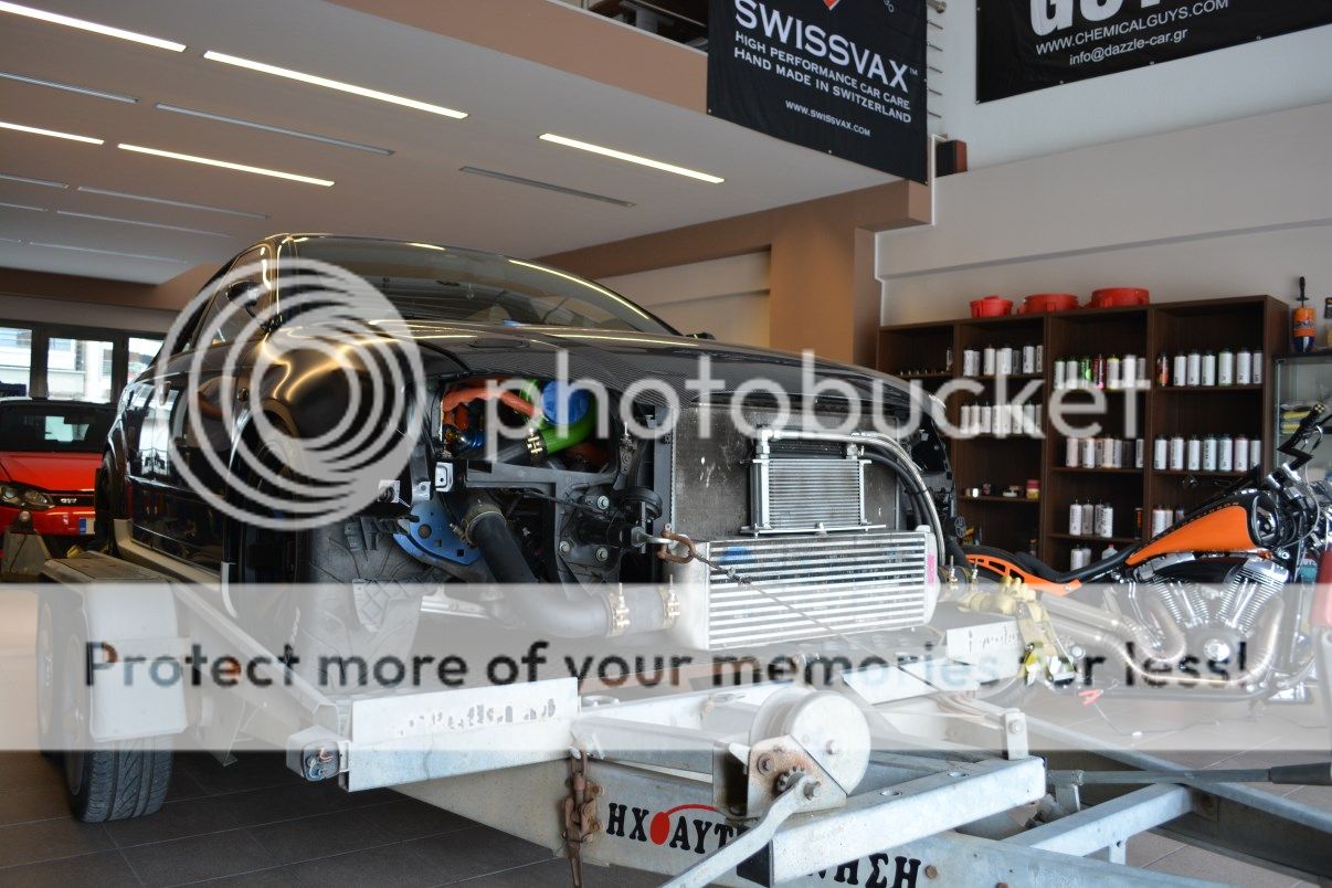

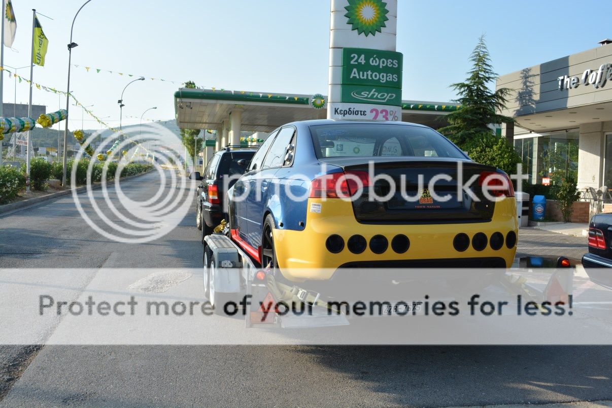

    Travelled about 500km (310miles) away from its base
    Such a love for petrol this engine . . .

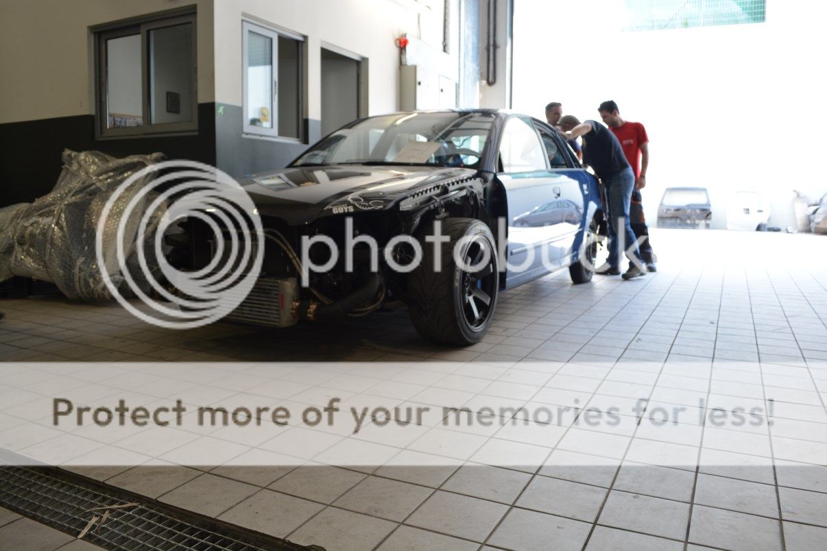

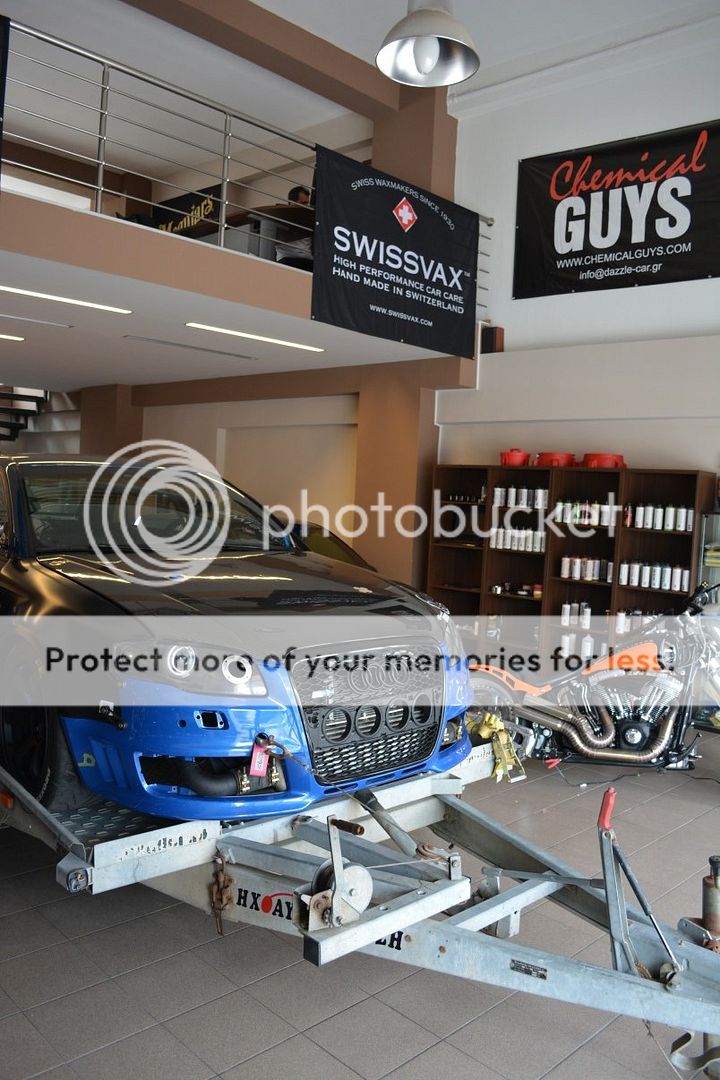

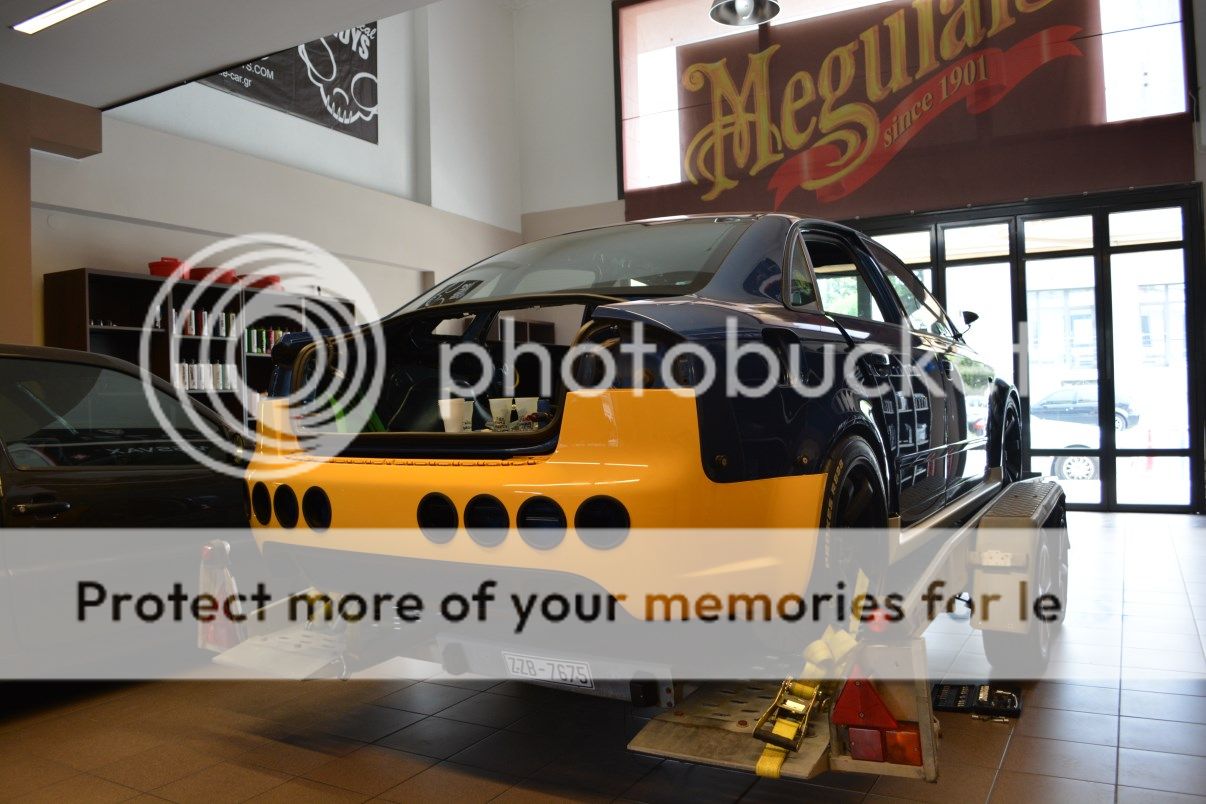

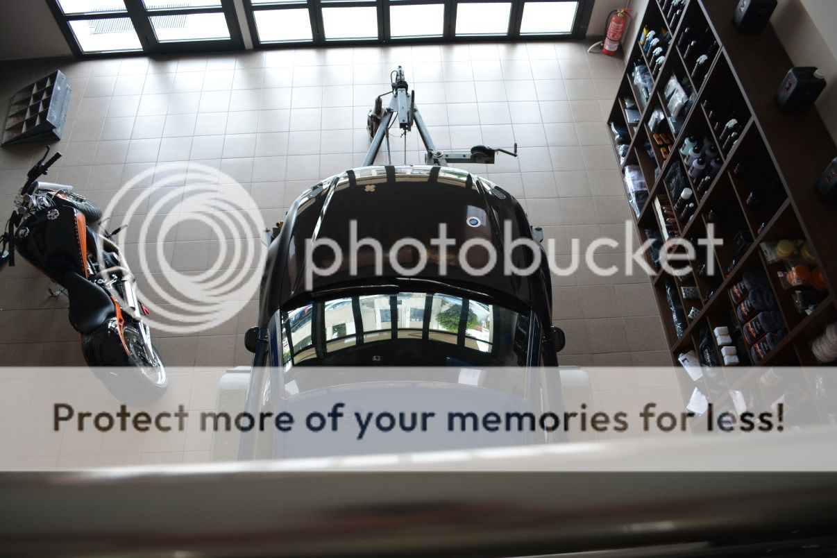

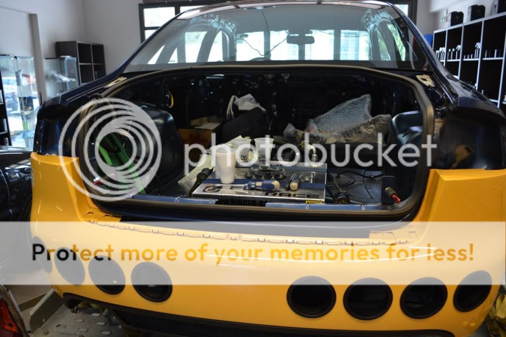

    Finally arrived at Dazzle Detailing center, where I would remove everything from the car, for it to go to the bodyshop
    Bongo was more than happy to welcome us

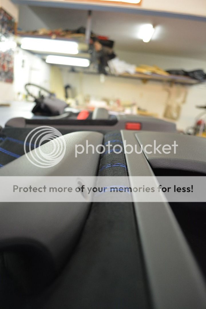

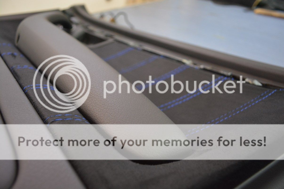

    Meanwhile, back in my hometown, the trim shop was doing work . . . Here are some pics I took while I was at it
    Cant wait to see the finished product
    It is coming awesome so far me thinks

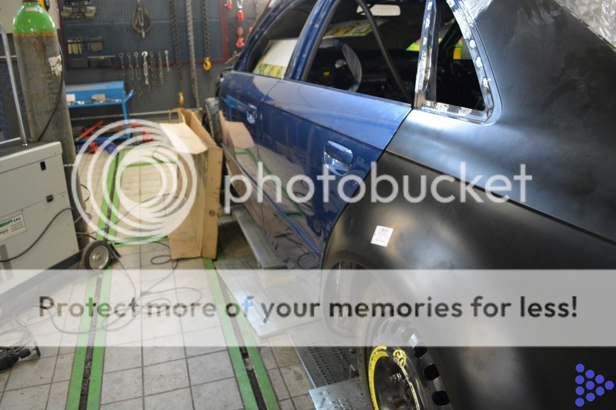

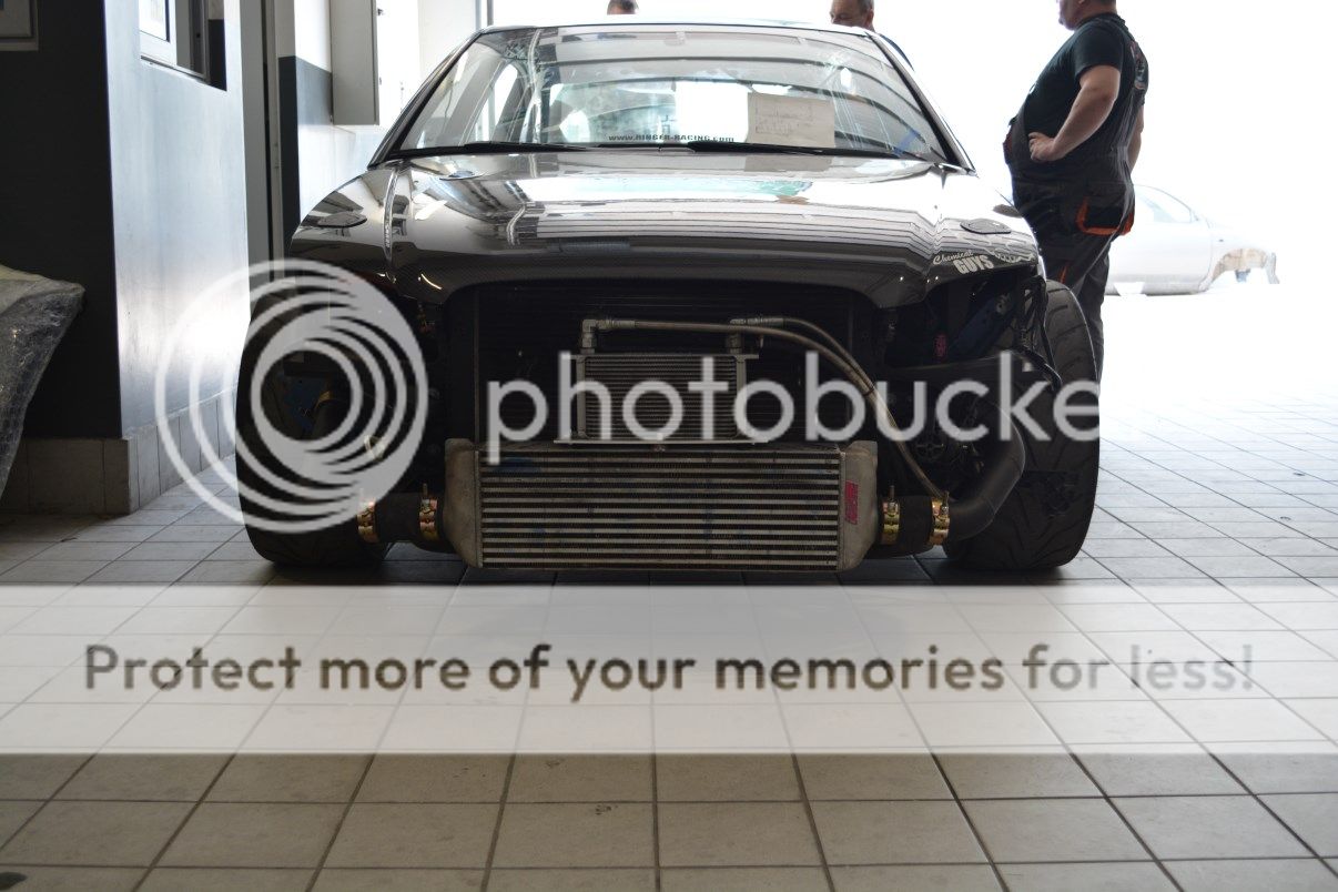

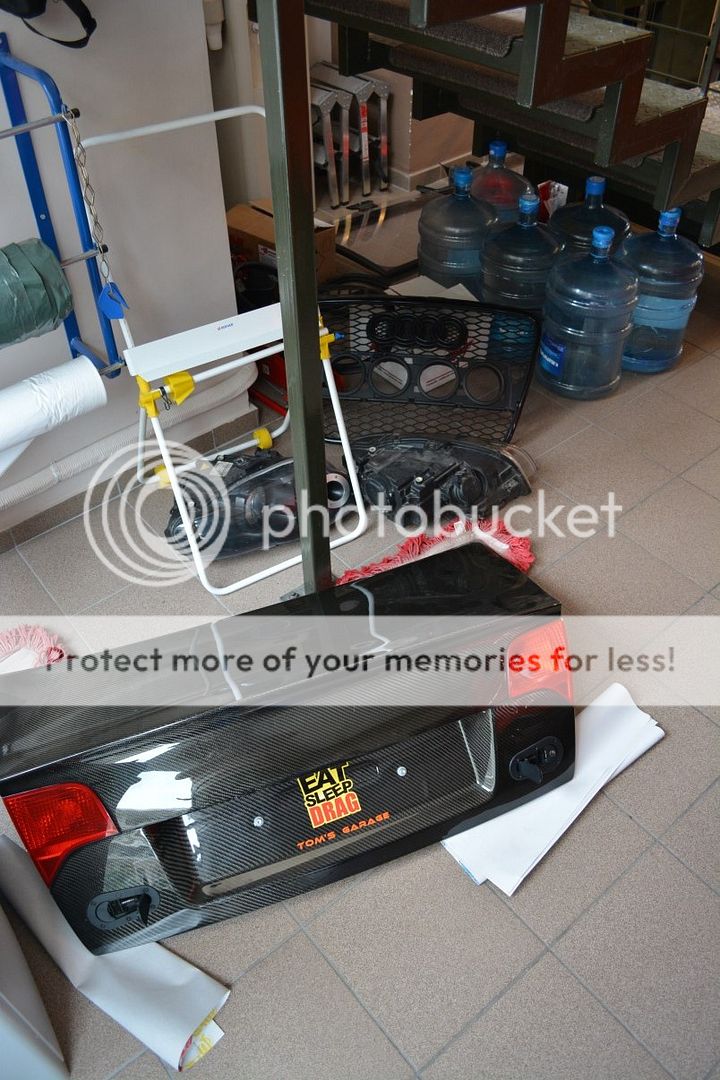

    Back to Dazzle, where I lost no time

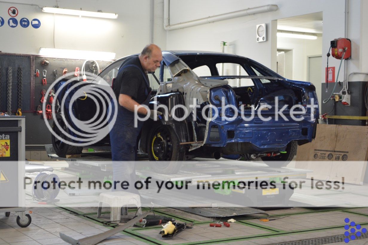

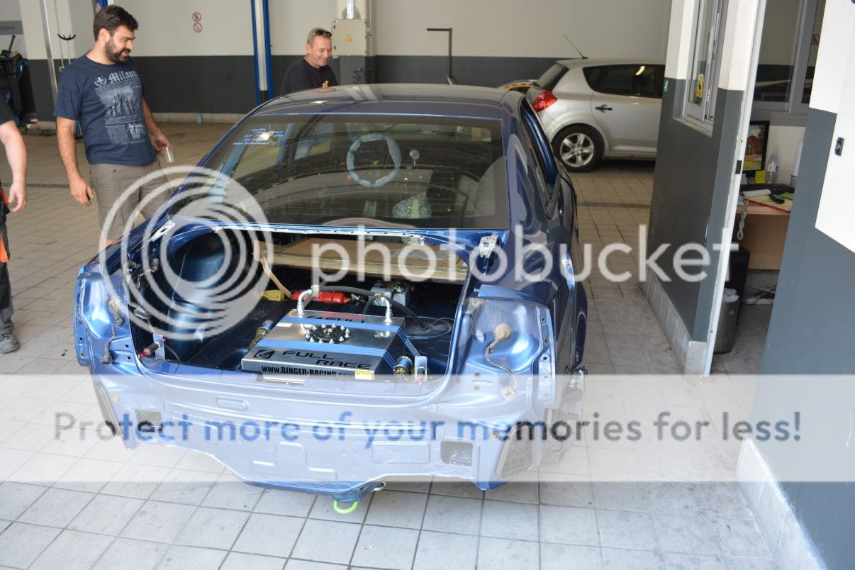

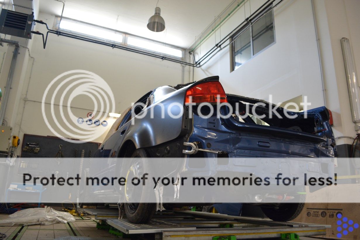

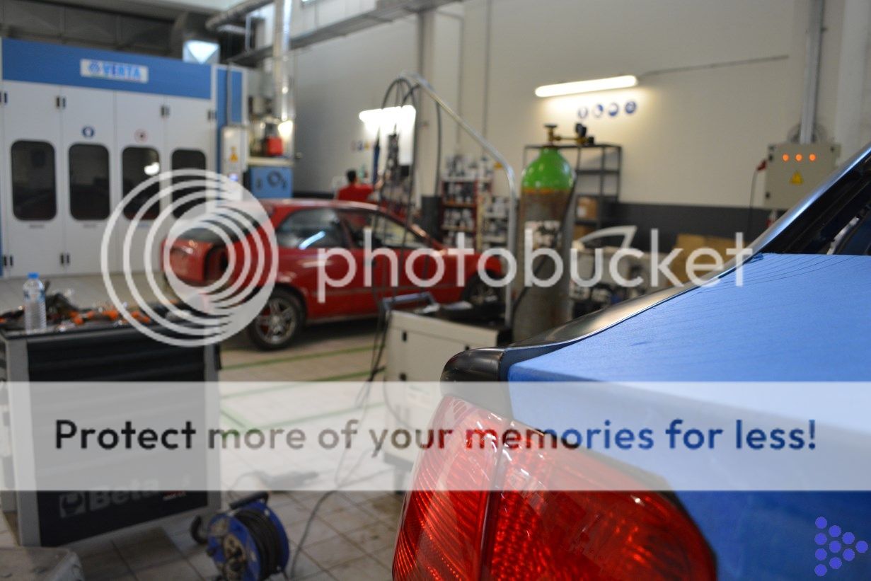

    Car arriving at the bodyshop where I removed the last of the parts to be painted

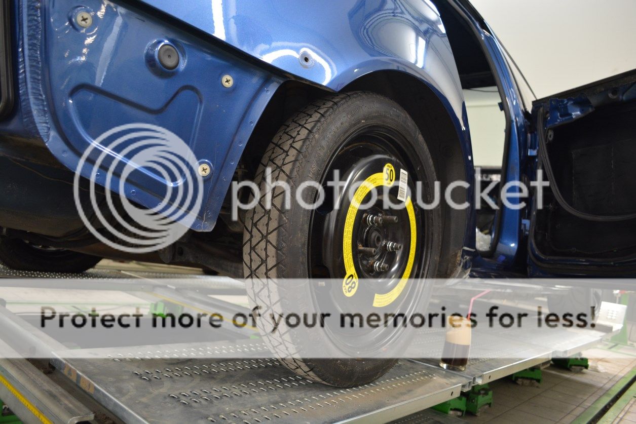

    I also installed emergency spares at the back for easier work
    LoL

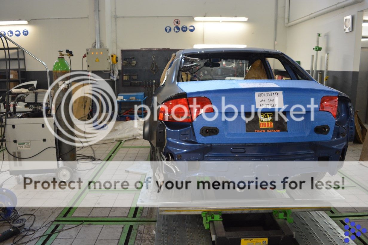

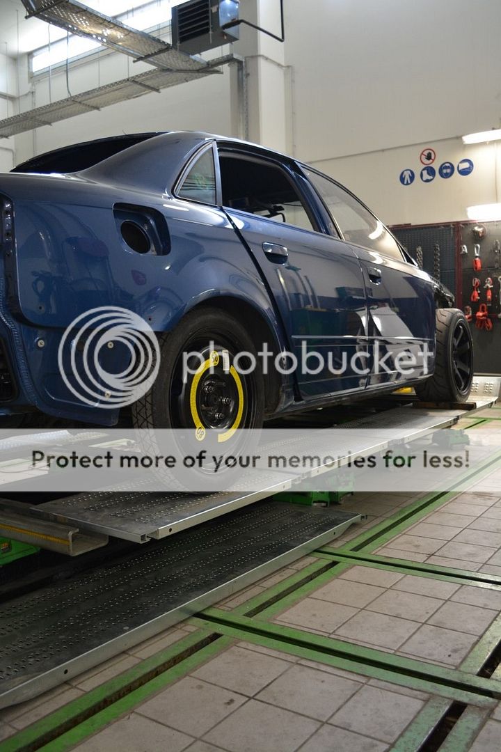

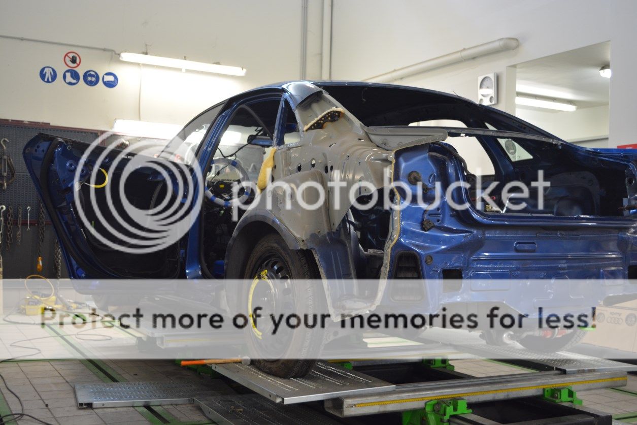

          Car climbed on the ramp
          LoL so funny looking, I love it

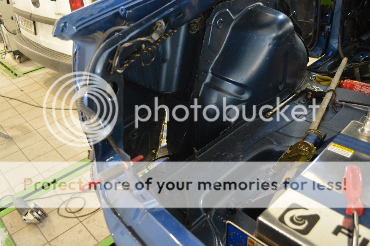

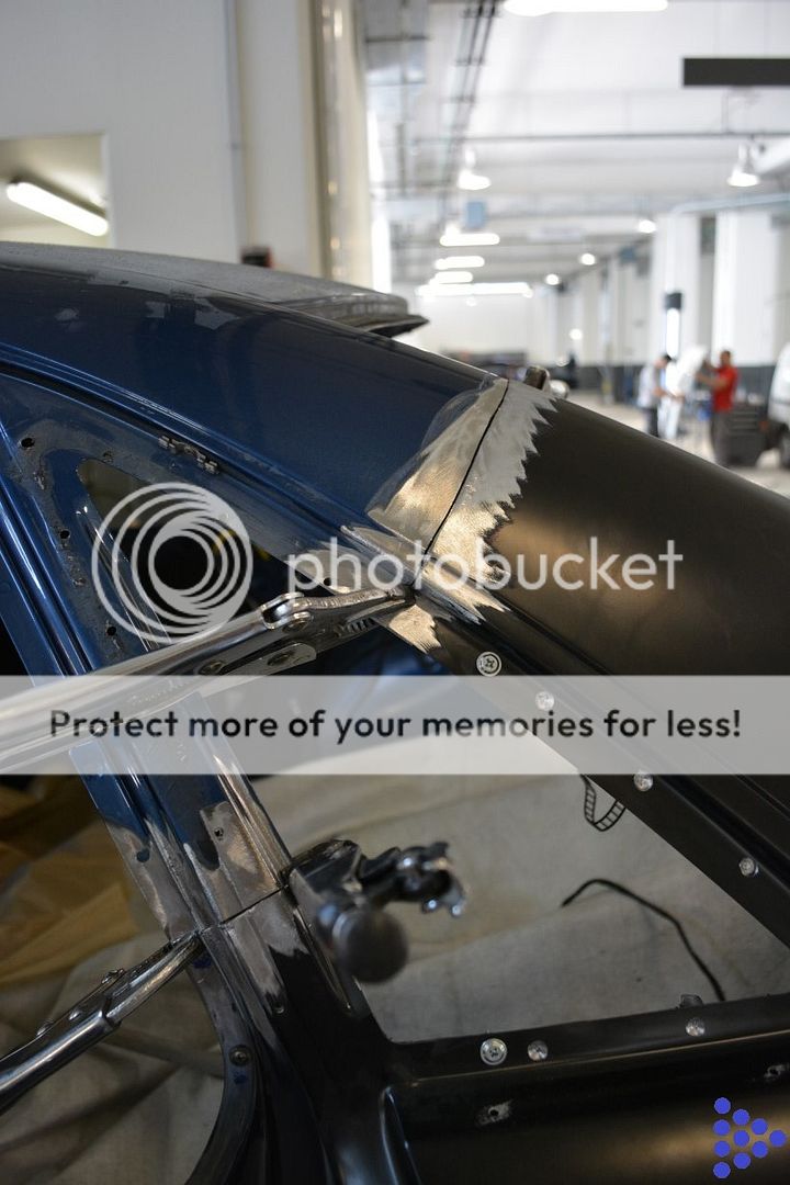

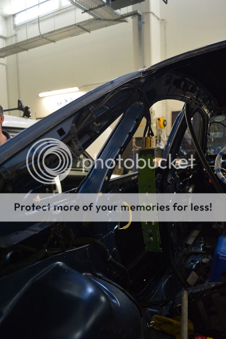

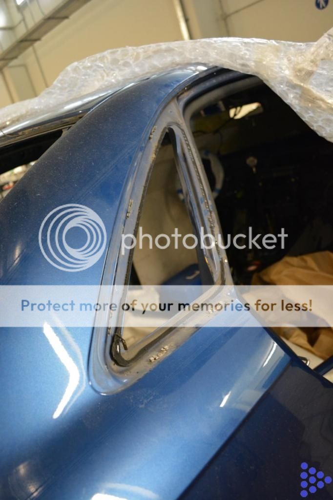

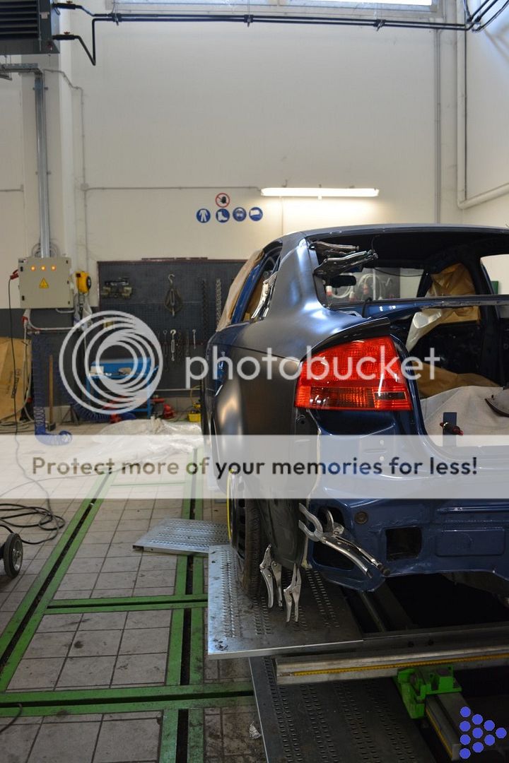

          Rear windshield off, and antenna too

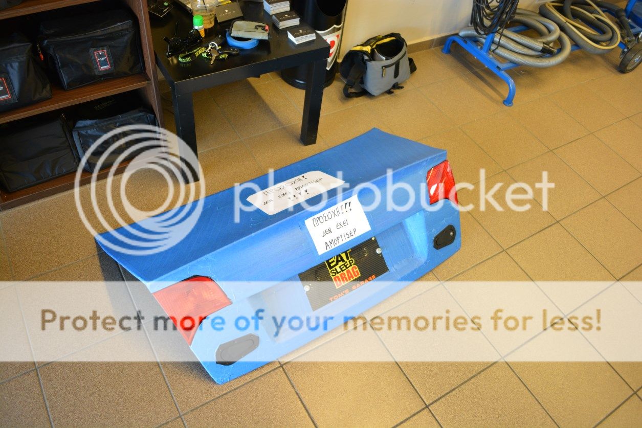

          So much heavier than the Lexan one
          Time to drill some holes

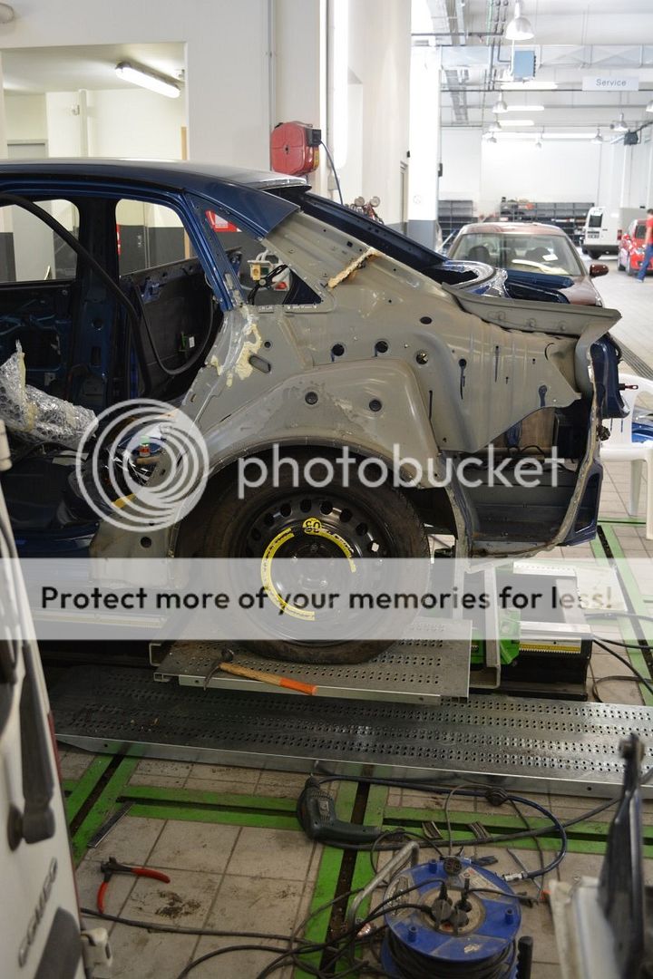

          I spy fender separation
          Random photo

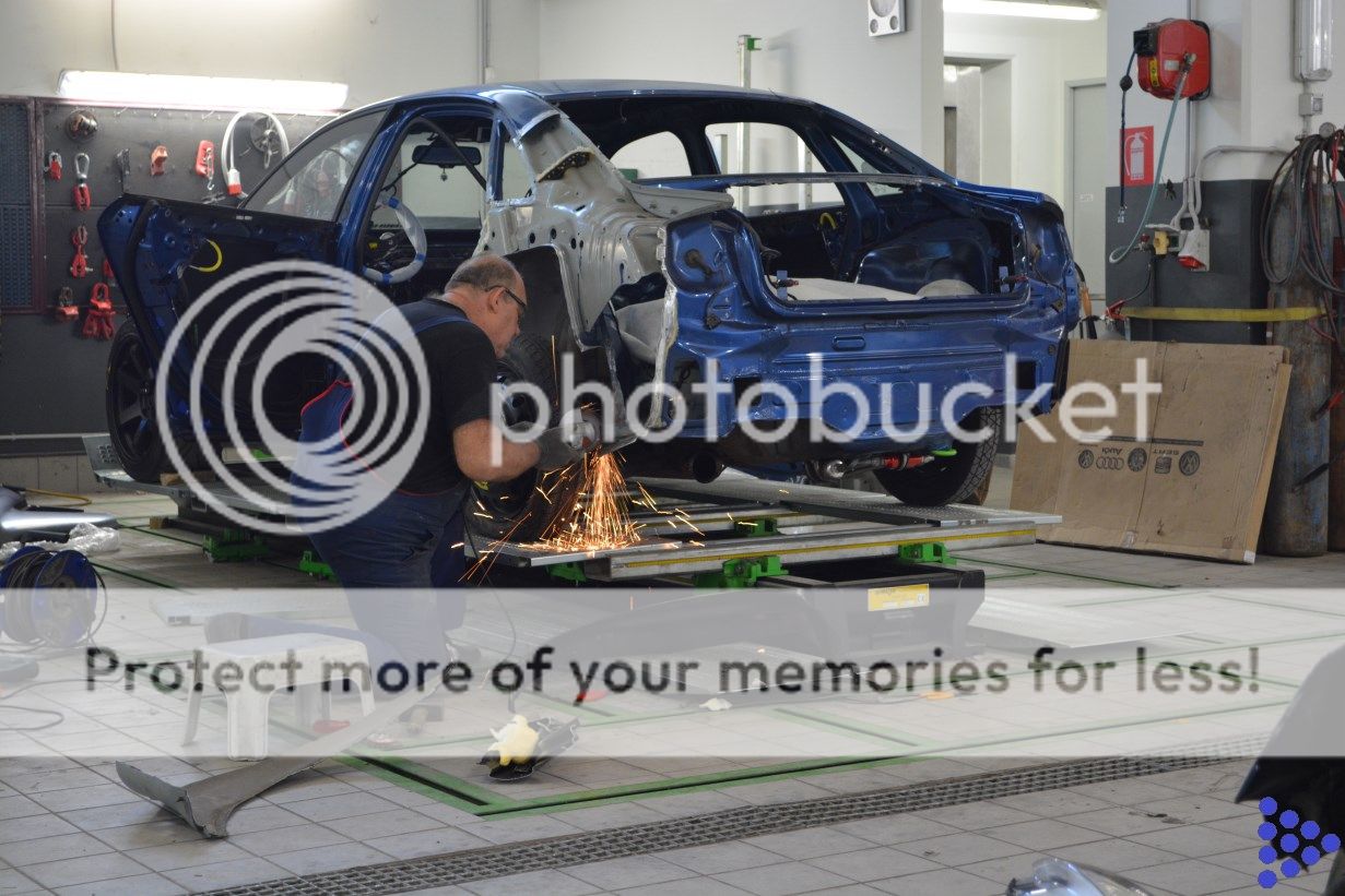

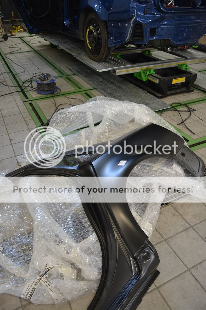

          RS4 Fender arrived in place of the crime

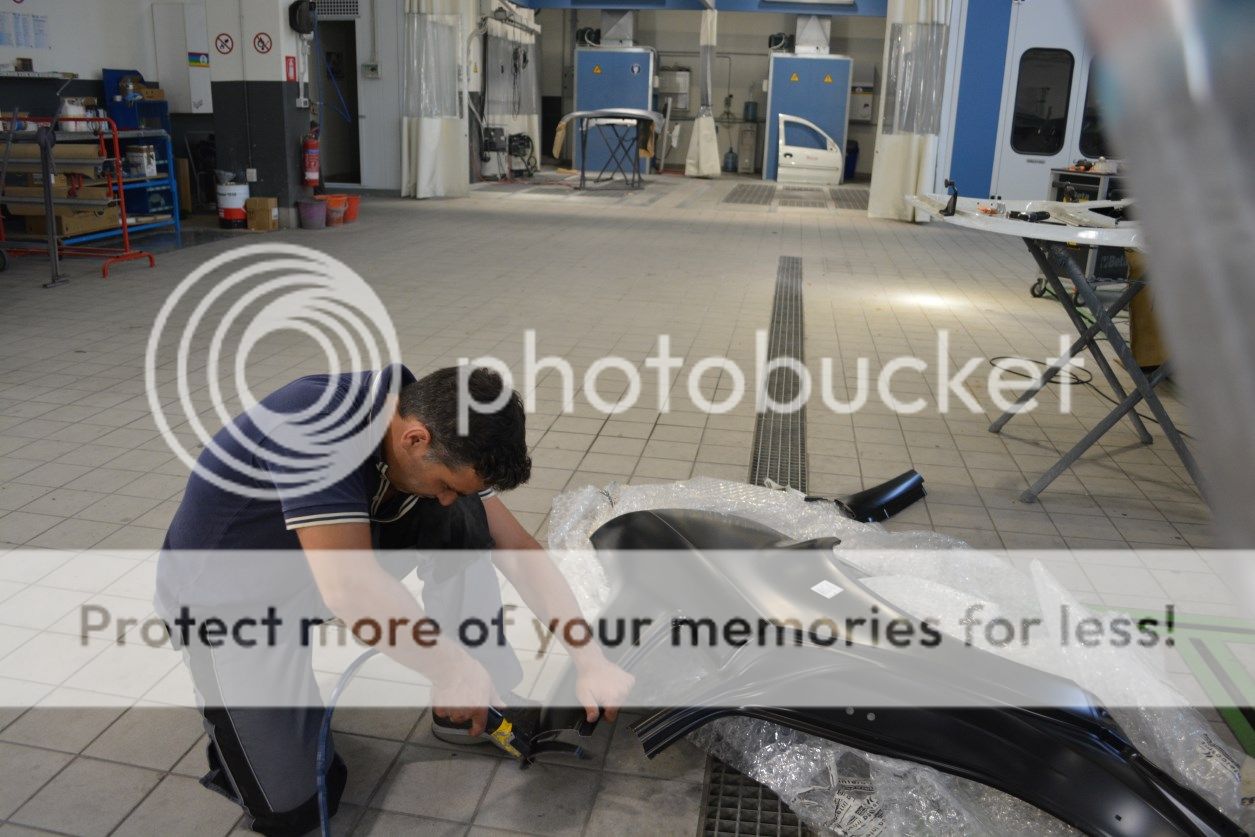

          Cutting time
          Fun time

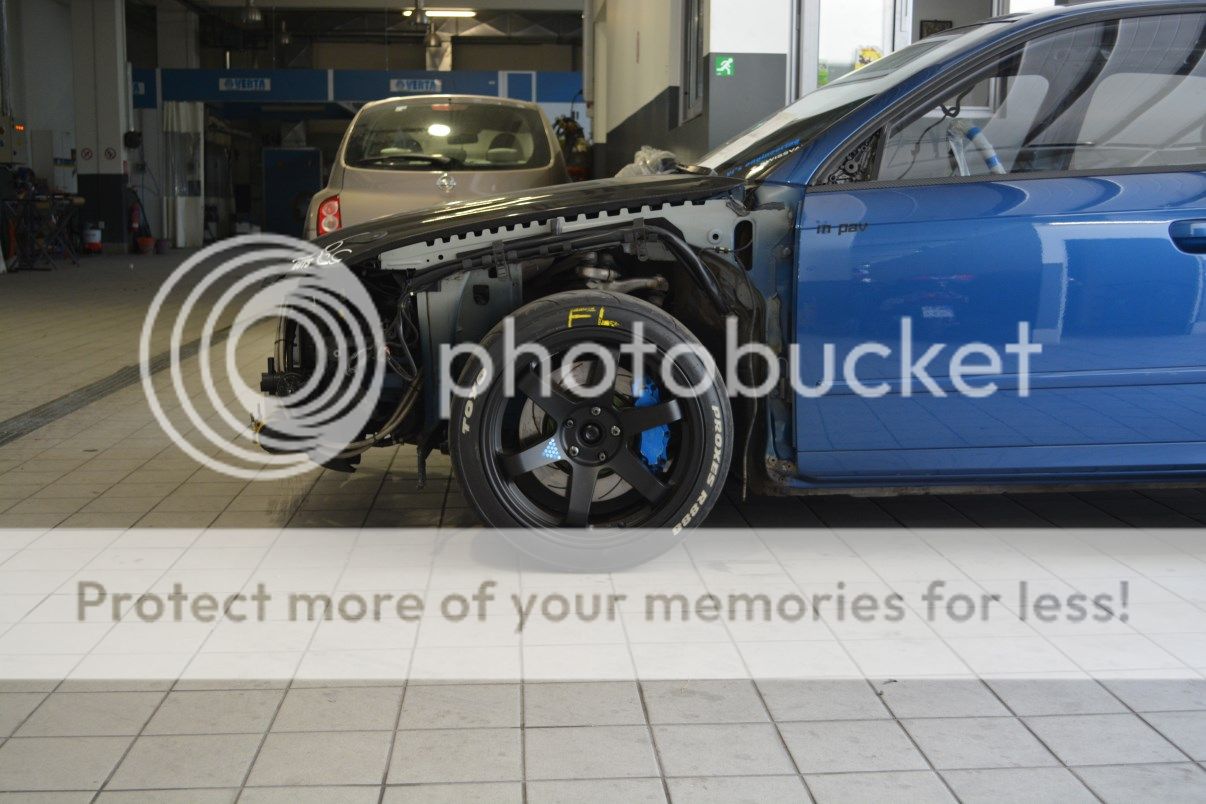

          Bye bye fender
          RS4 fender being cut
          Inner arch test fitment
          First RS4 fender fitment for fun

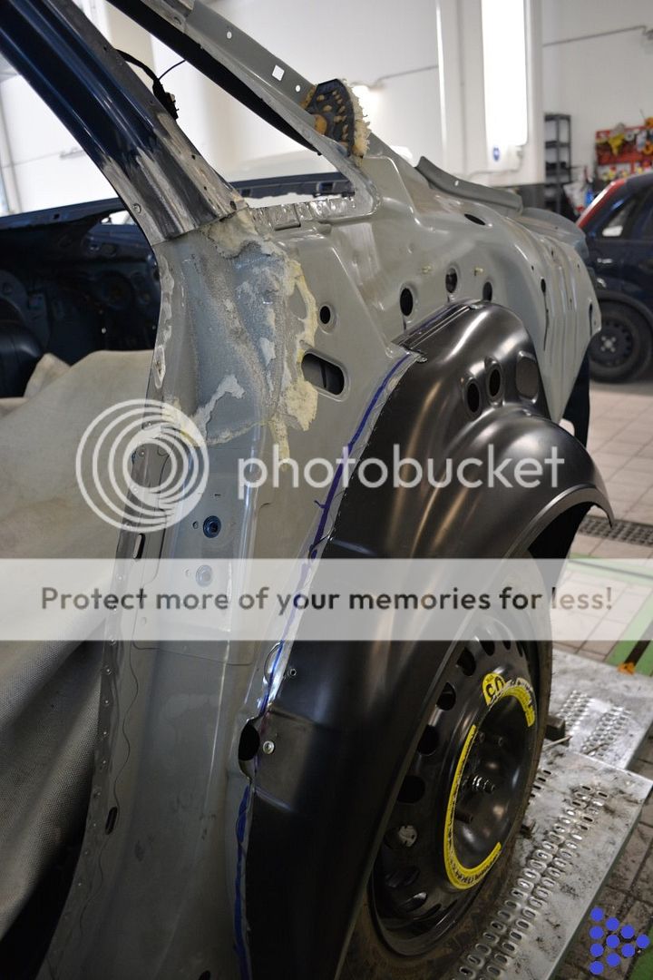

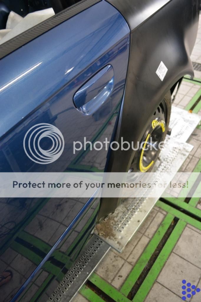

                    • So, I have a lot of pics with progress to show you all.

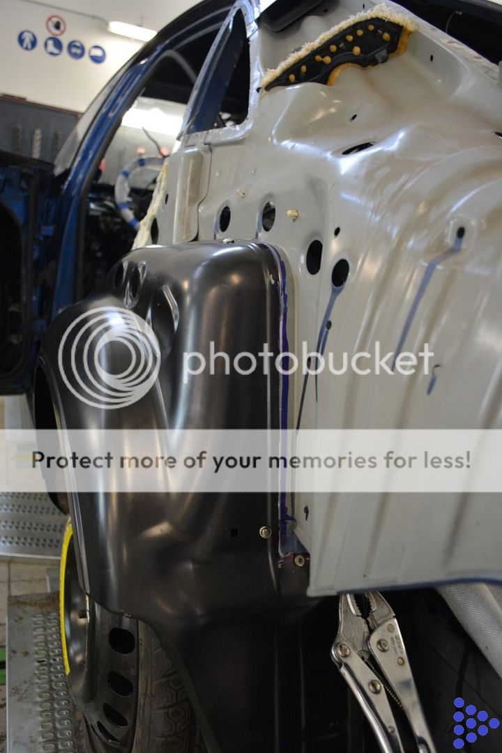

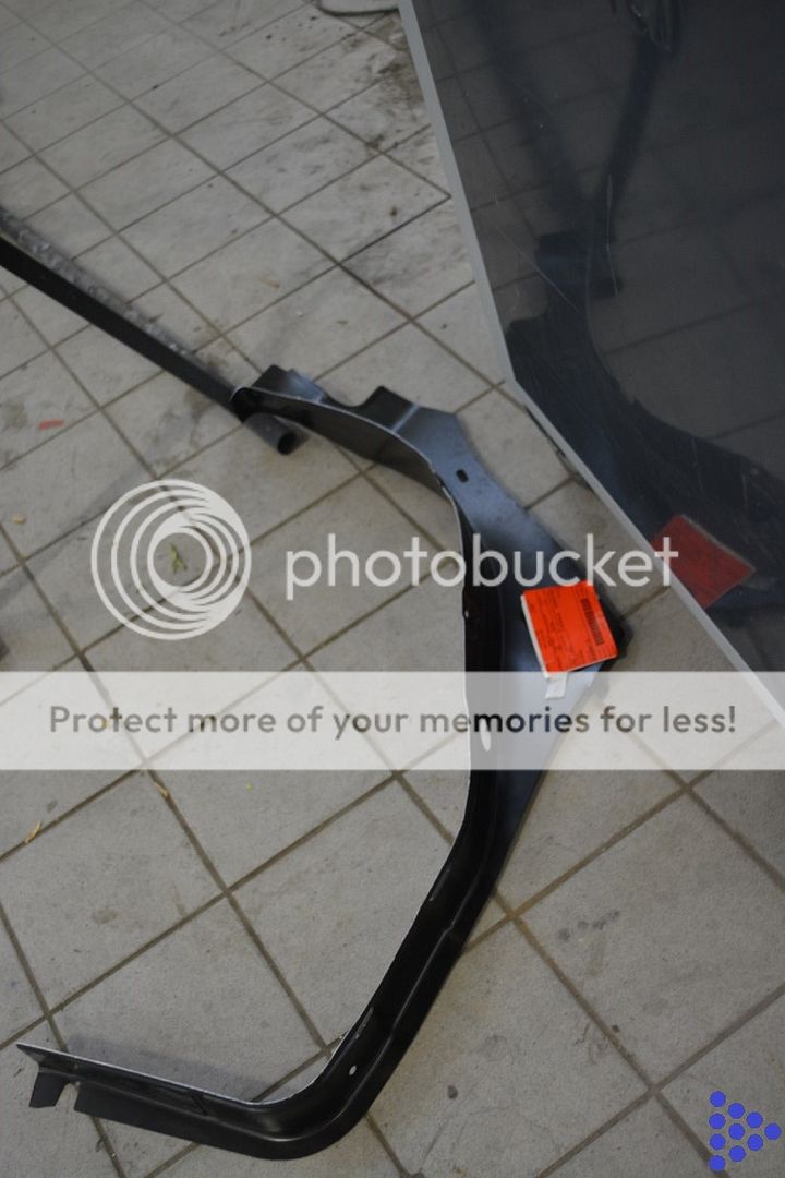

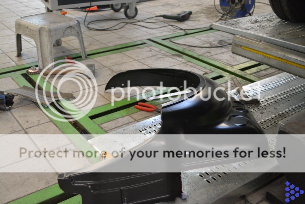

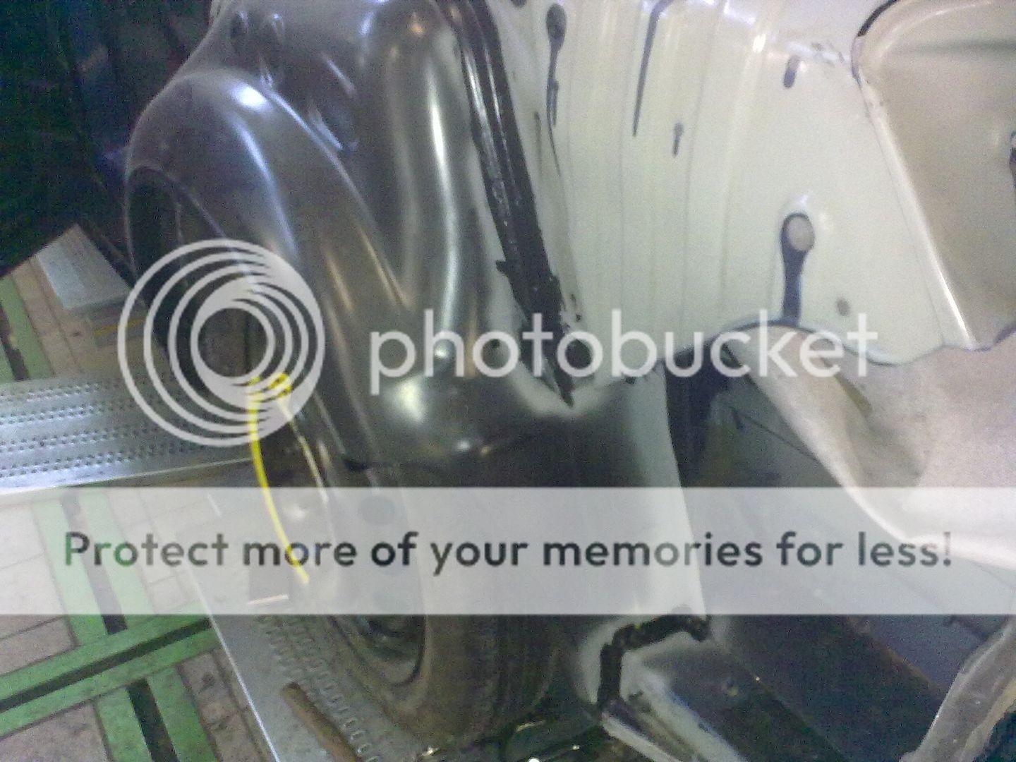

                      Inner arch
                      cut
                      new one
                      Cut
                      test-fitted
                      And then installed, with all the proper things done first

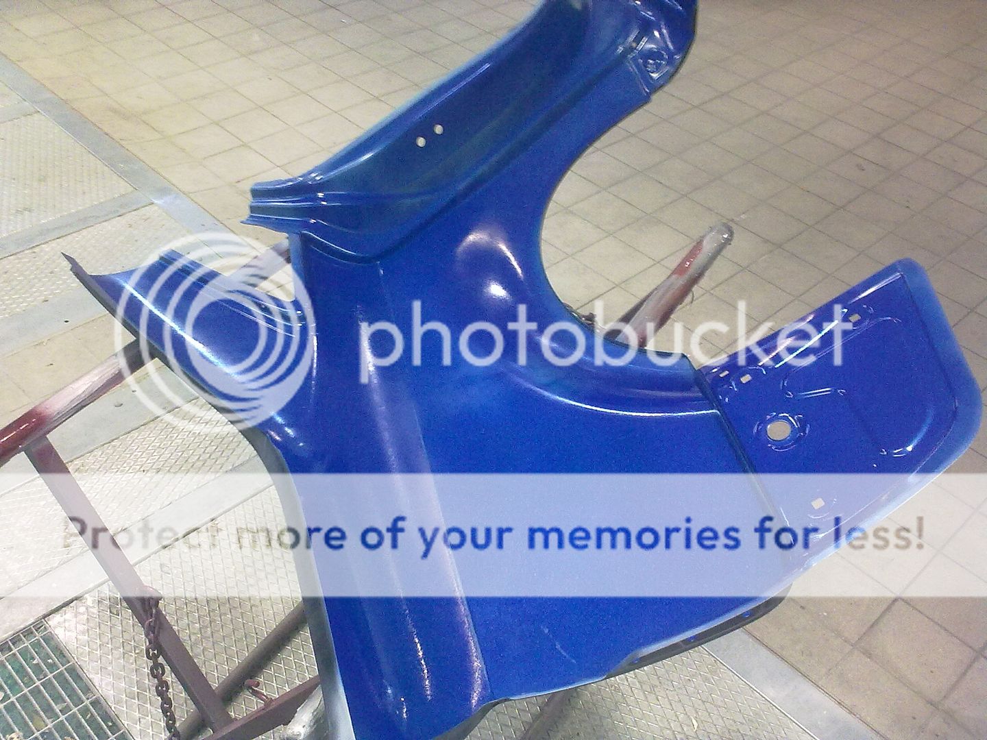

                      Primed
                      As well as the inner side of the fender
                      And then painted

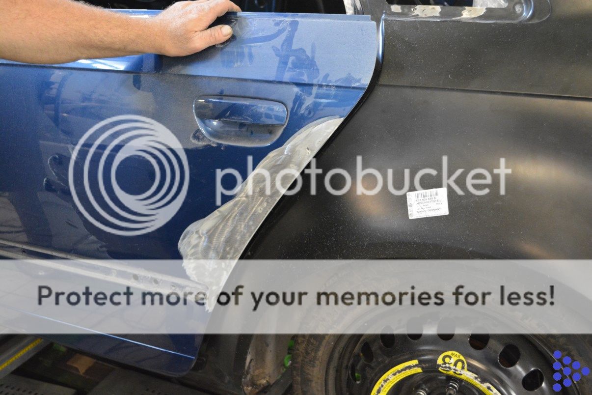

                      Checking fitment
                      Before
                      And after
                      Door difference

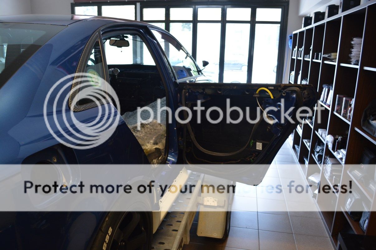

                      Another thing I did is this . . .
                      And voila, no door trim
                      Rear ones

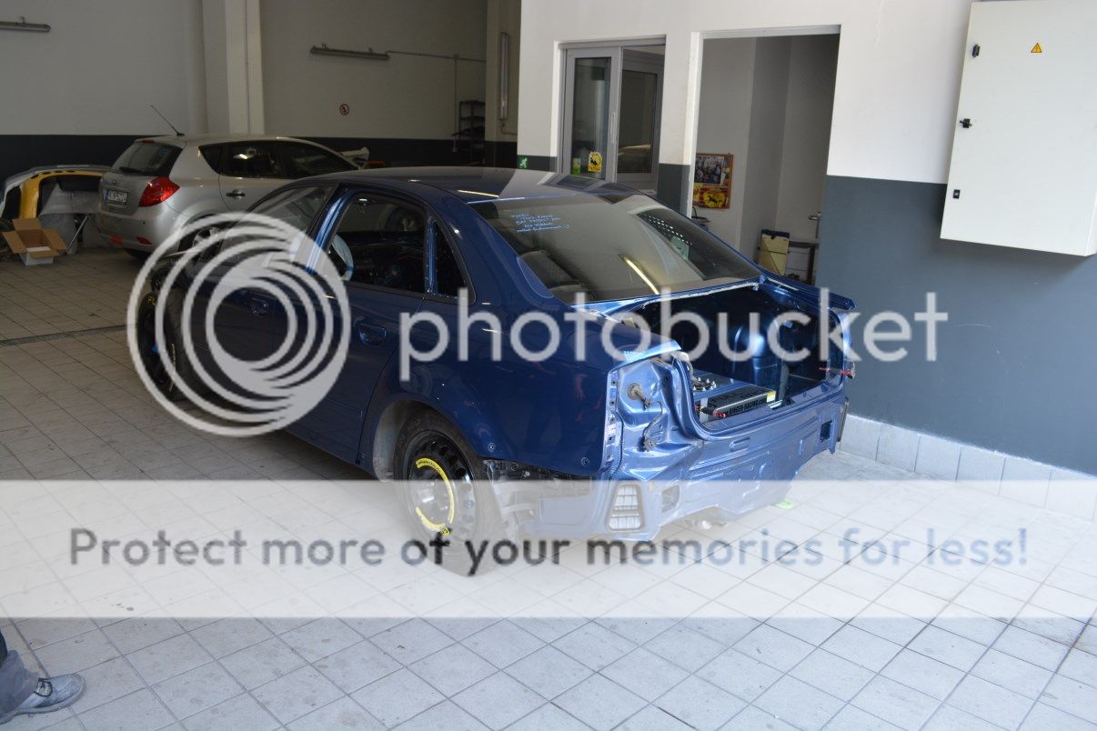

                      And then, you guessed correctly, all of them removed
                      Then we installed more things to check for correct alignment

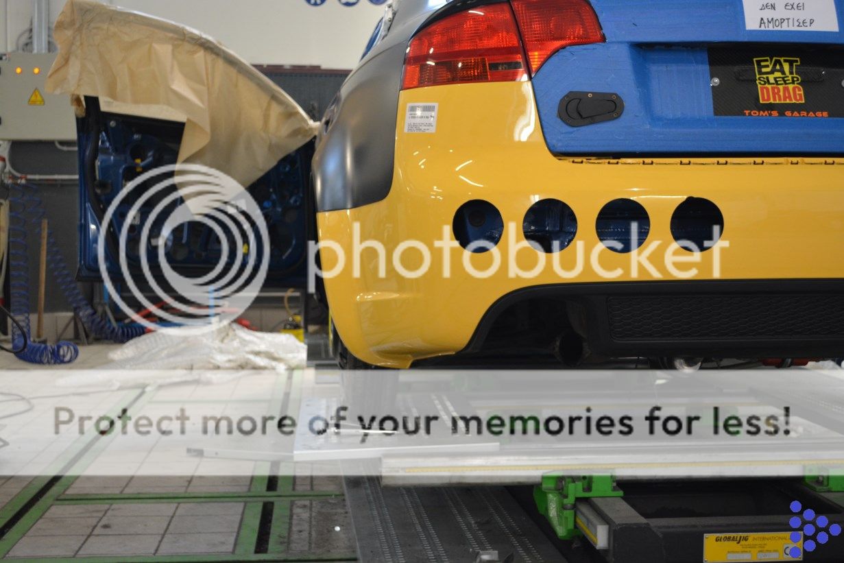

                      RS4 fender meeting the RS4 bumper
                      RS4 Seibon trunk meeting RS4 fender (almost. . . lol)

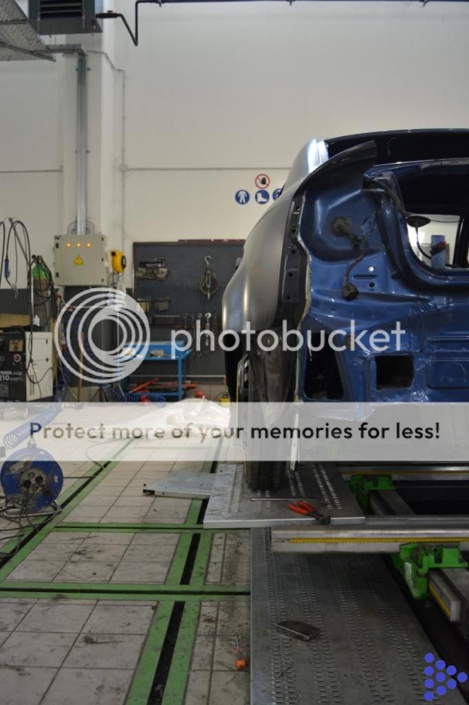

                      Time for some holes for the Vi's engineering quick bumper releases
                      Time to weld
                      More to come

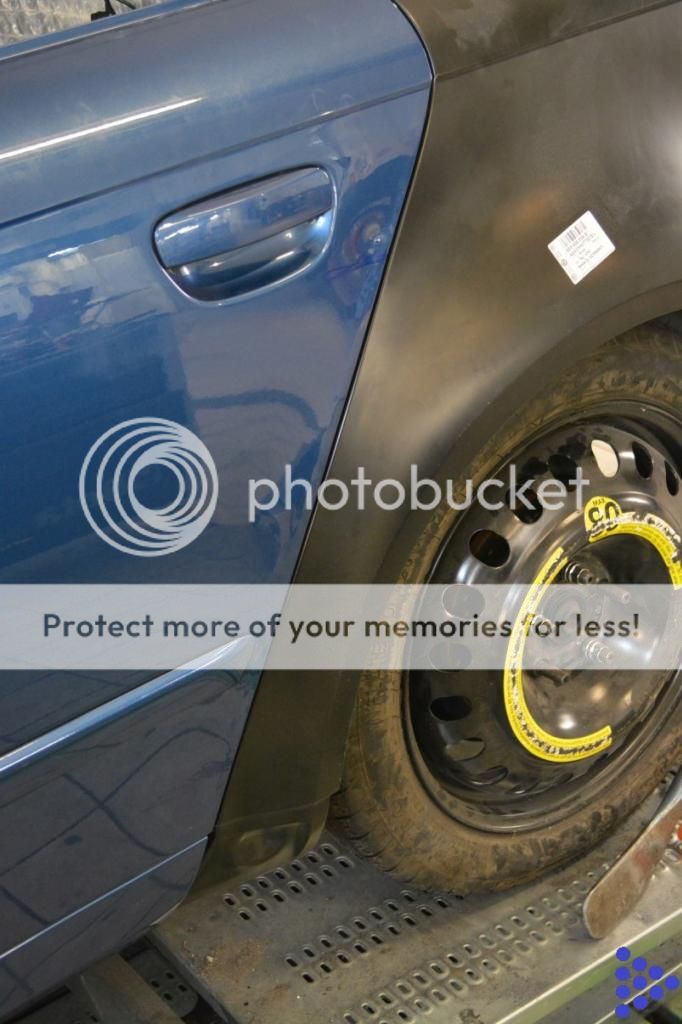

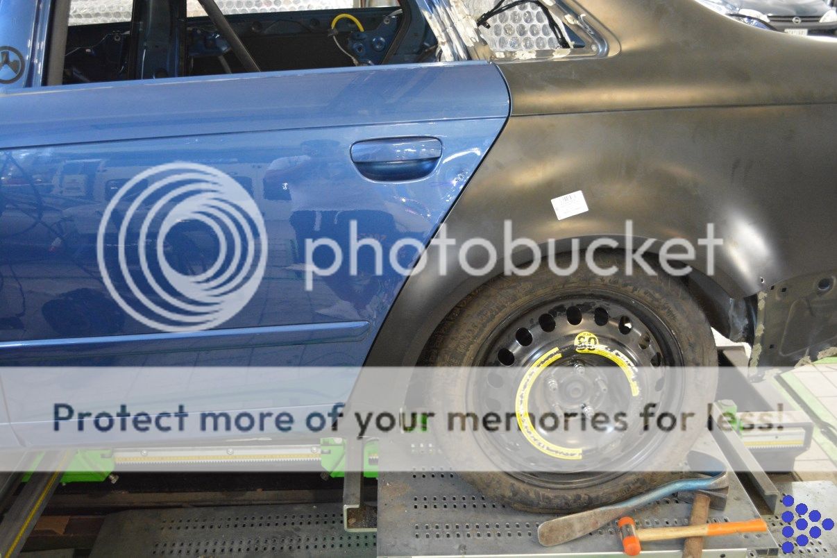

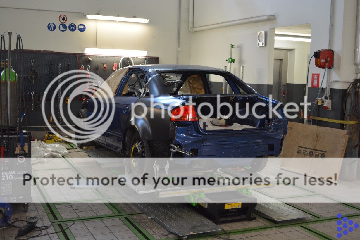

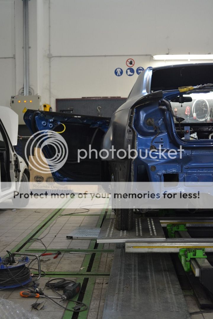

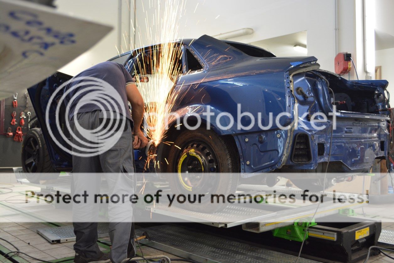

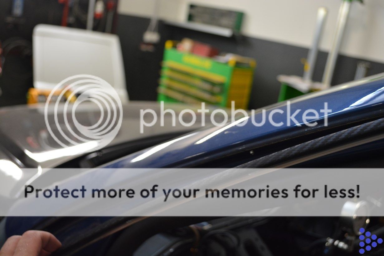

                              • More work was done today, and I am very very happy to share it with you

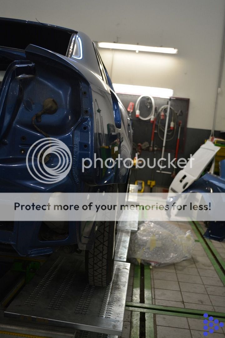

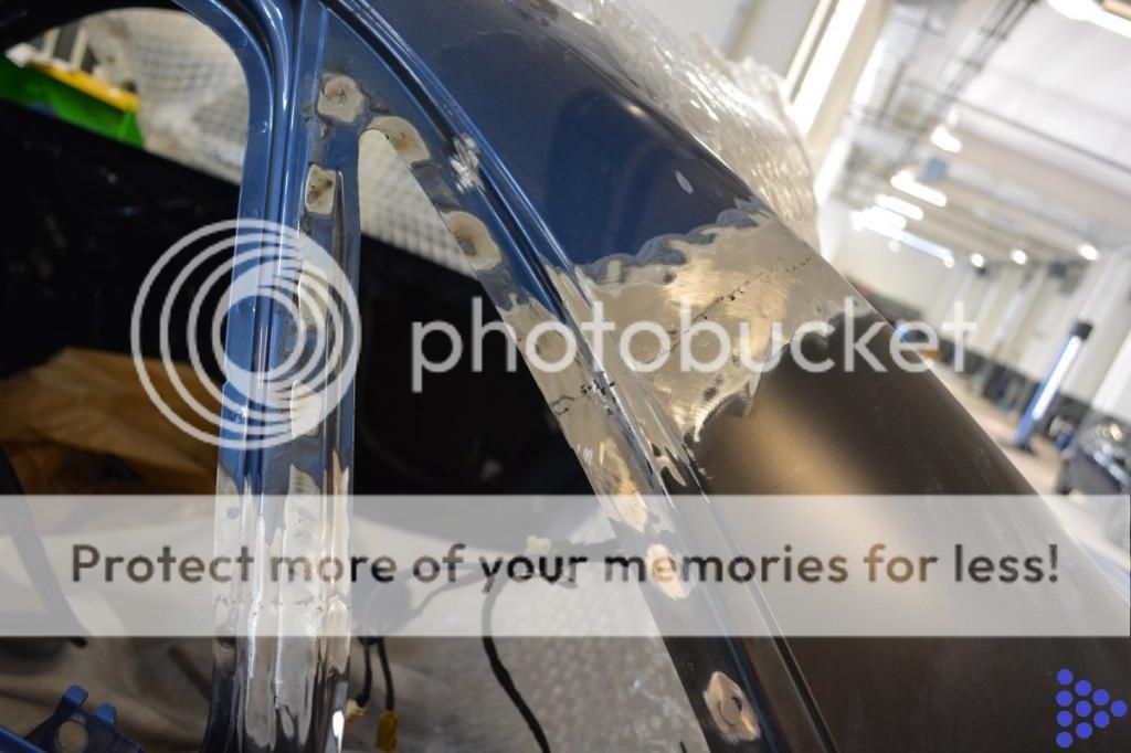

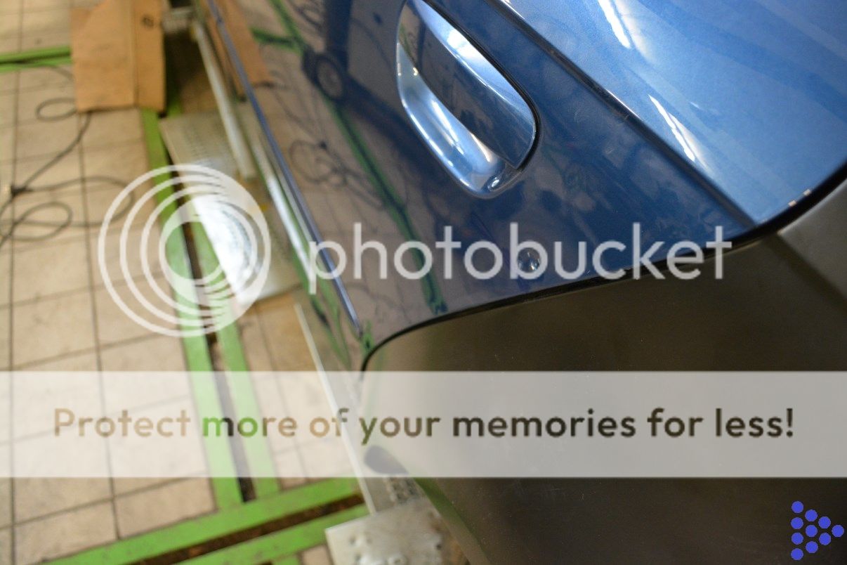

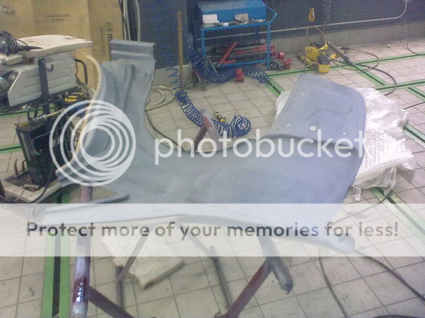

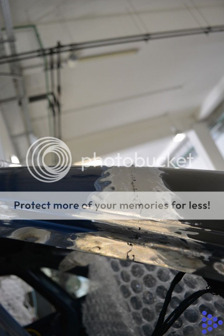

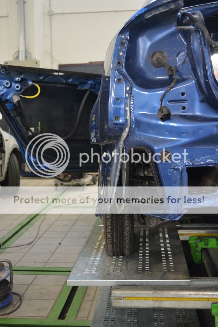

                                First things first, welding on the fender was finished
                                Door floor
                                Final sanding, and then seam sealer before painting starts.
                                What is more, all the rivet holes, from the window trim removal were filled, and then grinded down to give the clean look

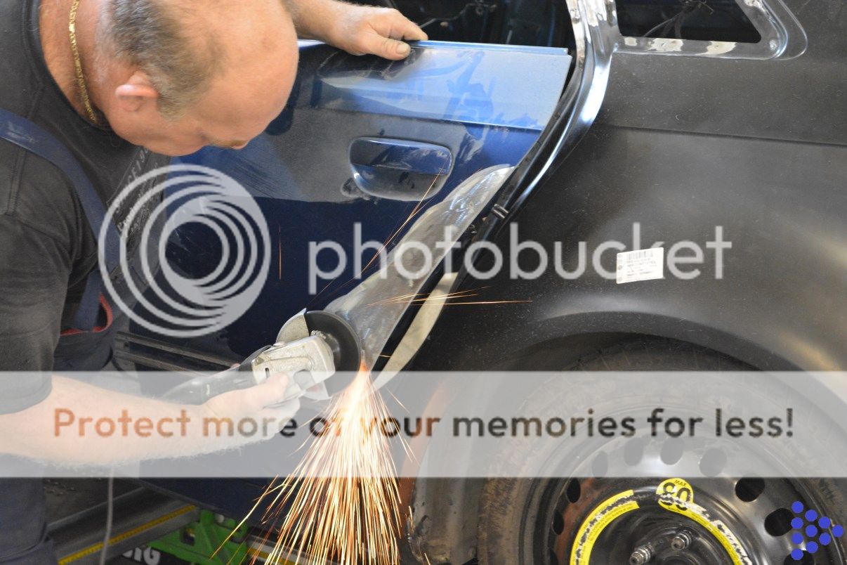

                                Now . . . if you recall, we had a minor issue with the rear doors, as the RS4 ones are a bit wider. However, if you have a shop with balls like these, you dont need RS4 doors, nor do you need bondo and filler or fiberglass to make it happen. Take a look for yourselves.
                                Before
                                And after. Let's Talk about art
                                In the shop's demand, I cannot show pics of the inner door side, cause let's just say, its their art and I respect that
                                All I can say is, it is purely metal work, no bondo or no filler or fiberglass. Respect and props from me.

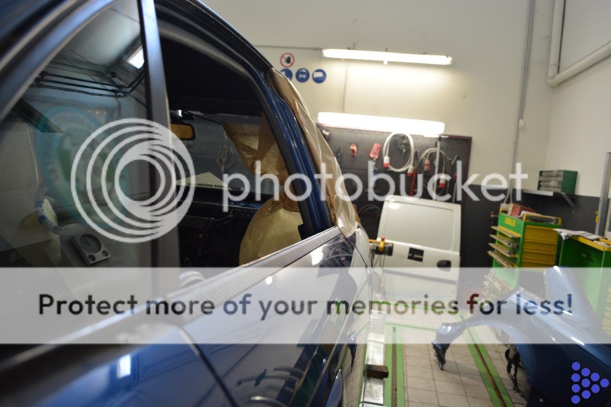

                                Trim out
                                Grinding time
                                No mercy
                                Almost done
                                Next time, we will go to the passenger's side

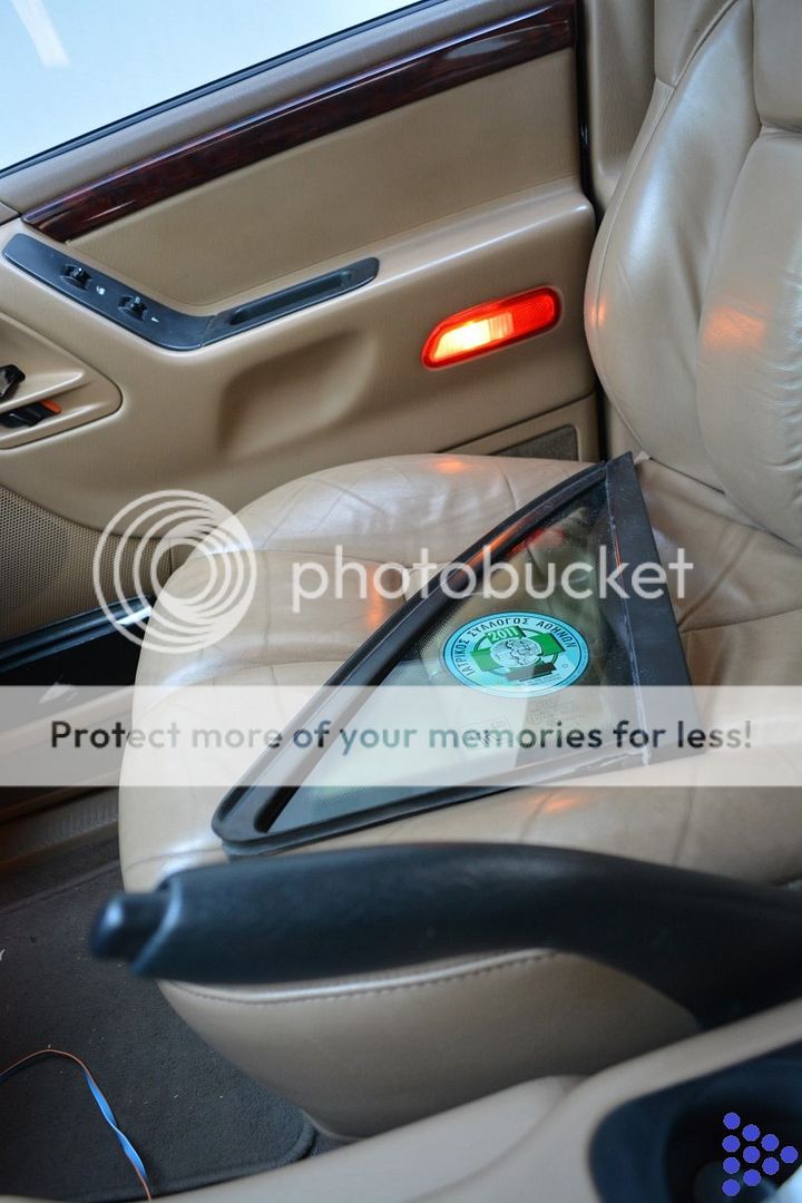

                                where the glass is already removed
                                Taken with me in the other vehicle
                                Cheers guys, more to come
