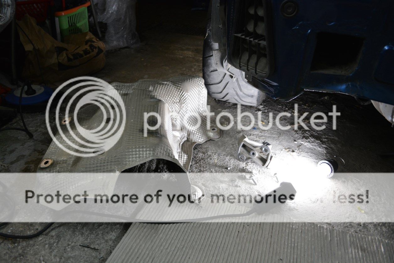

    First I wanted to do some work on the exhaust underside of the car
    Since the exhaust is removed, I can remove some weight, like exhaust hanger, heat protection etc etc
    Before
    And after
    Pretty dirty
    So I cleaned it
    As well as these

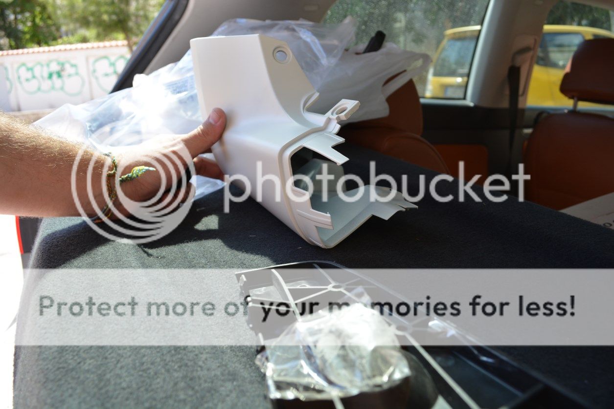

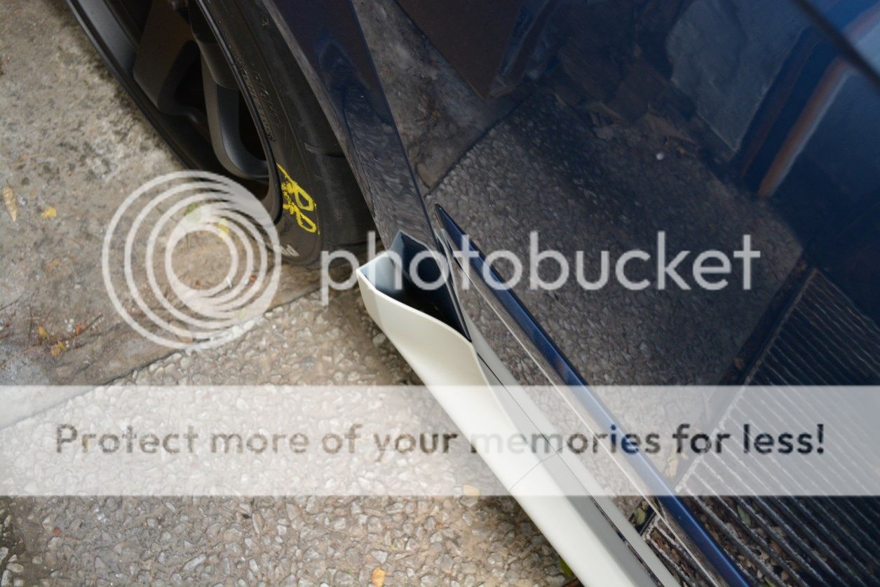

    As I told you, I had enough of sellers refusing to send these parts due to their size (wtf, bumpers are bigger), so I bought this brand new. What can I say. You gotta do what you gotta do sometimes.

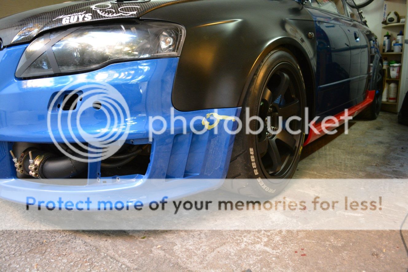

    Then, i had no more time, so I just managed to add these on
    Before
    Removed
    Cleaned of course, since car wont be seeing rain now
    Installed
    Same for passenger side
    Yeah, that RS4 badge just makes you smile. Pretty weird they put it there.
    Gonna be wide

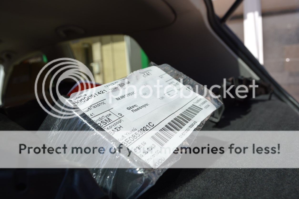

      First of all some more things arrived, that I forgot to receive yesterday

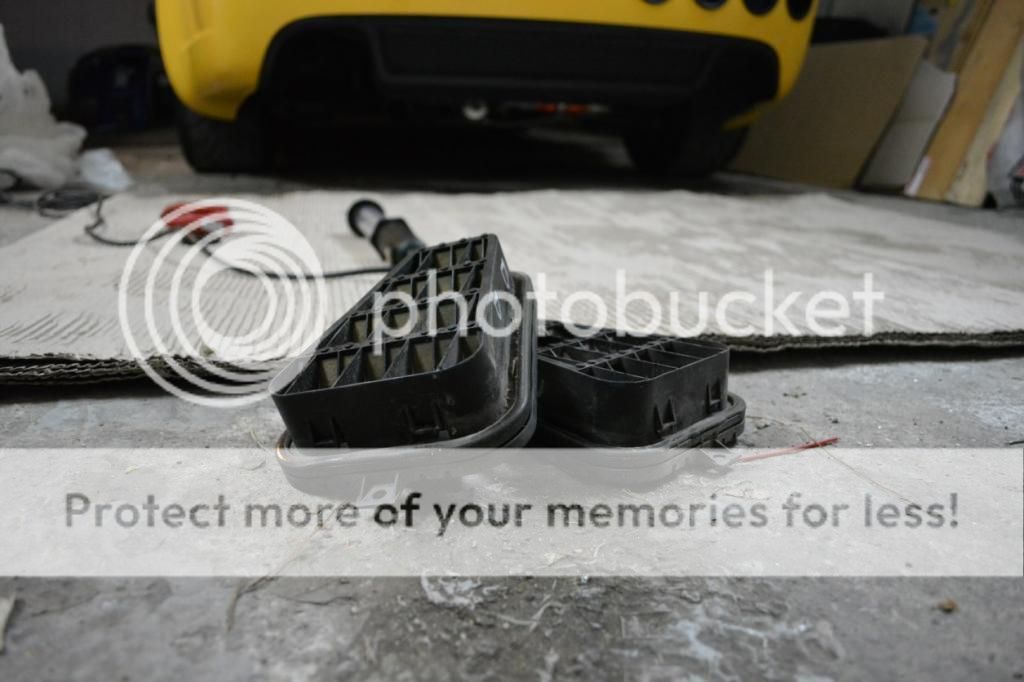

      And installed back the air ducts of the rear end after cleaning them thoroughly
      Love how everything is getting shiny

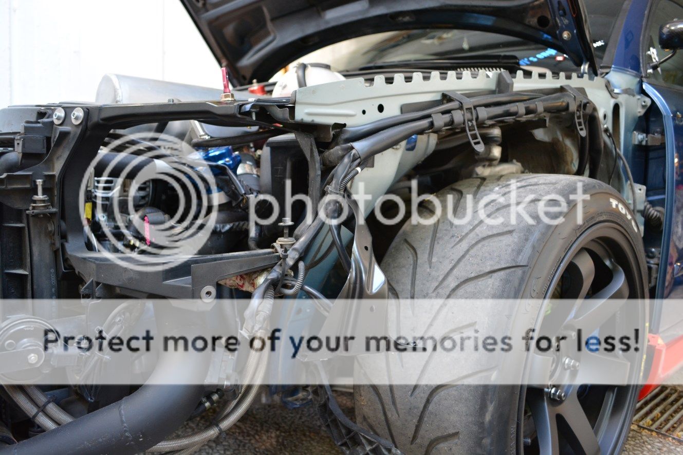

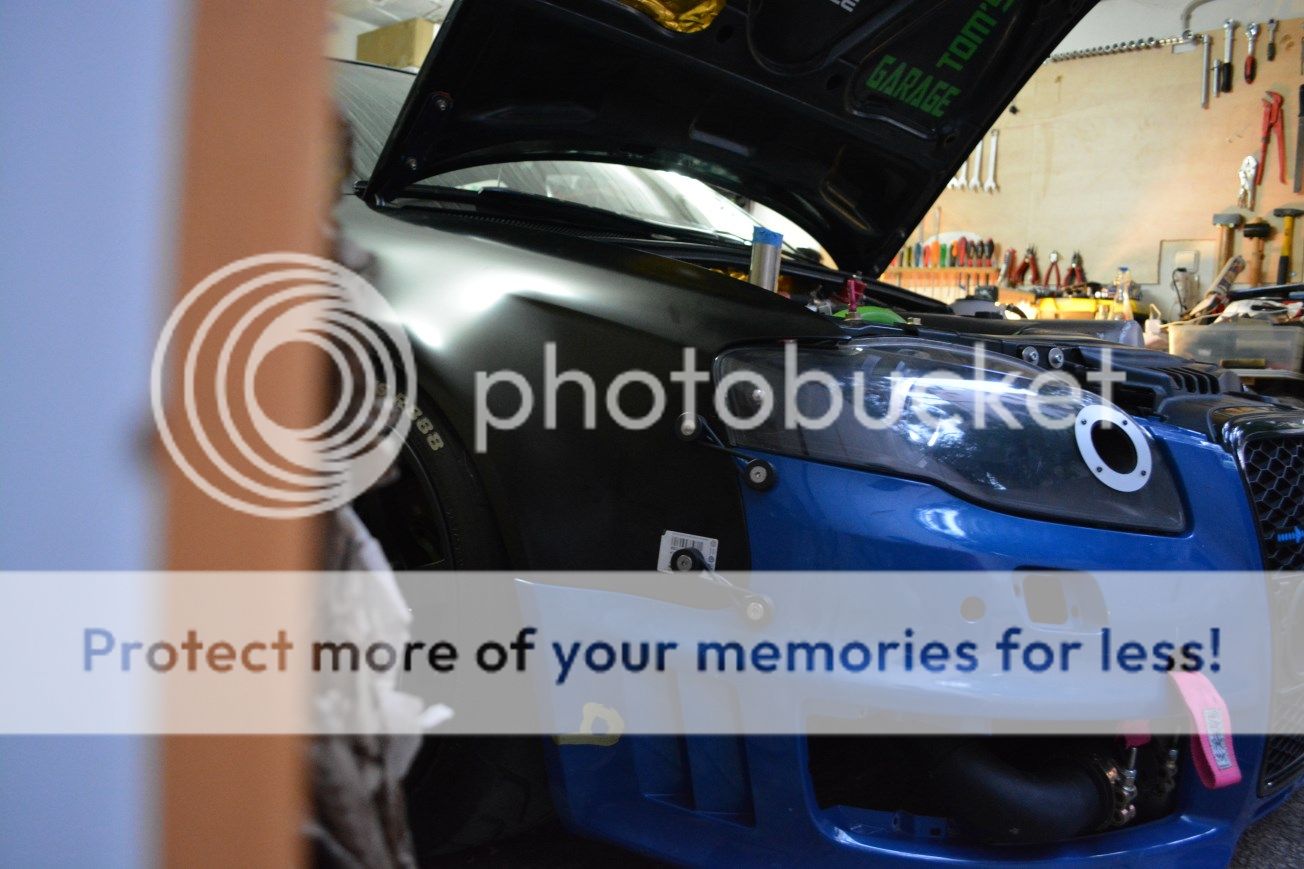

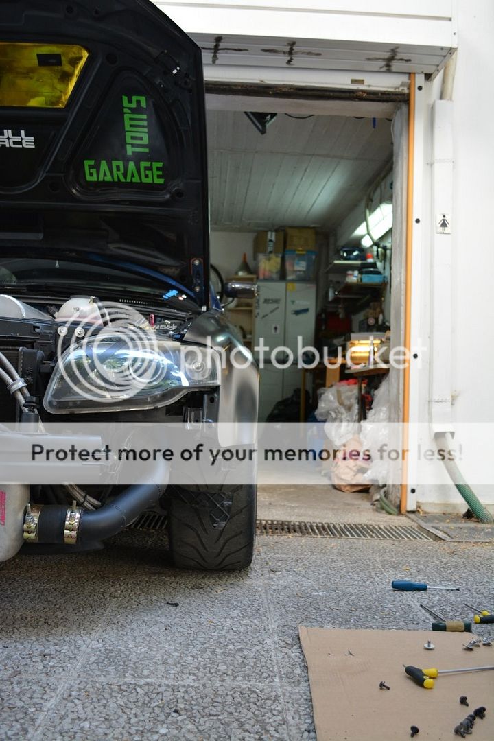

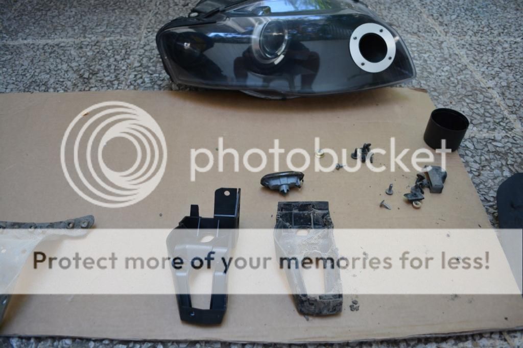

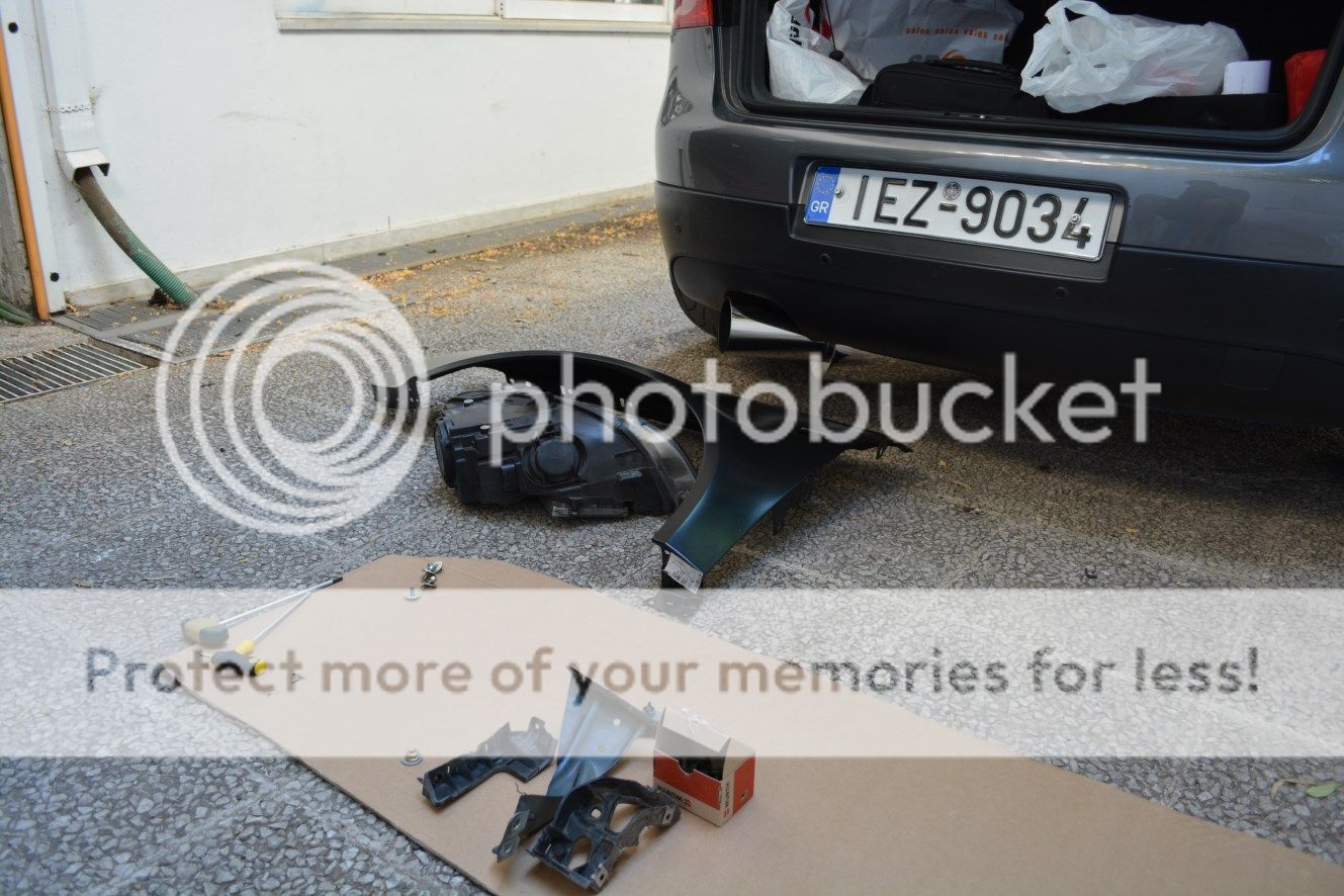

      Removed the front end once again, first driver's side
      First wing
      Then headlight
      So as to put everything in place properly

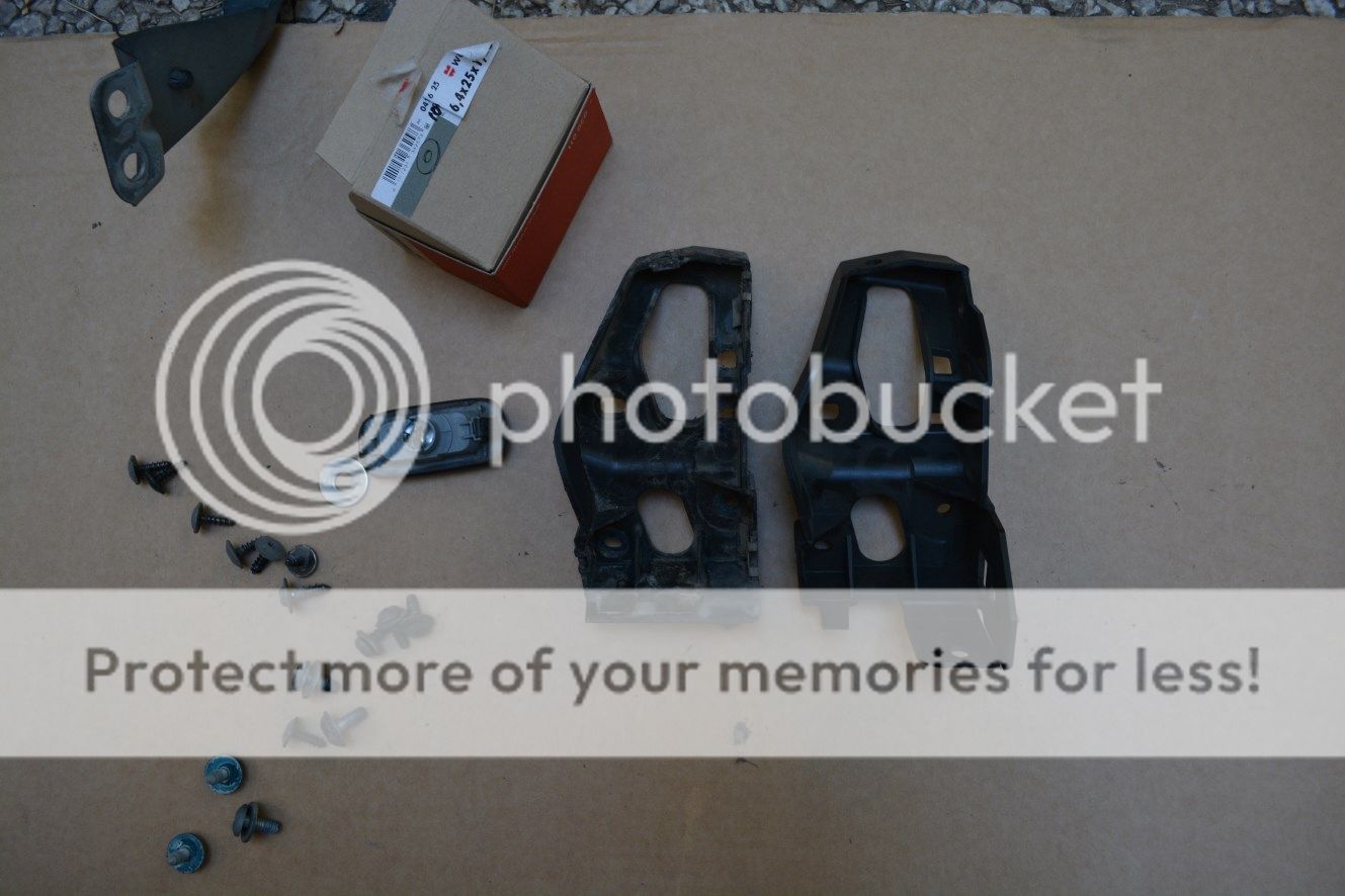

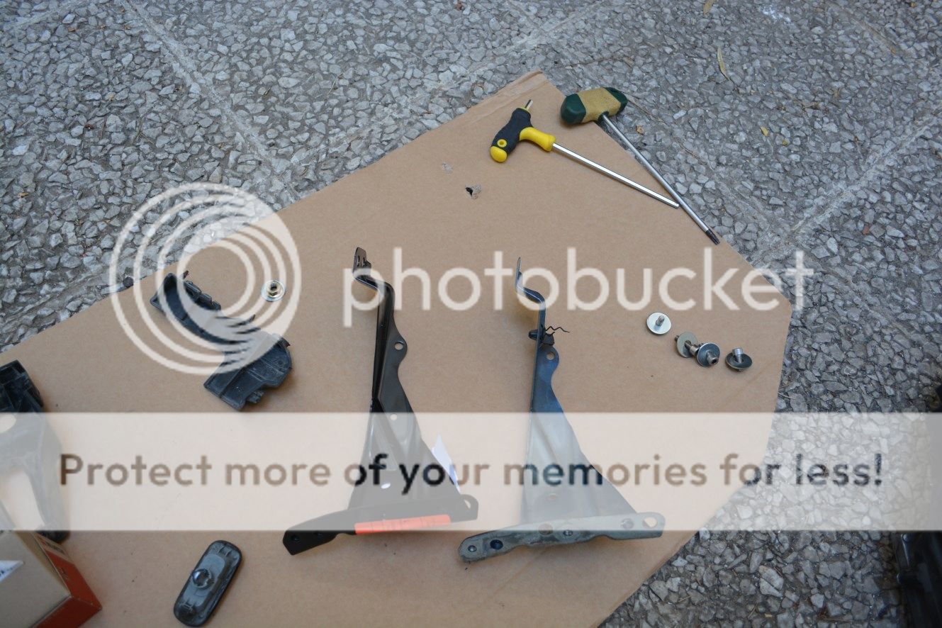

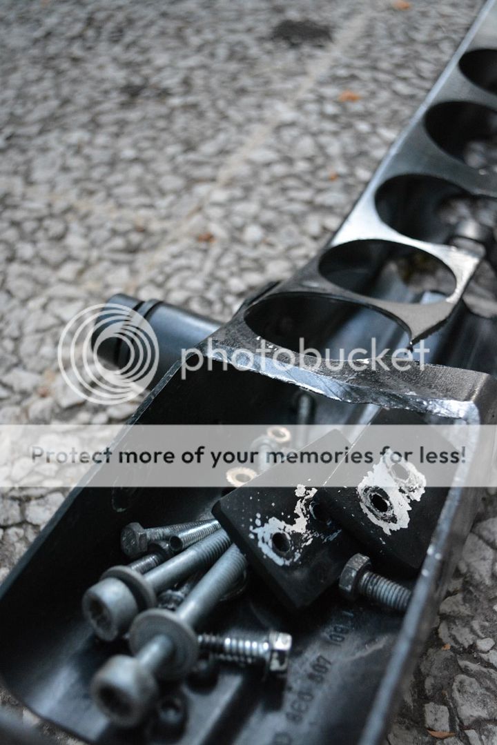

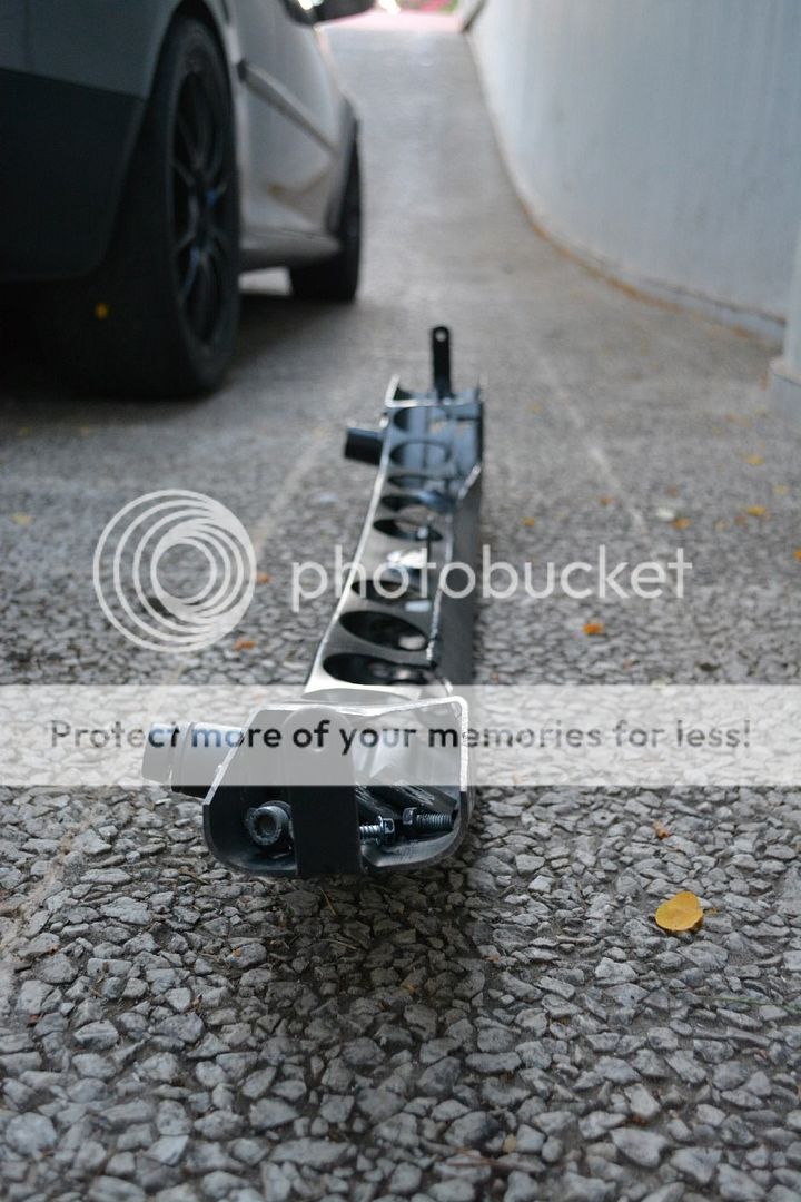

      Front fender bracket, RS4 next to A4 one, very small differences
      Installed in place
      Then these pieces
      That go here
      I got excited so installed the side repeater as well - LoL
      Driver's side done

      Here we have smaller brackets (those seemed identical actually)
      And then these as well

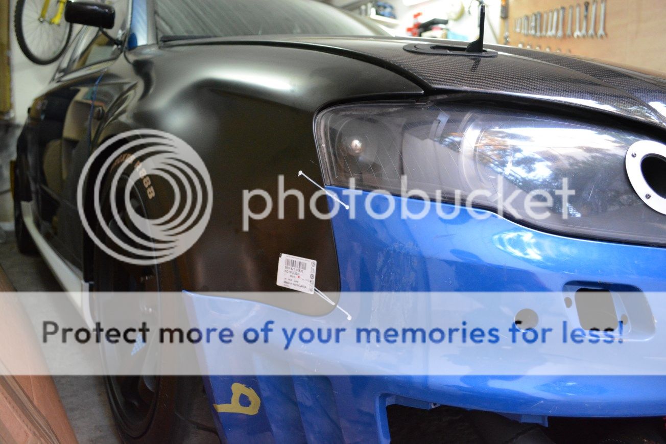

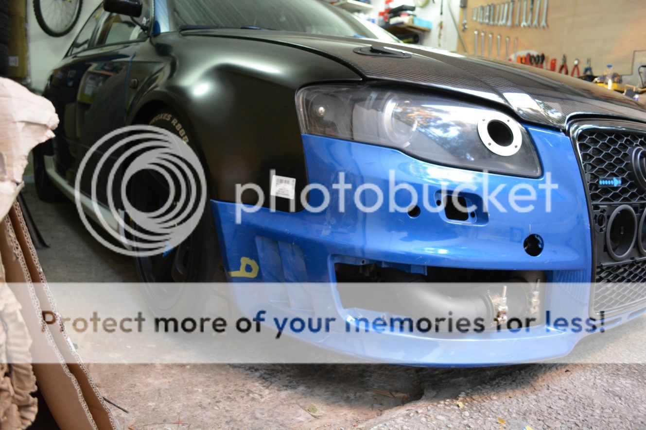

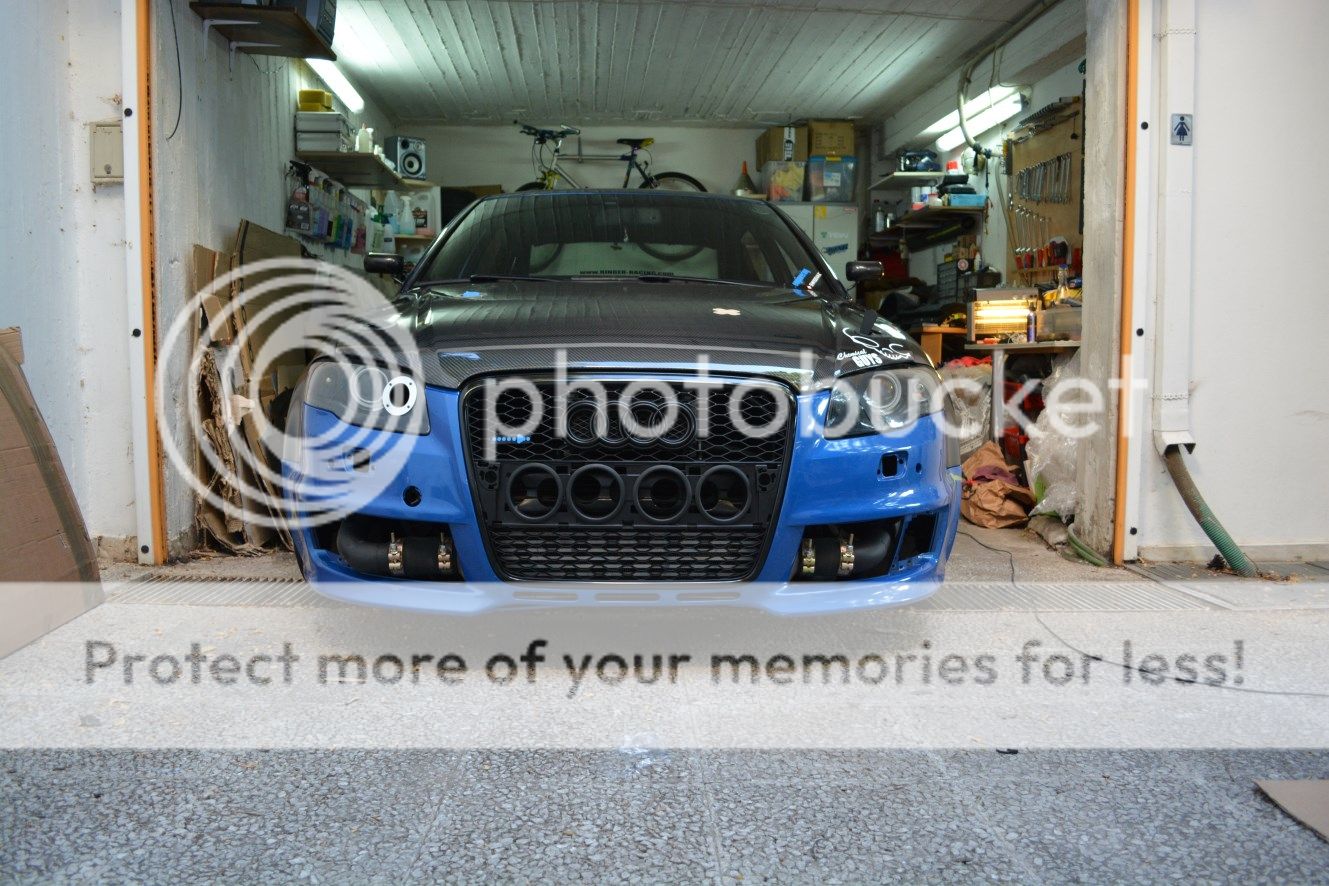

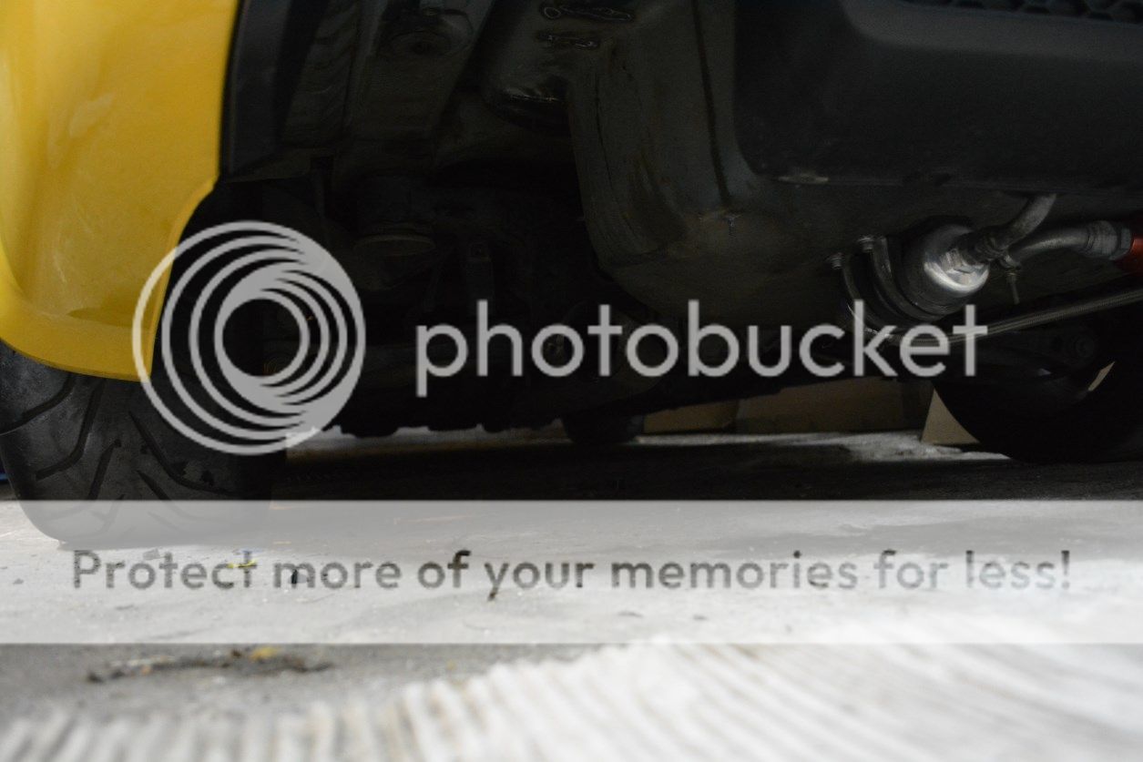

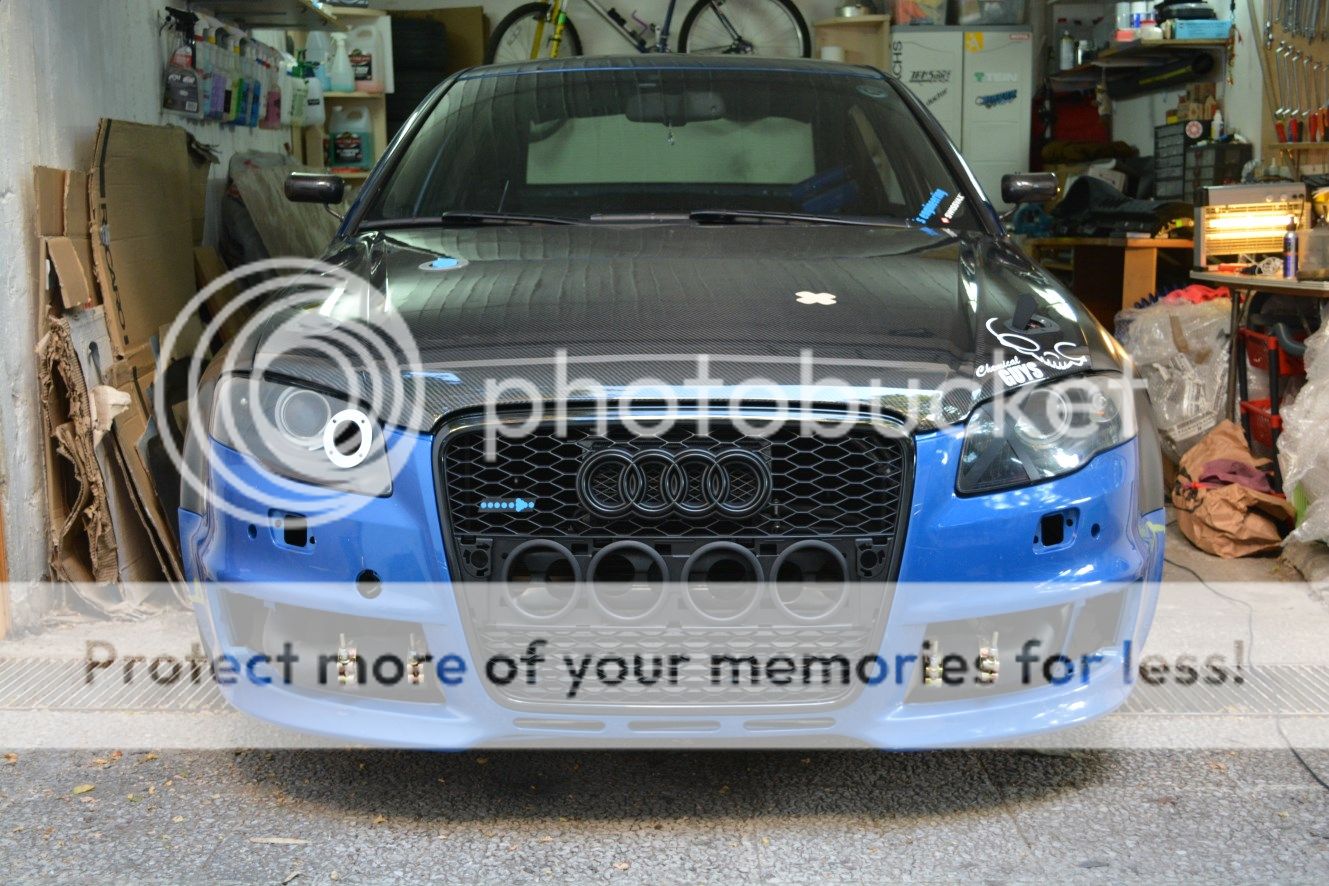

      So finished those, and it was time to test the front bumper. As I thought, no major drama here
      Driver's side went in first time
      Tight fit though, but easily in
      Passenger's side needed some love
      And it received it
      Done

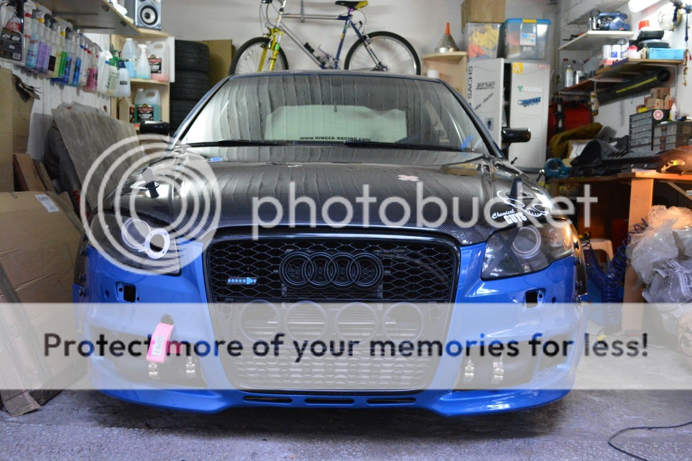

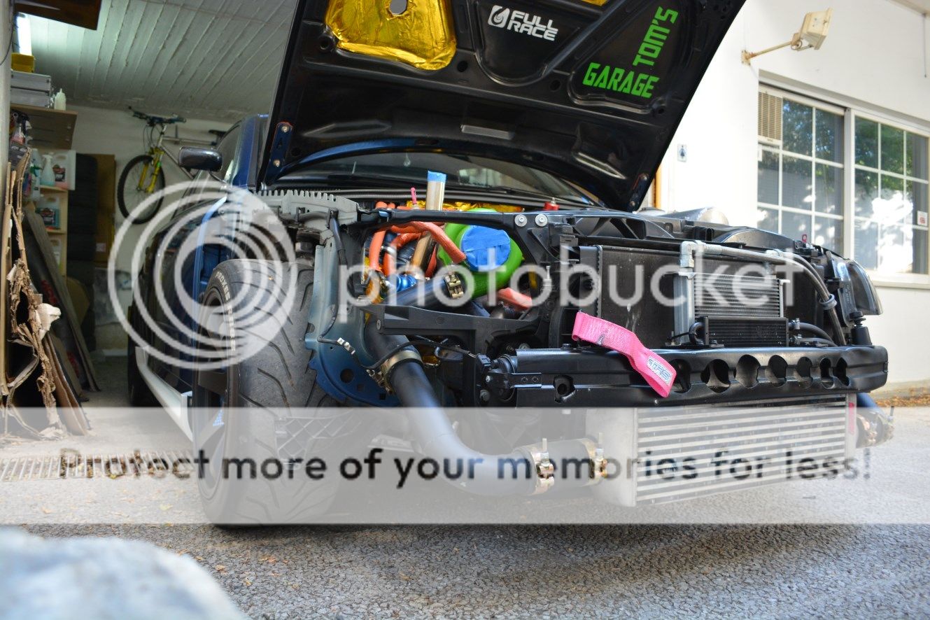

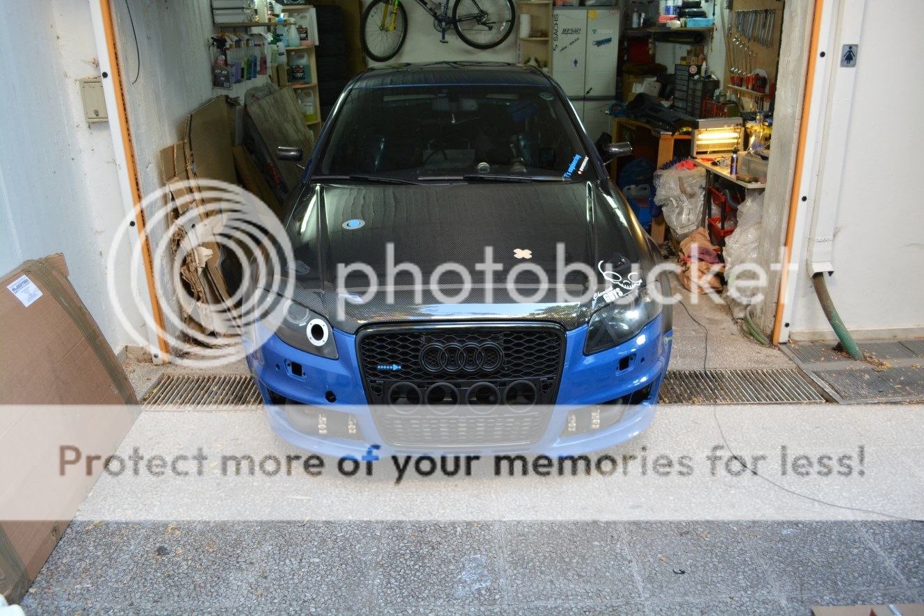

      At last, RS4 Front end, almost complete

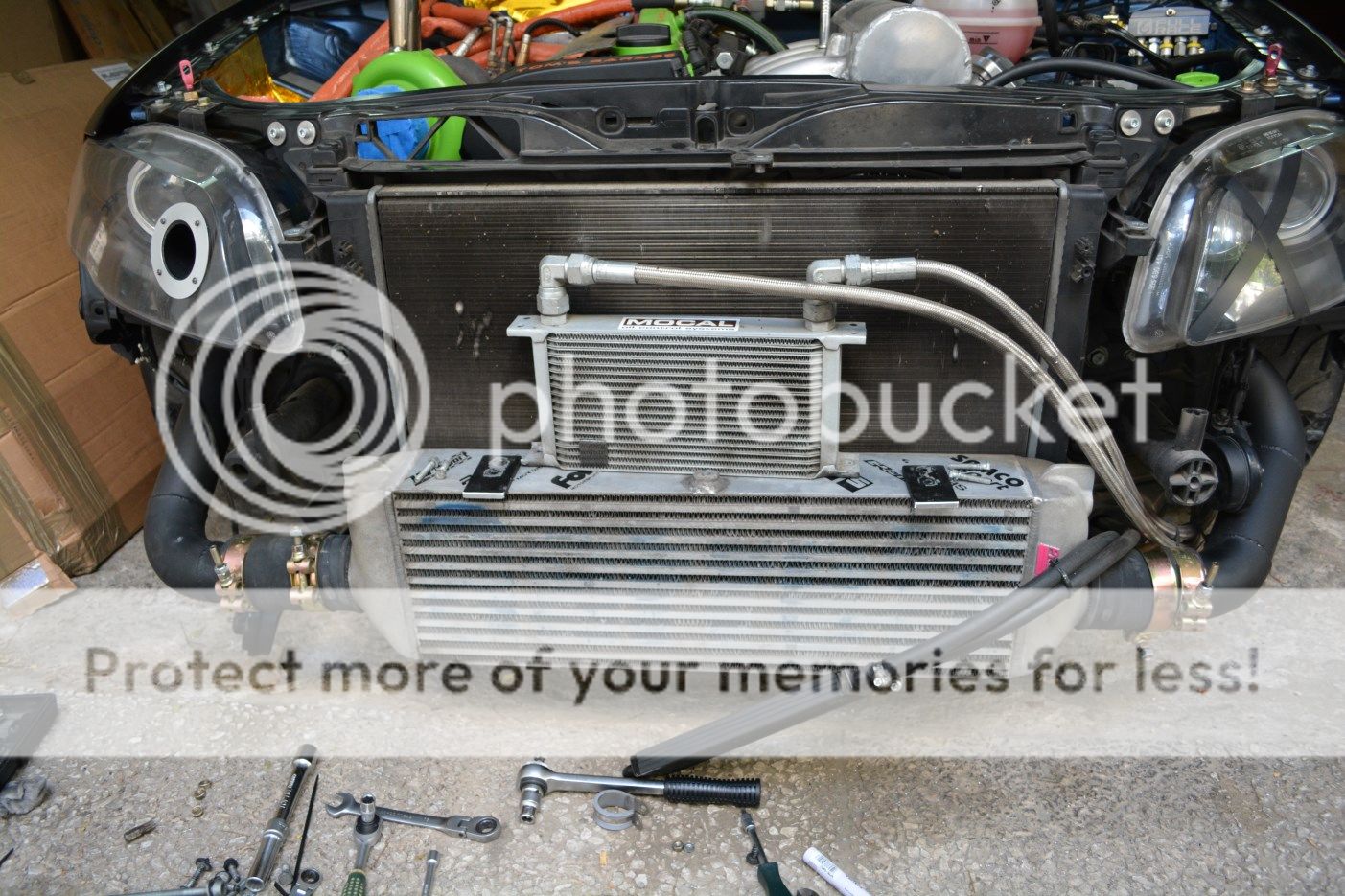

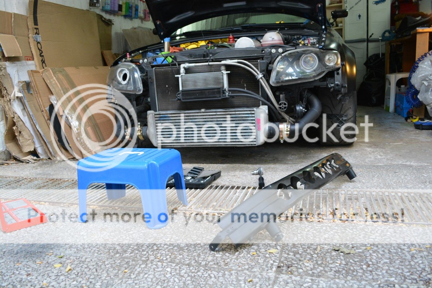

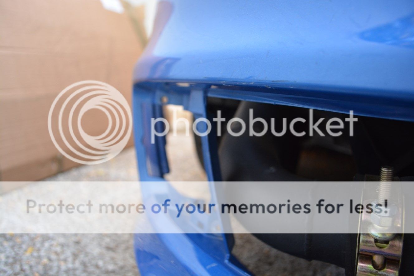

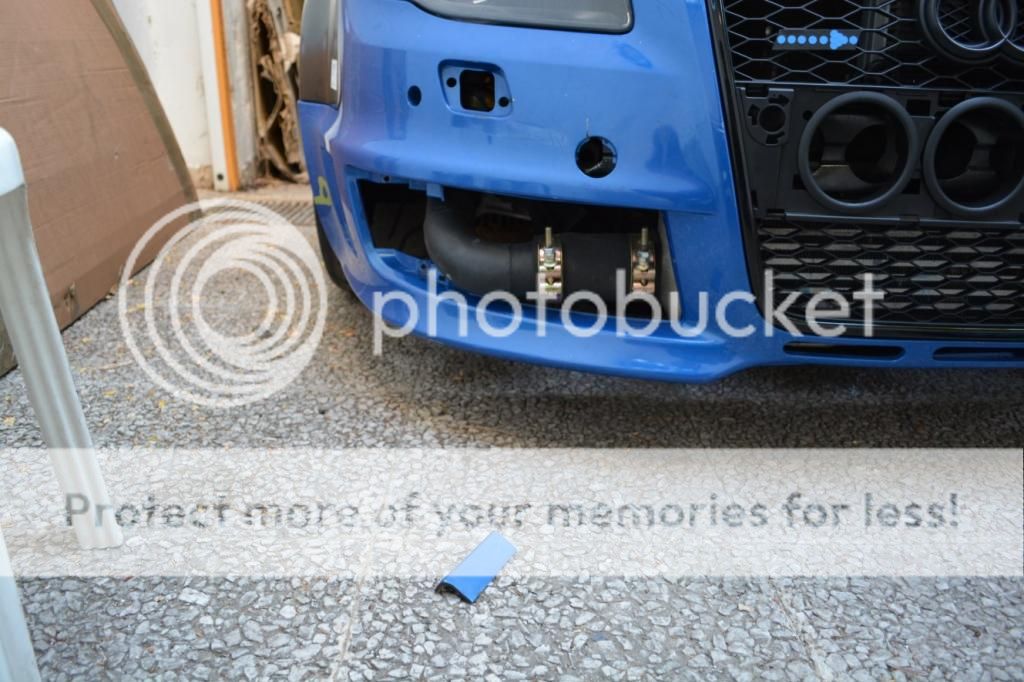

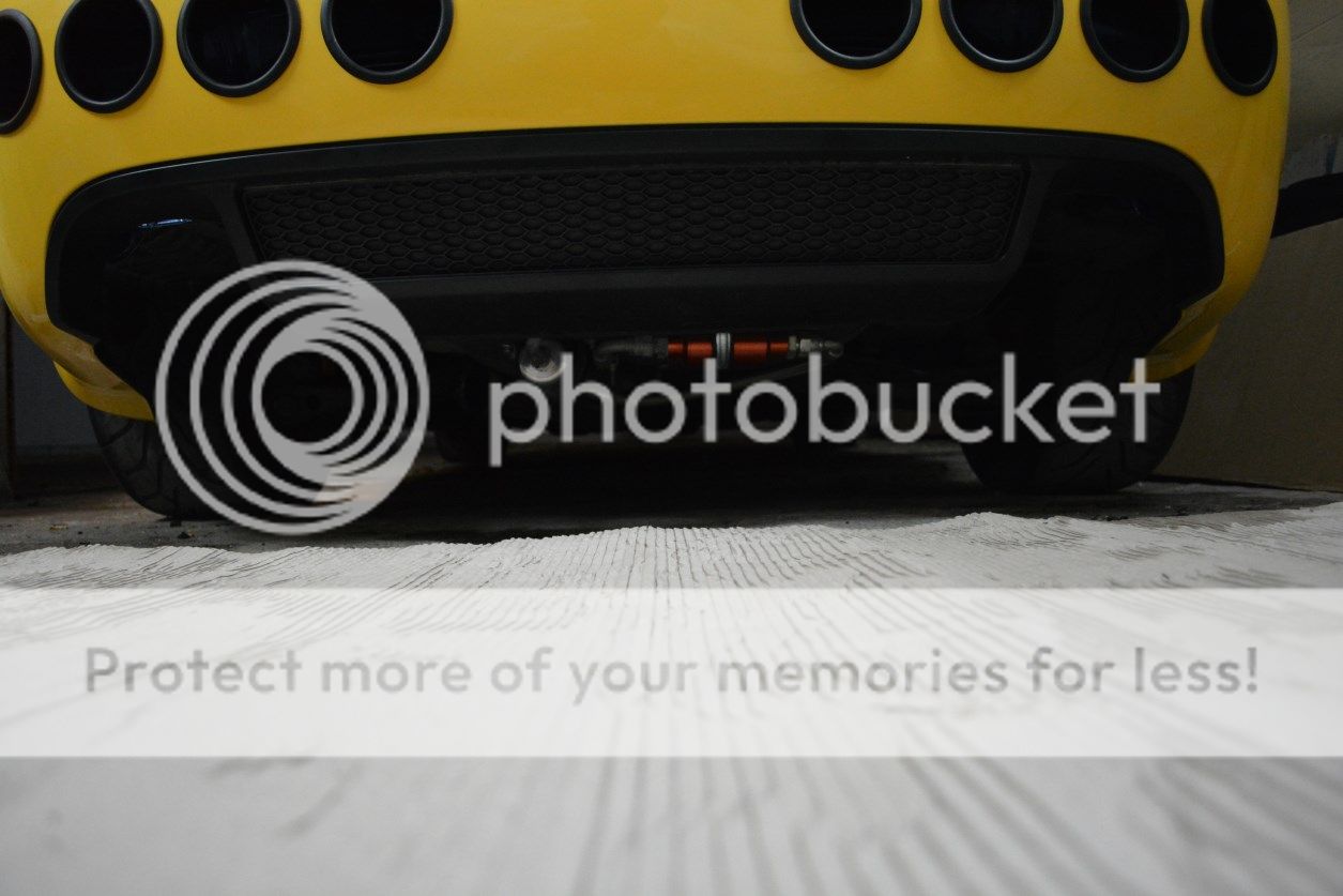

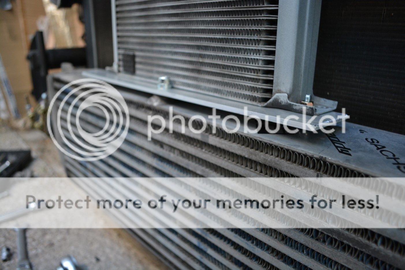

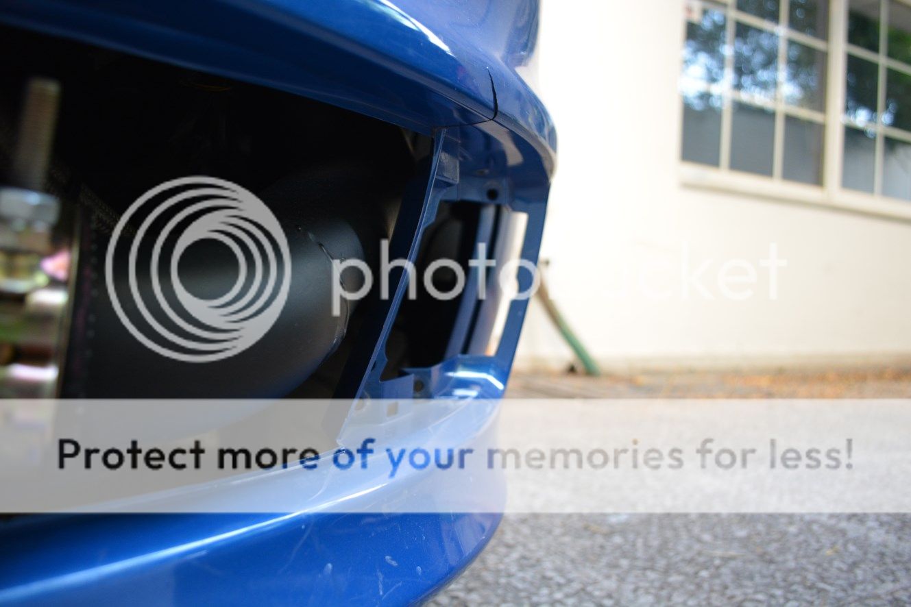

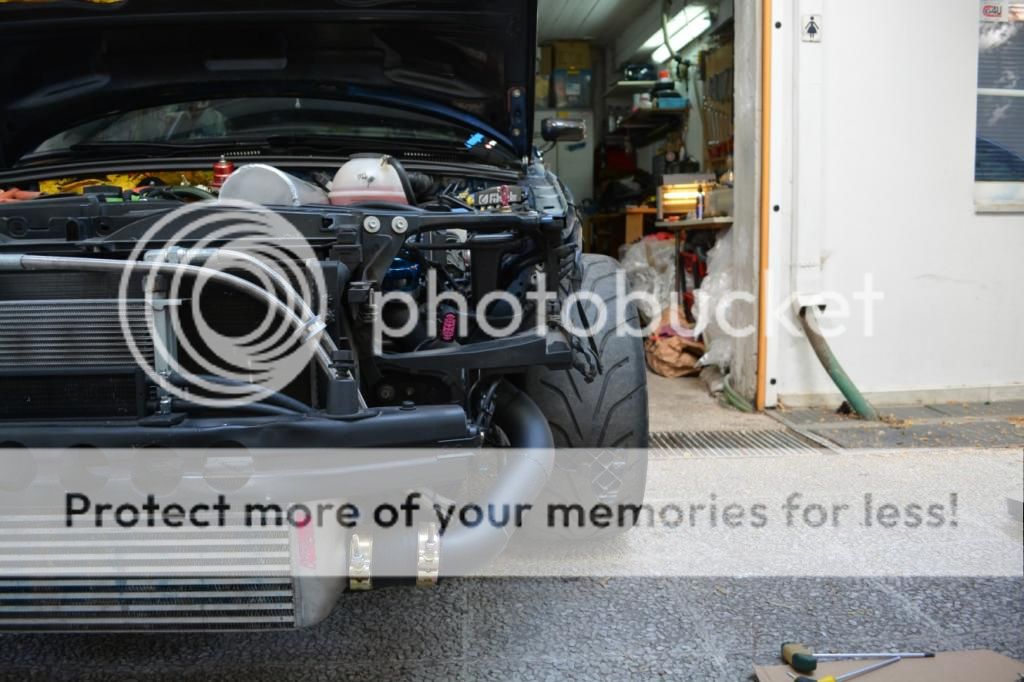

      For the time being, the "foglight" grilles, cant be fitted, due to the IC pipes standing out and getting in the way. I shall what I can do with this, but not my main concern.
      Front the front end assembly, I have also not installed the lower trim, below the grille, and I also need to install my quick release fasteners.
      The crash bar behind the grille will be modified in the future, in another project i have in mind with Tom.
      What is more, I need to decide how will the exhaust exit the car.
      Could be here . . .
      Or most likely somewhere here
      Or who knows where else . . .
      We shall see.

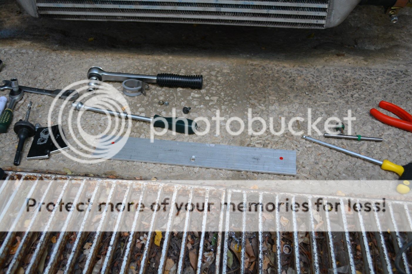

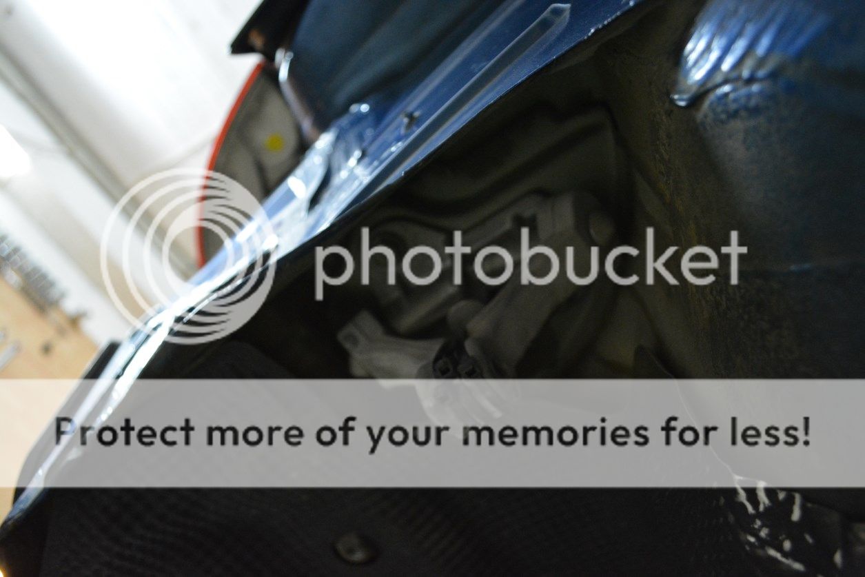

          • Updates
            -Took some measurements
            -Drilled some holes
            And then this happened
            Have to do the same at the back now when I get the chance

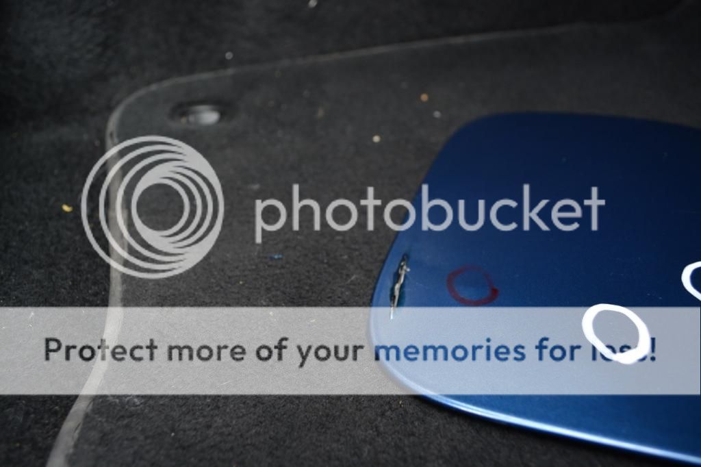

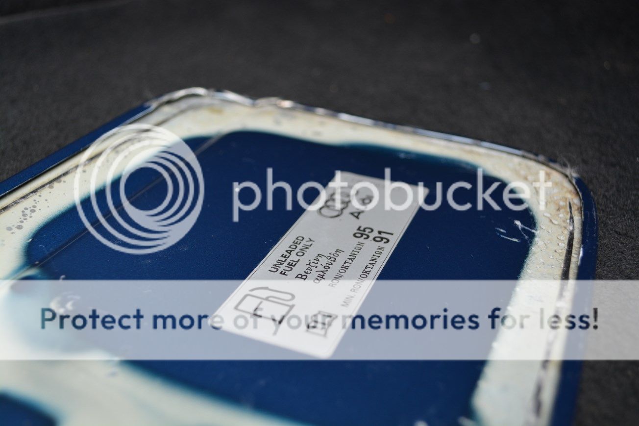

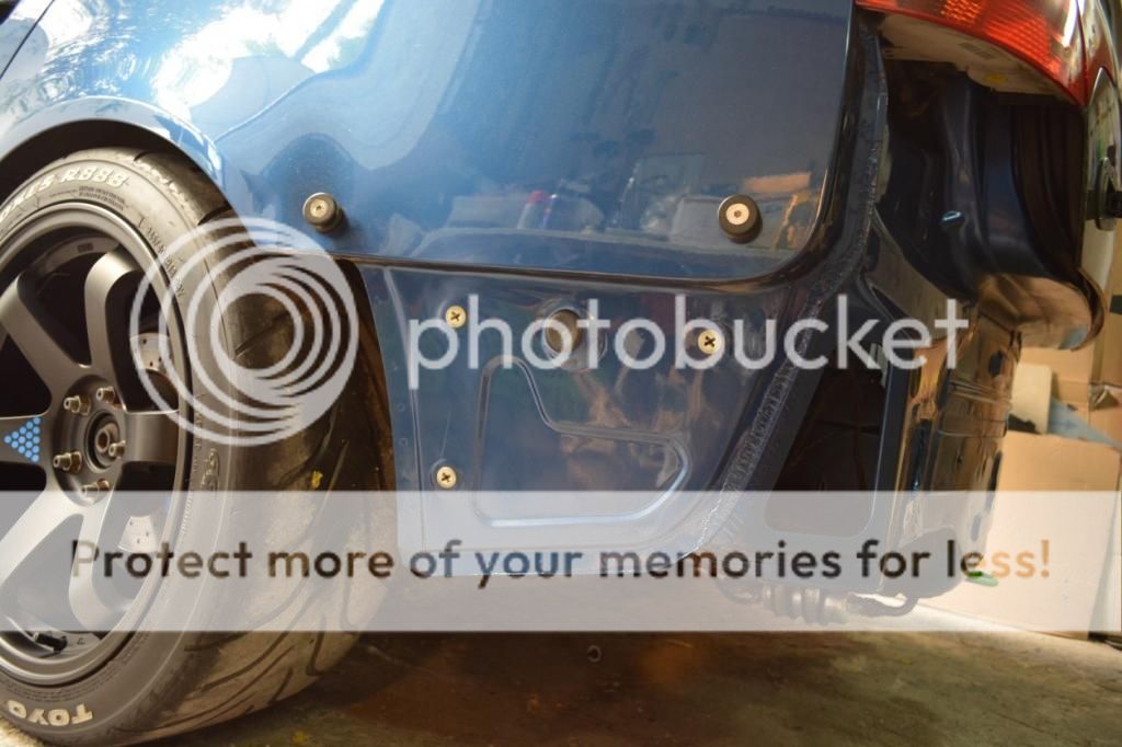

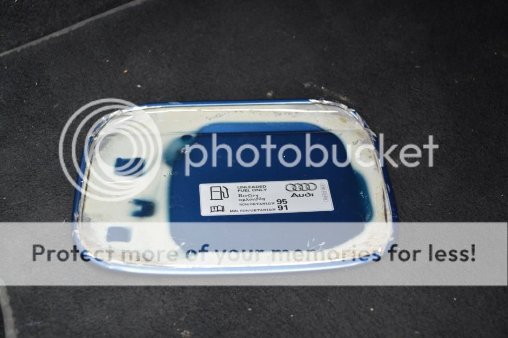

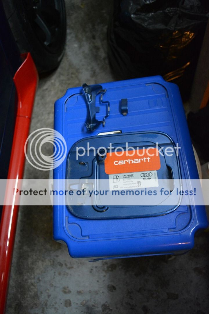

            I also did some work to the gas filler door, that I will re-use to close the RS4 Fender opening - after all, I dont fill fuel from there
            So, started by removing the latch
            And then I cut this whole piece off
            Leaving me with this
            I got a bit angle-grinder-happy-LoL
            And then this will be welded, sanded and painted with the new fender. (in this close-up, my Greek friends, can notice the funny -wrong way the unleaded is written in greek - αμλουβδη instead of αμολυβδη - LoL) .

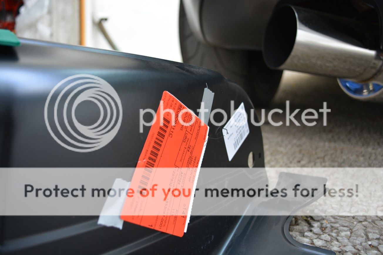

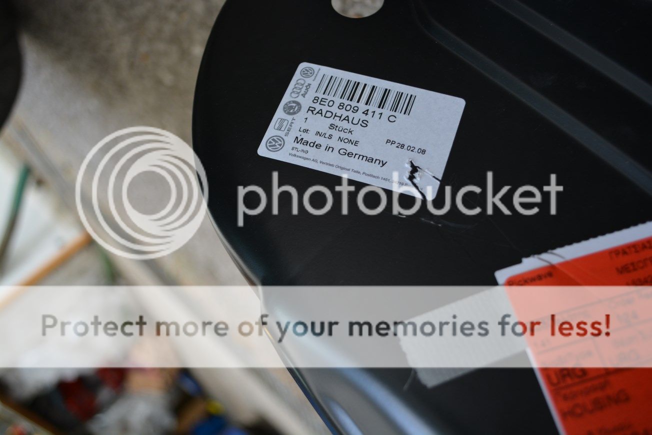

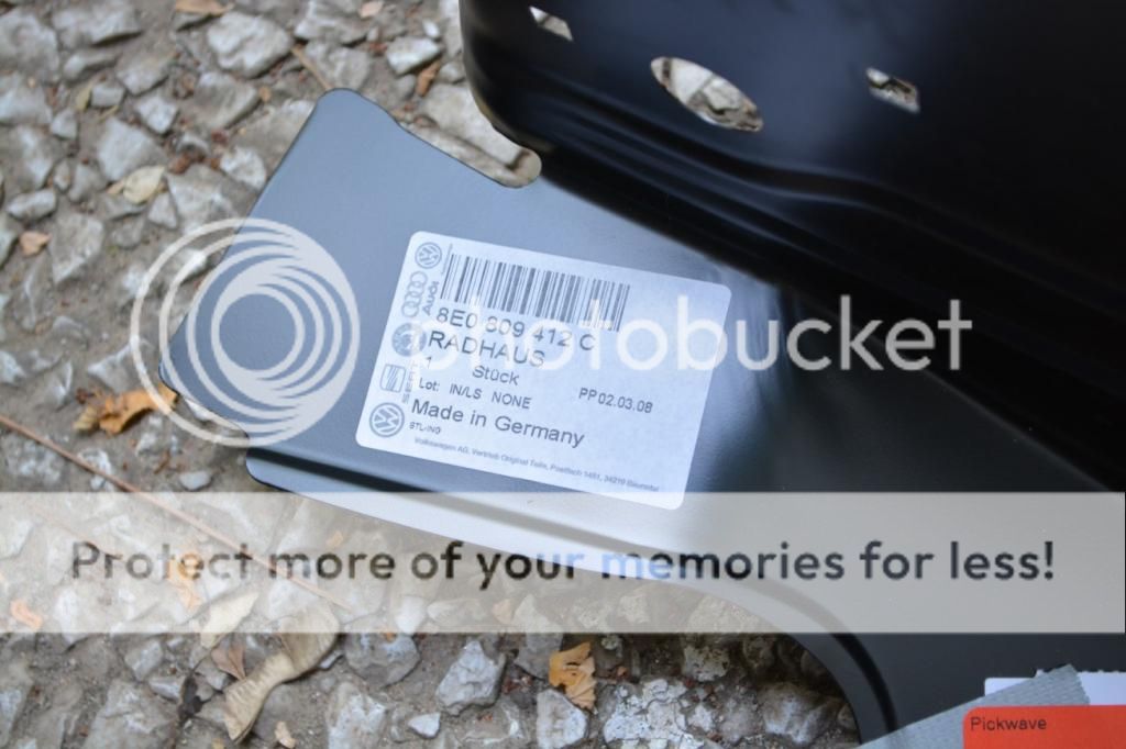

            Finally, and most importantly, another order arrived, a big one, which among other small bits and pieces, had these
            RS4 Rear Wheels / Fenders Inner Archees / Liners
            I hope they were needed and that it couldnt happen without them, cause those were damn expensive, especially for a part that will never be visible, and be heavy too - LoL

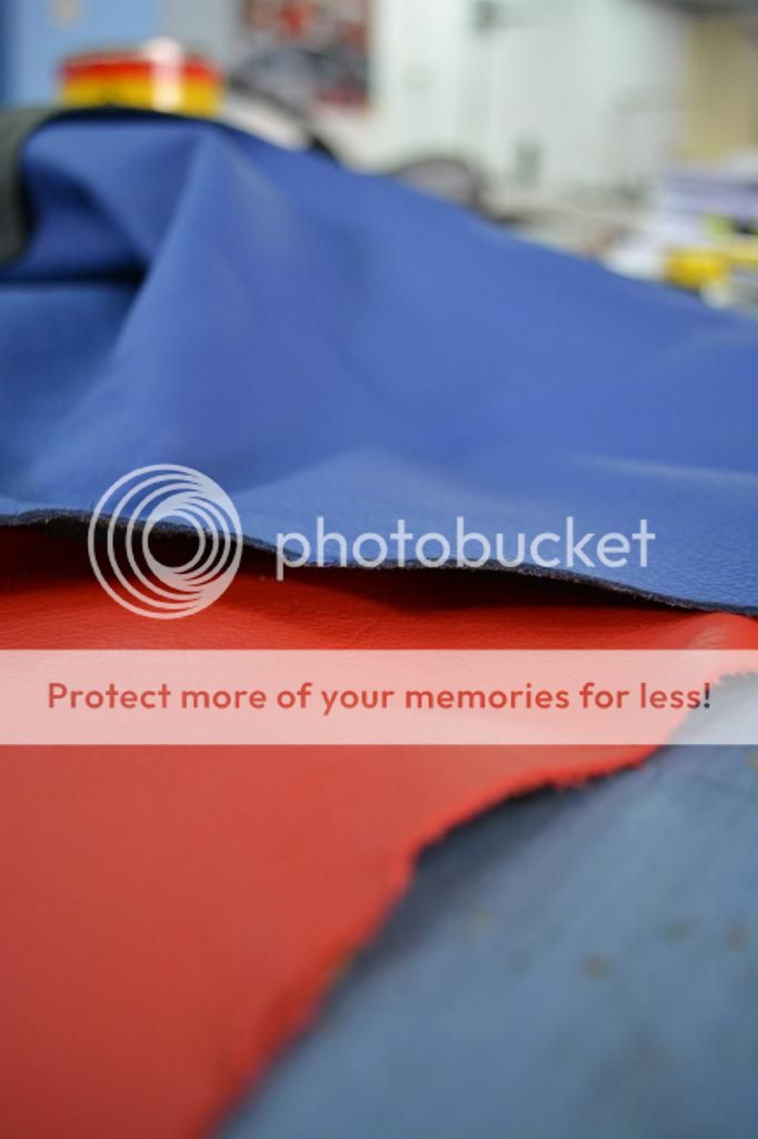

                    • I have some news from the trim shop, the alcantara is here, after a long wait
                      Yummy
                      Can be used in all ways, depending on what finish and feeling we want to give each part
                      And then, I played with some colours
                      Me likey

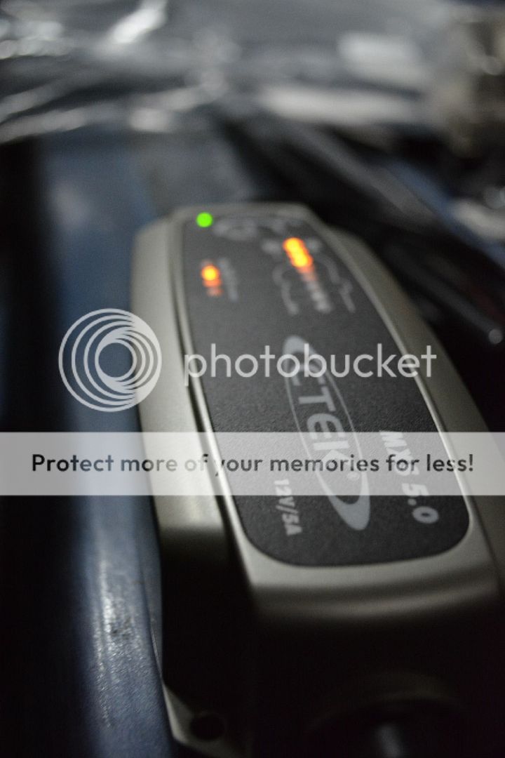

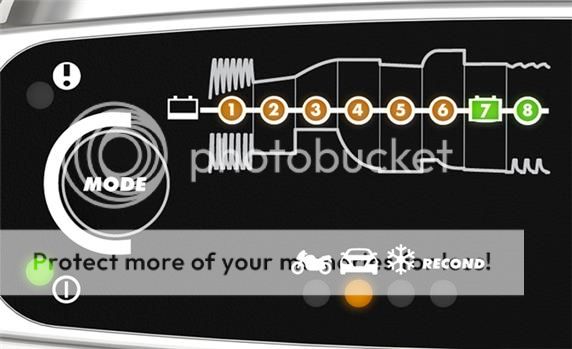

                      Given the fact that the Audi's battery is not in use during the weeks I am doing all the work, I needed to do something about it, so as to not buy a new battery when I drive the car again. Some friends of mine, that own a collection of some old cars, advised me to look for a specific company, CTEK.
                      I went for the best model for car use, and for the range of Ah I have in my cars.
                      Thus, I purchased this one,the MXS 5.0. I am amazed by how everything is extremely detailed and from their product quality.
                      The MXS 5.0 is a charger that offers state of the art technology that was previously only found in CTEK’s professional product range. The charger can solve a broad range of battery-related problems and is the perfect charger for those with high demands. The MXS 5.0 offers features such as battery diagnosis that shows if a battery can receive and retain a charge, a special reconditioning function that restores stratified and deeply discharged batteries, unique maintenance charging, a mode for optimised charging during cold winter days and the charging of demanding AGM batteries (i.e. Optima). The unique display allows the user to follow the entire charging process.
                      The MXS 5.0 is a fully automatic 8-step charger that delivers selectable 0.8A or 5A to 12V batteries from 1,2-110Ah and is suitable for maintenance charging up to 160Ah. The charger is IP 65 classified (splash and dust proof), designed to protect vehicle electronics and non-sparking, reverse polarity protected and short-circuit proof. It is delivered with a 5-year warranty.

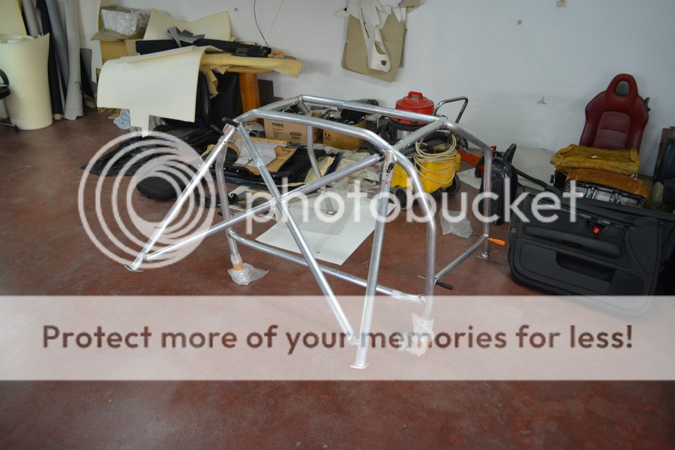

                            • So let me show you what happens, if you ask for the trim shop to take it easily, so that the cage, and rest of the interior are ready and done, when the car gets back from the bodyshop.

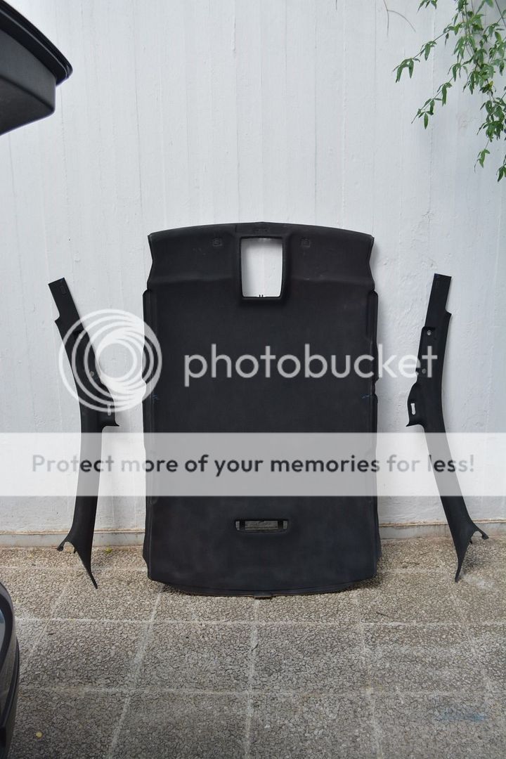

                              What happens, is that you wake up one morning, and you decide to remove these
                              Notice some numbers. I will tell you later why these are here
                              Headliner then went, you guessed correctly to the trim shop

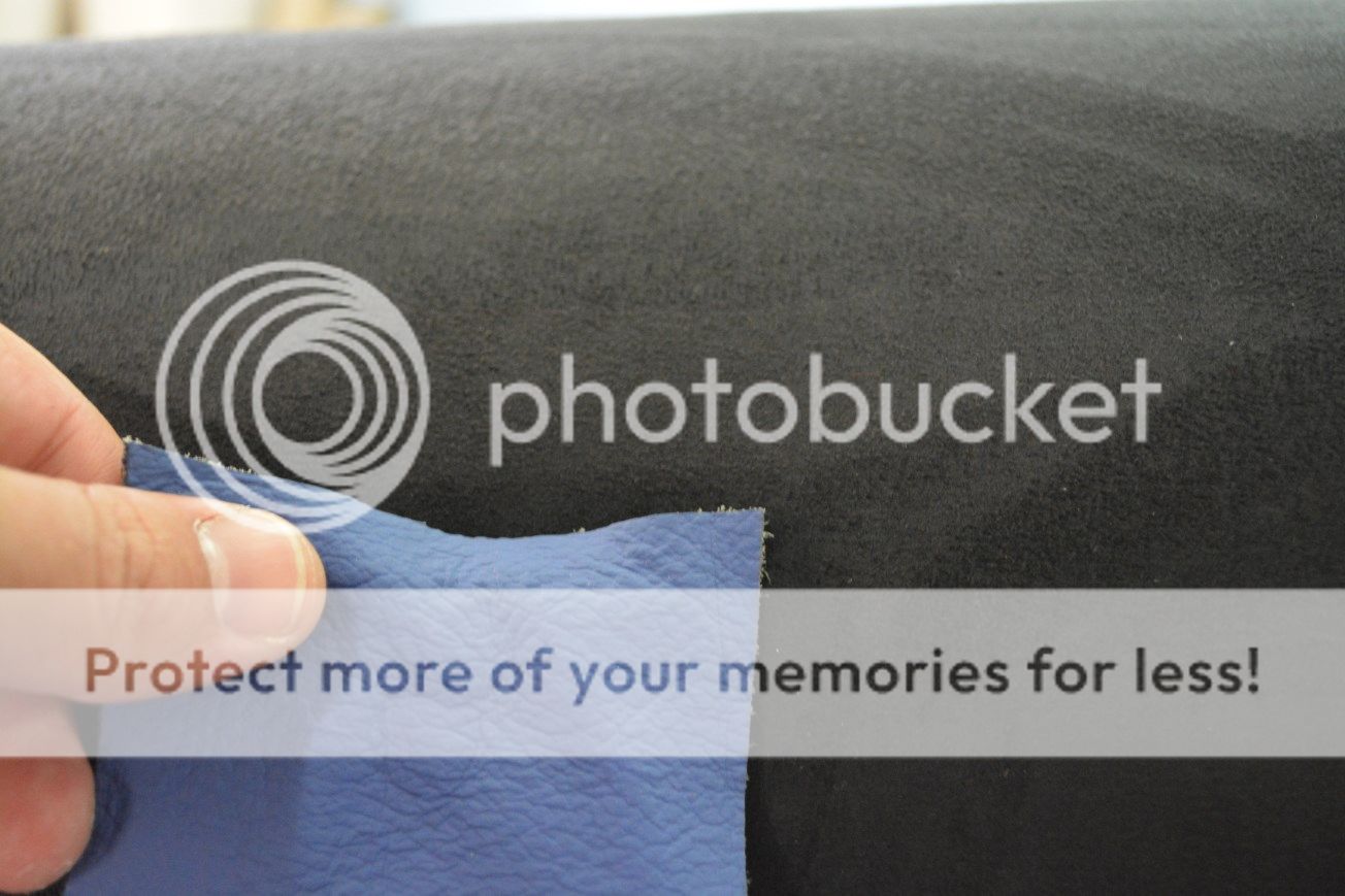

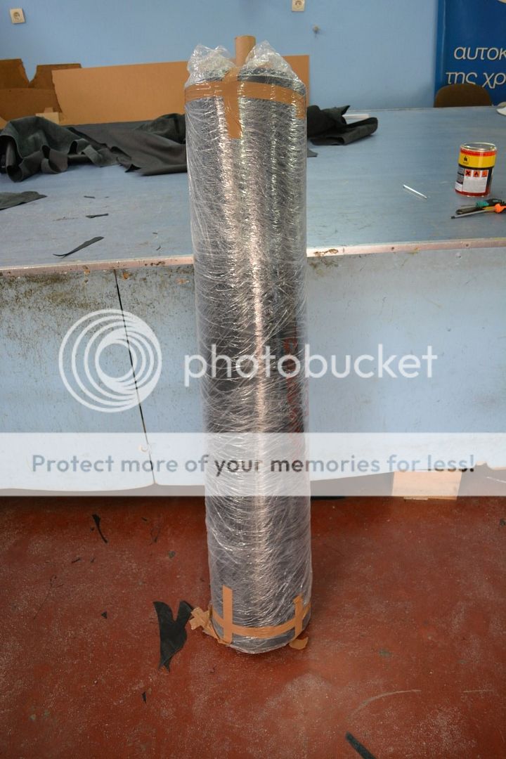

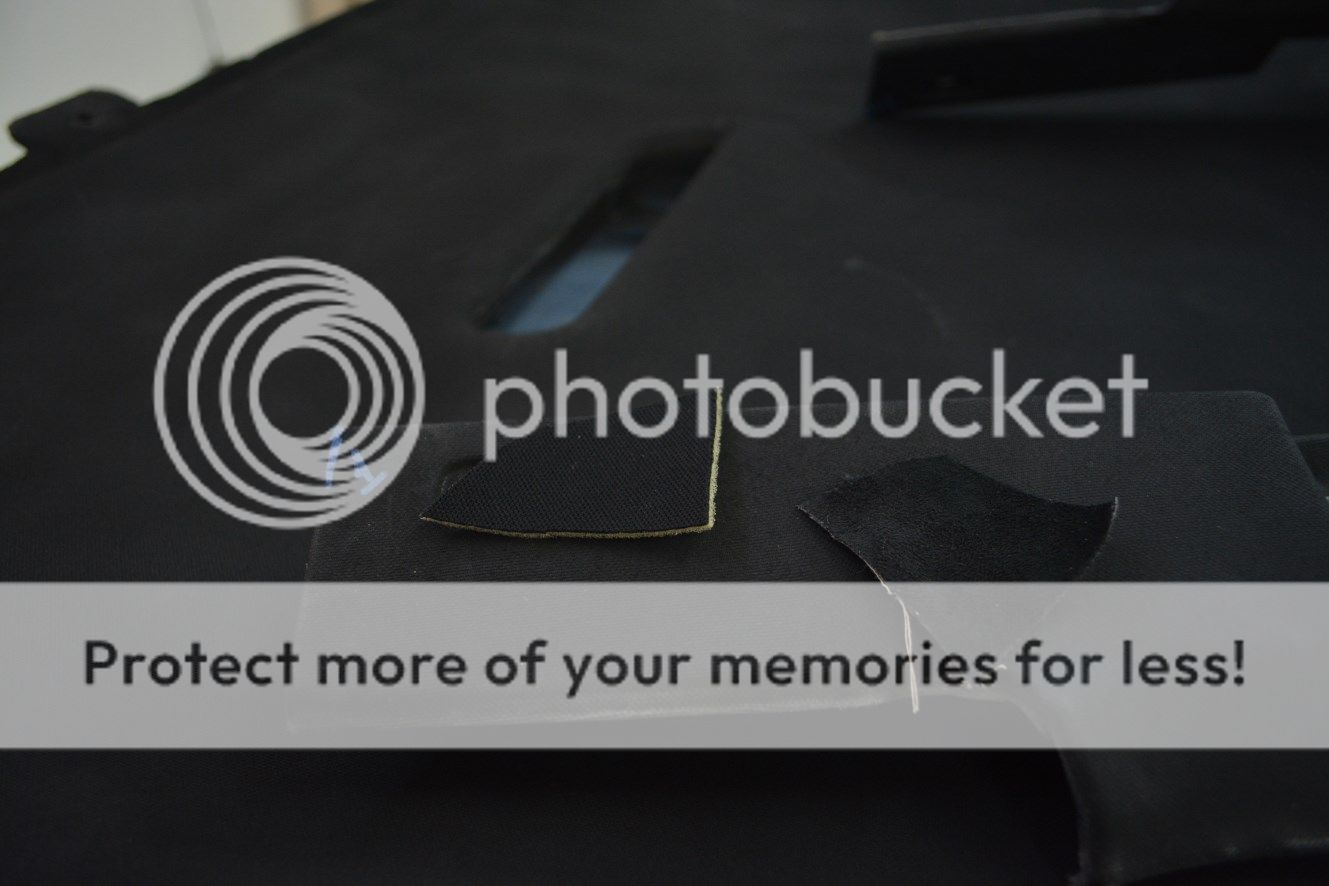

                              And then, I chose a material to play with. The owner of the shop, told me to go for this one
                              which, would make a great OEM black finish, keep the cost to a very logical level, and give the headliner the finish it deserves. He advised me against going for alcantara once again, due to the high cost.
                              However . . . I thought that it would be a shame not to.
                              So yes, material on the right, it is, once again

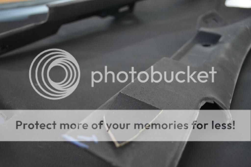

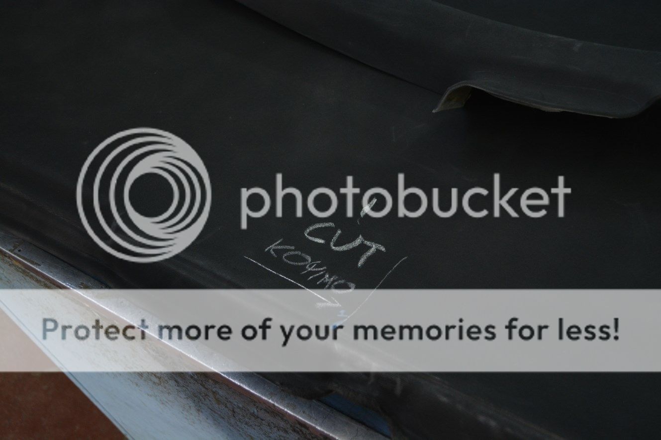

                              And here is, what the numbers were for
                              yeap, the roof will be cut, to the point where the A pillars stop, because from there and backwards there is no interior, just the cage. So bye bye more weight.
                              needless to say, the oem fabric will be removed, and then, alcantara will go on.
                              Hello cage
                              how are you doing here

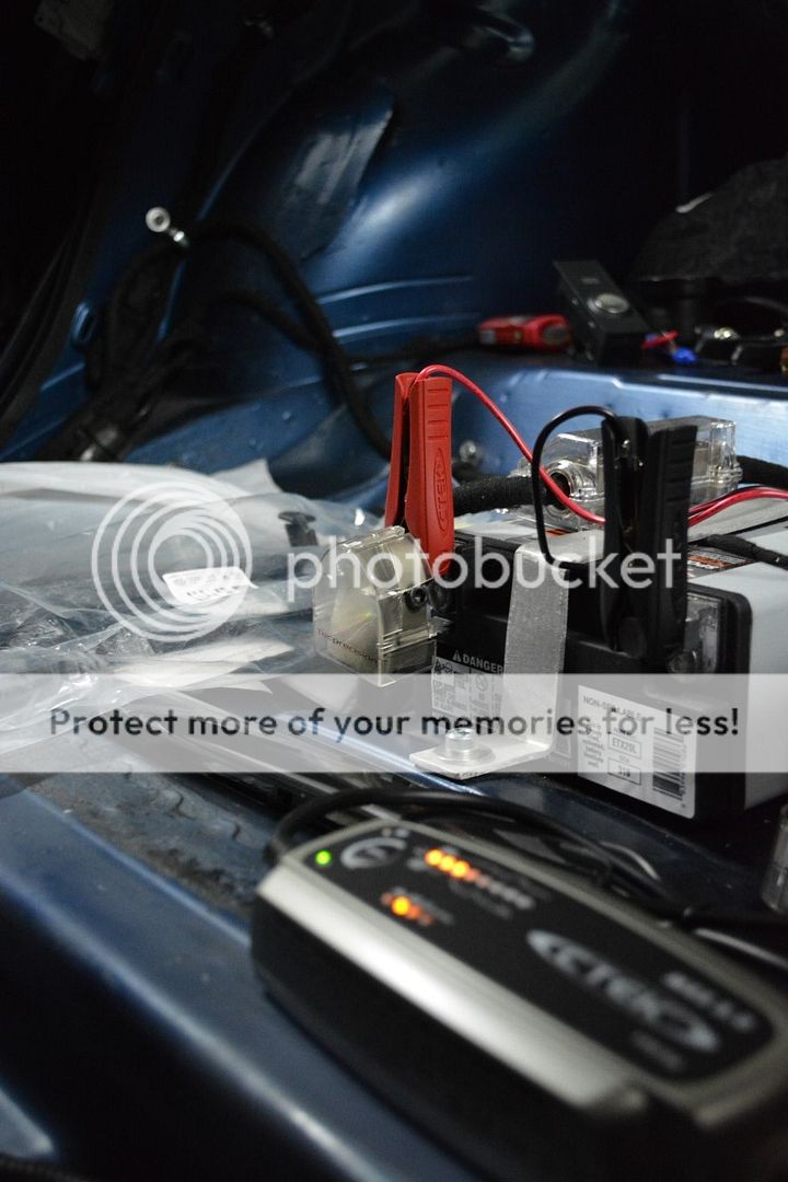

                              In other news, the CTEK is doing its job nicely
