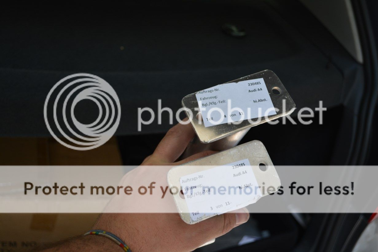

              2. I ordered all the bumper-fender-sideskirt supports, all new from stealership

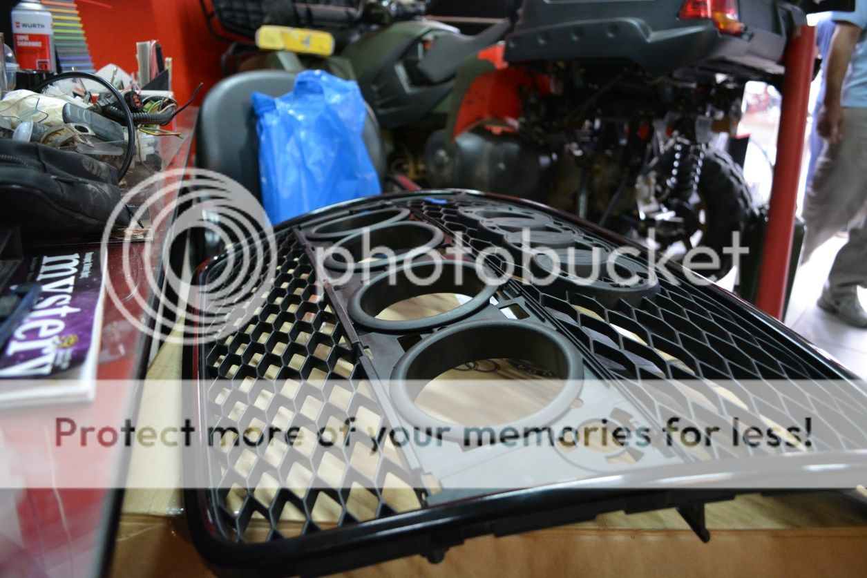

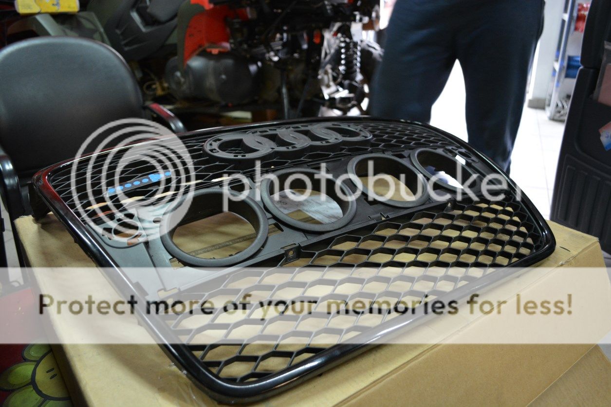

              What is more, I managed to do some work on the RS4 grill.
              Some sneak pics.
              Stay tuned for more

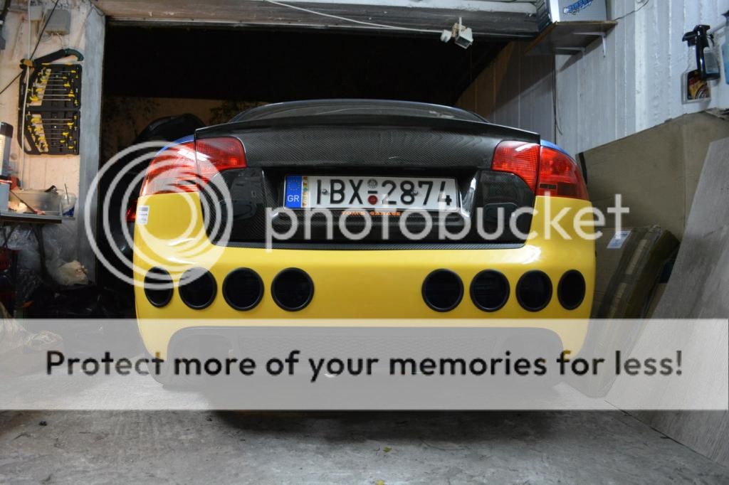

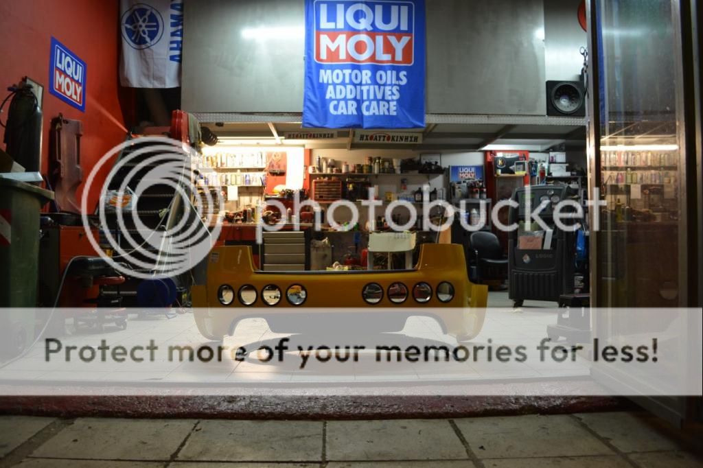

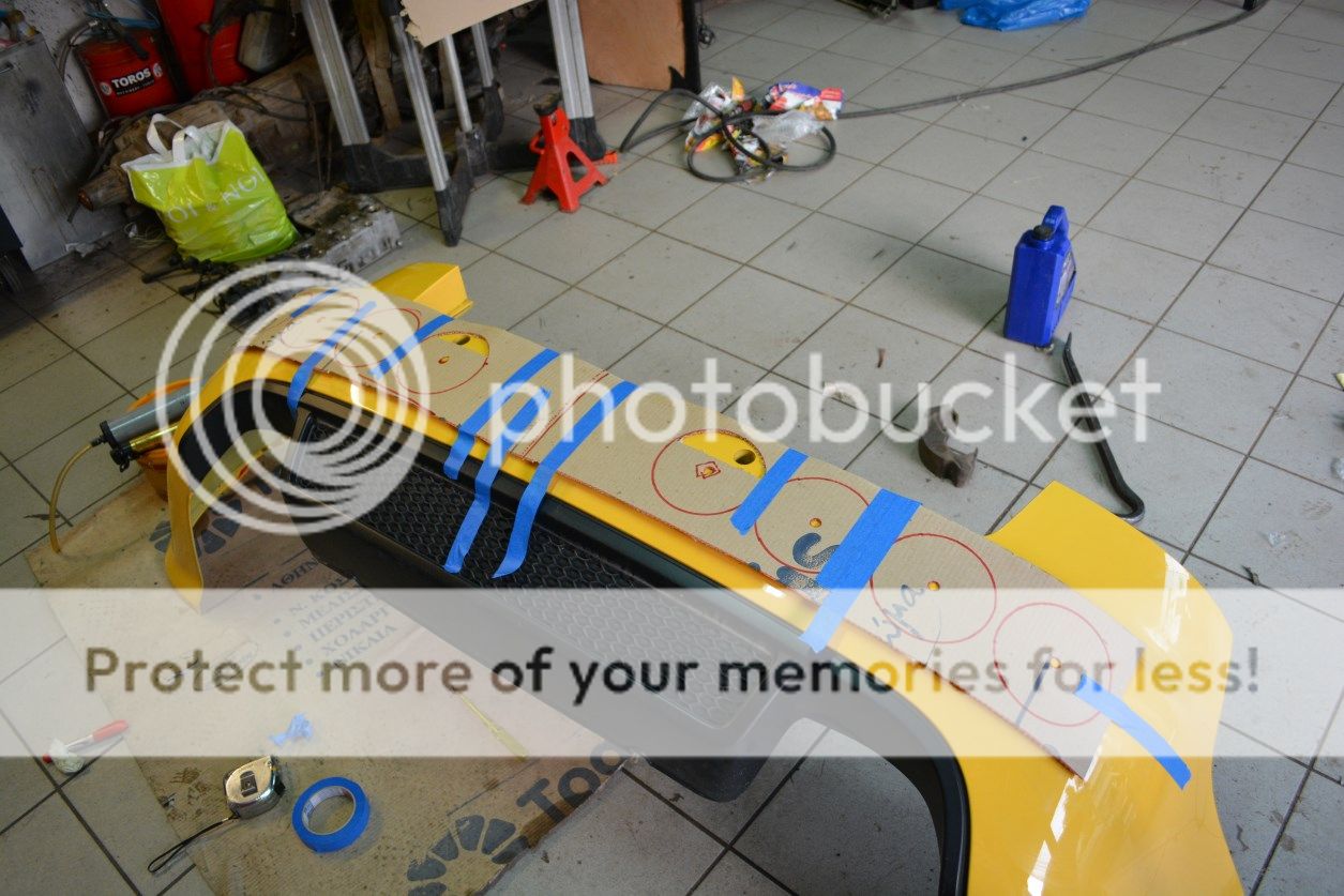

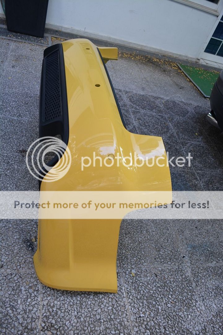

              • I found some time to play with the rear bumper and make it look like I wanted it to look, and make its weight, the weight I need it to have for my needs.
                So, let's see

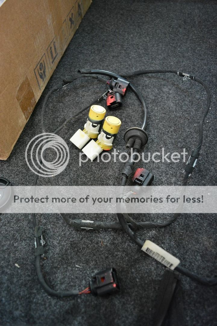

                Removed all the OEM Parking wiring and sensors, these are also for sale if someone wants them
                From this
                To this
                50:50 shot

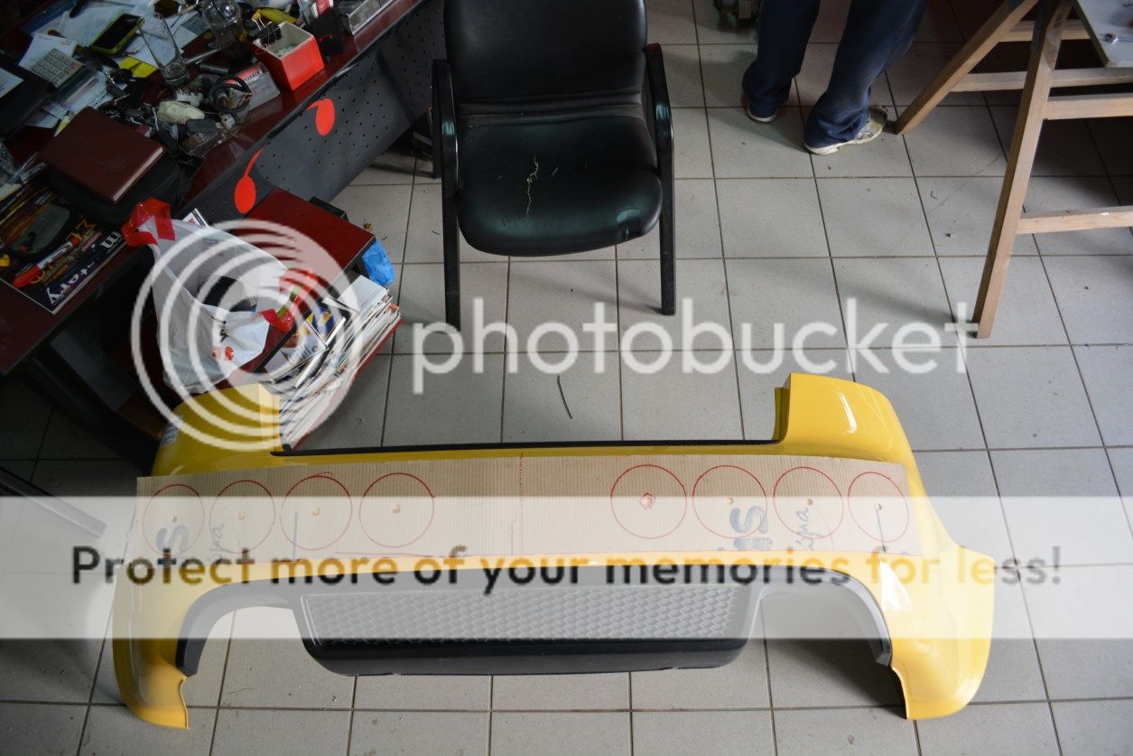

                Time to remove the real weight of the rear bumper
                This big chunk, that weighs almost 5lbs
                Then the game got more interesting . . .

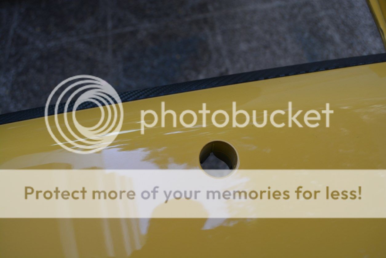

                Made a template
                Measure twice, cut once
                My hand was not shaking one bit - drilling was excellent even though I had the room for error due to the forthcoming paint session
                Then, I took some of these
                Now we are getting somewhere . . .
                Ready
                Lets throw it on the car to see how it looks for a quick snap
                This is when I would smoke a cigarette if I was a smoker
                Cheers for now. I have some more updates coming.
                Stay tuned
                Mike
                Audi RS4PRA | VW Golf MKV GT-Y | Audi A1 SportBack
                • I may sound stupid, so pls forgive me, but why do you make holes in your rear bumper?
                  Lucas
                  Daily: 2004 Pontiac GTO. . . . . . . . . Daily Econobox: 2009 Mini Clubman Cooper
                  Originally posted by LCG
                  High 21! It's like a high 5 but includes both hands, both feet and a boner.
                  • The holes in de rear bumper are to much for me, otherwise great car
                    • Originally posted by loekaaz View Post
                      I believe it's to help the air under the car flow better.
                      R.I.P P.WALKER 2013/11/30
                      • It is to reduce drag caused by the air getting trapped in front of the bumper.

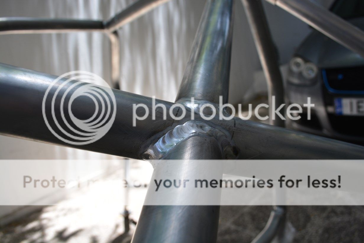

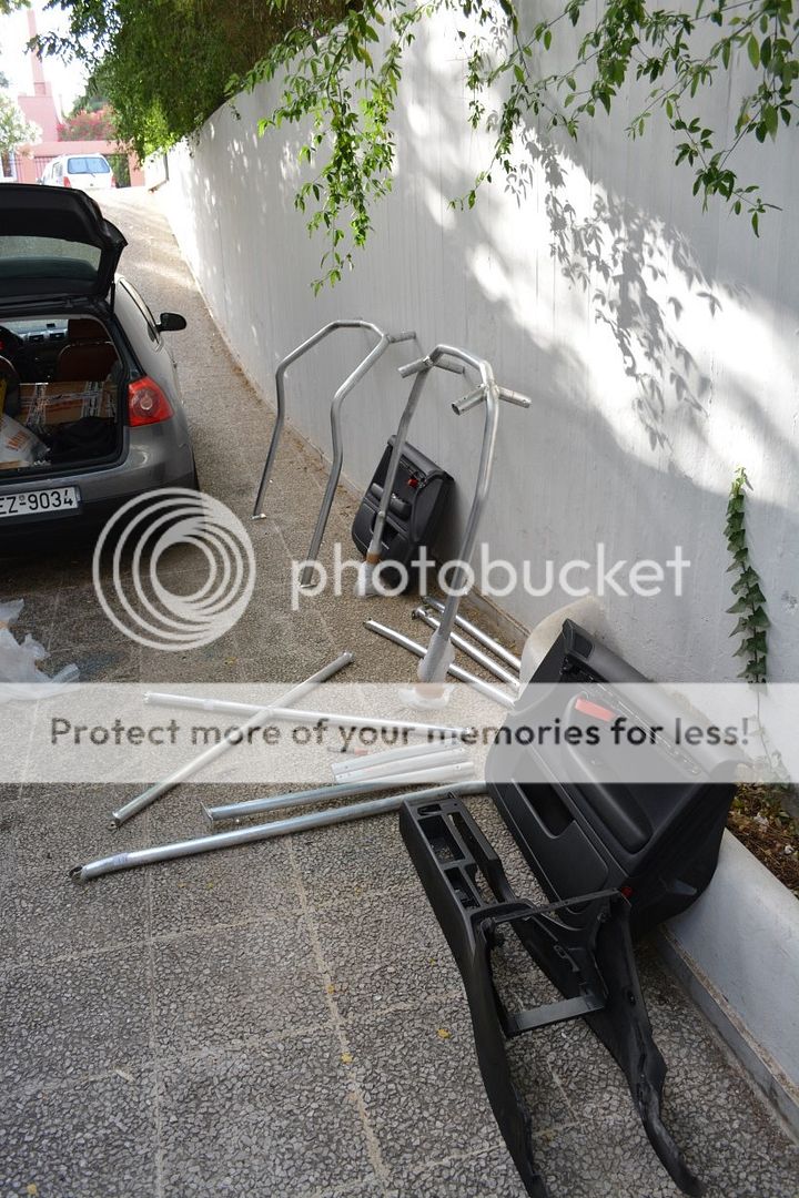

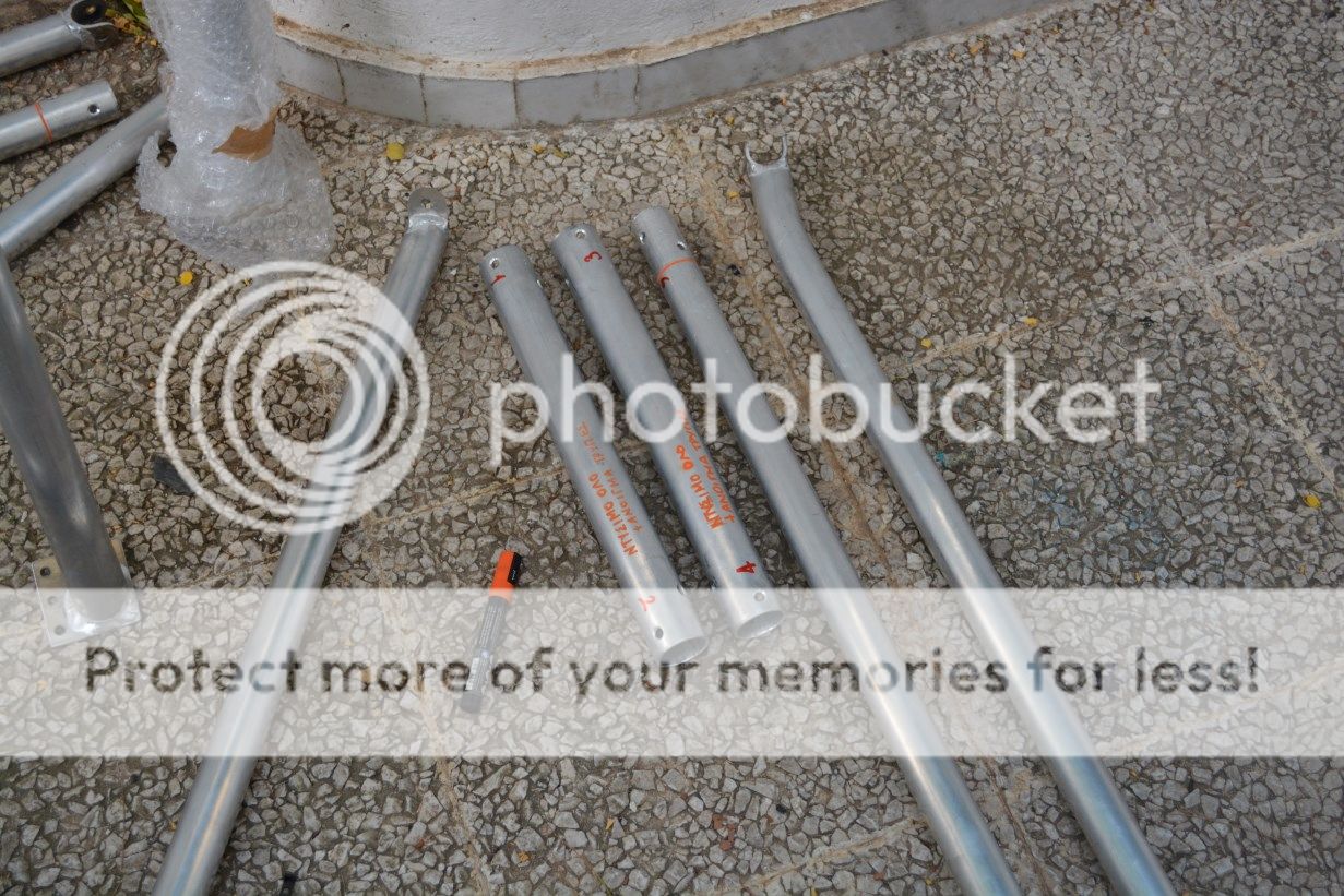

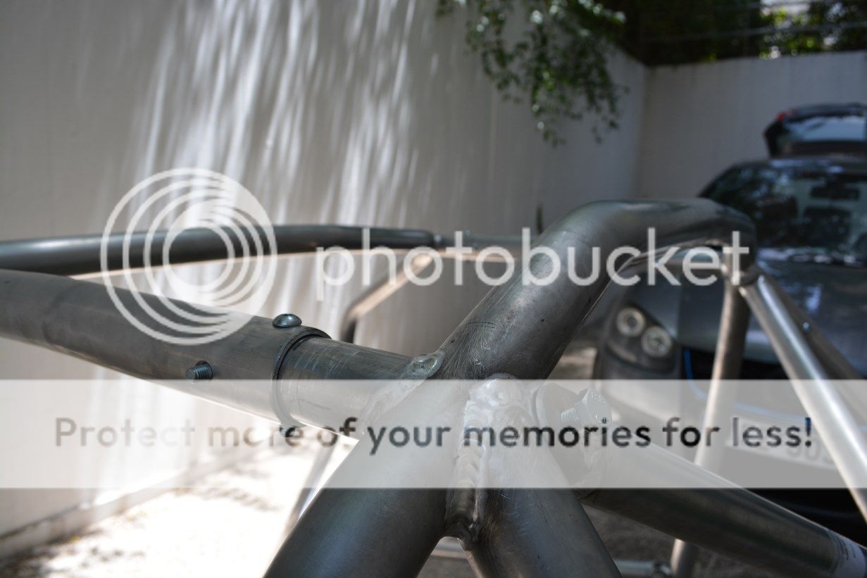

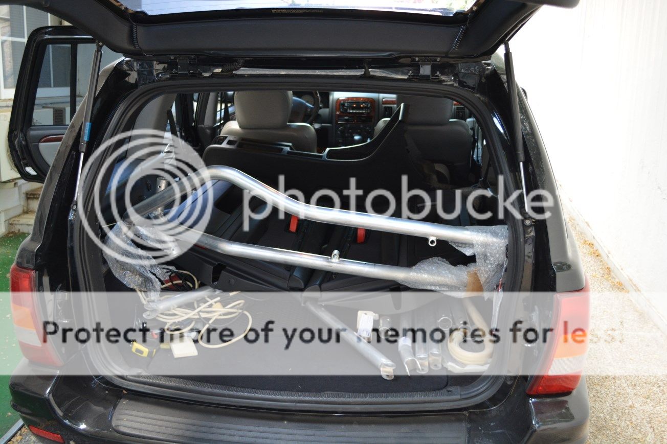

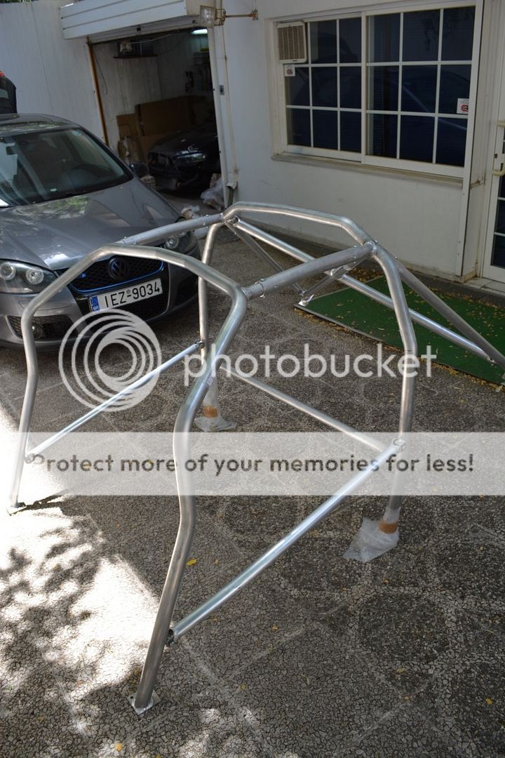

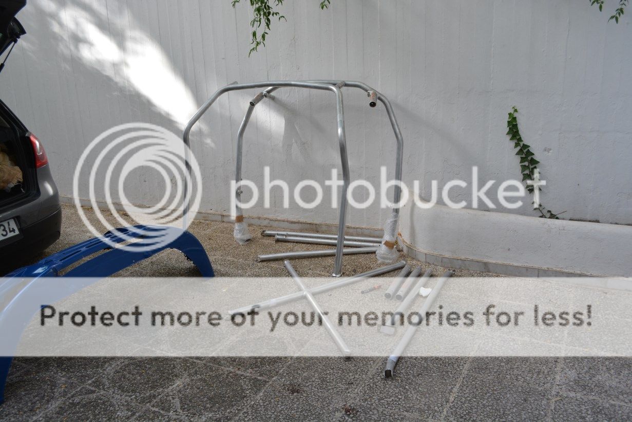

                        • So I have another surprise that showed up today.
                          After a long time, more than two months I think, the cage has finally been made, and sent to me
                          Needless to say I was over the moon when they called me it had arrived.
                          Sadly, it wouldnt fit inside the Golf, so I went there with a nice Grand Cherokee of a good friend, that's what friends are for
                          Tried really hard to not rip the box apart and take some pics of it first
                          This boxed later turned out to have the material/insulation I opted for it to have. But I will not use it at least for now. We shall see later.
                          Lost no time and put everything together to see how it would look . . .
                          Some random shots
                          Raw aluminium just like I picked it, cause I have other plans

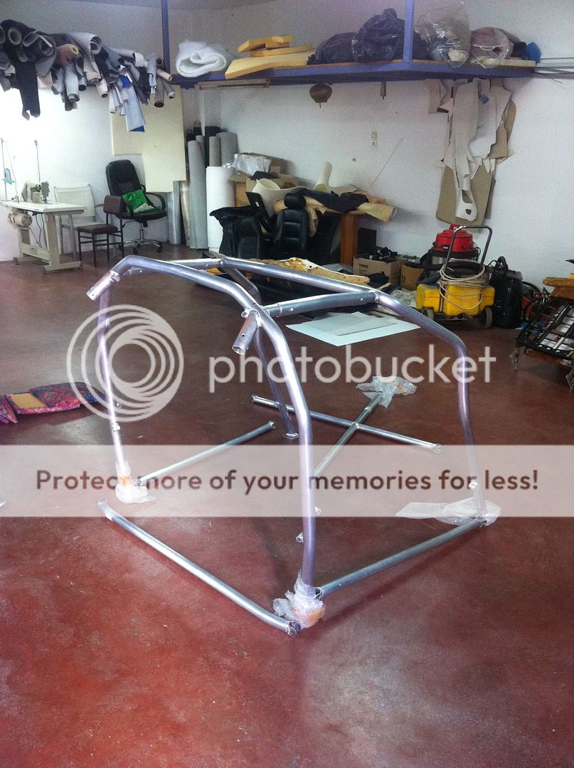

                          Then i turned everything to pieces again
                          And took some notes . . .
                          So as to go to the trim shop that did my dashboard . . .
                          But then some more parts arrived there . . .
                          Hm . . . who knows why . . .
                          More to come

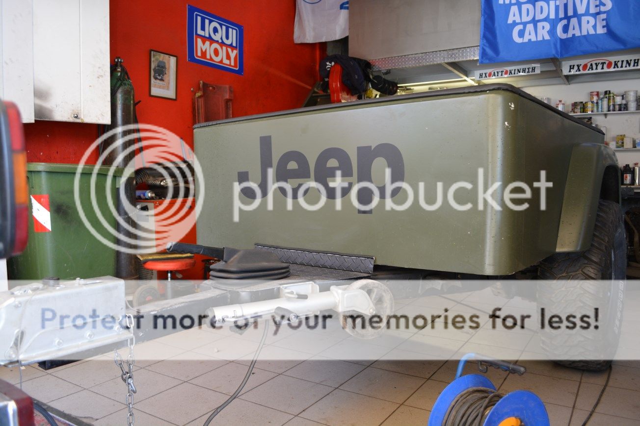

                          • So, I lost no time, and took the cage out for a ride. Not with the Audi however.
                            And these, as well
                            My other option for transportation was this, out of a Wrangler chassis
                            But maybe next time - LoL
                            Here it is in the shop
                            I also left these, for which I have some surprises - hehe

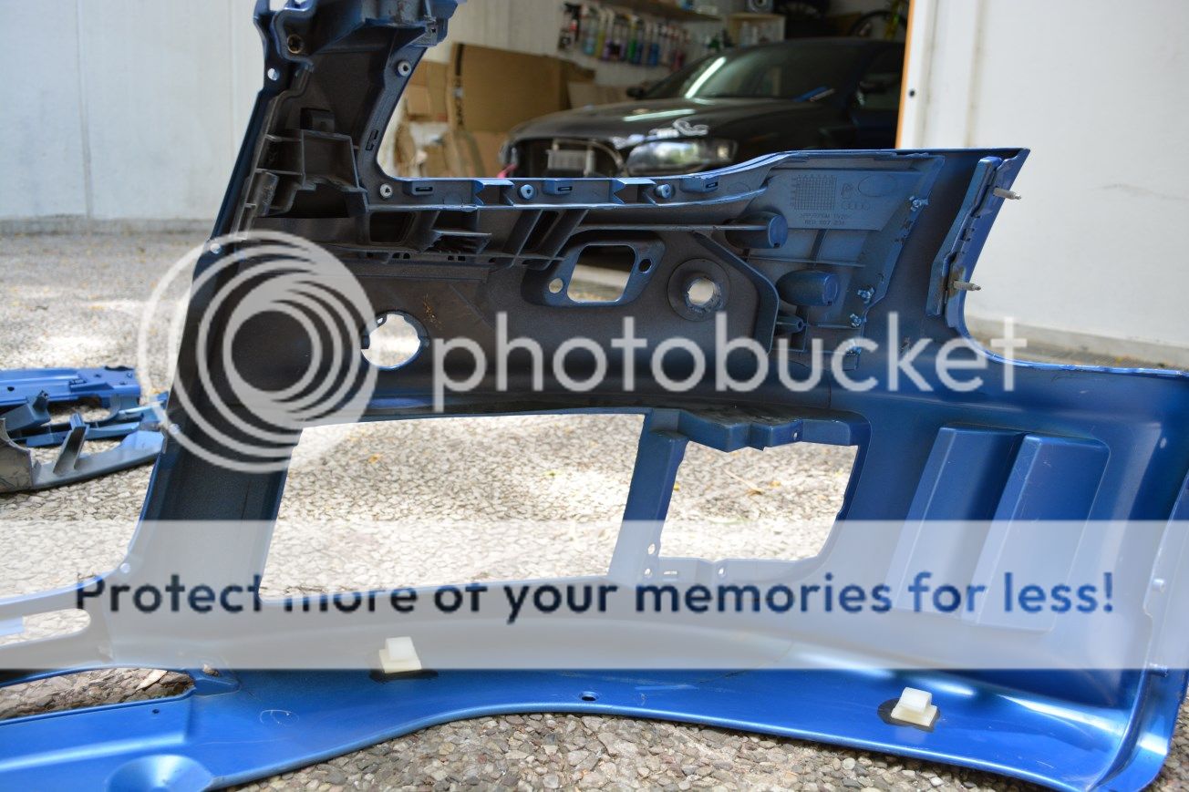

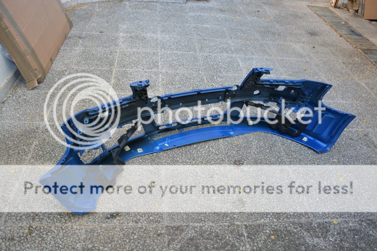

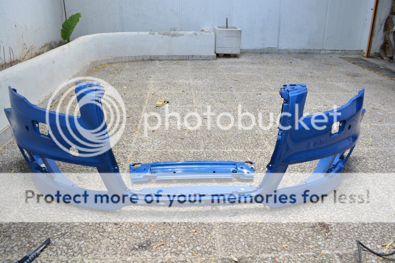

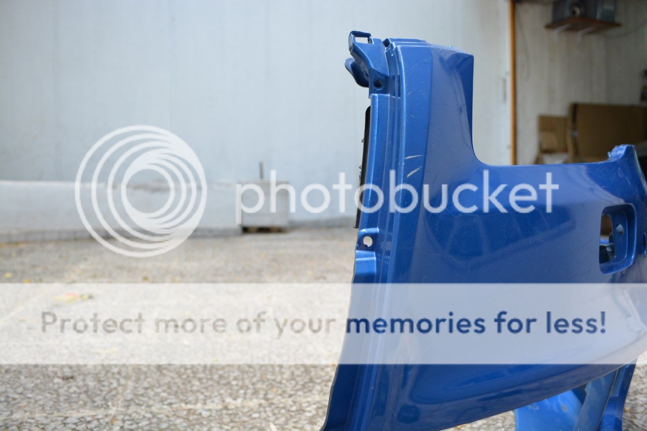

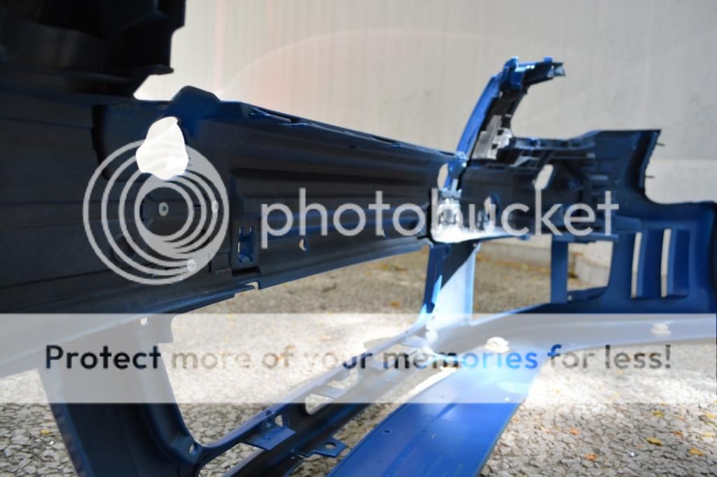

                            Now, I did some work on the front bumper, preparing it for the next week.
                            If all goes well, given the new things from stealership arrive in time, I will start the efforts of mounting everything in the front end.
                            Here is what I did

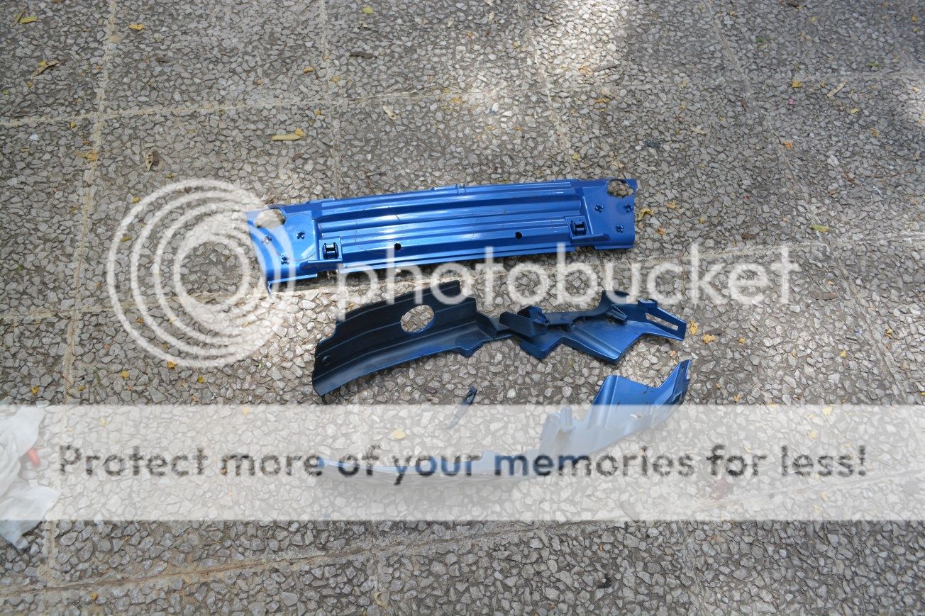

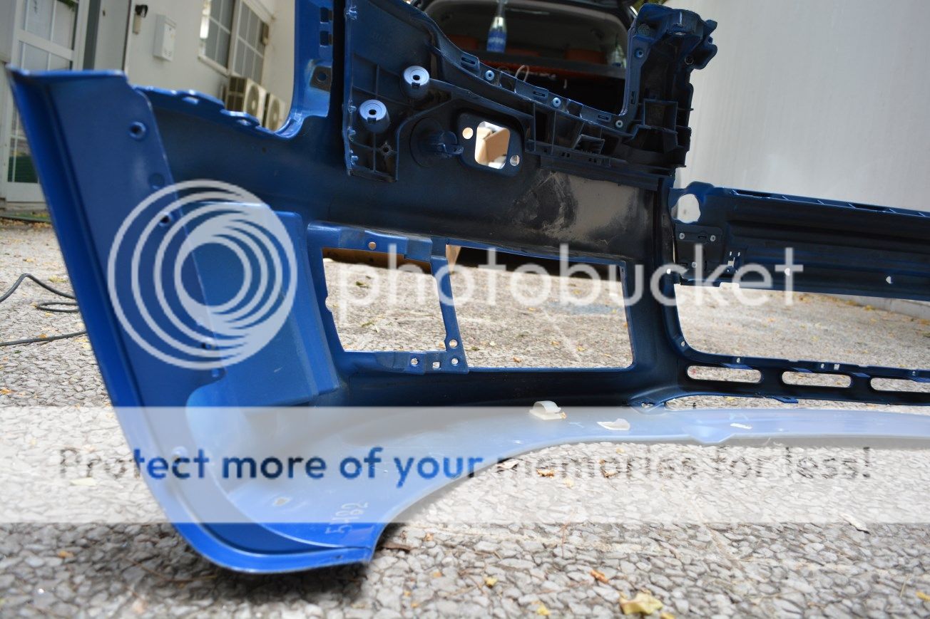

                            The bumper I sourced, came with these two parts fitted - the ones in black, partially removed.
                            I was ready to order those again, but last minute, I luckily thought I already had them, so cancelled their order. What is more, I dont need them, so I would have two pairs for nothing. Here they are removed

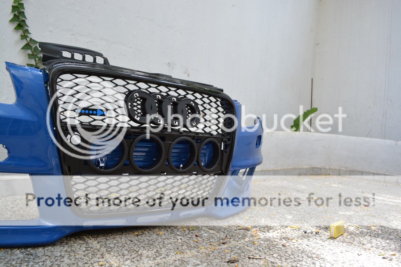

                            Then, it was time to throw the grille onto the bumper for the first time to see how it will look

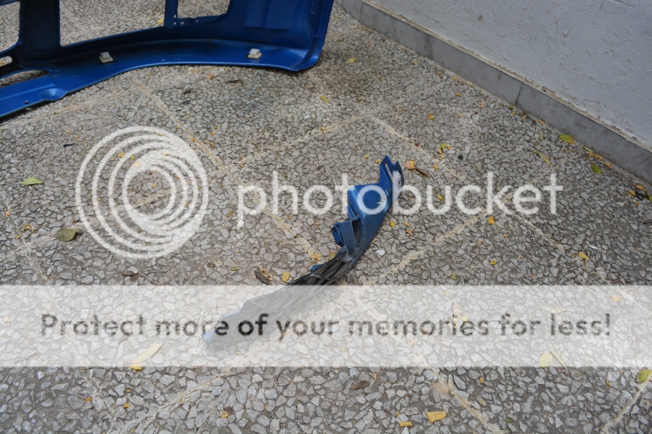

                            Can you spot which part will be cut off ?
                            Easy I guess
                            Front view
                            Rear view
                            Bye bye
                            Again as I said in the past, a heatgun and a paper-knife, works wonders in plastic, and gives you the ability to cut perfectly, and have no trimming work to do afterwards
                            I then installed the fog light grilles so as to see if I could remove some more weight off the bumper
                            Seems like this part is not needed for me
                            Before
                            and after
                            this goes away
                            Same thing from the other side
                            So these can go to the bin -well okay to my storage room, cause I dont like to throw away things
                            So bumper came out cleaner and lighter
                            And threw it next to the car, just to see how it would look . . .
                            Cant wait to find time for more work
                            Cheers everyone
                            Mike
