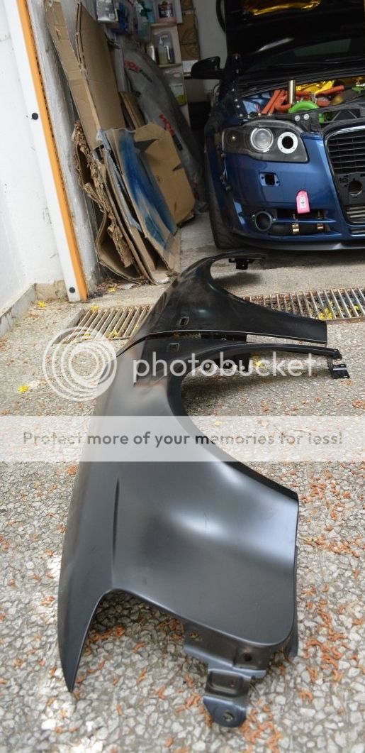

    Had been thinking for some time this project- of going RS4 wide, and thought I'd make a start. There is no hurry. Just gathering parts when there is the chance. It is not a cheap project by any means, so I will take my time on this one.
    Here is what RS4 wide means
    So, these are the said oem fenders, brand new

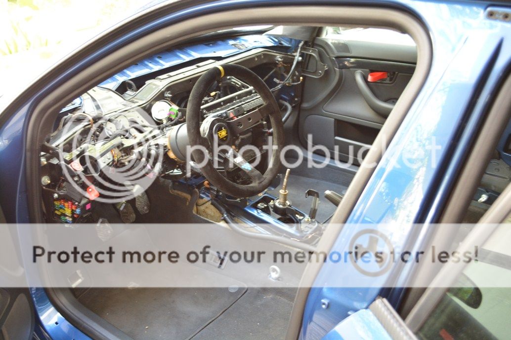

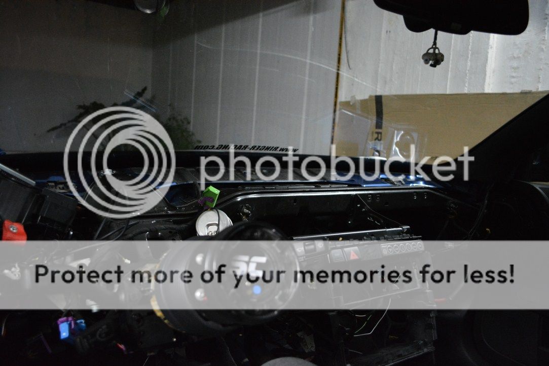

    • So, I had some plans to remove some more weight as I said before. Sat this evening, late after work to get some work done.
      My machinist friend was also there to help, hello Thanos

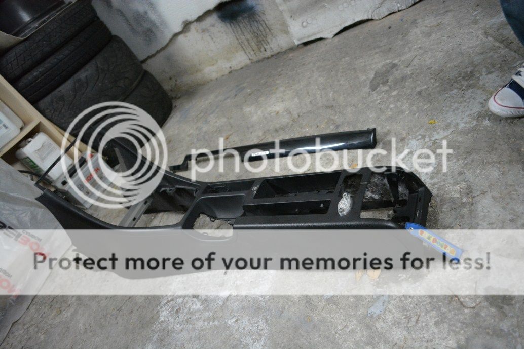

      Started by quickly removing the interior trim
      Centel console
      Pics show the progress . . .

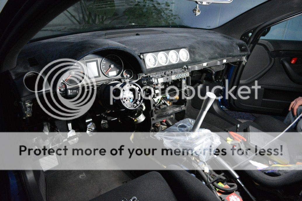

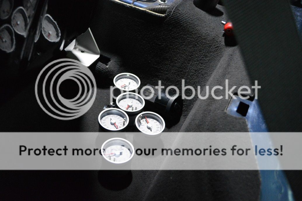

      Out goes the beautiful dash to get out of the way, to give access for more work
      Hmmmm seems familiar

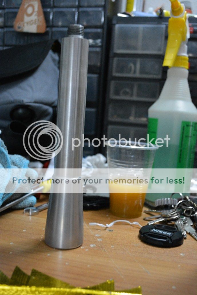

      The custom shift knob also went out
      Removed miscellanious stuff to gain access for the Heat matrix to be removed
      But no luck. It was hard. I mean frustrating hard.
      But . . .
      It came out, leaving this
      I also had to remove some pipes from here, and now have to make a connection between them, to make a closed circuit again
      And also have to seal this
      I love my work bench a bit more tonight
      All in all, a very difficult project if one wants to remove it without braking pieces. Glad we took our time, well worth it.

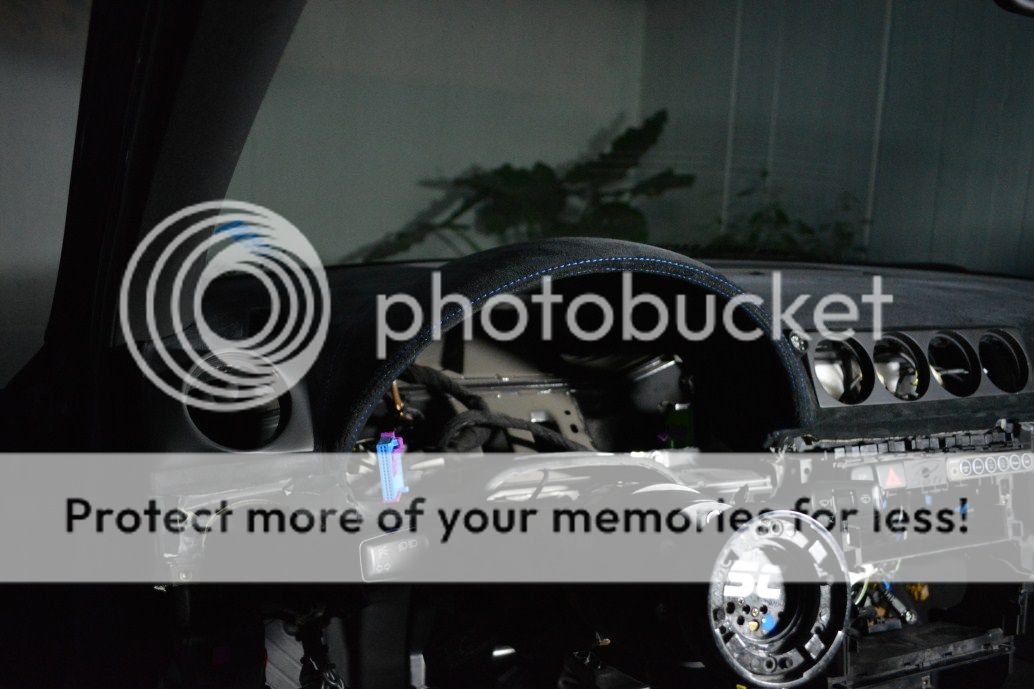

      • Did some more work when I had the chance, mostly removed all the firewall insulation, which is very thick and very heavy considering what it is.
        Leaving me with this
        If I am to face heat problems, I can go gold tape on the engine side, which I intended to either way at some point.
        Still lots of tar, and insulation to remove, prior to installing the dash back on
        What is more, I was thinking of not doing it, until cage was here . . . we shall see.

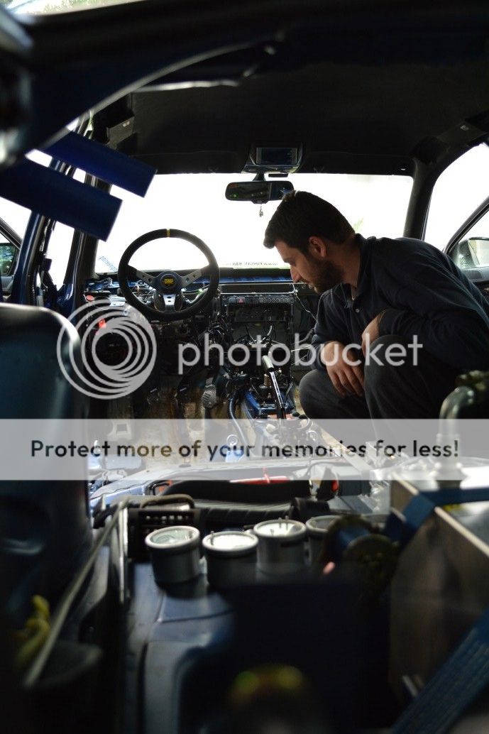

        • So found some time today to do some more work on the interior.
          Talked with Wiechers and they said that the cage will be ready in about 2-3 weeks. So I have plenty of time for some more things I want to do.
          Removed the seats first, both of them
          And then removed the carpet as well.

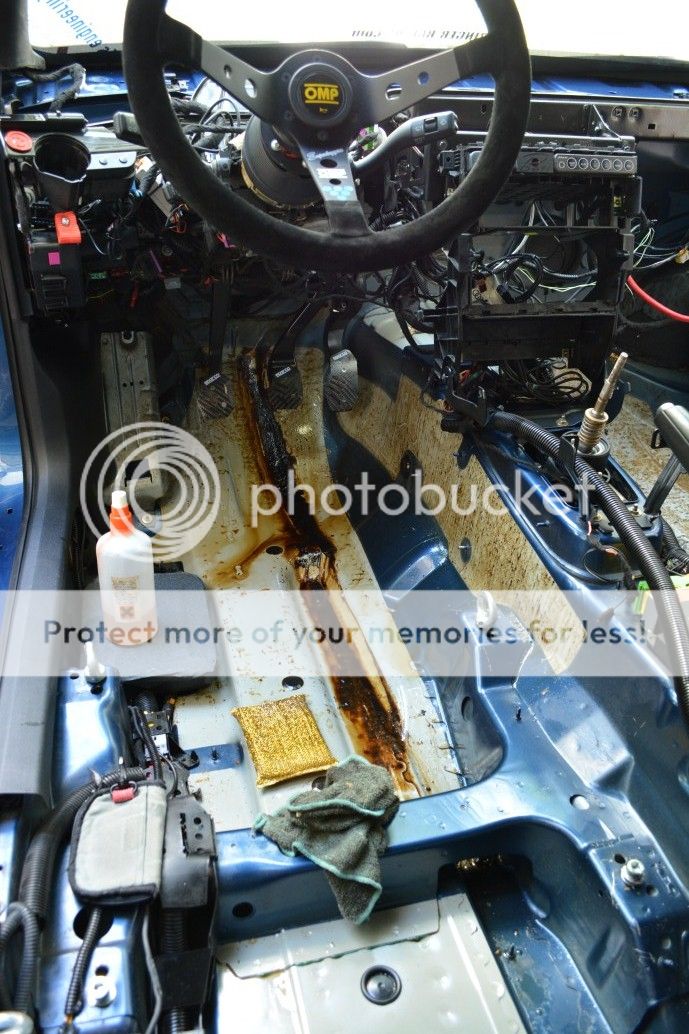

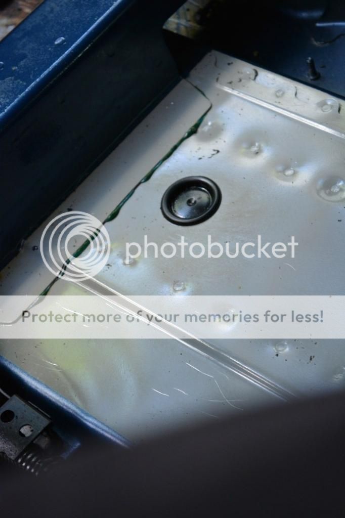

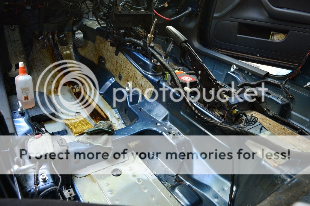

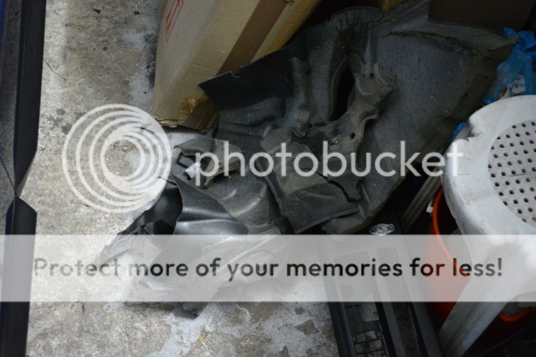

          Having removed the OEM tar sheets for the last race, I was faced with their remaining bits, that back then I had not the time to remove them.
          It was ugly. Really ugly.
          Then, came this. Chemical Guys Tarminator. An awesome product, yet again to the rescue
          Doing its work
          Two passes, and . . .
          Driver's side
          Dwell
          Another pass
          Getting somewhere
          Another before
          During
          And almost done
          There is a a line as you can see, where there is super strong glue, and I didnt want to go for that, although Kostas that was helping me not only with photos but with tar too, wanted to take that off too.
          Here is a kinda 50:50
          Then kept on the passenger's side too, and almost finished it. Ran out of tarminator sadly, so kept going with pump gas - lol.

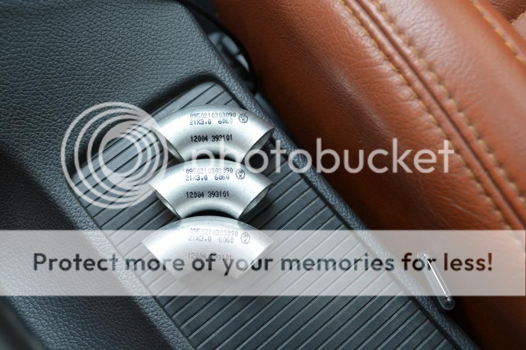

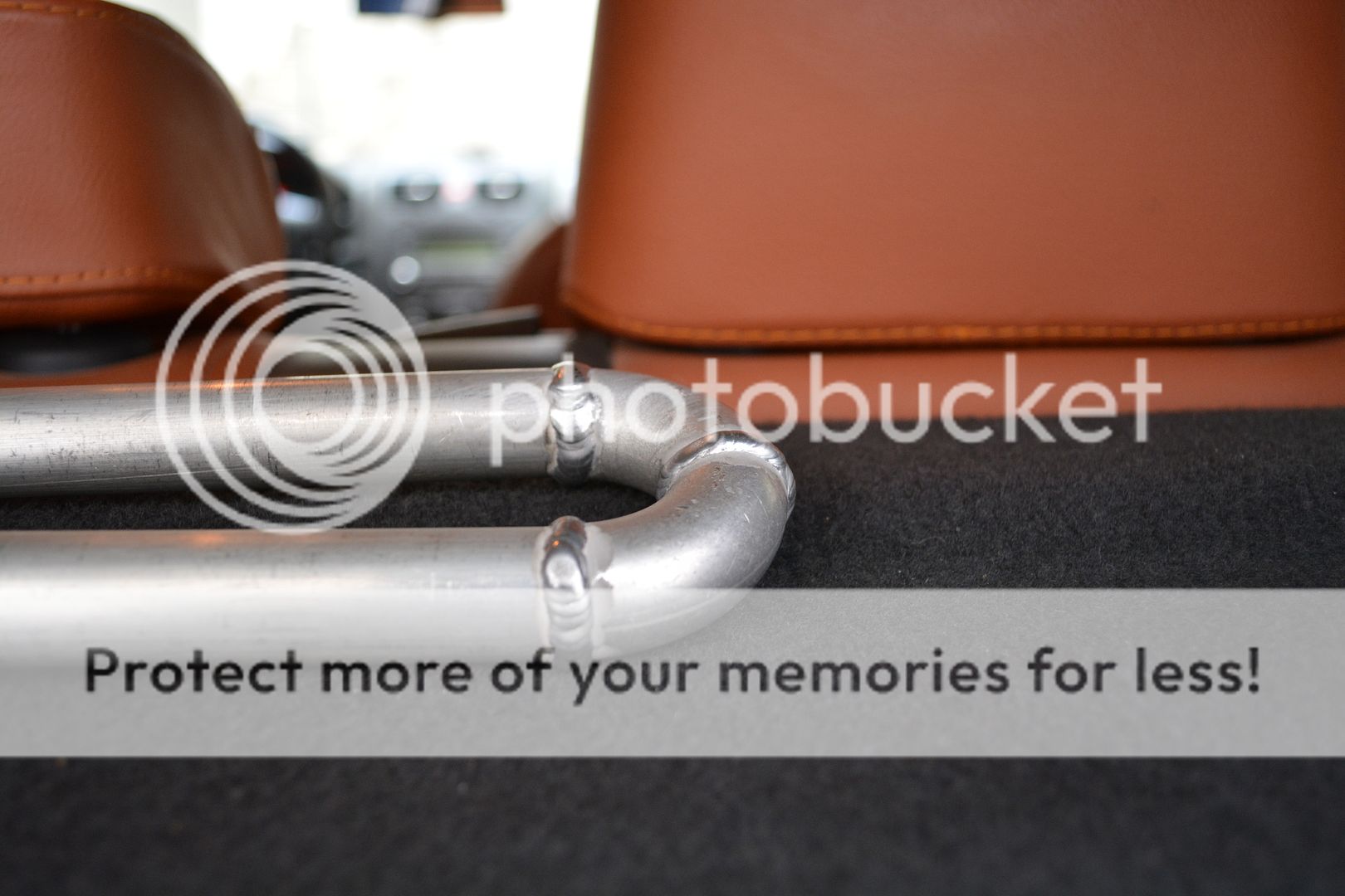

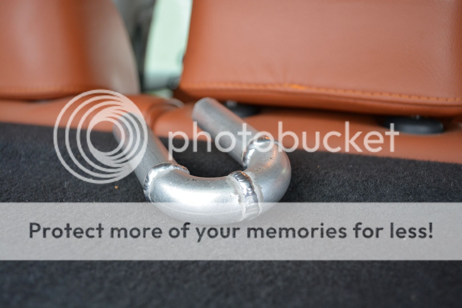

          • Another issue on my to do list, was to do something about the coolant hoses going to the heater radiator inside the cabin.
            At first my friend Thanos machined some end caps as shown before
            However I left this idea, and went for a "U" joint of the two hoses
            bought some of these
            And some straight aluminum pipe of the same diameter, and then, came this
            Left it pretty huge, to cut it to my needs aftewards
            measure twice, cut once
            Removed the previously installed end caps
            New T-Clamps
            Came out great I think
            Cheers

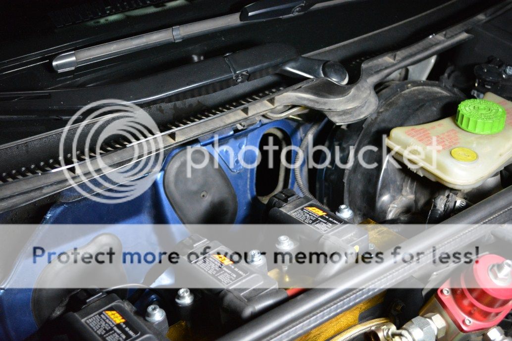

                        • So, after the AC Removal in the past, and the Heater Unit removal lately, there were some holes in the firewall, that needed some attention.
                          Made a template with carton
                          Thought about aluminium, either painted of wrapped, however I thought another alternative that would be fun
                          Used this to avoid any leaks, awesome product for oem quality work
                          yeap, it's plexiglass alright
                          Then continued to the second spot, which was harder
                          Again, carton template
                          Plexiglass first mock-up
                          And secured in place
                          Inside
                          Engine Side
                          Then, the place from where the coolant lines for the heater went inside the cabin.
                          Rubber seal
                          Plexiglass delete
                          Secured in place
                          All done
