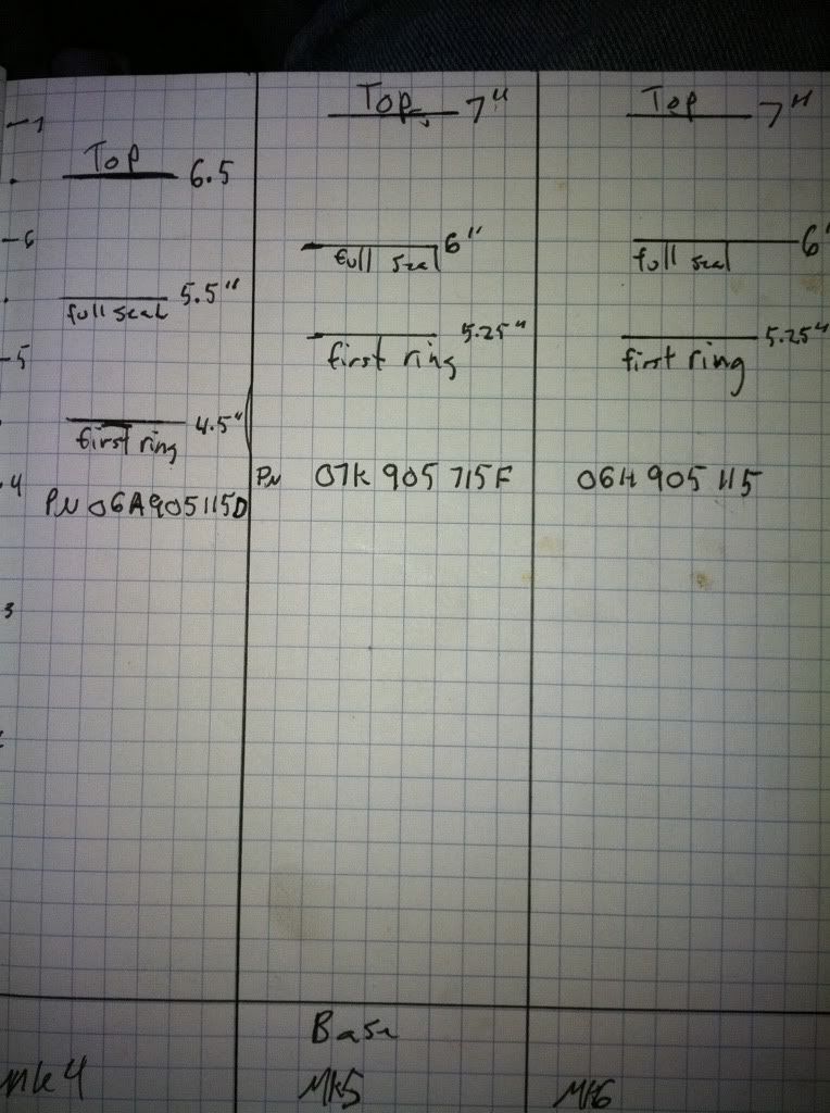

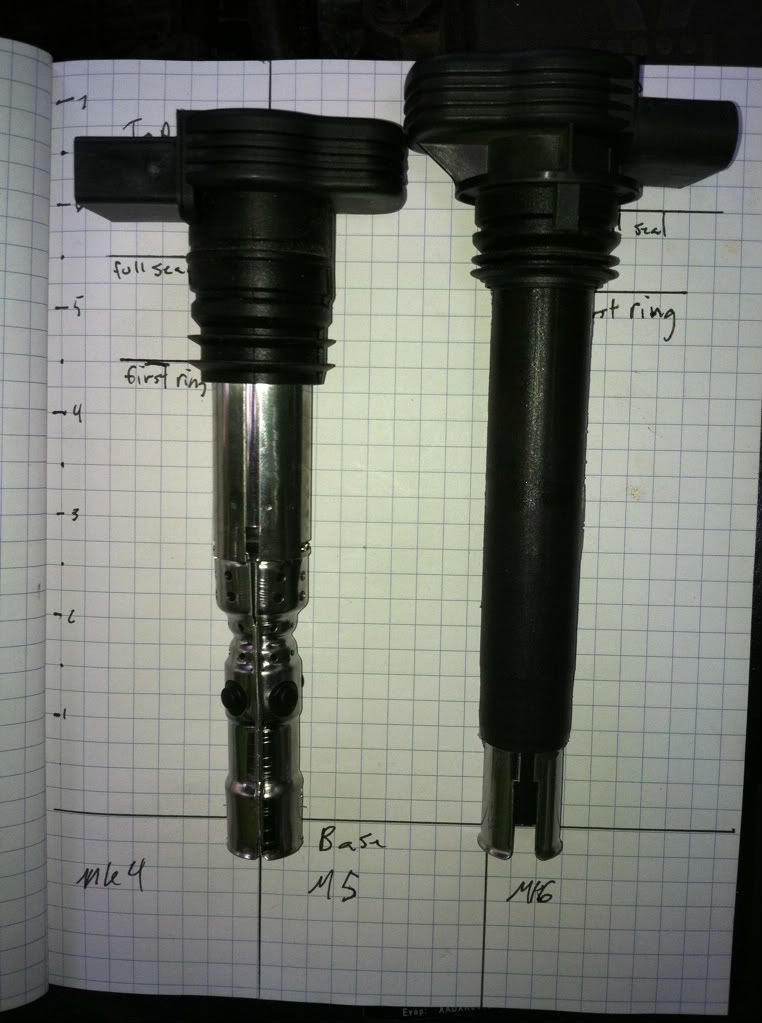

2x 1J0971658L - 1.8t coil pack harness - cheaper than buying the 4 pin connectors by themselves

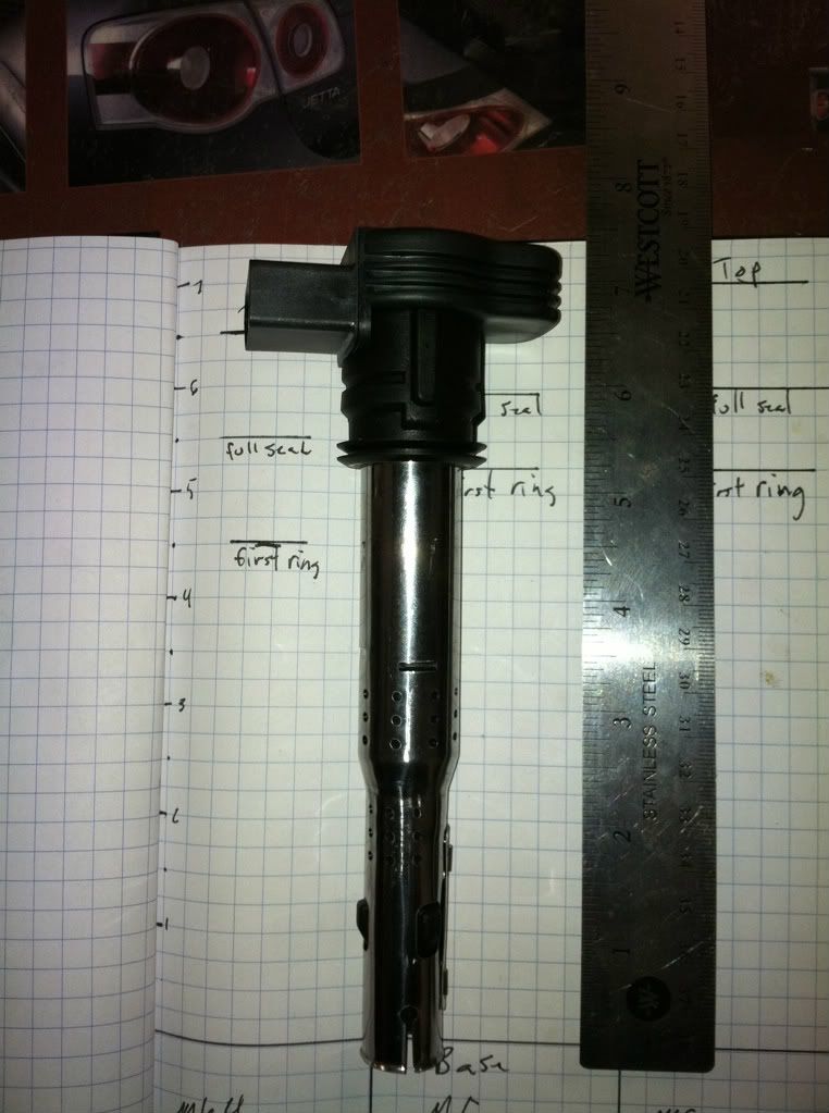

8x 06H905115 - 2.0TFSI coil packs - longer than 1.8t coil and produce higher voltage output
already waiting at the dealer
8x 03H971921A - .:R36 4pin protective caps
so i tried 2.8, 3.2, and 3.6 24v vr6 coil packs...all way too short.

1.8t one installed

turns out the fsi stuff has a higher voltage output than 1.8t and the 1.8t guys are upping the plug gaps to .040 from .028
