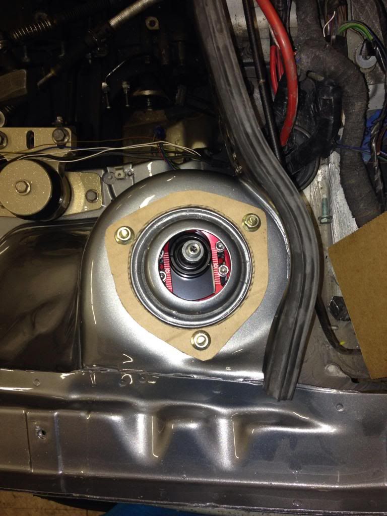

          Also got around to putting the new Airlift Performance struts in tonight, and a super big :thumbdown: to Airlift for the fact that you have to drill new holes to install them. I ended up just making 2 of the 3 original holes larger, and drilling one new hole in my freshly painted bay
          But paired with the IDF LCA's I'm getting -2.4* of camber at the front wheels. I think I found the limit for wheels up front with these struts too. My CCW LM5T's are 9" up front ET25 and are about 2-3mm away from the strut at full compression, and about 5-7mm away at full droop. I mocked a fender up with the wheel on there and it definitely tucks up behind the fender really well. Would be easy to fit another half inch on the lip and it would sit just like my rears do. ****ing pumped for that look.
          Made a quick template to hide the old bolt holes from my slam series struts tonight too. Hopefully going to have Matt at Haggard Fab make a few up, so if you're running into the same issues as me with these struts, give him a shout and he'll set ya up with some of these, only made out of metal not cardboard lol.
