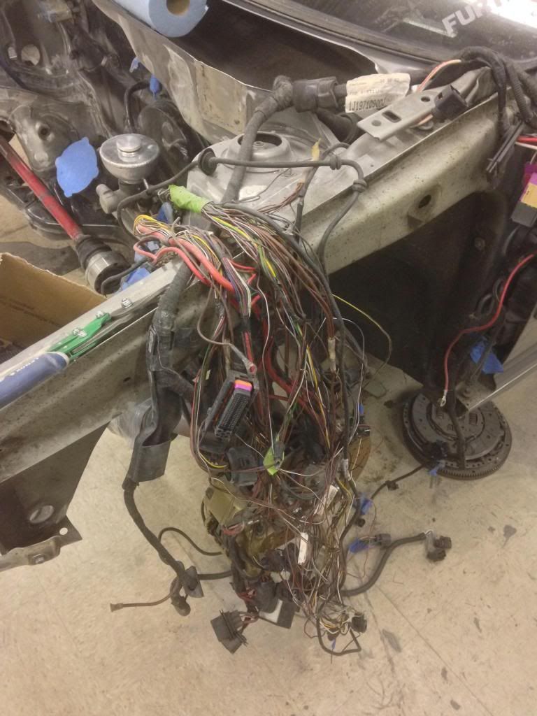

          Well, after having a go at some of the filler work I've decided to leave it to the professionals. I just don't trust my work enough to believe it won't crack, or fcuk up over time. The car will be going to the same shop that resprayed the car last year. It's called Autoworks, and they're more of an insurance shop, but they're small and independent and have done MANY VW's in the past. They actually just finished a buddy's car, and had about 300 hours of work alone in the engine bay. His car is going to set the bar in the MK5 game. It's bananas.
          Anyhoo, that won't be for a couple weeks so I'm trying my best to finish the harness work with some help from a buddy who ironically hates MK4's, but has done about 4 harness tucks in them lol, and get the motor in to at least mock it up and get everything set so it's basically plug and play once the car gets back from the shop.

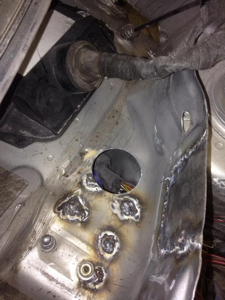

          Got the harness unwrapped and a few of the unnecessary wires chopped out. I then welded up the rain tray where the waterfall used to pass through on both sides, then hole-sawed a couple 2" holes in the tray for the harness.
          And the current state of the harness.. Yikes.

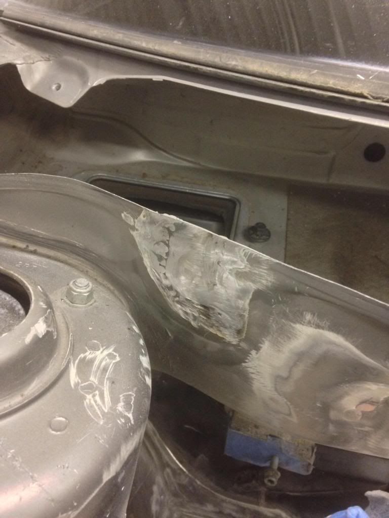

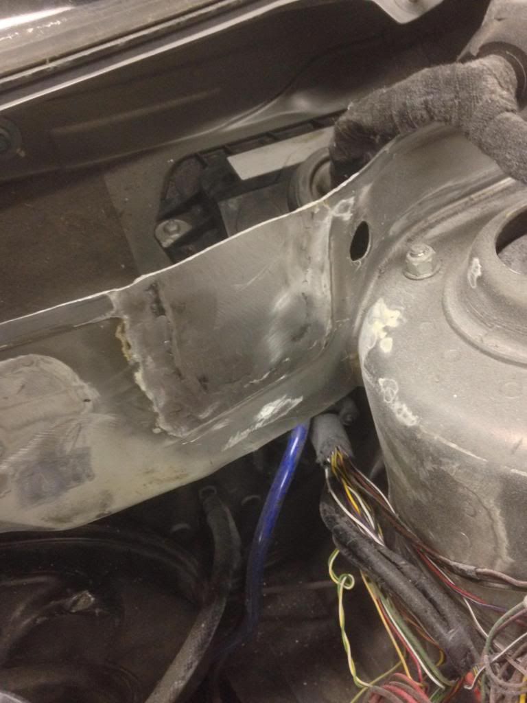

                Haven't updated this thread for a bit, but I started with some filler and decided that I'm going to leave that up to the pros.. Gonna send it off to the same shop that resprayed the car last year on Monday.
                Integrated engineering took more of my money tonight.. Oh joy. Billet fuel rail and some other goodies.
                Basically the whole chassis side of the harness is complete aside from routing it through the frame rail, which we actually did but pulled it back through so the shop has more access to the area. I still need to button things up %100 in the rain tray, but that won't take long. Everything is routed where it should and it only took 3 days of working on it.. Record time? Mayhaps?
                Same kid who's helping me with all the wiring will be taking my engine harness and bringing it back to me all wrapped in tech flex. That should be nice.

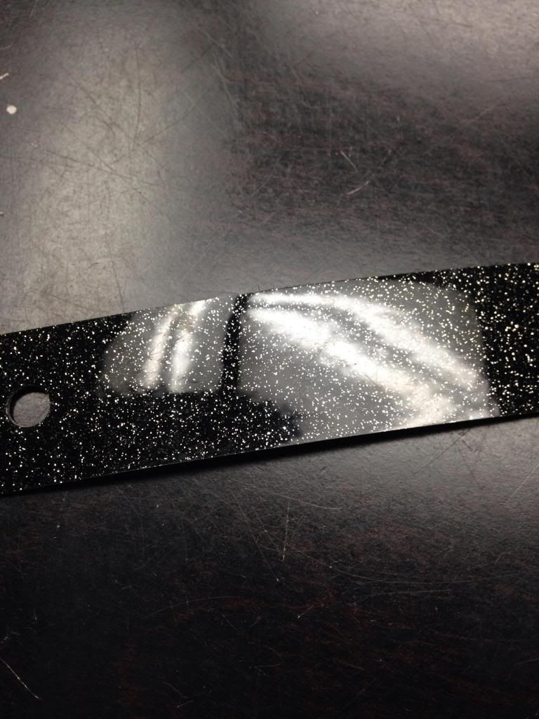

                      BUT I finally got a hold of Jeff at United Motorsport about turbo size and fueling, so that's all set. Going to go with 870cc's and a PTE5858. Apparently that's good for 450whp with the 2.1L stroker. I can live with that. LOL.
                      Dropped some stuff off at the powdercoater today. I have a video of the color swatch posted on my Instagram, but here's a picture of it for now. The reflectivity in the metallic is absolutely bananas. The base coat isn't going to be black, but more of a pewter/titanium color.

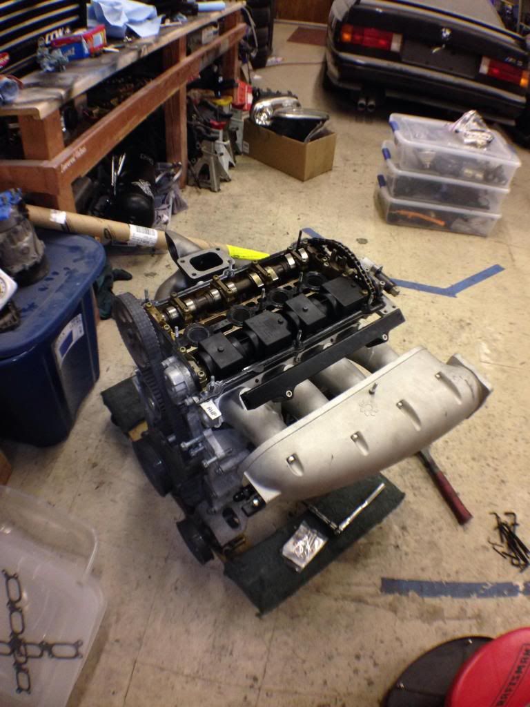

                      Then for ****s and giggles I bolted up the CTS manifold, IE manifold and fuel rail on my old motor cuz I was bored. Hopefully I'll have a turbo to bolt to the EM shortly
