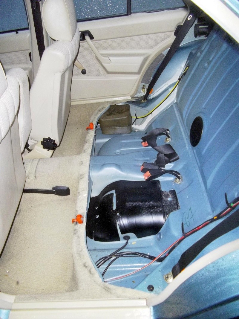

  • RENAUD
    replied
    that was today
    airlines... for the rear airbags and for the ouline that release pressure from bags
    to do all this, it was easier with removing the exhaust.. that I replaced
    intermédiate, silencer, fittings, silent blocs and even exhaust paste, all this for 100€ with shipping... thank's e-bay lol
    before
    after

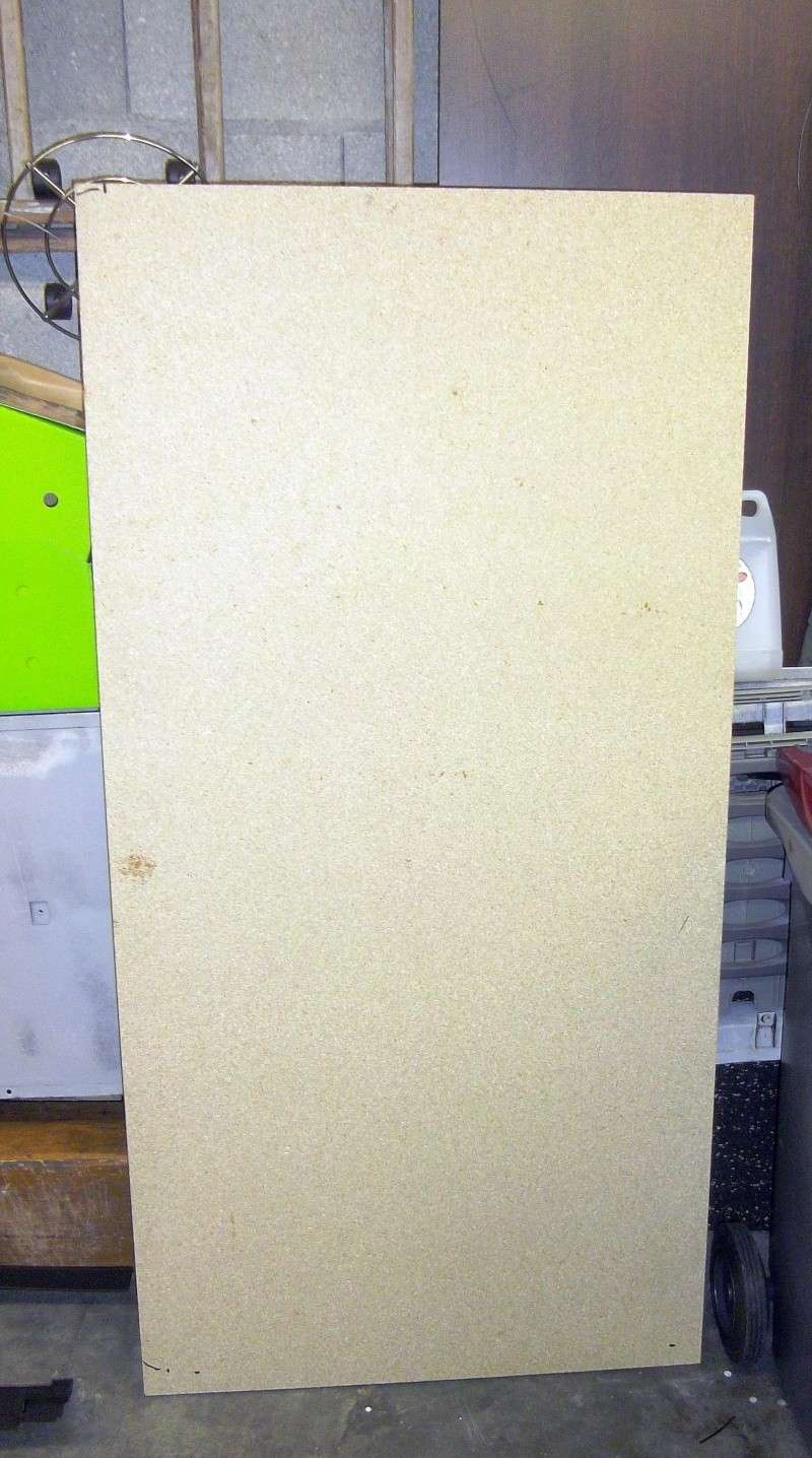

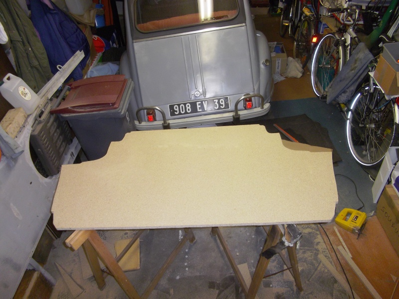

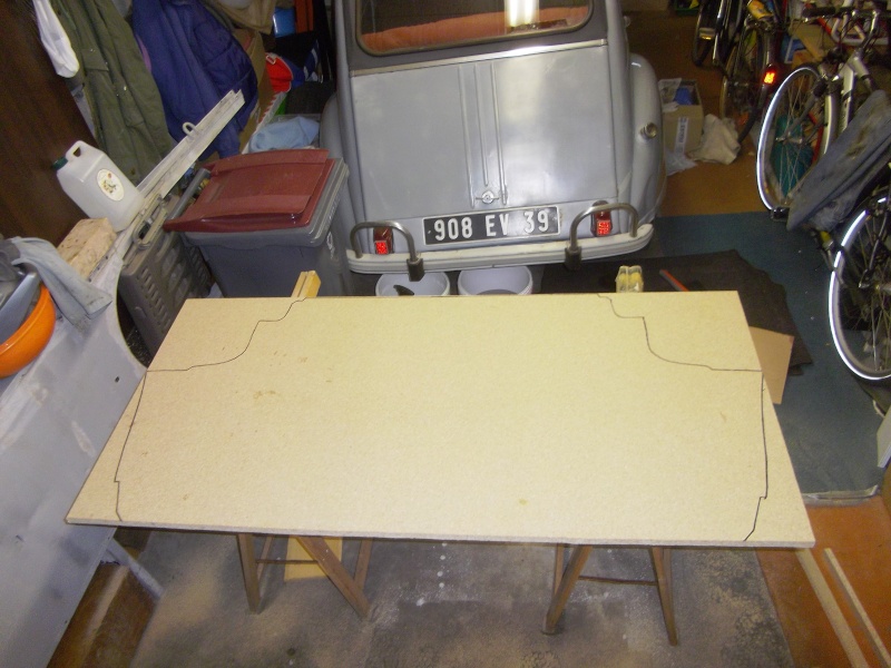

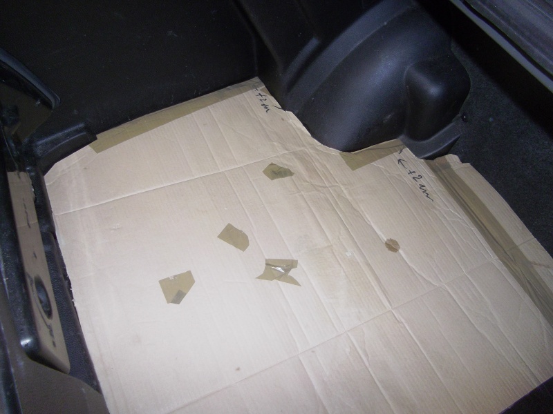

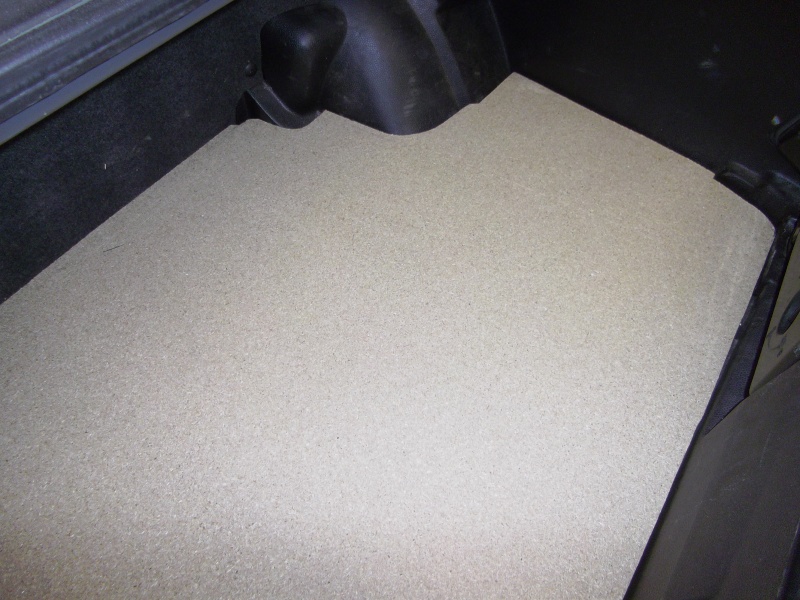

    Wanted to make go the airlines everywhere this afternoun... but with the rain impossible to work outside... so I made the false floor for the trunk
    a nice piece of 80 x 160 cm
    moke up the good shape with cardboard... and a lot of pain
    right side is symetrical, put the shape on the wood cutted to 76,5 x 176,5 cm :
    hop

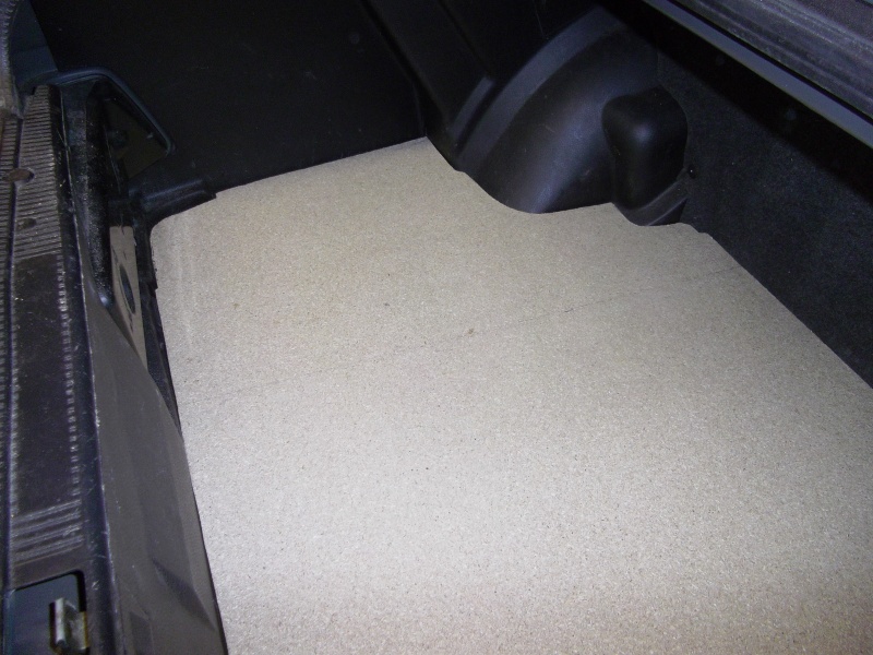

    great!... but it doesn't go into the trunk in one piece lol, had to cut it in 2 pieces
    but once installed happy with the result
    just to definitely attach the 5cm spacers between trunk floor and woodfloor and done...
    Leave a comment:

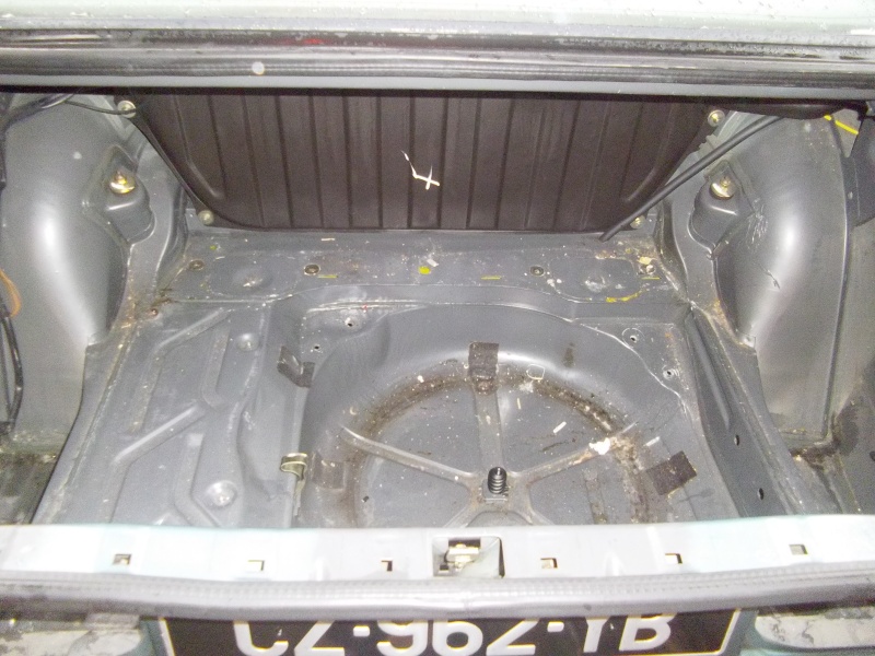

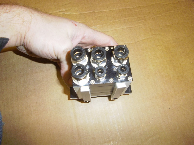

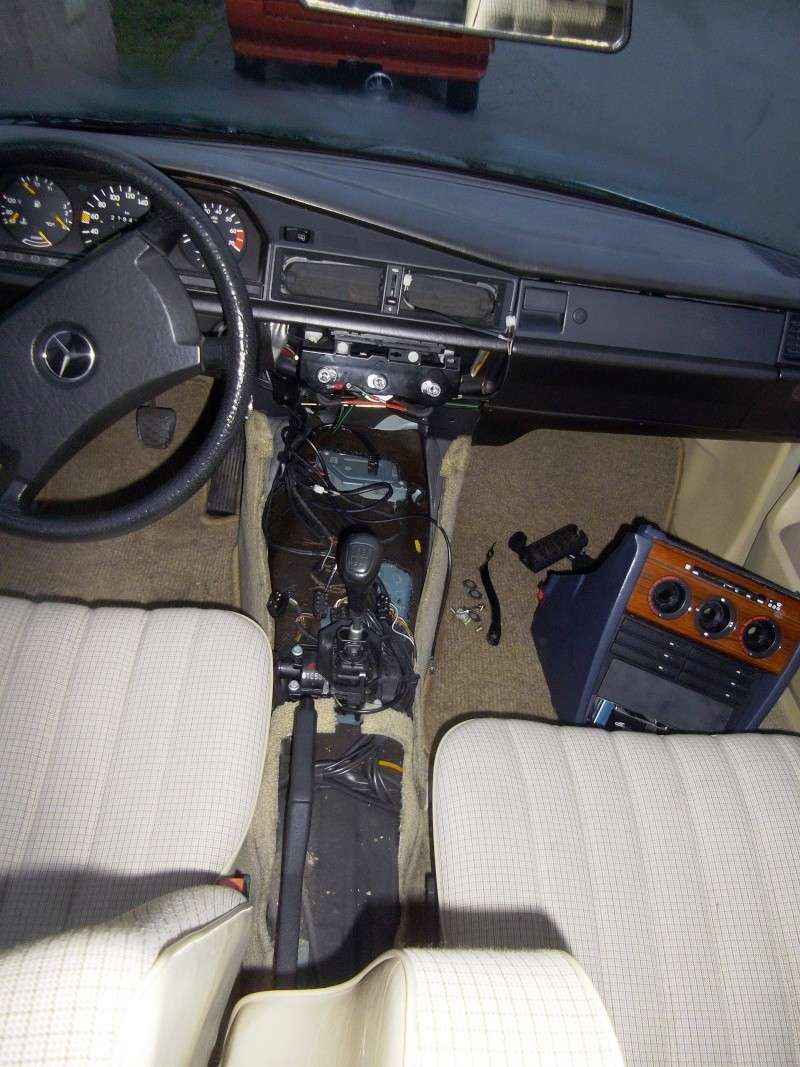

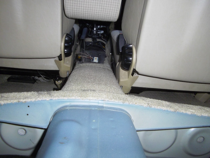

    nothing crazy but a bit of an effort...
    dismantled the interior, carpet, rear seat, trunk panels...
    all this to decide where to go with airlines

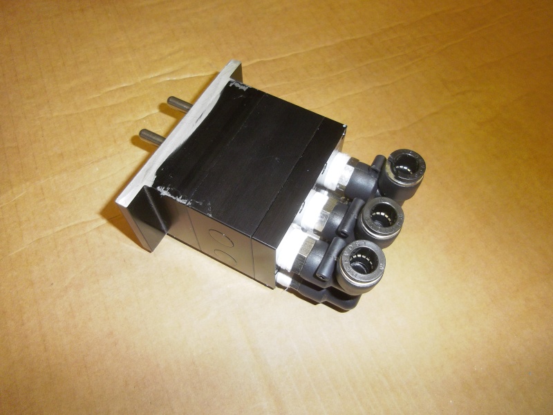

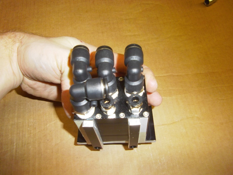

    I realised that i need to change 4 fittings on the paddle box, because of the lack of space :
    next is making 3 holes in the transmission tunnel
    airlines will go along transmission tunnel and then follow brake lines
    that's it for the moment
