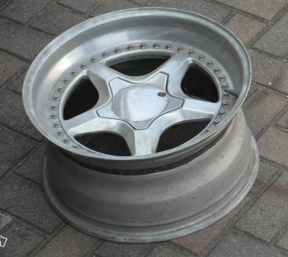

    and have maybe a chance to buy a set of cheap "eclair" wheels
    here are the pics :
    but with a bit of care it can turn really great i fink :

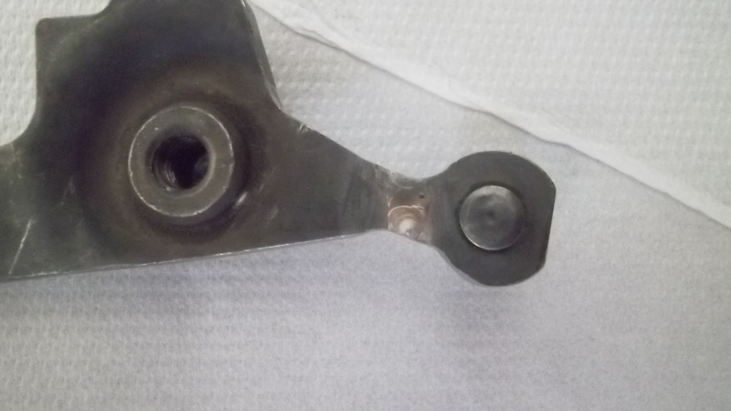

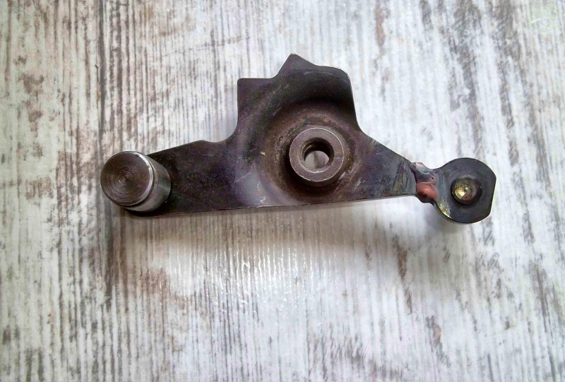

  • RENAUD
    replied

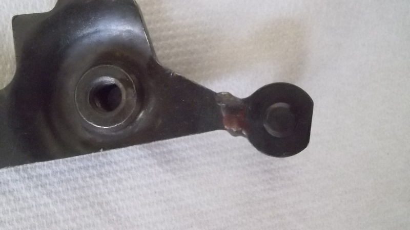

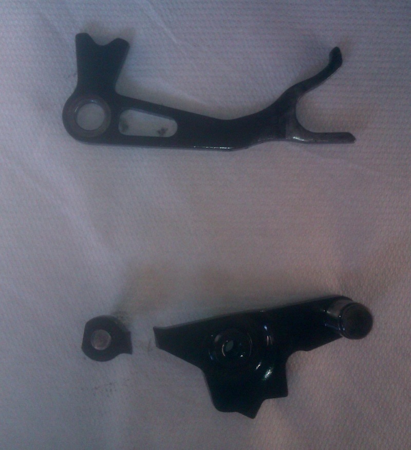

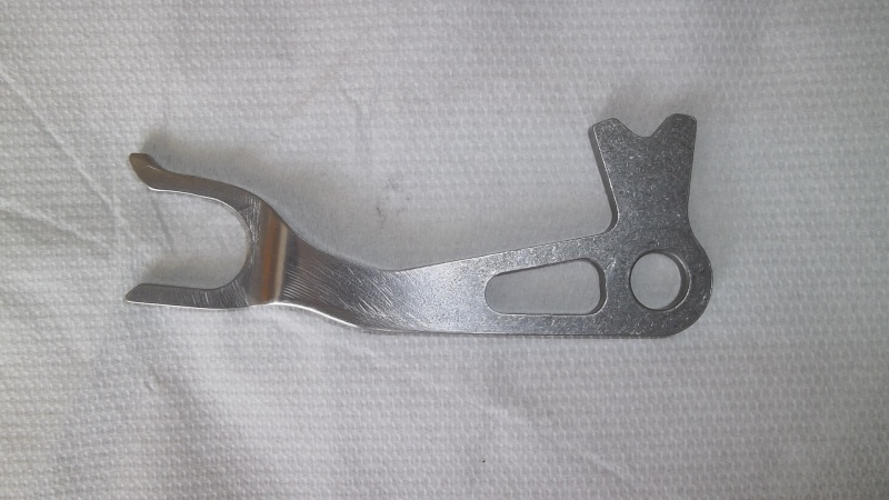

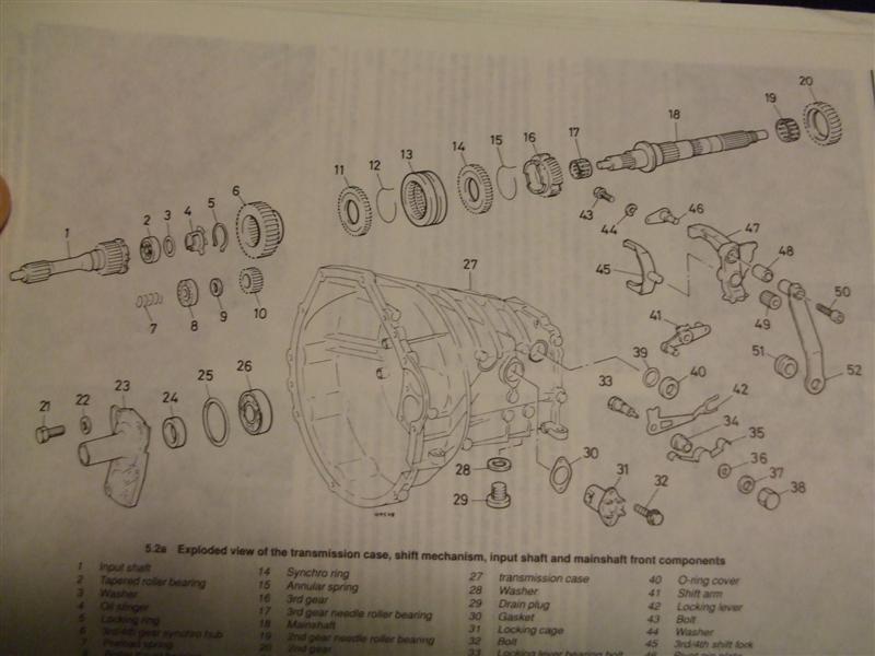

    really not the good shape as here:

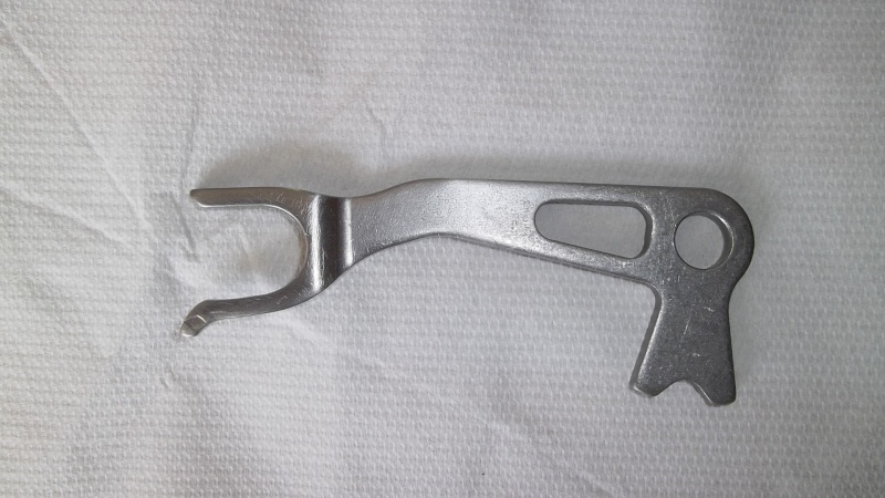

    (pièce 42)
    repaired it
    before
    after
    in place
    the welded piece also need some modification
    before
    after
    and then it worked like it should!
    so... now I need to dismantle it again to clean and to change all the gaskets...

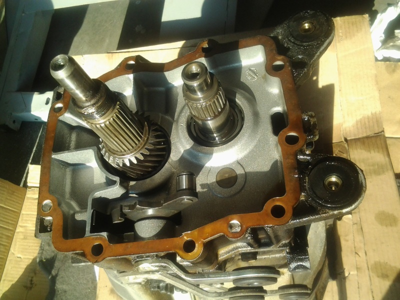

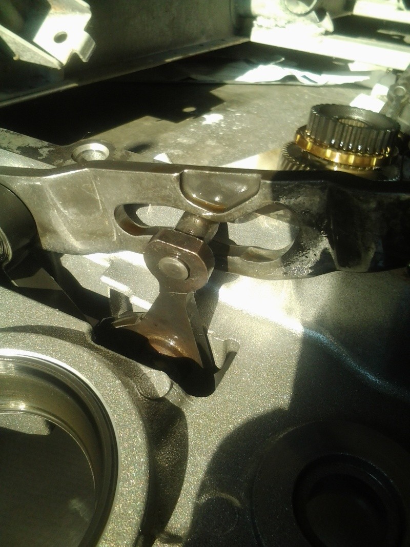

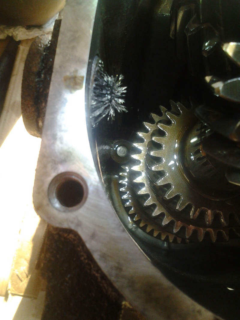

  • RENAUD
    replied

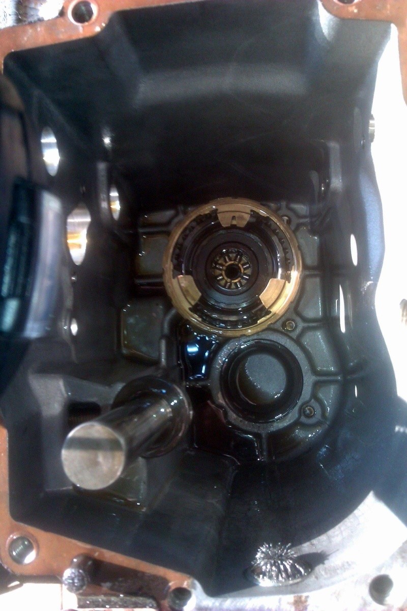

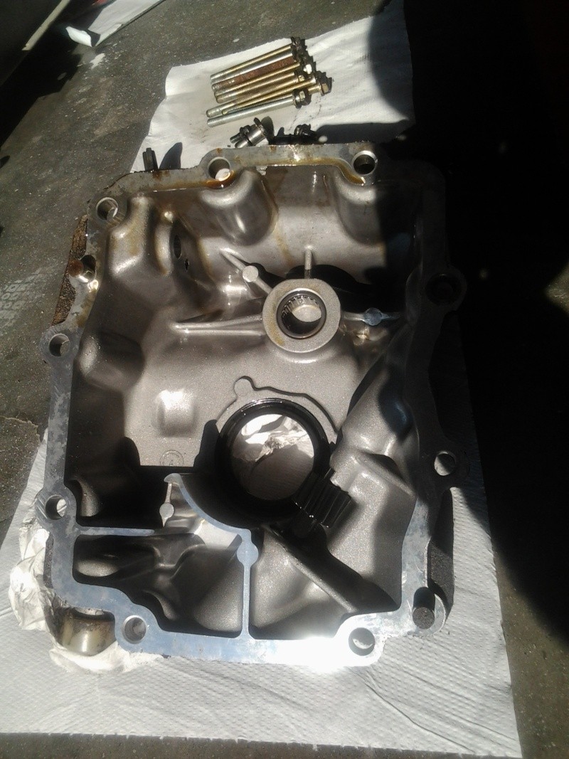

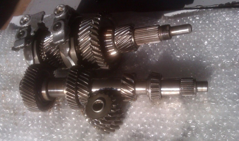

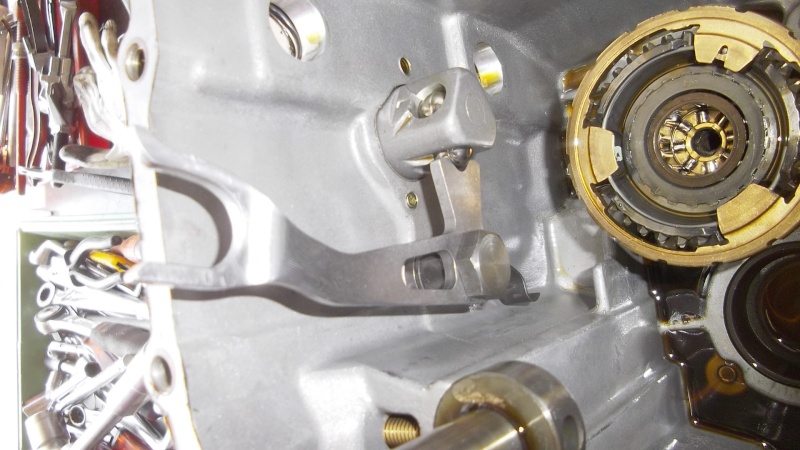

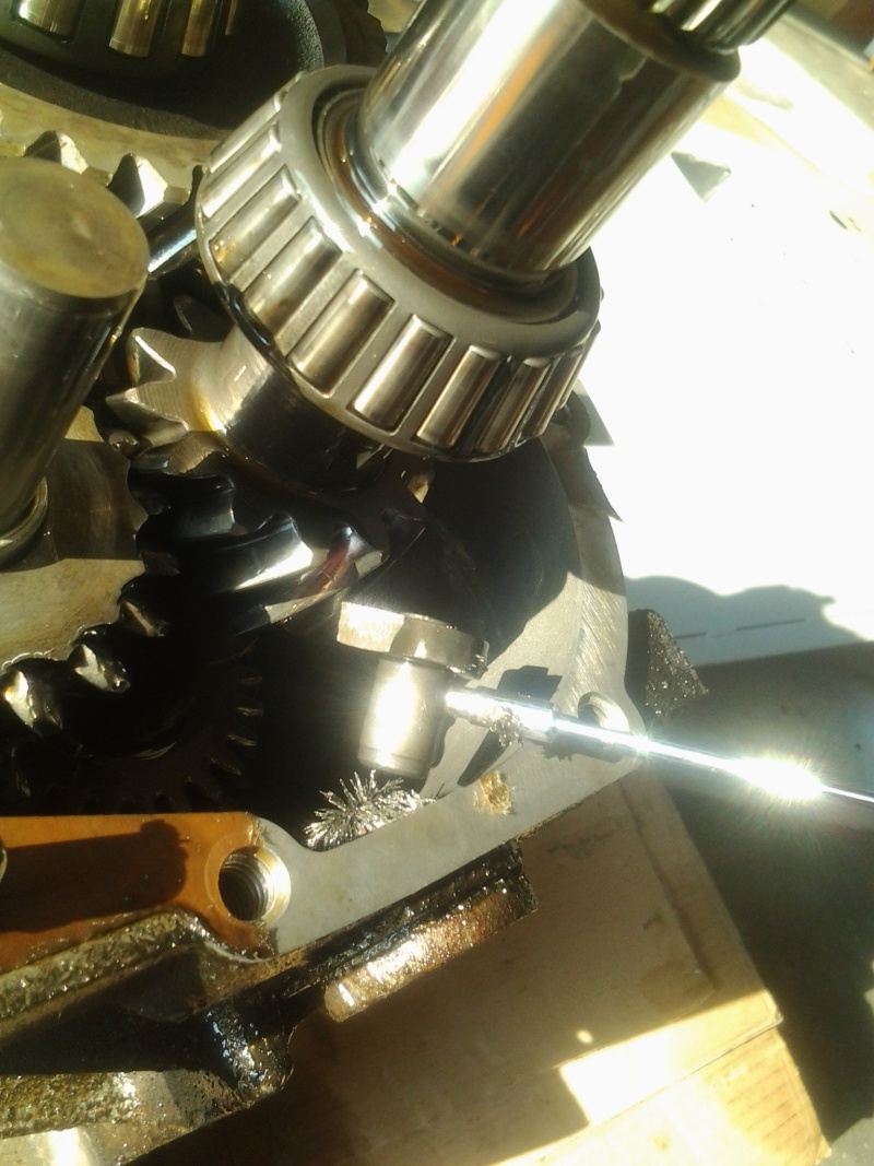

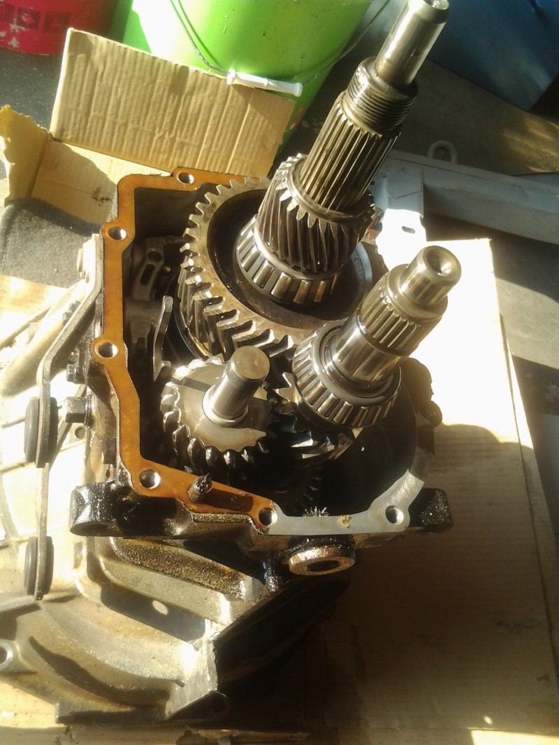

    dismanteld the gearbox and found what the problem was
    something weird right there at the bottom...
    ok...
    something is missing here!
    almost empty
    down : thing is broken
    up : thing have not the right shape
    after all this work need some...

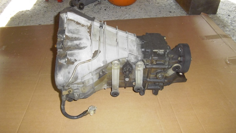

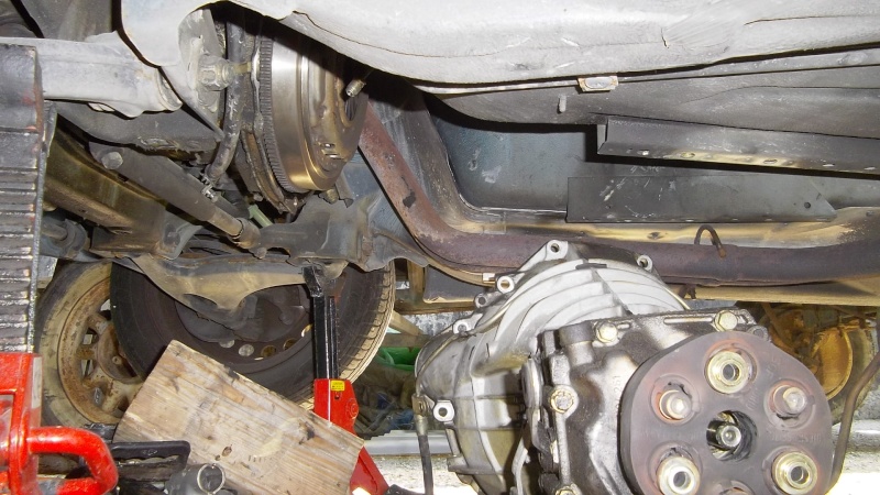

  • RENAUD
    replied
    decided to try sell my VW Polo Harlekin
    If someone would buy it I should by a cheap airide setup from Poland for the benz...

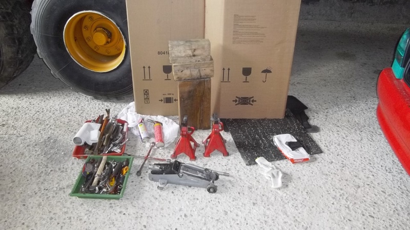

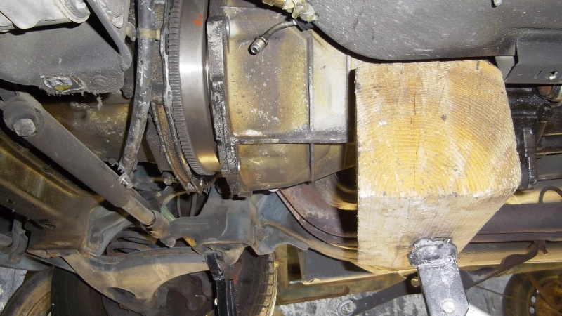

    So, full of motivation i started to remove the gearbox
    she's there, in the dark...
    tools
    didn't finished to remove it that day, i was missing a tool...
    let her like that
    found some nice old stuff
    Leave a comment:

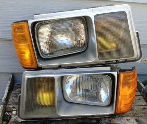

    recently won an auction for a pair of us spec headlights
    they already flew from california to florida by my cousin... and sh'll soon ship them to me in France

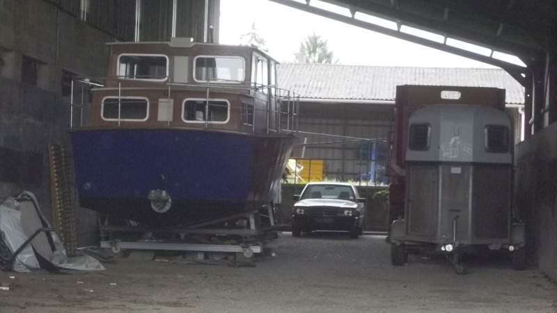

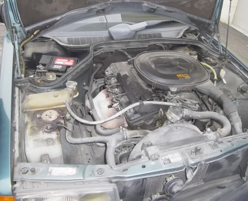

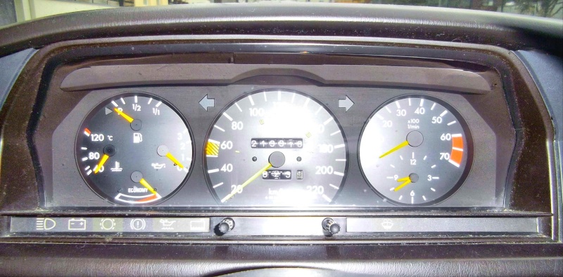

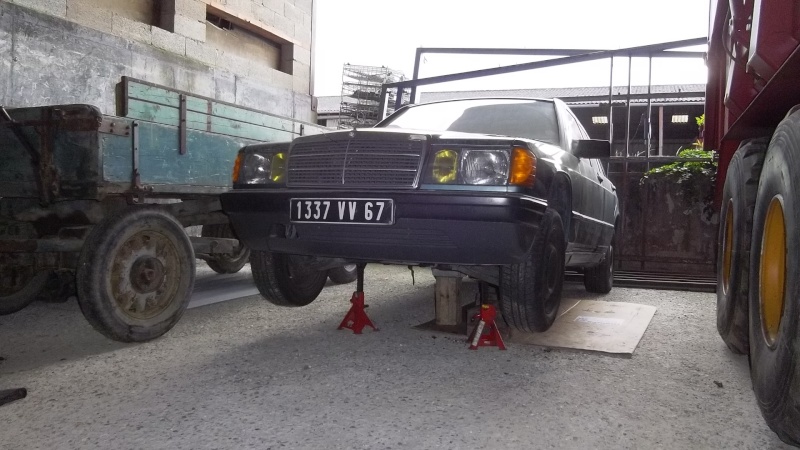

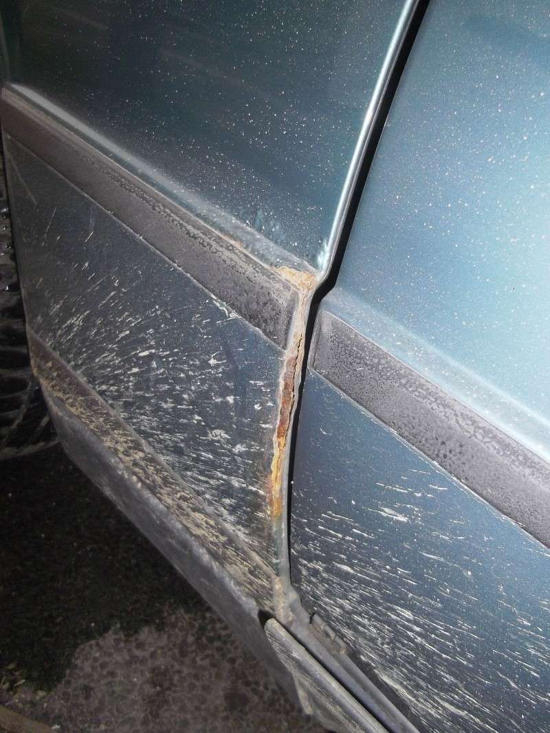

    A few days later, had it out from the garage
    corrosion
    engine
    dashboard
    running like a swiss clock
    inside like new even with 25 years
    bad news is, when another car is pulling it, ther's a noise in the gearbox, even at a few km/h (even à 2 mph)

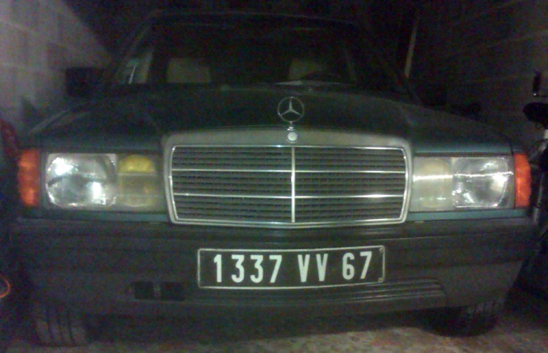

    Didn't need another car but price was low and the car was in rather good shape
    phone pics, the first time I came to see it:
    Bought it from the son of the first (dead) owner, price was 390 Euros because the gearbox was stuck in 5th gear and because the car had to leave, son of the owner had already sold the garage where the car was...
