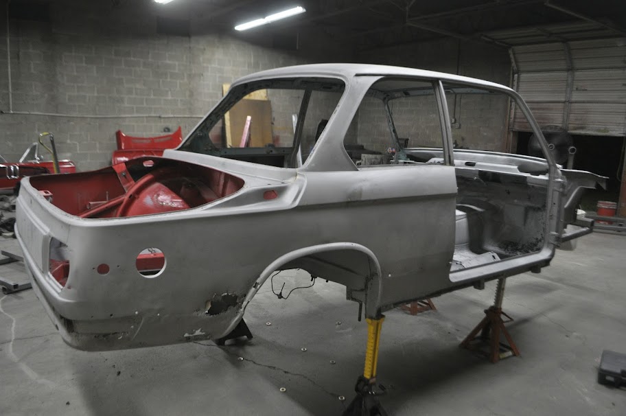

So moving onto the front I decided to re-assemble the front end so I can start to figure out things like radiator mounts, and the rest of the engine accessories. I also wanted to throw the front of the turbo body kit on to see how she would look:
There's a surprising amount of room in there with the M20 in place:
