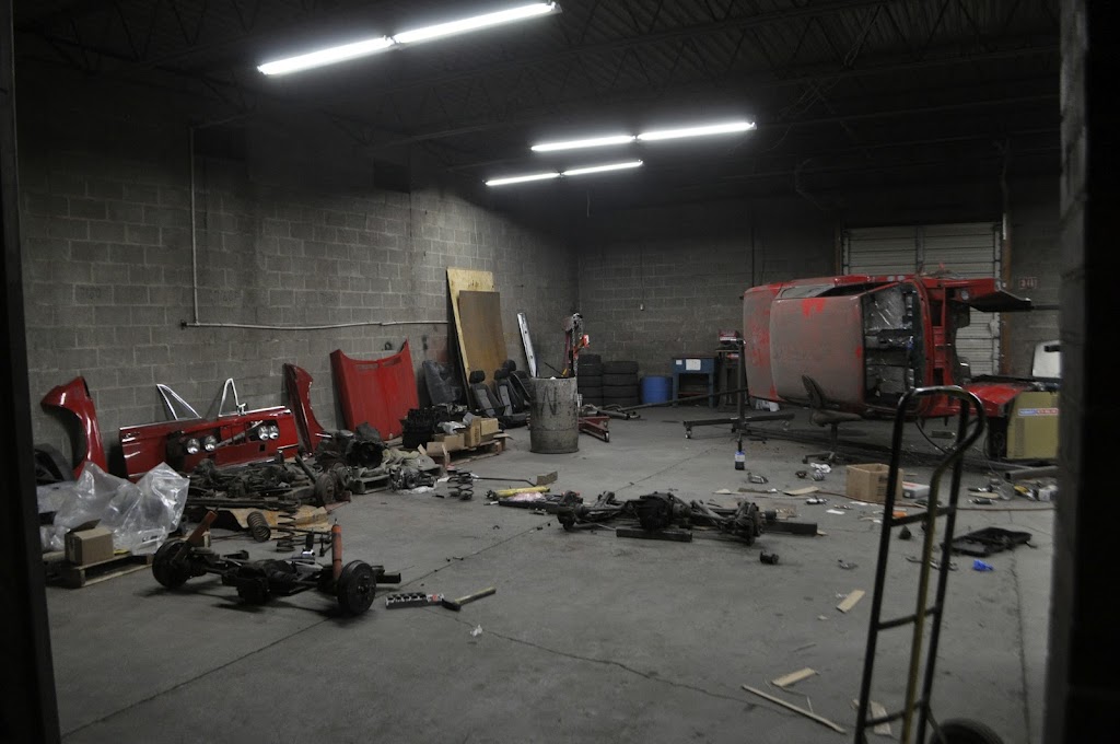

    The rest of my time has been spend stripping the car down to bare metal. After finishing all of the exterior surfaces, I started working on the underbody. The sand blasting process worked great for the surfaces with just paint and bondo (in some cases LOTS of bondo lol), but it was pretty much useless on anything with rubberized undercoating. Which is the entire underside of the car. Because of this, I had to bust out the 4" grinder with the wire wheel attached and strip off all the rubbery material. This leaves the base metal primer, which I'll sandblast off as a final step.
    Here's a pic of the underbody after stripping off the rubbery undercoat. It's kinda hard to see, but the grey/greenish area's are the base metal primer ready to be sandblasted. The lighter grey area is already sandblasted metal, and the black is an aftermarket undercoating from my previous repairs. It will also be coming off to bare metal, but it needs to be ground off still.
    What does half a car worth of undercoating look like?? This, the pile is about half and inch thick.

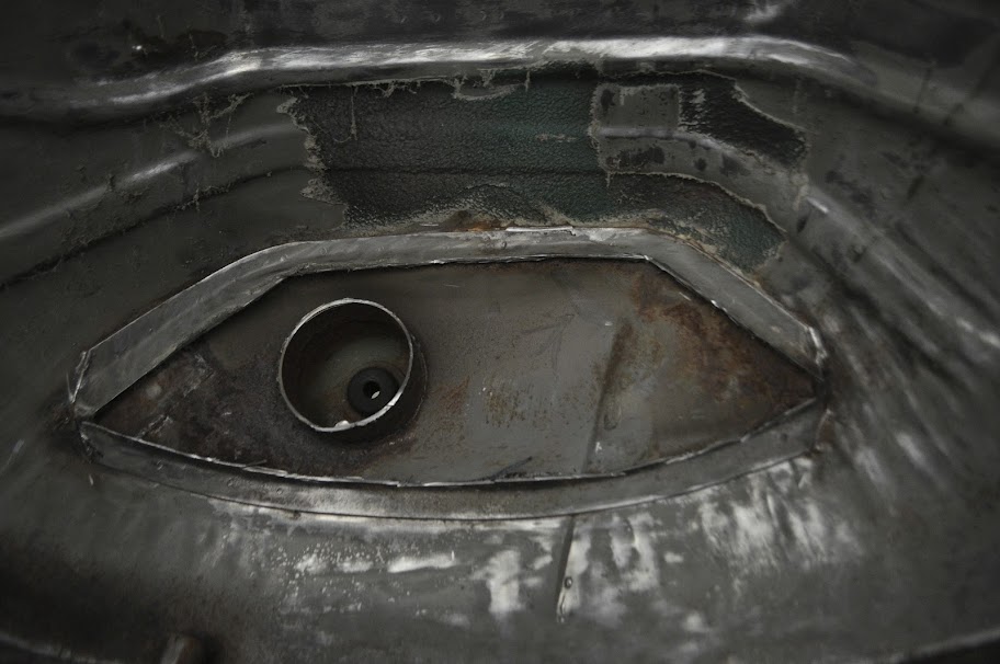

    After spending a few hours working on the bottom of the car, I turned my attention to the rear fender wells. The first picture is after I wire wheeled out all of the undercoating. This showed me what places were rusty and needed attention.
    For my rear suspension, I'm going to be running a true coilover that ties into the roll cage in the trunk area. This means that the stock spring perch and reinforcement are just taking up space, so out they come.

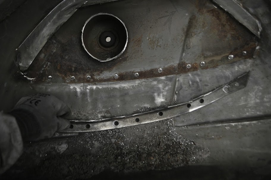

    With the inner section cut out, it just left the spot welded attachments which gave me a great chance to use my new spot weld cutters. Here you can see the individual spot welds on each piece.

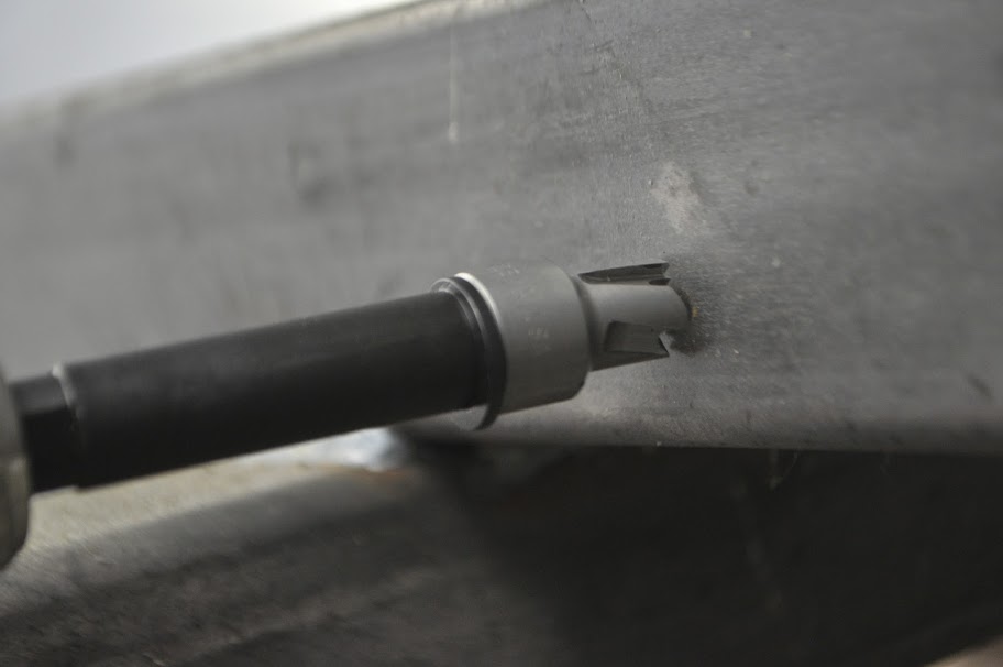

    First I punched the center of each spot weld so the cutter could locate properly.
    And here you can see the cutter. The center rod is spring loaded, so it helps to locate the cutter without drilling into the second layer of metal.
    As you push the bit in, the rod retracts keeping the bit centered.
    Now all that was left was to drill out all the spot welds for the spring perch support.
    Bottom Side Done:
    Top side Done:

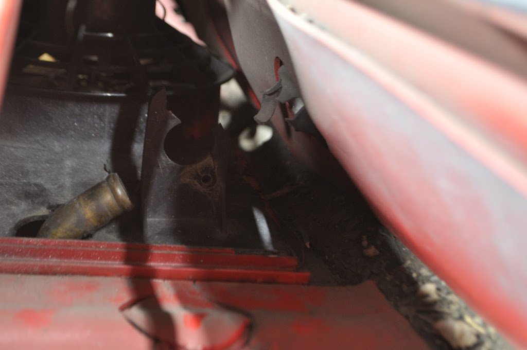

    After removing it, I'm really glad I did. You can see all the rust that was hiding underneath it. Luckily with the perch out of they way it will be very simple to patch it and tie it into the cage with my shock mount.
    The next steps are to remove the spring perch from the other side (passenger) and then sandblast the underbody for hopefully the last time. Then I just need to blast the interior, which shouldn't take much time at all thanks to the thin layer of paint, and the trunk.

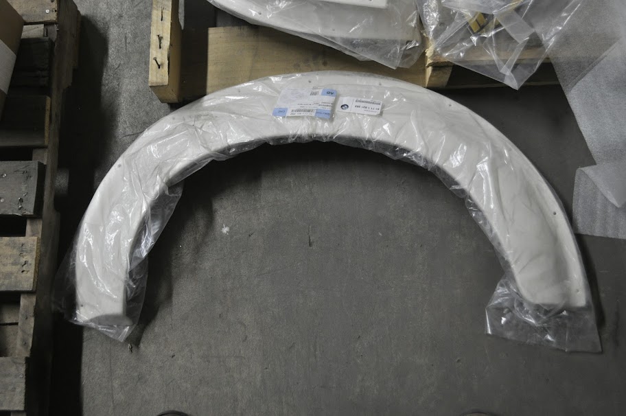

    First thing first, the rest of the Turbo body parts came in from Blunttech (thanks again Steve). All together the kit consists of:
    4 fender flares:
    Rear Trunklid Spoiler:
    Front Spoiler/Lip:
    Gasket for between the Body and Flares, along with mounting nuts:
    Sadly the Front Driver Side Flare is currently unavailable from anywhere. Supposedly BMW has then in production, but there is no telling when they will be available again. As of right now it's not holding me up, since mounting and trimming the front fenders won't take to long (the time consuming part is going to be the rear flares). Worst case scenario is I'll end up having to get a reproduction and use it until the OEM piece comes back in stock.

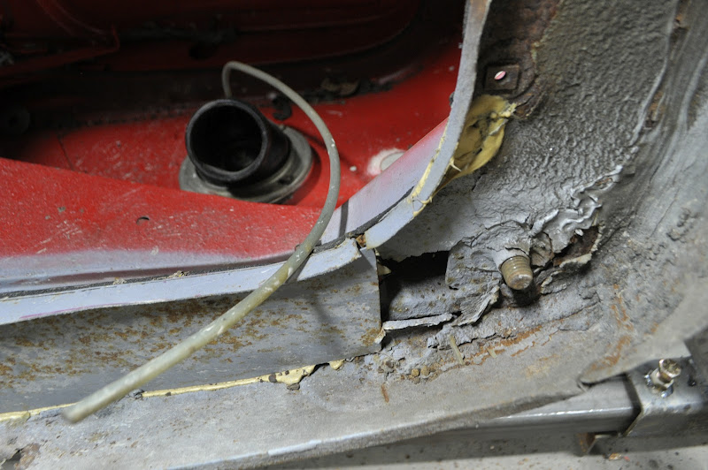

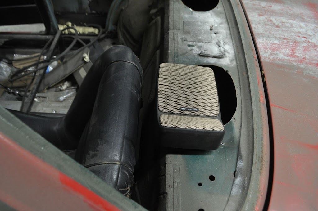

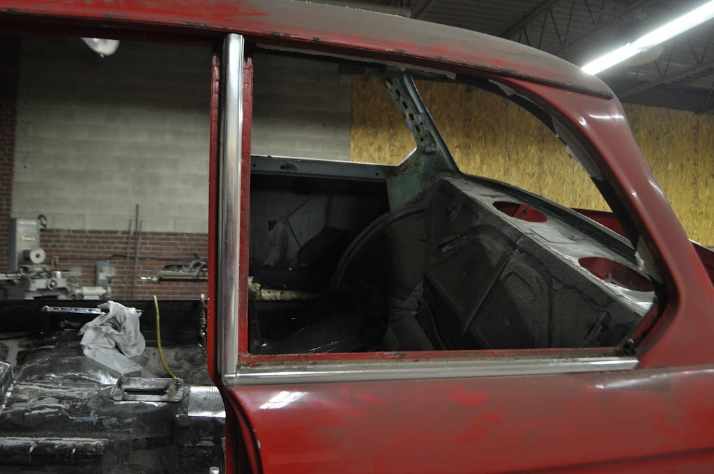

    Put in a solid amount of time today, and with the long weekend I still have two more full days I can throw at her. I'm hoping to get the whole body media blasted/stripped by the end so I can tear into the rust repairs that I know I'm going to come across.
    First I started the day like any sane person, grinding down the rest of the underside welds in jeans, long sleeves and a welding jacket. Hell, it was only 95 degrees today.... But luckily that didn't take to long. Next up I took a break and ran to the hardware store where I found a 12ft x 100 ft roll of clear plastic drop cloth. I'll suspend this from the ceiling to make a 'booth' that I can blast the body in. This will hopefully keep the dust and sand from getting all over the rest of the shop.
    But before setting up the booth I had to finish removing misc stuff from the unibody. First up was the rear chrome trim, which pops out with 4 plastic tabs:
    Rear Emblem, it was a little dirty behind it:
    Trunk Lock:
    Door hinge and pins:
    Rear Side Windows and Surrounding Trim (windows are already out in the pic):
    The Trim is held on with a few rivets, you can see two in this pic:
    Drilling them out:

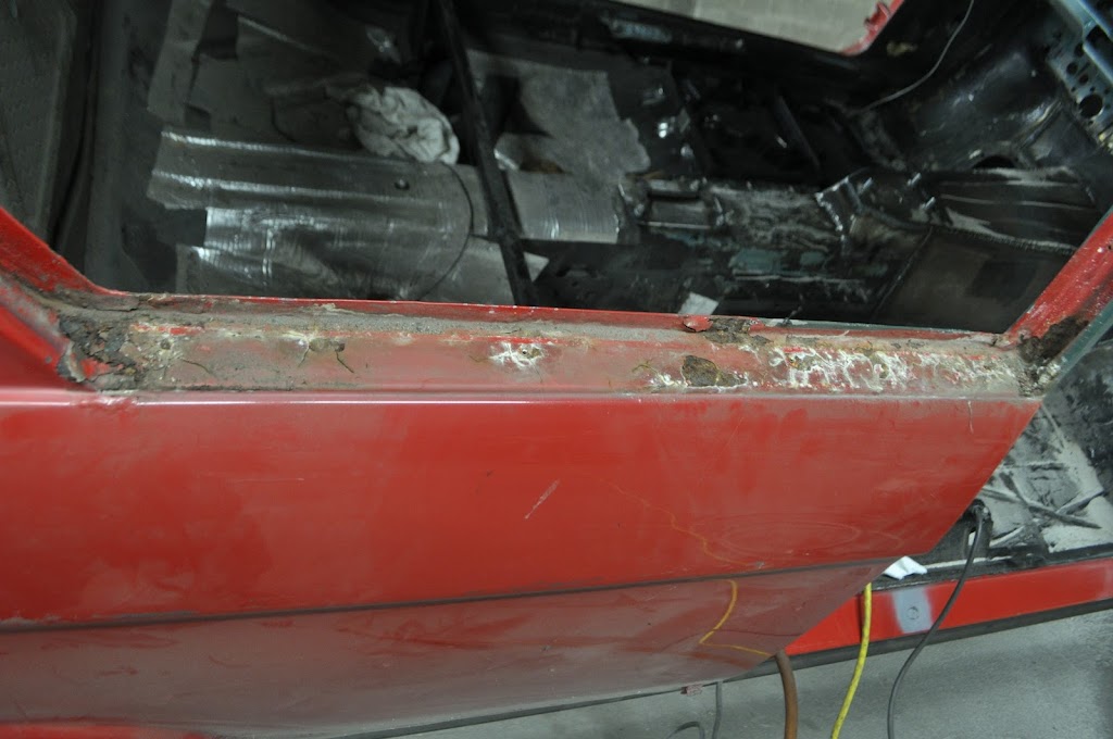

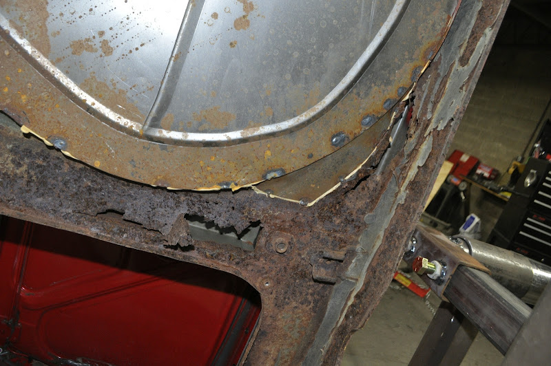

    Yay, more surprise rust!! Although I guess it shouldn't really be a surprise anymore....
    The other Side was just as good:

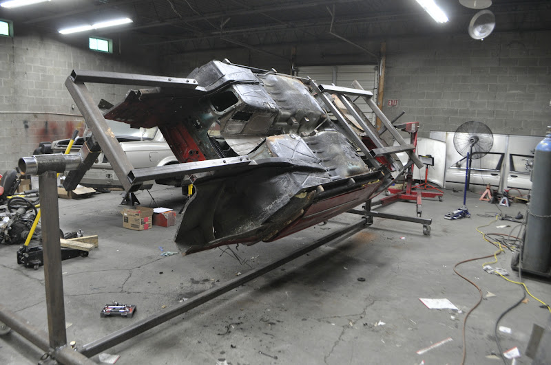

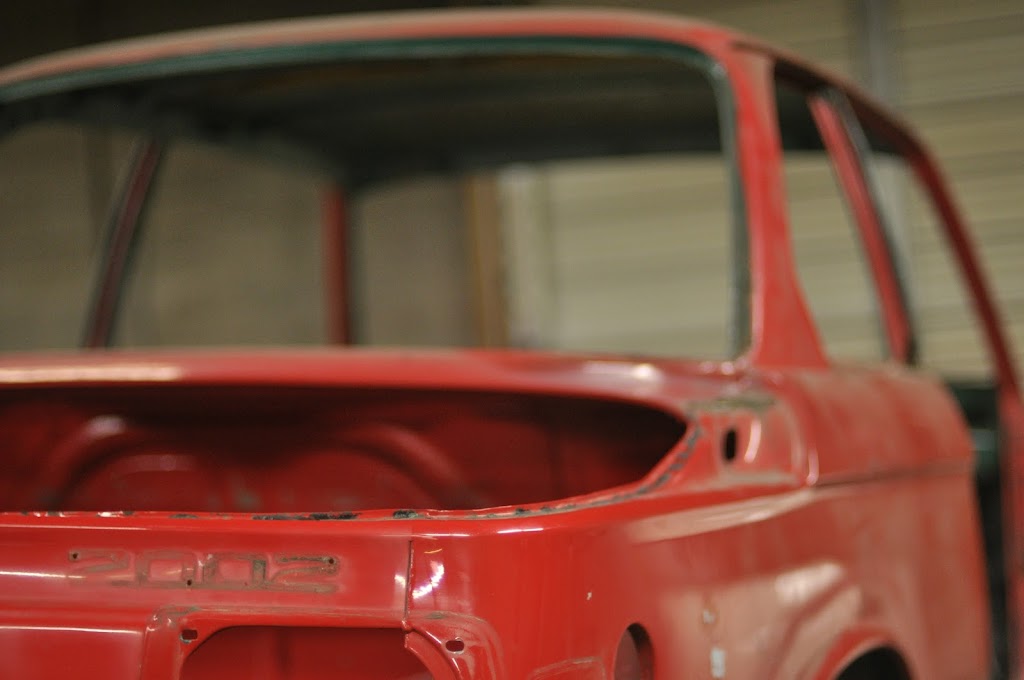

    With the chassis/body stipped down to the bare shell the next step is media blasting to find any hidden cancer that is covered by paint and bondo. First thing tomorrow morning I'll set up the booth and start knocking it out. I hope to have it done by the end of the weekend assuming I don't run out of media or have any other issues...
    A little bokeh to end the night with:

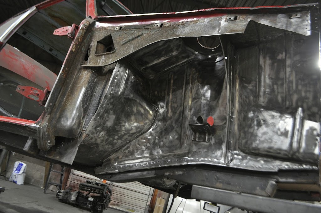

    Tonight I finished the rest of the interior welds on the trans tunnel and firewall and started grinding them down. The idea is to make it smooth enough that you can't see the seams once it's covered with seam sealer, undercoating and paint, making it look somewhat OEM.
    Just a few pics of the progress. I used up my last grinding wheel before I finished so I'll have to pick some more up tomorrow in the a.m.
    Before:
    After:
    Leave a comment:

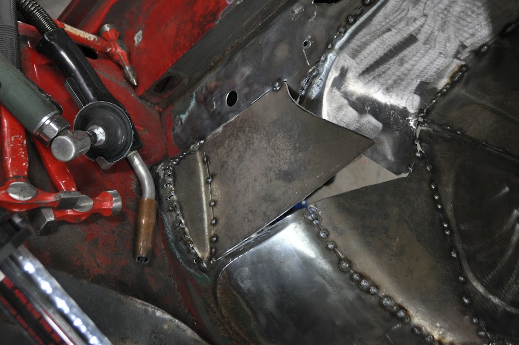

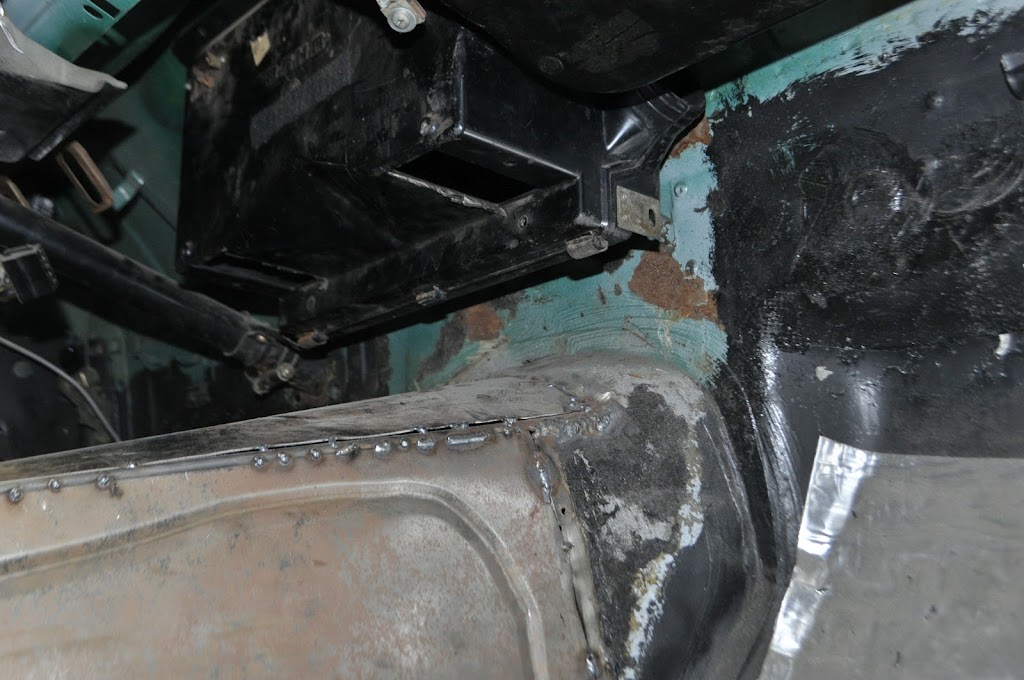

    Old crappy panel:
    Cut Out:
    New Patch:
    Tacked in place:
    I got tired of moving my light around as I tacked stuff in place so I made this handy adjustable torch light. It's always right where I need it to be pointing!
    First half of the tunnel welded up:
    Exterior of new panels fully welded, ready for grinding:
    All tucked in for the night, ready for sleep (me too!):
    Goodnight!

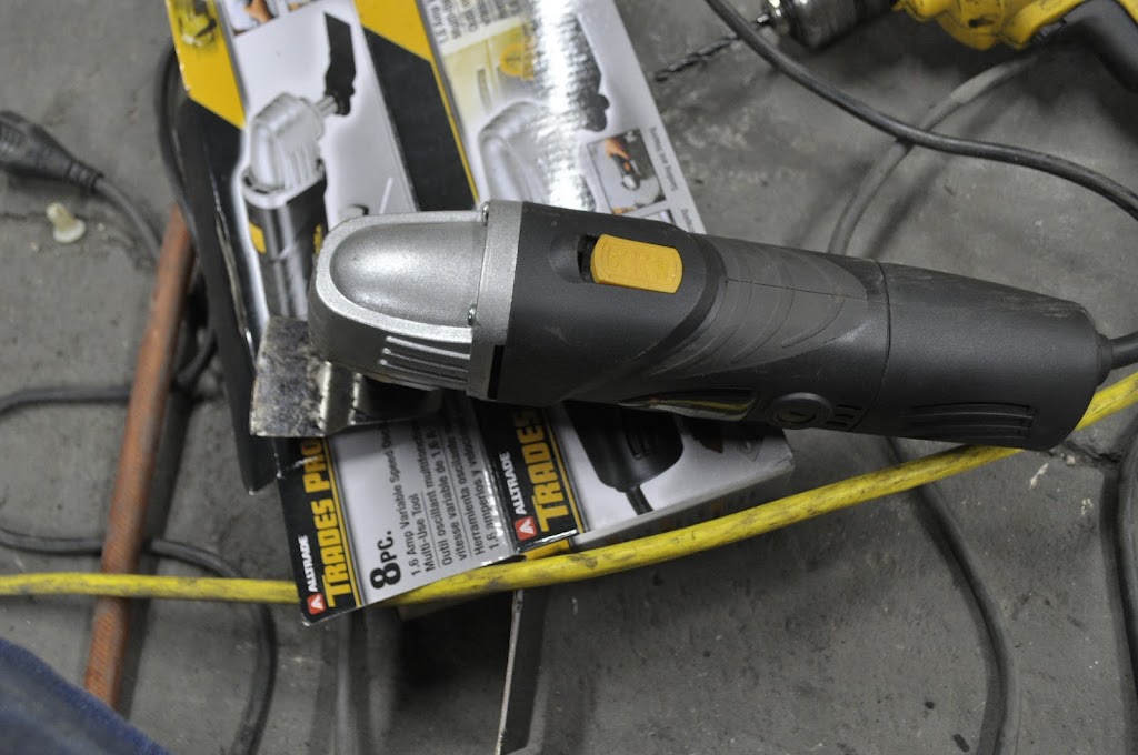

    I was able to start stripping the body down to bare metal. For this I used a combination of an 'oscillating multi tool' with a scraper attachment and a angle grinder with a wire wheel. After spending a few hours getting it to it's current state, I decided that I wasn't happy with how much progress I was able to make. So I broke down and ordered some fine grade glass bead, which I will use to media blast the entire body in the next week or so. I already have a media blasting pot, so I'll just need to make a small 'booth' with drop cloths to keep the dust down and go at it. This will let me reach into all the nooks and crannies in the body panels and kill any rust, which will help me sleep better at night.
    The progress I made before 'quitting' the wire wheel stripping:
    In case anyone is wondering, this tools works great at removing undercoating and especially the sound deadening material from the inside of the car;

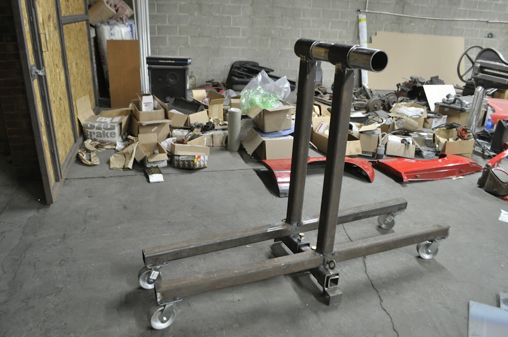

    So the next parts of the build will involve a lot of body work. I need to fix the rust spots around the trunk floor as well as strip the entire body down to bare metal. I was really not looking forward to laying on my back stripping the undercoat and cutting, grinding and welding the new metal. So I decided to spend a weekend to make my life for the next month much easier.
    Two end pieces made up:
    Front Subframe Mounting Brackets:
    Rear Subframe Mounting Brackets:
    Do a Barrel Roll!!

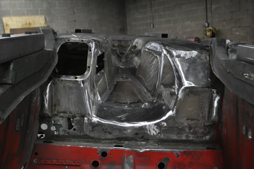

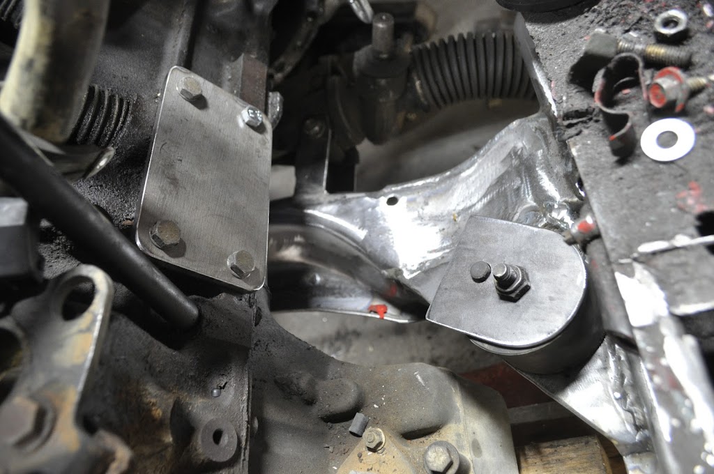

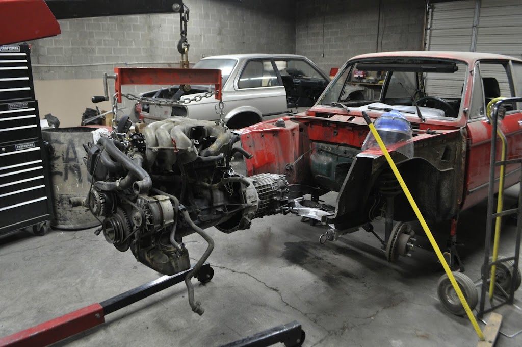

    Got a lot done over the weekend. First up was deciding on the final engine placement. In the end I decided that I would lower the engine down closer to the subframe, and move it back a half an inch. This way the firewall modifications would be minimal, and I would be able to still use the stock e30 driveshaft. So I removed the old engine and transmission mounts and positioned it where I wanted it to be, which told me what needed to be removed:

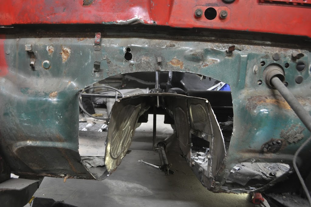

    How the tunnel/firewall looked before the new cuts. Notice that even though I had enlarged the rear section for the G260, the front opening was the same size. This made removing the engine trans pretty difficult, the bottom of the transmission would hit the steering rack before it cleared the upper edge of the tunnel.
    So keeping that in mind I cut out enough that would let the engine and trans move in and out much easier, as well as keep the stock sheet metal around the heater box.
    With the tunnel and firewall clearanced it was time to make the new mounts. First up was the engine, put in place:
    Clearance around the Tunnel:
    Driver side plate mounts in place:
    Passenger Side plate mounts in place:
    To fabricate the rest of the mounts, I used cardboard to make a template, then cut them out of sheet steel and bend them to fit. Cardboard template and metal piece made from the template:
    The new passenger mount next to the old one.
    The new driver side mount next to the old one.
    Next was the trans mount. Individual Parts cut out:
    Tacked together, still needs to be fully welded and smoothed out:
    And the final placement of the oil pan, it has ~0.5" clearance with the subframe. Since I'll be using poly mounts that should be plenty.
    Overall I'm much happier with the new mounts. The old ones looked pretty crappy, and everytime I looked in the bay it bothered me a little. they still need to finish being boxed in and internally braced, but once they get powder coated they should look OEM. Sadly I didn't get to finish them because I started on another project this weekend, which I'll post up shortly.

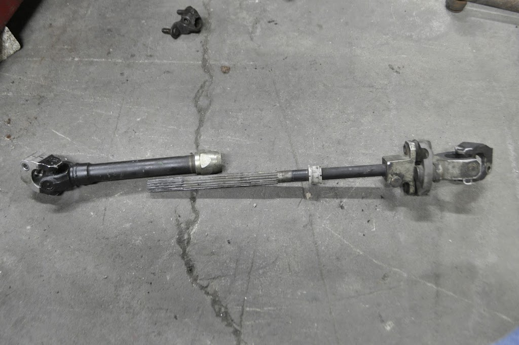

    I didn't get as much done tonight as I wanted, but that's because I spent a couple hours figuring out an issue with the surface finish on the lathe. Once I got that sorted, it was time to put the 'new' donor M20 in place. There were a number of reasons I wanted to use this engine instead of the dummy block I had been using. The main reason is this way I will know that the misc accessories and sensors will fit.
    It never looks like it will fit....
    The transmission at home in it's larger tunnel:
    All tucked in:
    Lots more room with the rack in there. I still need to shorten the stock column and fabricate new linkage, but that will come later.
    Not a ton of room on the exhaust side, but enough. I may run the stock manifolds at first, but ultimately I would like to make a set of custom equal length headers:
    Stock down pipe almost fit with the rack conversion, but the boot would not last very long. Of course with the stock steering system it would have no chance in hell of fitting, so it is an improvement.
    Clearance of the Oil Pan, a little less than an inch. I don't think I want to go any lower, but it does have room to move back another 3-4":
    Here you can see all the extra room with the bell housing compared to the stock steering system. Before I had maybe 1/8" between the track rod and the bottom lip of the bell housing. Here there is plenty of room, I could move the engine forward another 1.5" (cause I hear that's good for handling....)

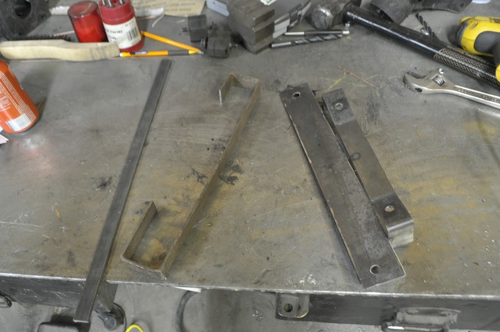

    Worked on the control arms tonight. Didn't like the flimsy stamped design, so I started by stitch welding the seams. I also picked up more argon so I could TIG them. This helped keep the head more controlled, gave me more practice TIGing, and made the clean up easier because there's no splatter. I've still got a long way to go before I try and tackle the stainless exhaust, but I am getting better with it.
    Side Shot:
    Small End:
    Other End:
    Any guesses as to what these will be?
    Lightened:
    And now for the first parts made for the car on the lathe! Top Die:
    Bottom Die:
    Turns the strips into:
    Straightened, Clamped and Welded:
    Finished Up:

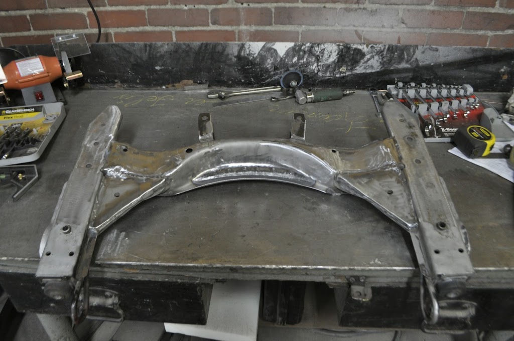

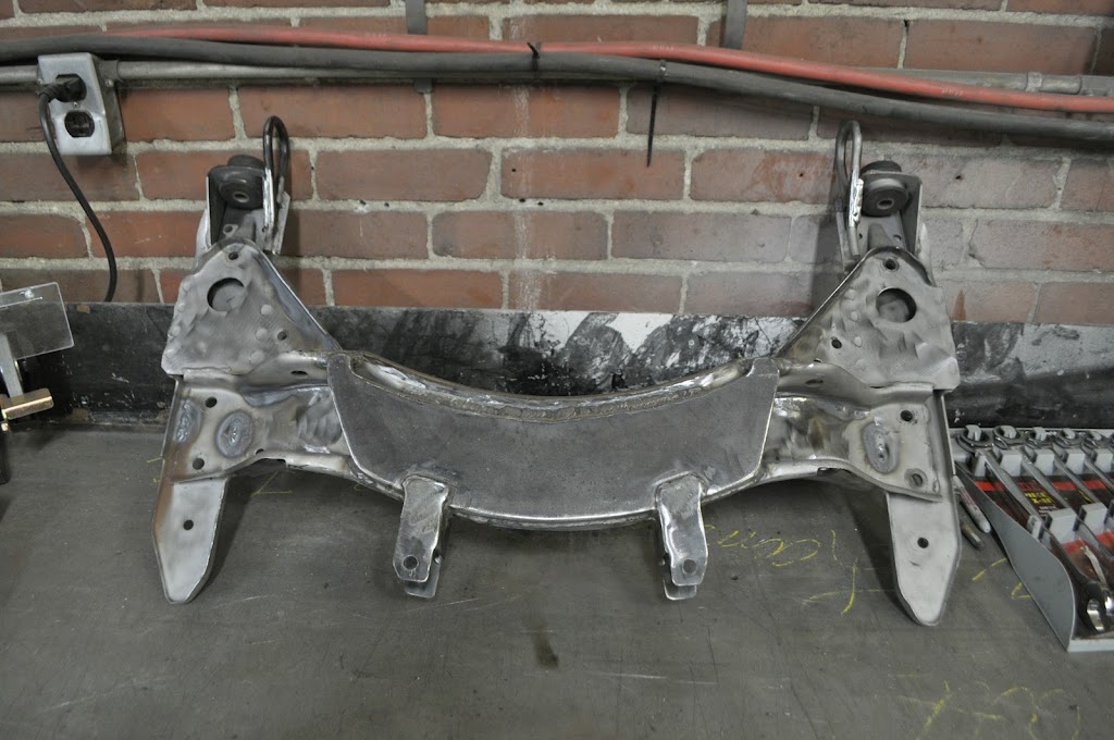

    Next up was to finished up the reinforcement of the front subframe. In stock form, the center of the subframe is two pieces of 1/8" steel spot welded together. Taking into consideration the greater power output of the m20, the greater weight of the m20, and the fact that my skid plate (due to the very low oil pan) will be mounted to the bottom of the subframe, I felt that it needed to be much stronger.
    The stock bottom plate on the subframe:
    I cut out the old bottom plate and plasma'd out a new piece out of 1/2 steel plate. This should stiffen up the center of the subframe while giving me a sturdy place to mount the skid plate. The new plate welded in place:
    Side views, I ran another weld bead all the way around after this to fully penetrate the 1/2 steel:
    With the subframe stiffened up I needed to make up some mounts for the steering rack. After taking many measurements to double check the placement and trying to keep it centered and squared, I tacked the tabs in place. After a final measurement everything was welded in place. I originally wanted to TIG the mounts, but I ran out of argon gas so I had to bust out the MIG. Got the job done just fine, but had to spend some time cleaning up the splatter.
    The tab's in place:
    The underside of the subframe. You can see the reinforcement plate along with the steering rack mounts:
    More of the rack mounts before cleaning the welds:
    Rack mounted on the frame:
    Subframe and Rack mounted in the car:
