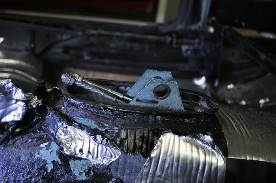

    My friend and I took some 1/8 steel bar and welded it to the inner roof sheet metal. This reenforced it enough so that we could just tap straight into the roof without needing any extra clips or tabs.
    Next was to start on the pedal box. The stock set up is a rube goldberg-esk contraption that looses any connection your foot may have felt to your braking system. I'm hoping to be able to remove the booster and just run a manual set-up, but keeping the dual circuit bits. We'll see how that goes as the packaging will be very tight.

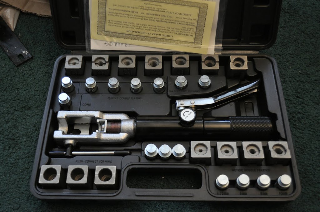

    New Hydraulic tubing flare tool. This can do all sizes of metric and american brake lines, as well as fuel lines and quick-disconnect for hydraulic applications. This will come in handy when it comes time to run the new brake and fuel lines.

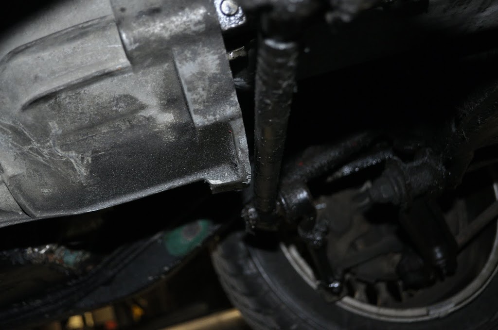

    With this in place the entire engine/transmission assembly is VERY solid. I may upgrade to poly mounts down the road, but we'll see how the rubber ones feel.
    Here's a picture showing how much clearance there is between the steering linkage and the bell housing of the transmission. It's not very much at all, probably 1.5mm tops. I'll probably have to either notch or bend the linkage to gain some more clearance, but I'm going to wait and see if the transmission moves that much under spirited driving. It may be another reason to get the poly mounts.

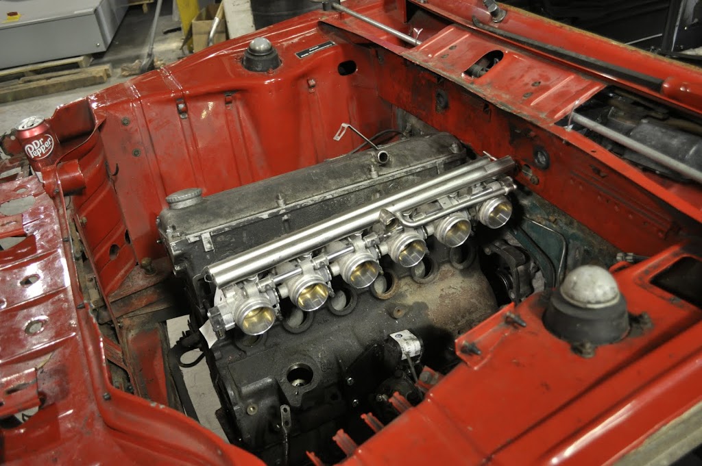

    Now for the money shots. I put the S54 throttle bodies in there to get an idea for what kind of clearance I would have between the brake booster. I'll need to fab up some kind of airbox for the tb's, so depending on clearance I may also go with a straight boosterless system.
    Next on the list is probably going to be making the manifold to interface between the throttle bodies and the head. I'm probably going to end up casting a custom piece, much like what I was planning to do with the bike carbs earlier. This one will be a little trickier though because of the oil passage between the 3rd and 4th intake runner. I'm going to draw it up in CAD this week and see what we can come up with.

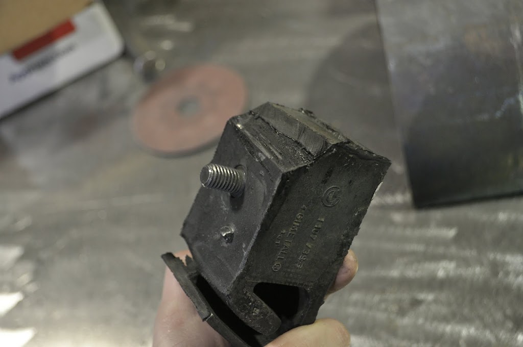

    The past weekend I was finally able to find some time to work on the '02. The 2.7l block and 885 head are still at the machine shop, but luckily for me I ended up with 2 complete m20's and so I was able to use the spare engine as a 'dummy' to get the engine and transmission mounts made up. At first I was planning on fabricating my own mounts for everything, but considering how much free time I've had to spend on this in the past month I made the decision to purchase some premade mount from Manimal (a member on 2002faq.com). They turned out very nice, the only thing I might change is to cut the tabs and re-weld them so the engine sits slightly lower in the bay. As is there is well over 1" of clearance between the oil pan and the subframe, and one of the upper mounting bolts for the transmission is blocked by part of the firewall. No biggy, but it would make removing the transmission without taking out the engine more challenging. Oh, and I also had to drill out the locating hole on the passenger side mount so the rubber pin on the stock mount would fit through it.
    Here you can see the one hole I had to enlarge:
    And here you can see the pin fitting nicely inside the hole:
    For the driver side mount, you have to notch the stock rubber piece so it will fit at the correct angle. Here's how much I took off with a cut-off wheel:
    And here you can tell the my angle was a bit to large. I took off material @ a 45 degree cut, in hindsight a 30 degree probably would have done the job:
    With those modifications done I was able to drop the engine in without much trouble. For some reason my driver side engine mount was a little to far in, so I took my trusty BFH and persuaded it to get into it's proper position. Once everything else is mounted and in place I'm going to drop the from subframe and refurbish it, at which point I will also weld in some re-enforcement on the driver side engine mount. For now it fits/works just fine though.

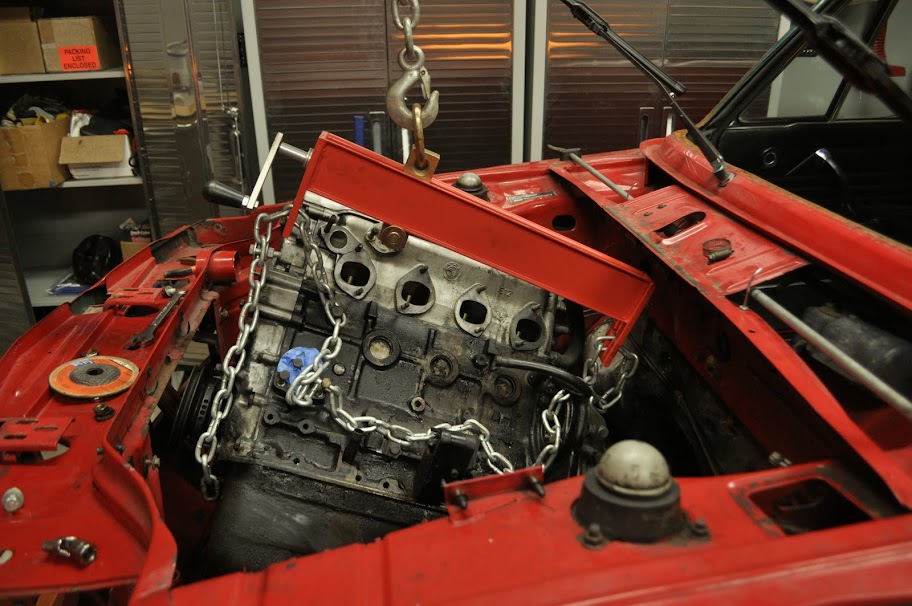

    The last thing to do before heading to the machine shop was to get the valve springs out of the head.
    My purdy new valve spring compressor. Worked flawlessly and got it for under $20 from sears:
    Also picked up a real set of feeler gauges. Wasn't expecting it to come in a nice roll-up pouch but no complaints here:
    With the valves out I could do a preliminary check of flatness on the head. Looks like it's right around 0.0025" max, so it should be easy to get it smoothed out again.
    All the parts wrapped up and ready to go to the machine shop. Who says the e46 can't haul parts.

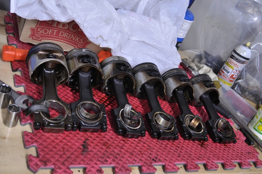

    So Thursday night I needed to finish tearing apart the engines to see what condition the insides in. First thing was to finish stripping the 'i' block and get the crank shaft out.
    The empty block ready to go to the machine shop:
    The 2.5L crank:
    The 'i' pistons, rods and main bearing caps all together so I don't loose em.
    All the pieces parts taken off the block. Mounts, oil filter housing, pulleys etc:
    ---------- Post added at 12:54 PM ---------- Previous post was at 12:38 PM ----------
    Next on the chopping block is the 'eta' engine. It has no idea what's coming:
    Popped the head off. Here you can see what the eta pistons look like. They would be perfect for boost (giving a CR of ~8.0 with the 'i' head), so I'll hold on to them for now in case I decide to go down that route in a year or two.
    The eta pistons and rods. These rods are 130mm where the 'i' rods are 135mm. This will help to compensate for the longer stroke of the crank.
    The eta crank. Looks a lot like the 'i' crank lol.
    Over all the eta crank was in great condtion. The only bad spots were two places I could catch my fingernail on the bearing surfaces. Hopefully it can be polished out and reused.

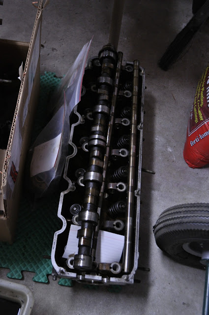

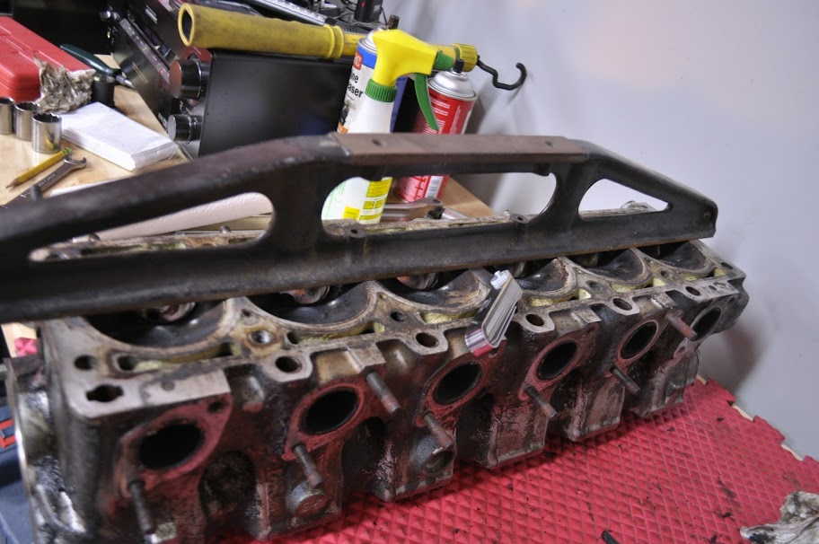

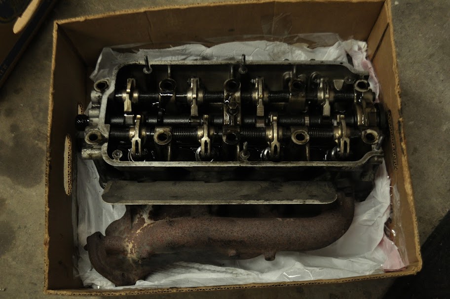

    Here's one of the 'i' heads, torn apart all except the valves. I still need to pick up a valve spring compressor to get those out of there.

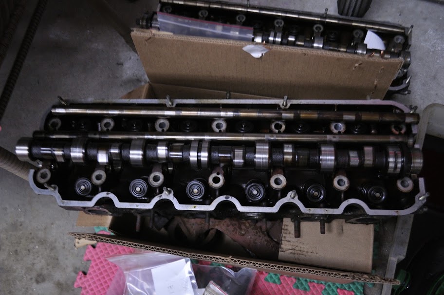

    The other 885 head. Both of them had roughly the same camshaft wear, which was slightly more than I was hoping for. I'll have to see what the machine shop says as far as what is acceptable for cam bearing surfaces. So long as the bearing surface on one of the heads is alright I'll be fine since I'm picking up either the 284/272 or the 288/288 schrick later this month.
    And to keep me honest, it seems like this is how everything is going to shape up, at least mechanically:

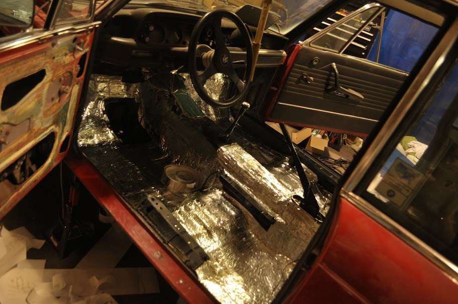

    With the wiring out of the way, I was able to finish taking out the rest of the interior.
    Carpet, Steering Wheel, Dashboard, Pedal Box and pretty much everything else gone:

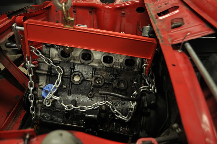

    And FREEDOM!!
    That is one oily engine lol:

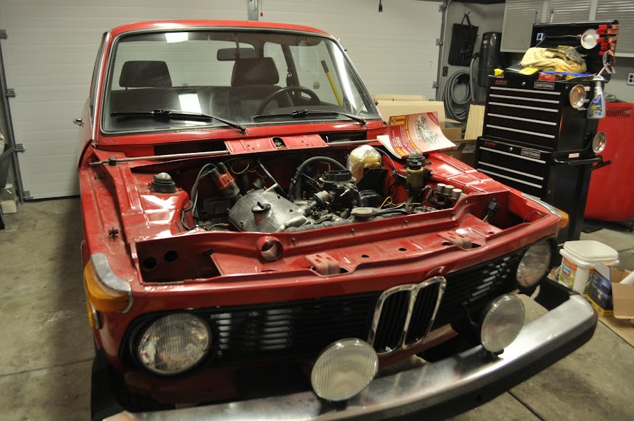

    So after much debate, it looks like she may be down and out for longer than I anticipated. But it's all for good causes.
    First, more body panel inspection, so off with the fenders:
    Both fenders must have been replaced right before she was resprayed before because they are both very clean (unlike the rest of her). I'll be able to fill in the reflector holes ala euro style and have some nice clean fenders.
    Then I needed to get the windshield out and see how bad the rust under the seal was. In the pic you can see how the entire frame was starting to rust out. Luckily it seems that I got to it just in time, it's only surface rust and should clean up fine:
    Then as I was taking off the front bumper I managed to drop one of the fog lights. Fuuuuuuuuuuuuuu.....
    Next thing on the list was to start unwiring.... Everything.... Thankfully electronics are at a minimum on her, so this was much simpler than say an e36 or even and e30. A couple of pointers, label EVERYTHING. You never know how long it will be until you are re-wiring and you'll pry forget what that little connector went to.

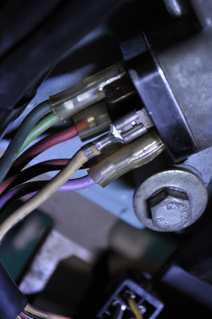

    A pic of the ignition switch so I can remember how it connects:
    And Finally after about and hour and a half of wraslin' the two harnesses were free. On '02's there are two different harnesses. The engine harness which holds all of the stuff that makes the car go, and the Body Harness that does everything else (lights, gauges, dash etc). They connect together along the firewall underneath the dashboard.

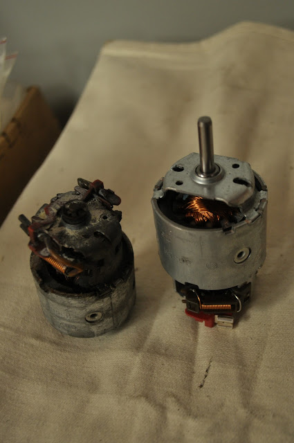

    Like I said earlier, one of the main reason's she's been decommissioned for the winter was the lack of a heater. This would let the window's fog up very quickly, which is never a good thing. So while the coolant system was drained I figured now was as good a time as ever to tear into that and get it fixed. So without further ado....

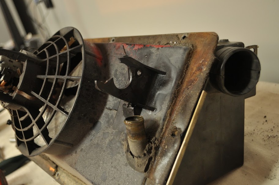

    The ugly 'ol heater box after I wrestled it out from under the dash:
    The mount for the heater valve once I unbolted it. Who knew plastic would get brittle after 35 years of head fluctuation....
    The innards, not very pretty. Although I have heard leaves can increase airflow ~20%.

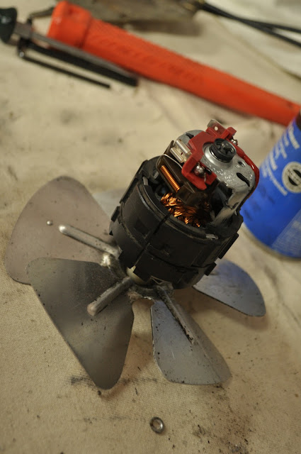

    And here's the bastard that's been keeping me in the cold.
    Next to his replacement:
    And the fan blade swapped over, ready for it's new home.
    I then finished disassembling the rest of the box and sorted all the parts. I just need to actually sit down and order the new seals and grommets to put her back together. I'll also fix all the cracks with some JB weld or the like and give her a fresh coat of paint.

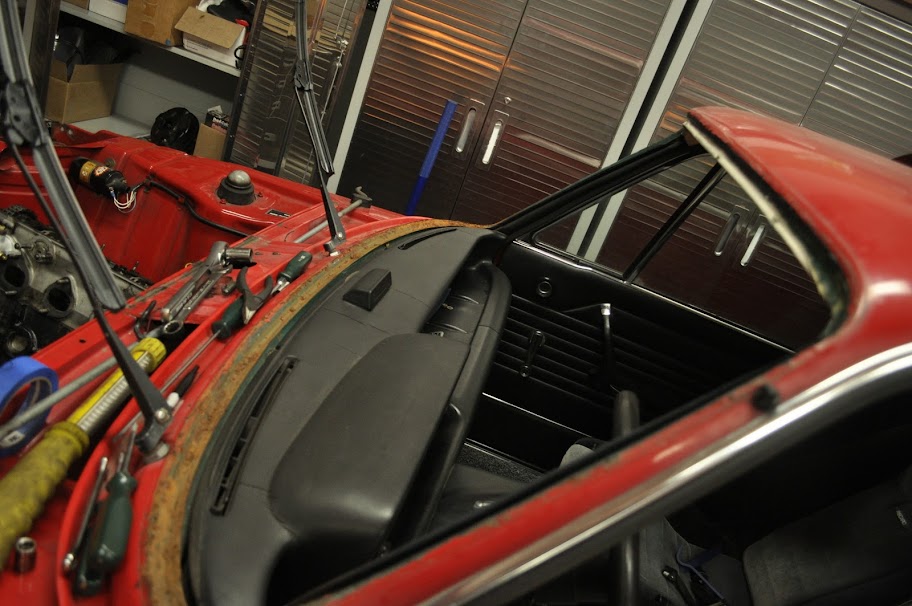

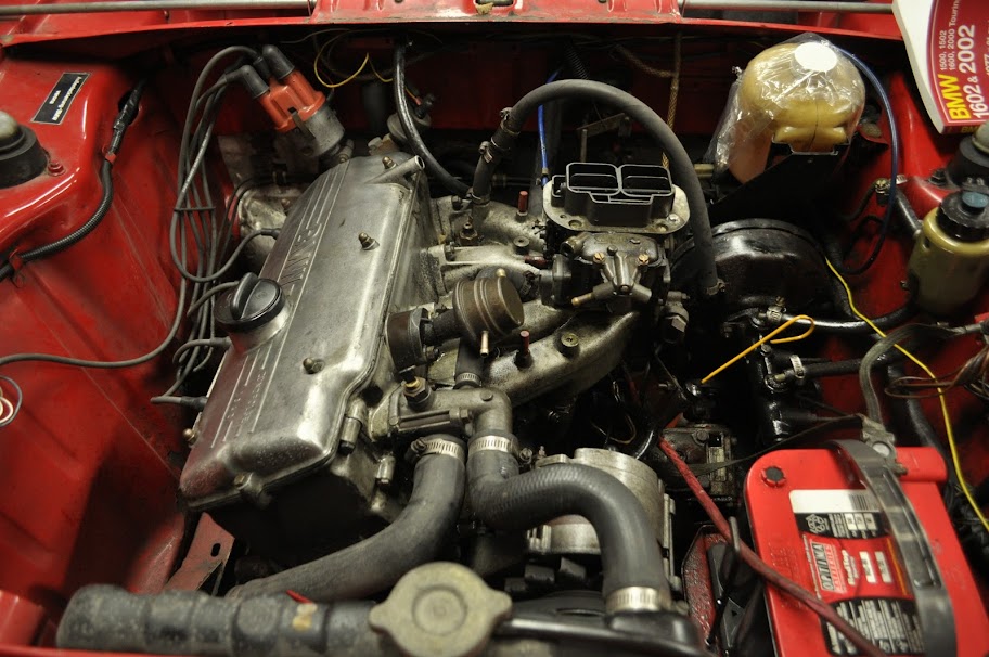

    I'm going to try and let the pictures do the talking....
    Step 1: Remove the Hood
    Step 2: Admire Weight Reduction

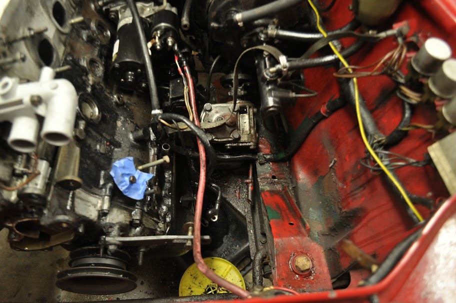

    Step 3: Examine Ugly Engine Bay

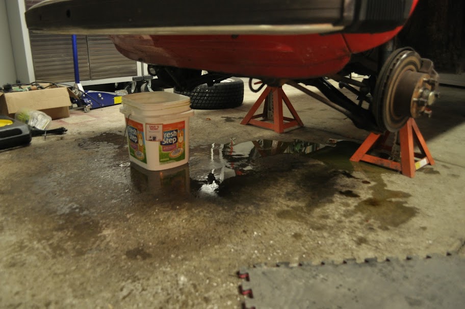

    Step 4: Spill Coolant All Over the Floor
    Step 5: Disconnect Coolant System and Remove Radiator

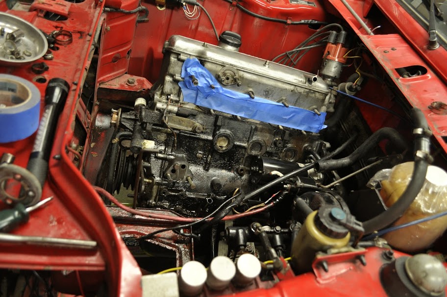

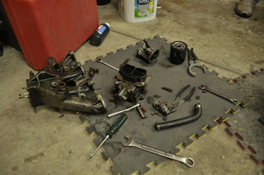

    Step 6: Remove Intake Manifold
    Step 7: Admire Your New Roomy Engine Bay. Your engine now runs on hopes and dreams.
    The main reason for removing this stuff was to work on the new manifold design and make sure it would bolt up to the head and let the carbs sit at the correct angle etc etc. But after looking at how dirty the engine was I couldn't help but think I should just pull the whole thing and give it a good refreshing. But I digress...

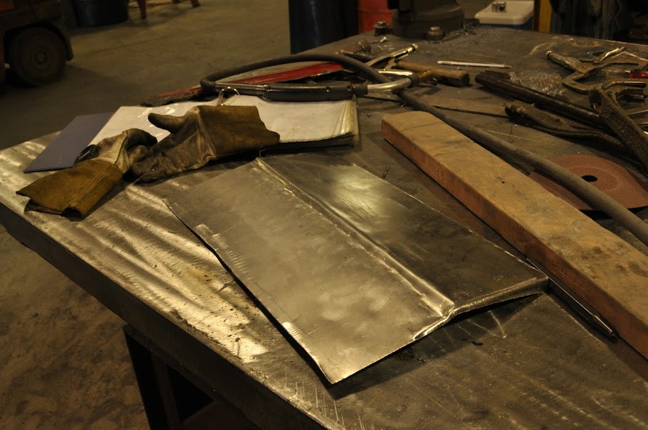

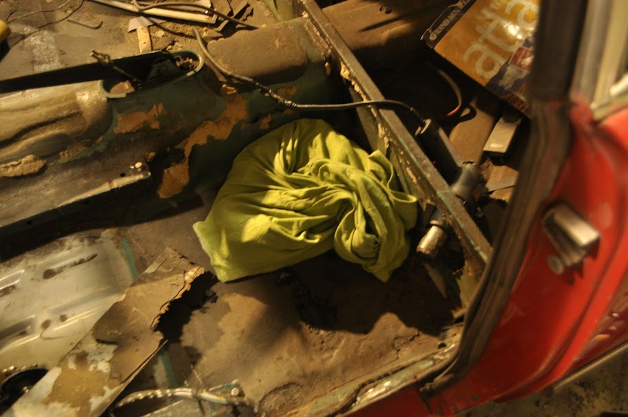

    Then I needed to make a new outer fender panel. Here it is in the earlier stages of being hammered out:
    And here it is welded in place. It's not the prettiest but I'd say it's pretty darn close for my first hand-made fender.
    Now with the majority of the rust repair done (woo!) it was time to help makes sure things didn't start to rot away again. but before you can really protect the metal, you have to get down to the bare stuff. This meant getting all of the old, tar-ish sound deadening off of the floors. Normally this is a terrible job that can take days with a heat gun and a scraper. Unless you know a little trick. Say hello to my little friend...
    Dry ice in a convenient pillow case:
    It may look tame, but it's doing it's thing. After 5-10 minutes under the pillow case, the sound deadening chips right off like a Maaco paint job.

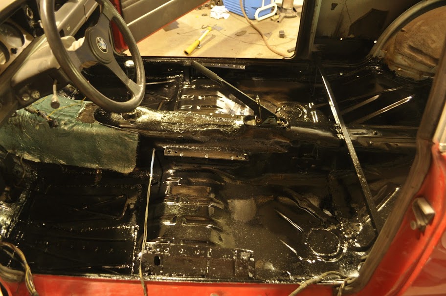

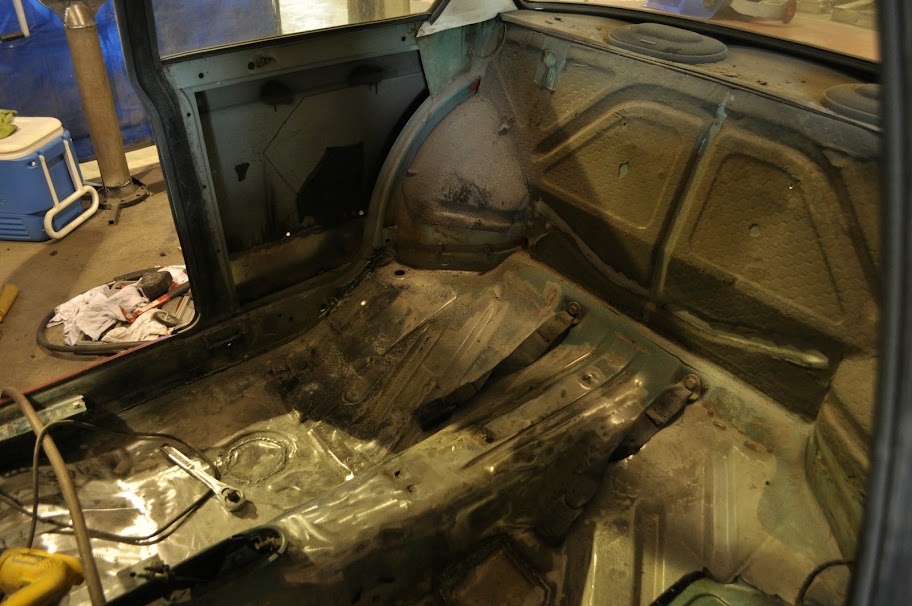

    Here's the rear with all the sound deadening off the floors. They are now ready to be covered in POR-15:
    But first let's give a nice test fit to those e24 rear seats. After some trimming of the rear fiberglass they fit like a glove.

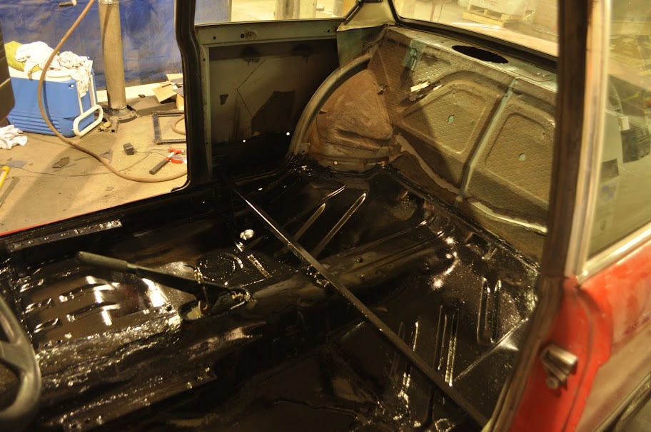

    With the rest of the interior sorted and repaired, the floors got coated in POR-15 top and bottom (where the undercoating had come off):
    Then as the POR-15 was drying, I prepared the next layer to go down. Sound deadening tar paper and Insulating ducting foam. Much like Dynamat and carpet insulation in function, but a whole lot cheaper. If I ever get to the point of doing a 'frame off' restoration, then I may splurge on the name brand stuff. Until then these will definitely do just fine.
    Laying down the Tar Paper:
    Laying down the insulation on top of that:
    With all that done there was just a couple of minor details to button up like re-sealing the gas tank and patching some holes in the trunk. Then the new fuel lines were run and hooked up to the engine. Finally after a couple of cranks she fired up as good as ever. That was about as far as I managed to get before school started and I was back up on campus. I did drive it up at school on and off for a couple of months until the weather really started getting cold. At that point, the lack of a working heater/defroster meant that the windows would fog up within the first 15 seconds of driving. So she got parked until I could find more time to work on the heater box and brakes. Thankfully that time came at the beginning of the new year. hopefully I'll be able to upload those pics in the near future.

    The Passenger Floor. Maybe there's at least some hope of clean metal underneath....
    No Such Luck:
    Finally cut it back to some 'clean' metal:
    Then new floors were cut out, beads were rolled, and then welded in like the drivers side. Which I forgot to take pictures of.

    For the past couple of years I've been working towards/dreaming about picking up a 2002 to call my own, and a couple of weeks ago I finally pulled the trigger. I went up to Detroit and amidst a strong fuel/exhaust smell she managed to tackle the 4 hour drive back to Springfield (Ohio) without a fuss so I can't complain. Anyway, without further ado here she is:
    2002
    The engine runs pretty strong, not that I have much to compare it to.
    Engine Bay 3
    Once I got it home and really started looking it over, I found out that she has a few nice surprises and a few not so nice surprises. But that's all to be expected I suppose.
    First, a 32/36 w/ manual choke:
    Weber Carb 2
    Next, a Tii Mechanical Advance Dizzy:
    Tii Dizzy
    Then I forgot to take a picture, but a full Ansa Sport Midsection and Muffler, which is pretty freaking loud @4000 rpm cruising down the highway lol. I think there's also a leak somewhere though, so that's definitely not helping anything.

    Oil leak from somewhere around the oil filter housing / intake manifold / head gasket.
    Oil Leaks
    So the plan is to fix the rusty area's and get the interior back to being sealed from the exterior. I've got some plans to help stiffen her up where it counts that shouldn't add to much weight either. In the end it won't be a show car by any means, more just a car meant to be driven. I've already started some of the rocker work so I'll post up more pictures soon.

    Next in line was the inner front rocker/side of the floor. At first I was going to leave this piece in, but the more I poked at it the more fell out, and so I decided to make up a new patch to cover it up.
    The rusty piece:
    Old Busted Joint
    The sheet metal patch, unbent:
    Template of old busted joint
    The patch, freshly bent:
    New Hotness\
