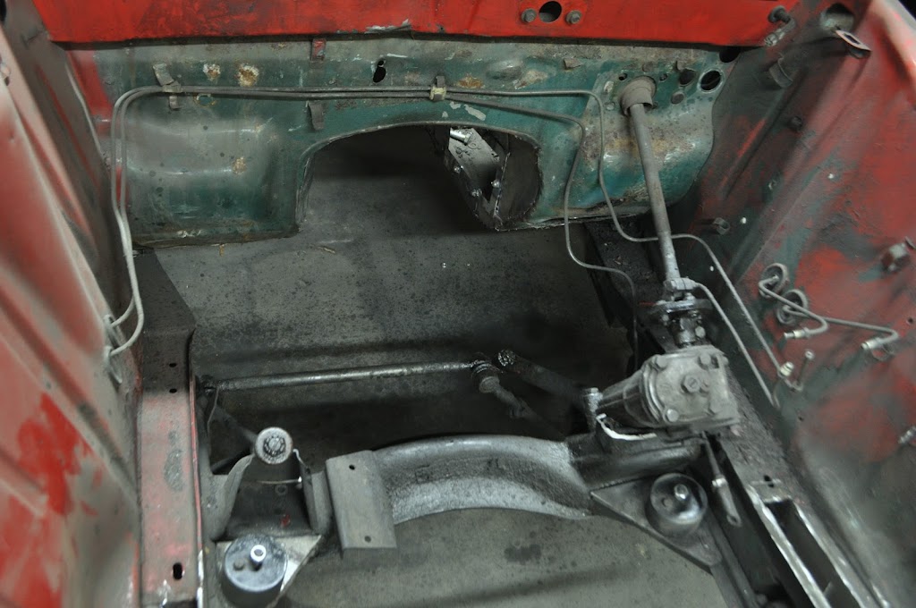

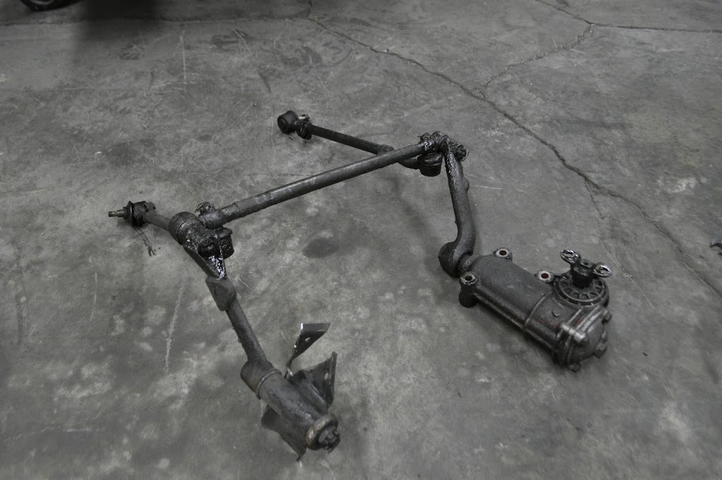

    Removed the stock steering box and pitman arm assembly tonight. This will give me a lot more clearance for the oil pan and transmission bell housing.
    Dummy block and transmission being pulled:

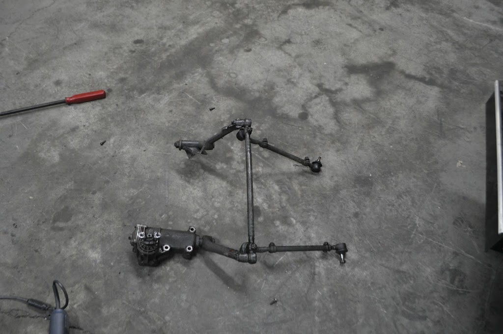

    Here is the stock Steering box and linkage assembly. Notice how far up and back the center linkage is:

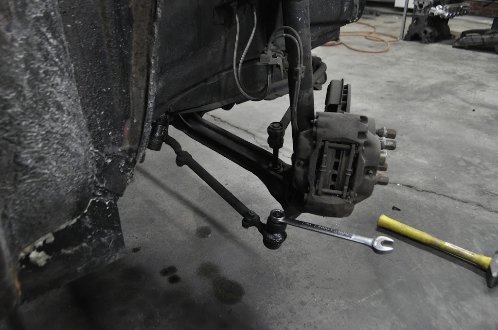

    Removing the tie rod ends:
    Stock assembly removed. Also saving some weight compared to the lighter steering rack:

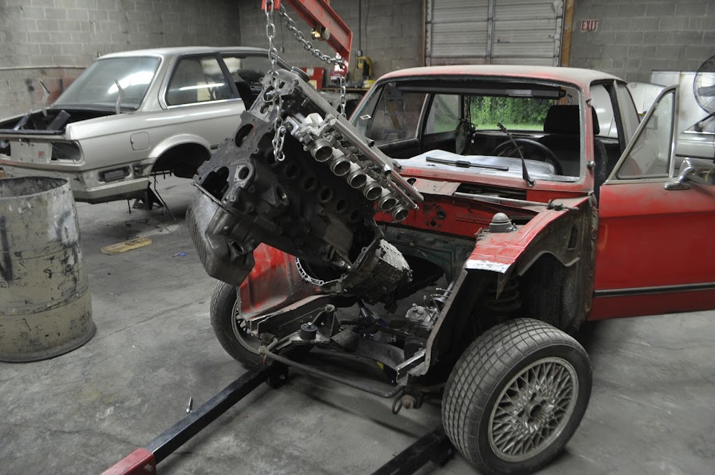

    Stripped the e30 over the weekend. Pulling the motor gave me a chance to finally use my new to me Engine Hoist I picked up a few weeks ago. American made, I can't tell you how much nicer it was to use that the 'import' branded versions. (America, F$CK YEAH!)
    Engine and trans pulled without to much fuss. Although I forgot to drain the autoTragic of it's lifeblood before tipping it at a 45 degree angle. I was rewarded with a 6ft x 6ft puddle of red trans fluid. It looked like I just slaughtered something lol. You can see the quick-dri spread around on the floor to soak up the mess:

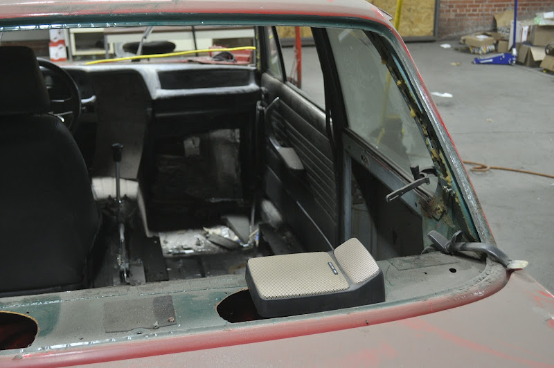

    Then I turned my attention to the interior. Namely the rear seatbelts, the third brake light, and the rear speakers. The seatbelts will be used with my e24 rear buckets, they bolt right up and look pretty much brand new (forgot to take pictures, sorry). The rear brake light also looks to be in good shape. I haven't decided where I'd like to mount it though.
    Bottom of rear window:
    Or top of rear window:
    Pretty excited for the rear speakers as well, a two-piece design with a woofer and tweeter. The housing look fairly period correct, and match the square taillights nicely. I'll probably paint the grills black or silver, depending on what flows nicely with the interior.
    First I tested them out on the shop stereo to make sure they worked and sounded good. Luckily for me they sounded great:
    Test fit on rear shelf, kinda hard to imagine without anything else in the interior though:

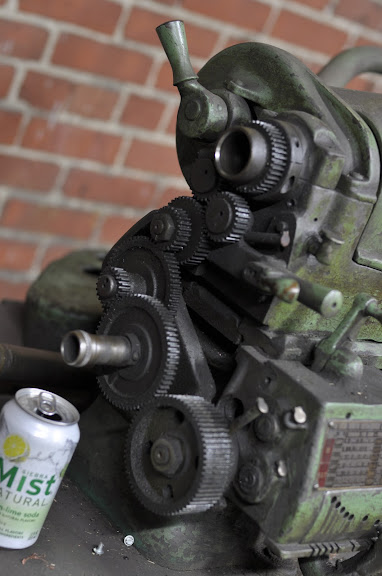

    And just because it will be used to make parts for the car, I wanted to show you what took up all of my free time for the past two months. Remember the lathe I bought? I decided to restore it to ensure the parts I was making would be high enough quality to put into the car. I completely dismantled it, painted it, replaced all worn out leadscrews/nuts etc. It's basically brand new, short of re-scraping the ways (they only have ~0.0015" wear right now), which I plan to do once the car is finished.
    This is how it was when I got it:
    And this is how it sits now:
    I still have a few parts to button up on it, but it made it's first chips the other night. Night and day difference, I feel much better about using it for critical parts now. Overall I'm hoping to make:

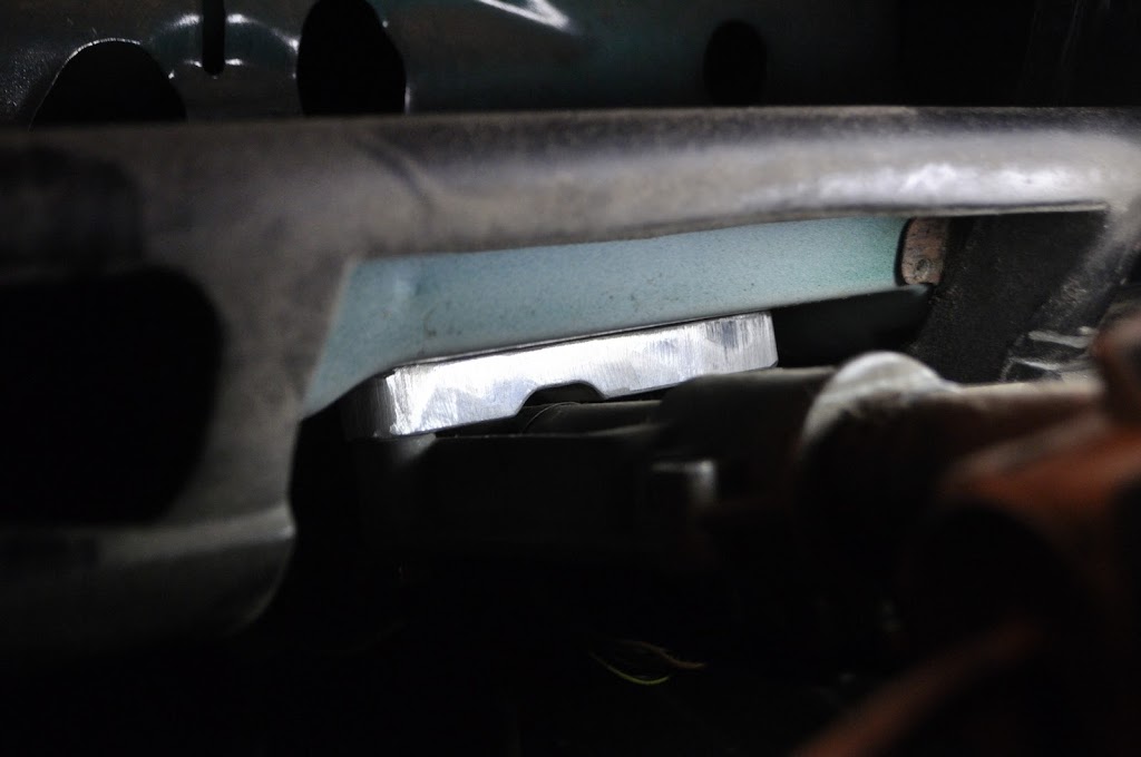

    The next thing I tackled was to get my new seat mounts drilled and mount the seats back up. Unlike the original Recaro mounts, these utilize the stock '02 sliders and let the seats sit roughly an inch and a half lower in the car. Sadly I forgot to get pictures of the mounts, but I'll be sure to show them when I take them back out for powder coat. The only issue with the lower seating position is that the steering wheel now felt a lot higher. So I took some 0.75" aluminum plate I had and machined a spacer to go between the steering column and the dash mount. This dropped the steering wheel the perfect amount. Here's the mount intstalled:
    With the new seat mounts and steering wheel position figured out I put the e46 e-brake handle in place. To do this I cut off the original mounts for the '02 handle, and then welded in a flat plate with the correct mounting studs. The e46 handle just bolts down in place, with the stock brake cables running up from the stock location.
    About 2.5" of clearance between the handle and the shift assembly. Plenty of room...

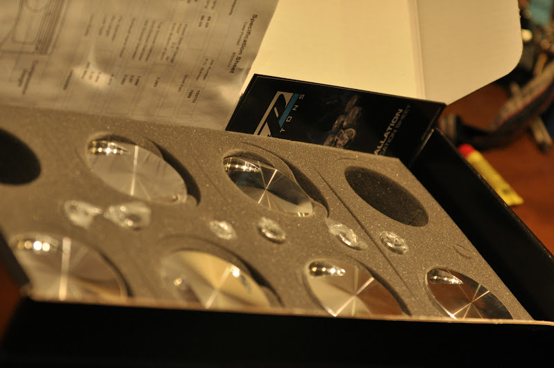

    So after 3 months of waiting, They finally arrived!
    Specs:
    86mm Bore
    10.5 CR
    Intake valve relief 4.7mm
    Exhaust valve relief 1.9mm
    289 grams
    Total Displacement will be a hair under 3.2 L
