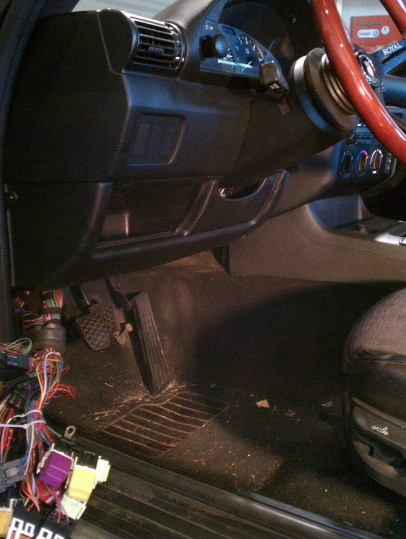

 I then decided that since I got the euro glovebox in, why not tackle the driverside cubby. Of course there was yet another stupid metal pad.
 Then of course a bracket had to be welded to the frame to keep me from a straight bolt on install. (That polkadotted rusty bracket)
 I decided that a dremel was smarter than an angle grinder this time.
 After that was off the piece fit well=)
 I did notice that you can see through the opening below the column. I believe that is because the metal pad covered that a little before. I'm going to make a little plate to sit there to pretty it up.

 Could get you the plastic cover that goes under the steering wheel... ours are in a different angle then yours, didn't keep that in mind when getting you the partsOriginally posted by Earl View PostI did notice that you can see through the opening below the column. I believe that is because the metal pad covered that a little before. I'm going to make a little plate to sit there to pretty it up.
 you wouldn't need to make your own plastic piece then
 I can take a pic how it looks in our car, later
 Not a problem Kitty. A picture would be nice. Do you guys have tilt steering? We do not=( Our column is non adjustable.Originally posted by bimmerbabe View PostCould get you the plastic cover that goes under the steering wheel... ours are in a different angle then yours, didn't keep that in mind when getting you the parts
 No, in Germany the tilt steering wheel never came. AFAIK this has never been an E36 Compact feature at all, not even as an extra.Originally posted by Earl View PostNot a problem Kitty. A picture would be nice. Do you guys have tilt steering? We do not=( Our column is non adjustable.
 Steering wheel height adjustment has never been a standard item in the E36 range. This was always a special feature that was quite pricey, too... therefore it's not *that* easy to find out there... at least that's the standard in Germany
 But there are quite a lot of people here who put the adjustable piece from a Coupe in, I heard that works quite fast and easy

 I would have more if the euro spec interior has more things that were different. It is quite off to me that the US dash frame has those mounts welded on instead of being bolted on. I should make writeups for the glovebox and drivers side install.Originally posted by frink84 View Postmore cool euro-spec stuff! nice.
 I'm assuming you change out the whole column then? I may have to look into it. Luckily for me, the steering wheel is at a perfect angle for me anyways=)Originally posted by bimmerbabe View PostNo, in Germany the tilt steering wheel never came. AFAIK this has never been an E36 Compact feature at all, not even as an extra.
