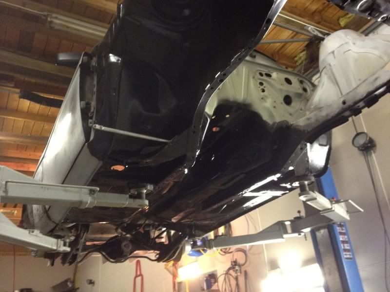

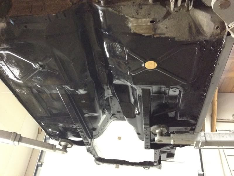

    well, finished the paint on the underside of my car now! i think it looks ok now :P
    Next thing on the to do list is to get it down on the wheels again, but this time on coilovers! So i have started building a rear axel! took a volvo 740 axel since its 10 cm wider then the 240 axel, and strippd of all the brackets and shit :P

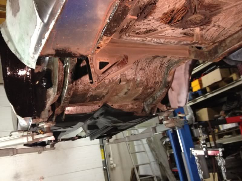

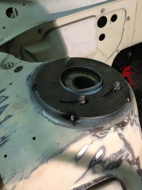

  • volvo242
    replied
    test fitted the rear coilovers! just hadd to see how low i can go before i removed the rear axel!
    Stock hight shock vs coilover! aprox 7 cm shorter :P
    On the car, still 5 cm more to go on the coilovers
    I then removed the rear axel so i can get on cleaning the underside of the car :P
    NASTY job by the way.. that shit gets everywhere and i look like a caveman after an hour under there :P
    Got tired of that and did some welding on a few hard to reach places (but no pics of that) :P almost ready for some paint now!

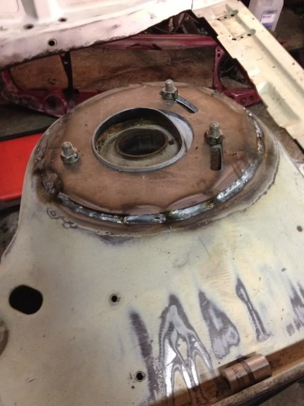

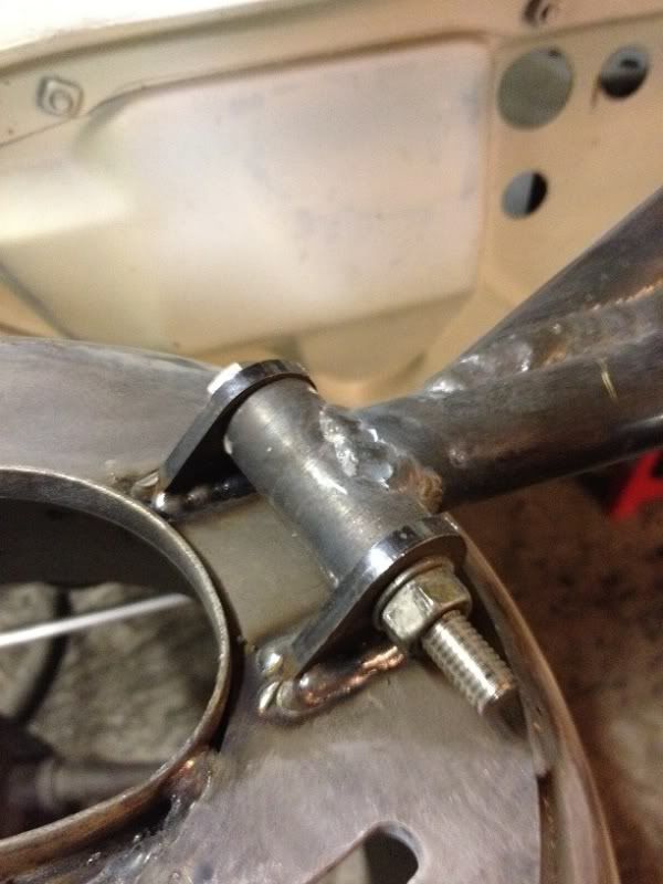

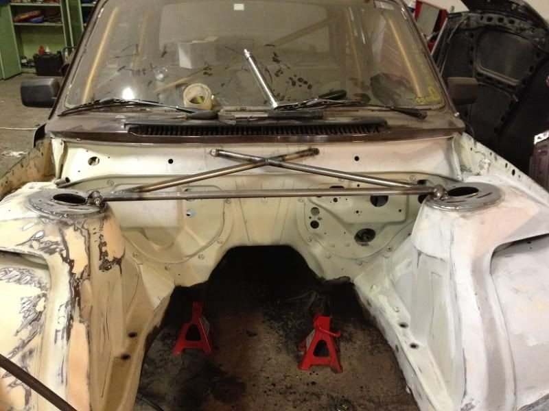

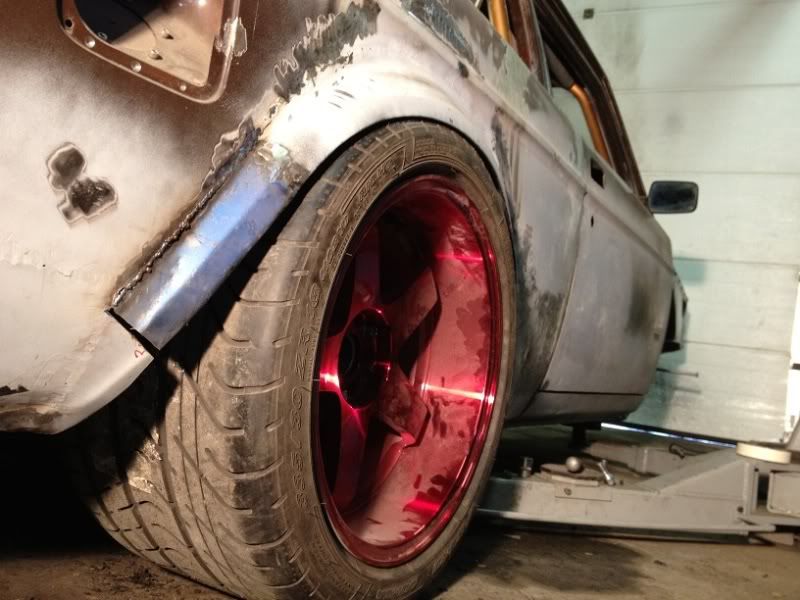

  • volvo242
    replied
    some pix from the last few days :P
