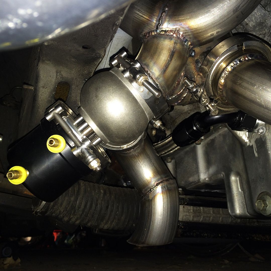

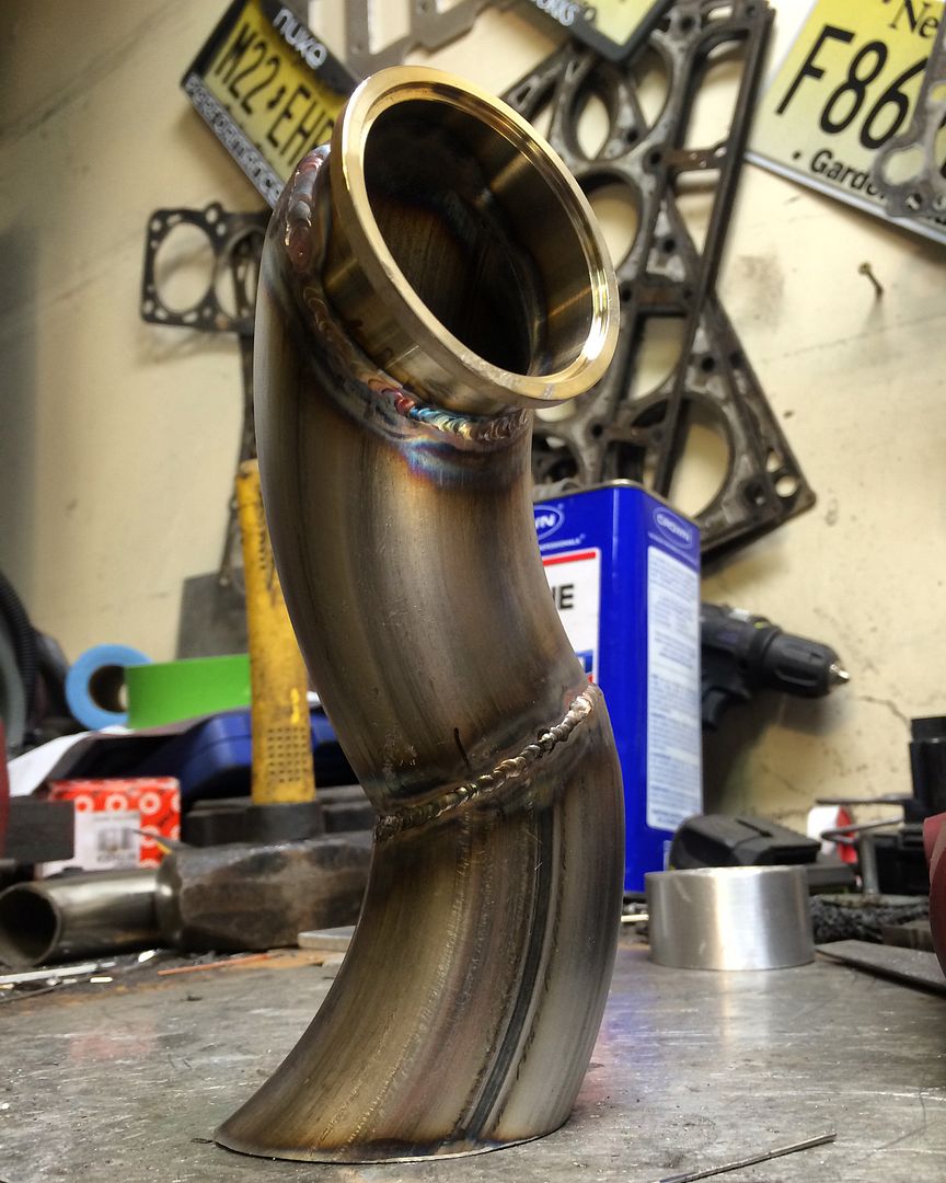

  • Finally put the manifold back in and mounted the wastegate and made a dump pipe.
    At this point I could fire it up, but for some reason I'm in no rush.

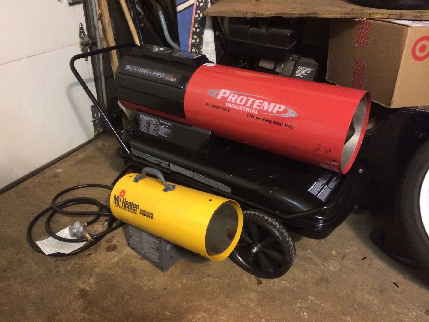

    Also got a crazy deal on a heater for the garage so life is beyond good.
      dope heater, keep it ventilated in there though, those fumes will get to ya.
      Instagram: ian_ballzz
      e30 build thread
      • Originally posted by eethirty View Post
        Yeah when I got it it was running stupid rich so you couldn't even use it.
        Got it adjusted and at 220k btu I run it with the door cracked and then close it after.

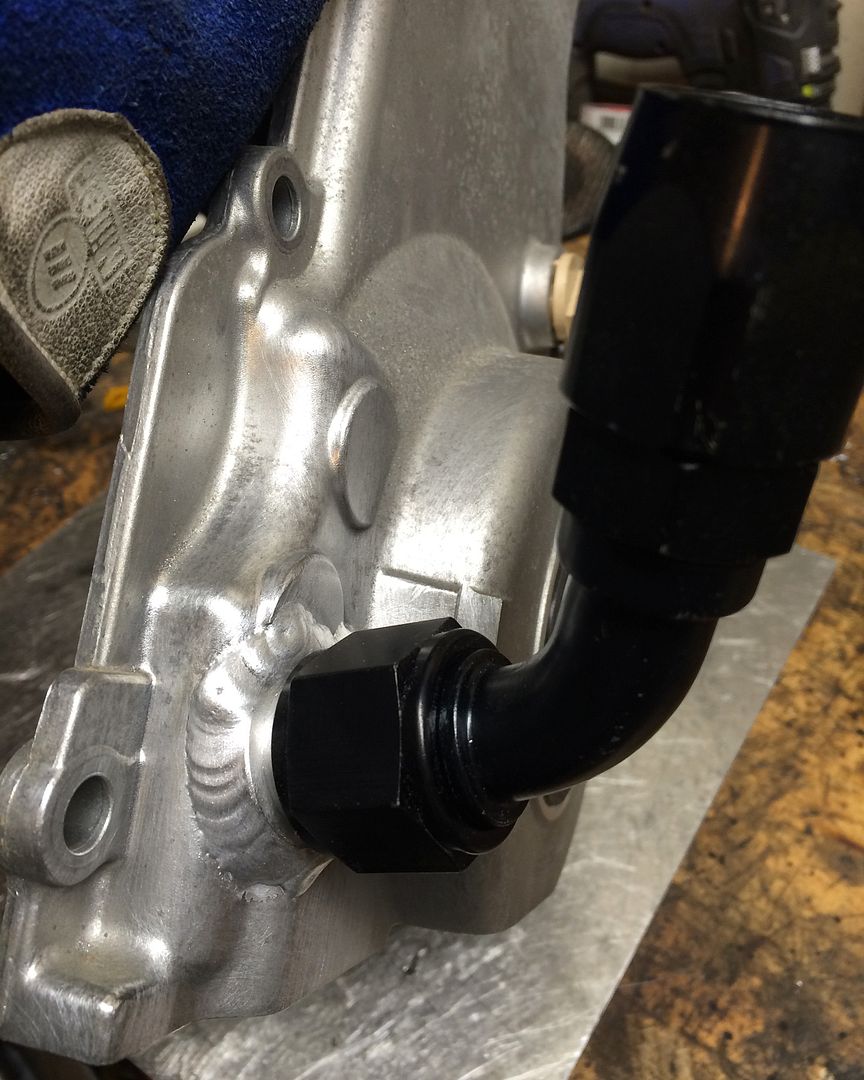

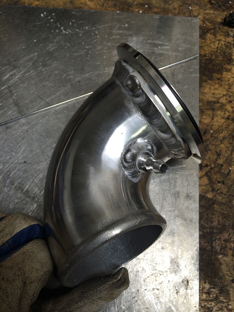

          • Welded up my drain to the timing cover so it clears everything.
            Welded a nipple on too for wastegate signal line.

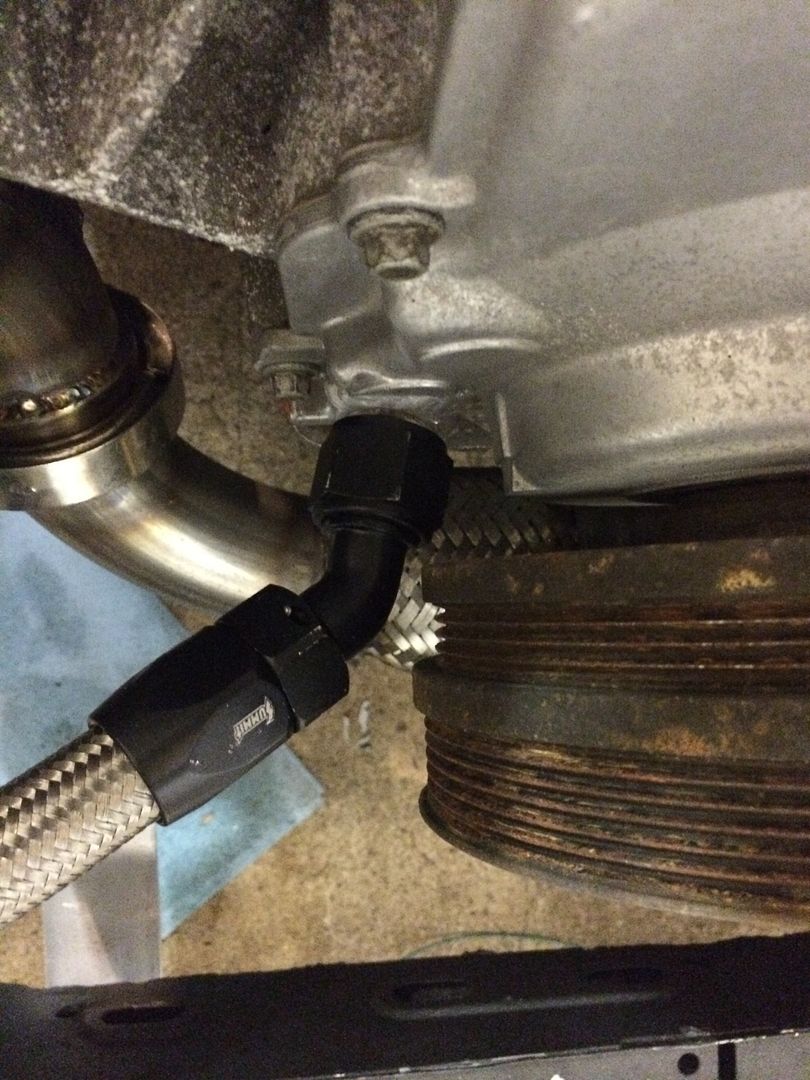

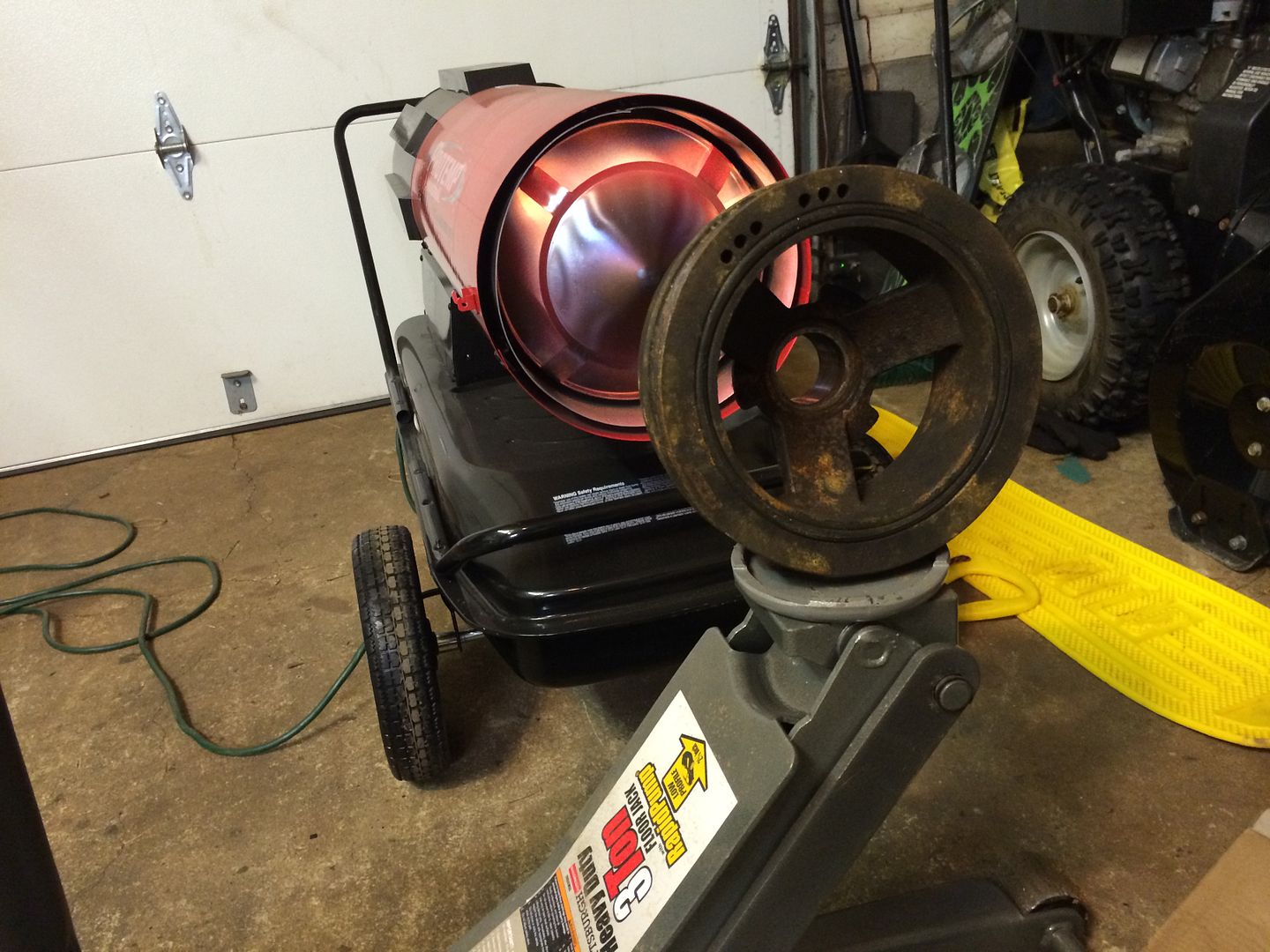

            • Slid the crank pulley on, turbo drain clears just right.
              All I need now to start it is a fitting for the drain flange.
              The one I had was damaged.

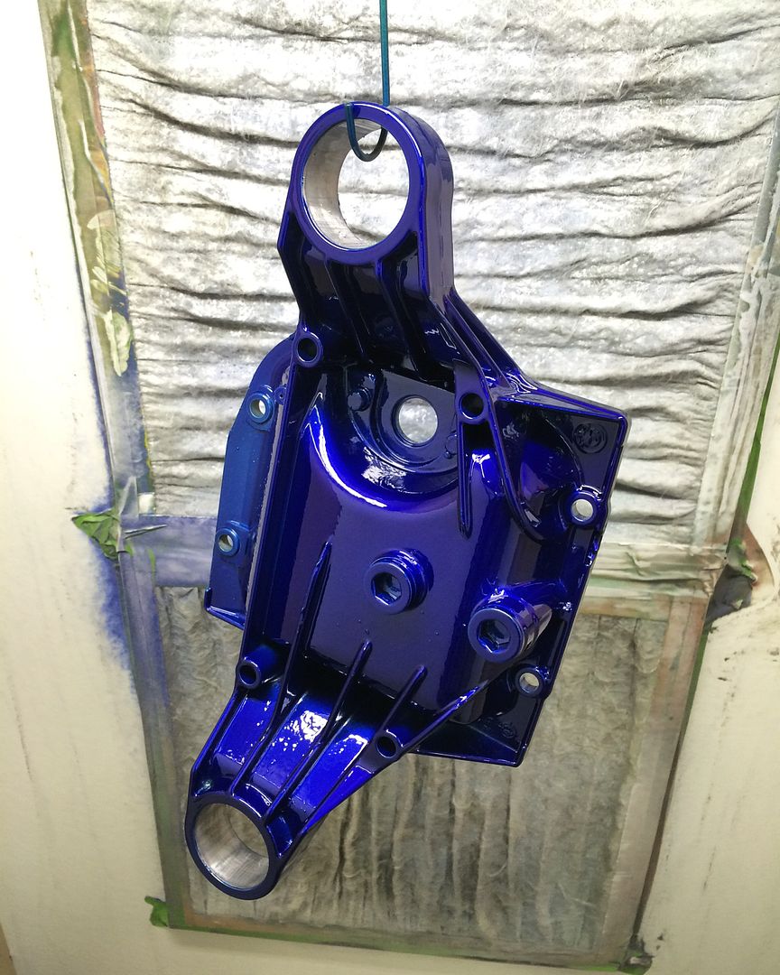

                • My brother powder coated my diff cover, let me know if you need any work done.
                  Going to have a bunch more stuff done to match, just wait.
