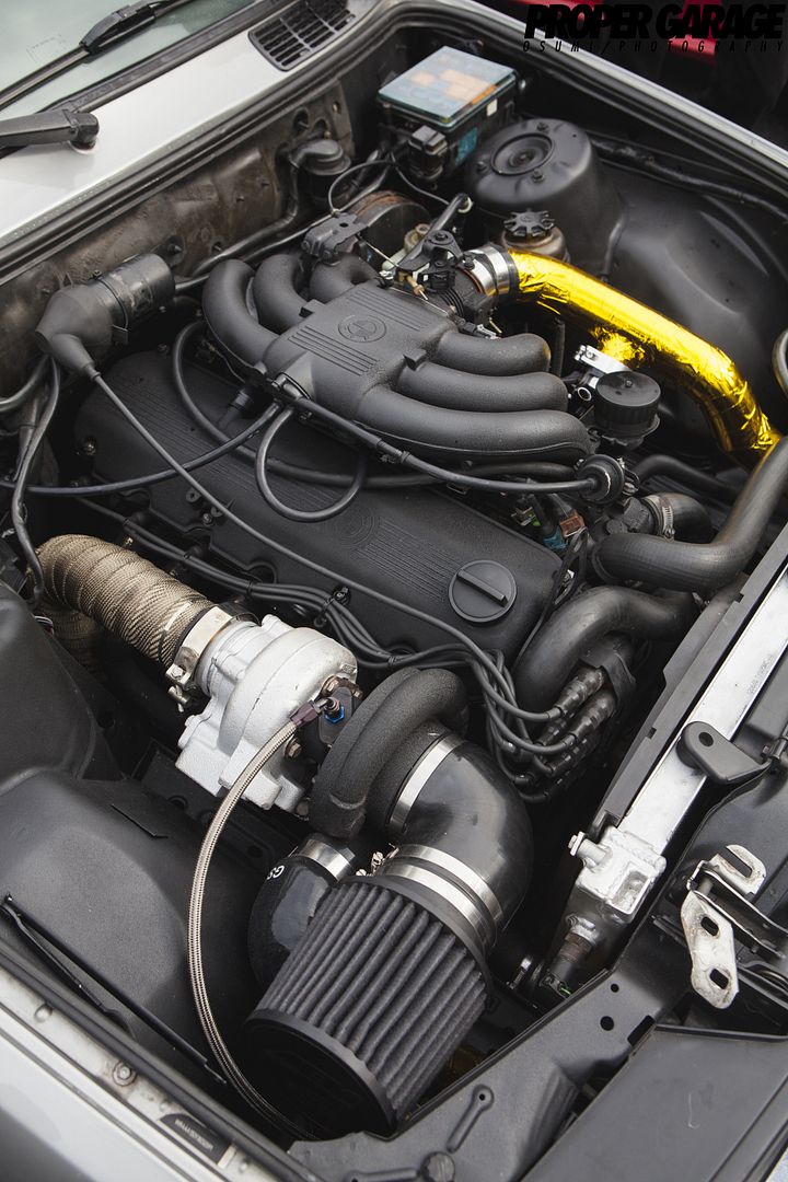

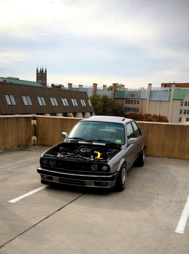

    The first version of my car was the stock 2.5 with a Holset HX35.
    It made good power, so I replaced the HG with an MLS and ARP studs.

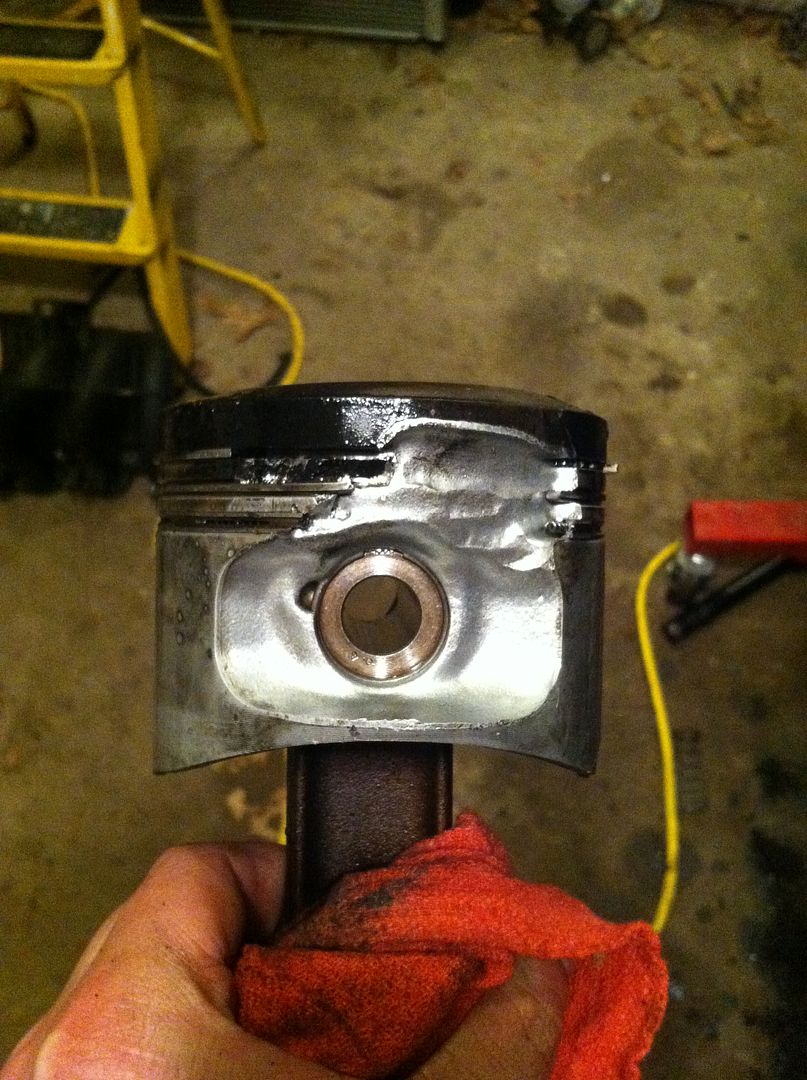

    Ended up melting a piston before getting bigger injectors and more boost.

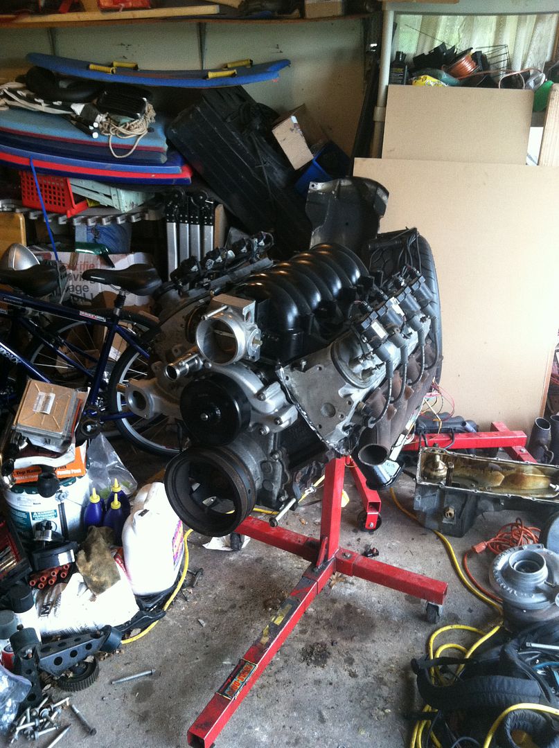

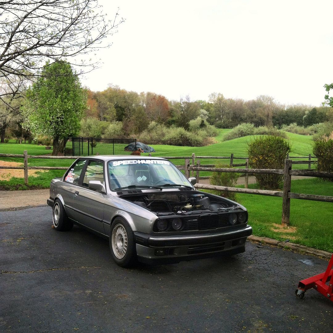

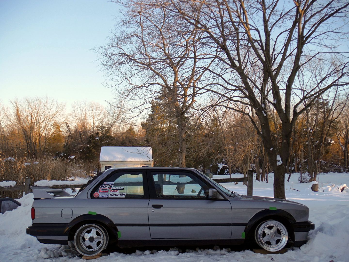

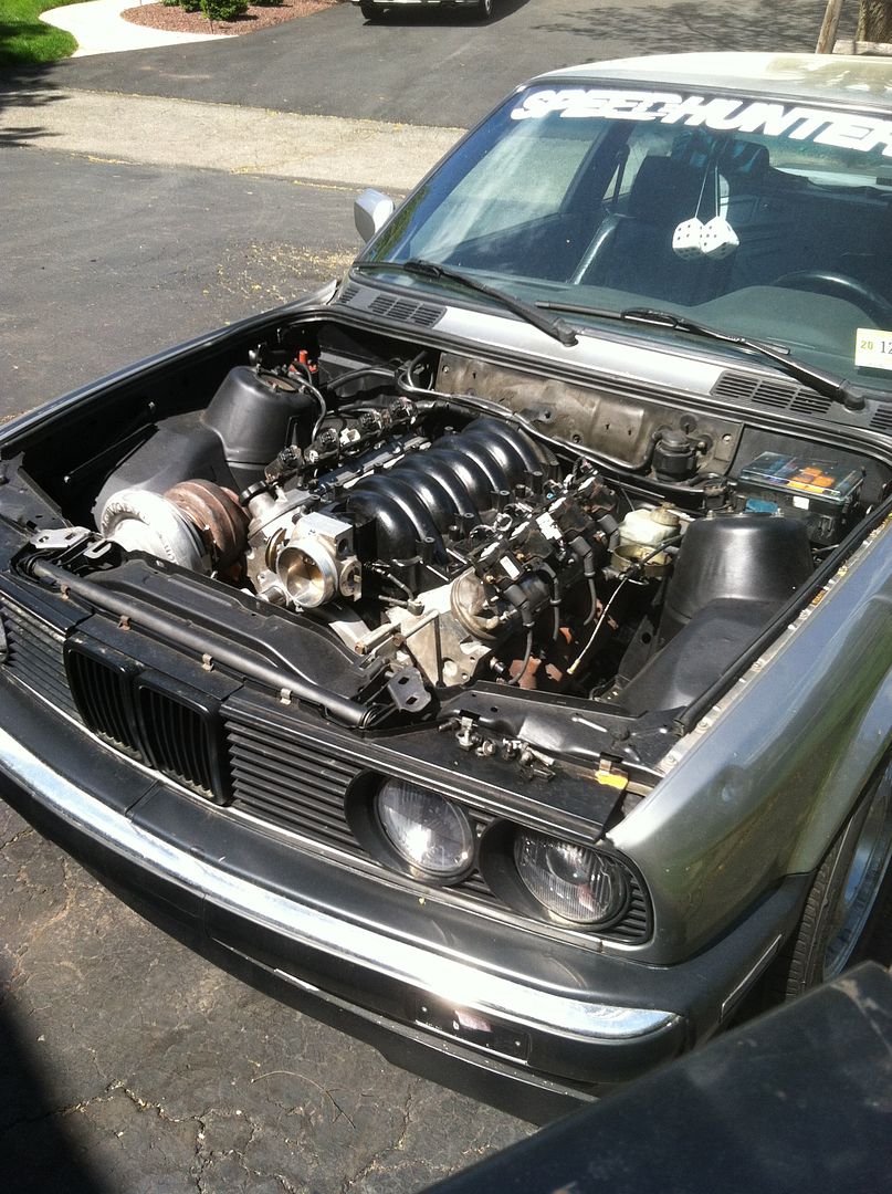

    I sold off all of my e30 related parts and everything and have started collecting LSX parts. The plan is a 5.3 LM7 with ls6 intake/cam and LS9 HG's and ARPs and a T76 or TC76. Here's some picture of the car so far and the exterior changes planned.
    Let me know what you think and if you have any advice, please let me know.

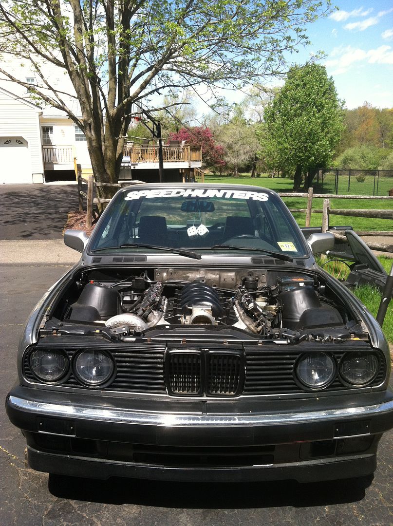

                Finally put the banner on, it will look good with all the exterior changes

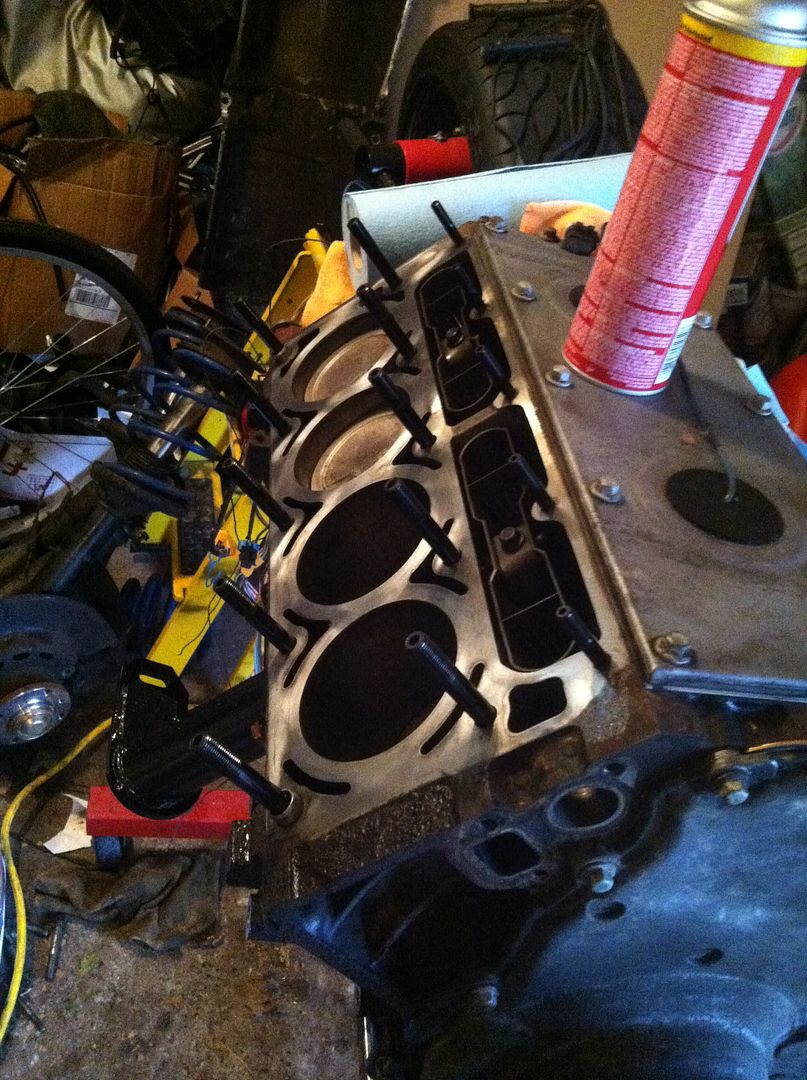

                ARPs to hold the boost

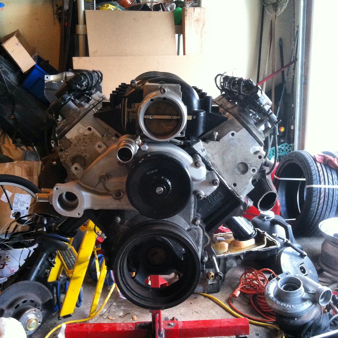

                All mocked up, got gto oil pan too just need to notch it

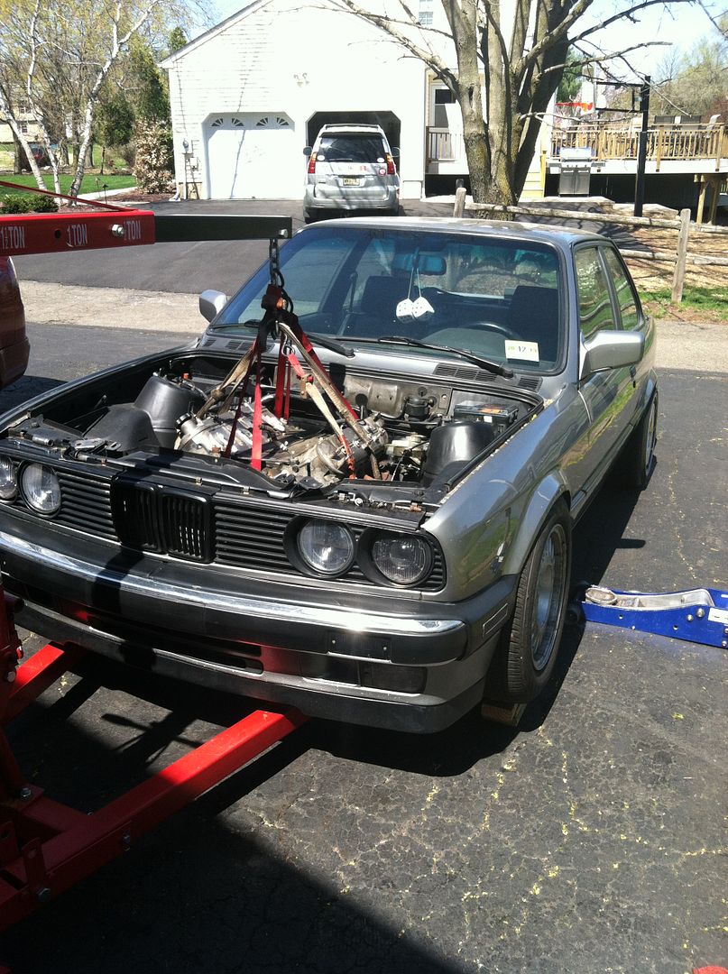

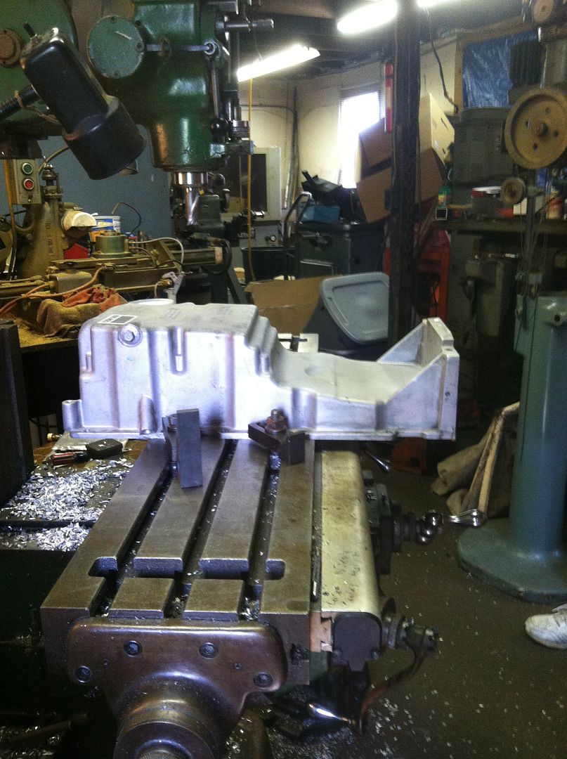

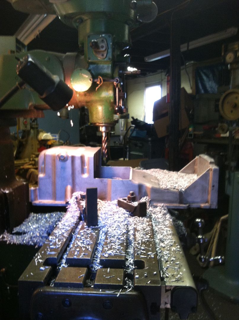

                    Notched the gto oil pan today

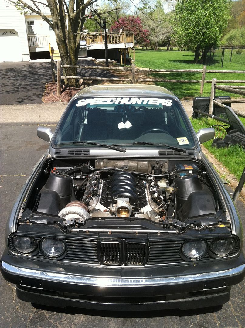

                    Test fitted with manifolds and oil pan, hx52 mocked up for size
