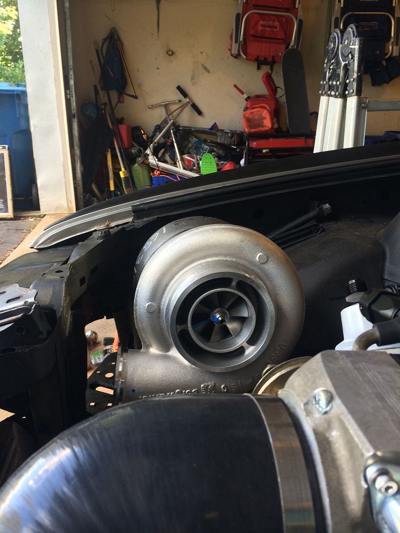

where did you source the goodies? Pricing?
60mm JGS wastegate from Race Part solutions for $500Originally posted by nsogiba View Postwhere did you source the goodies? Pricing?
Tial 50mm Q BOV I bought over a year ago for the hx35 so I forget.
BW S475 I got for a steal, $700 from Smeding Diesel.
The vbands, sandwich plate, and spark plug boots I got from Squeeze Performance.Instagram - @Dirk_LSXT

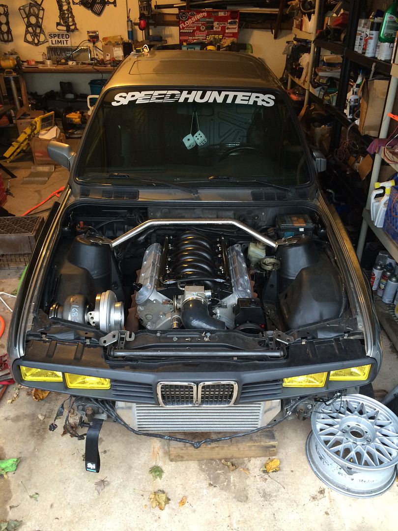

anything between the downpipe and fender? straight dump? shit's gonna be loud!
Once the crossover is all finished I will indeed dump it out the fender.
5" fender dump and 2.25" valence dump for the wastegate for everyone's enjoyment.

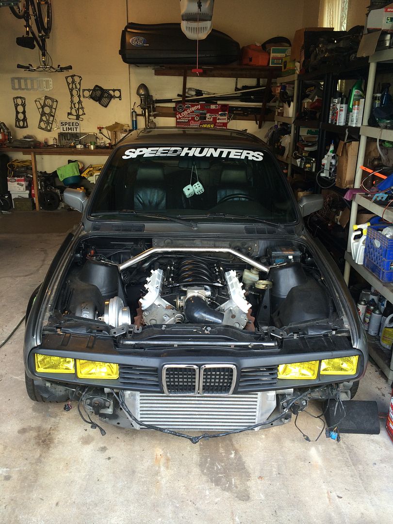

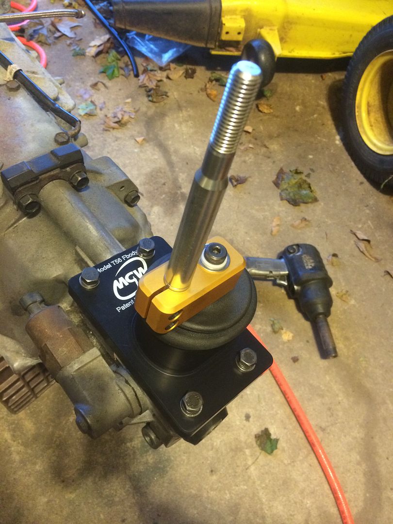

So I ordered an MGW shifter, Monster clutches Lt-1sc w/ lightweight flywheel and a circuit soul shift knob. So far I've only received the shifter so here's that, very nice piece.

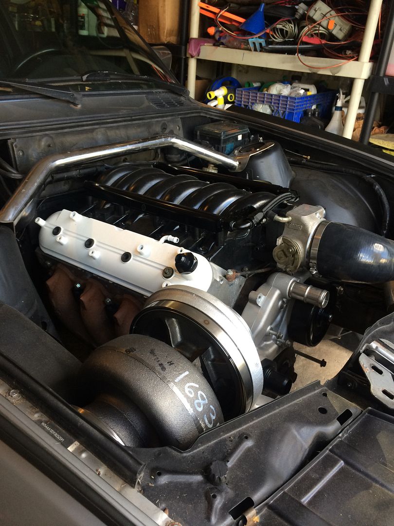

Shaved the valve covers and installed power steering and alternator.

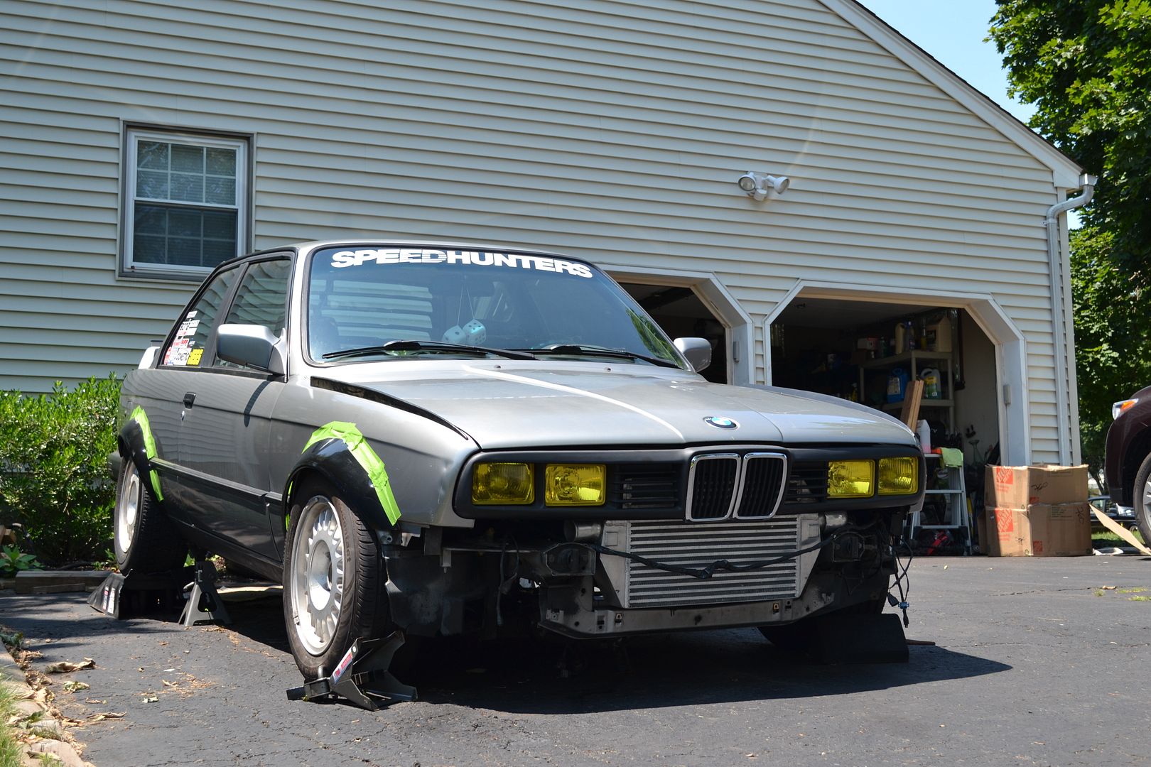

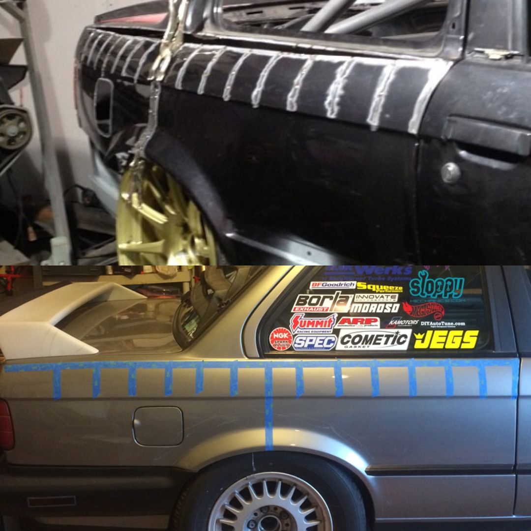

And I'm contemplating cutting up the car instead of sticking cheap fender flares on it like everyone does.
