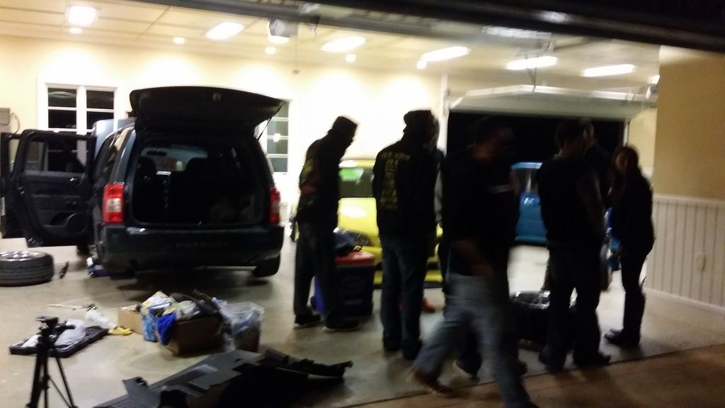

Import Alliance was an absolute blast. I'm so glad we made the trip up there. My bag setup had a melt down on saturday night, when I would air up one corner (rear drivers side) would instantly dump. Checked the lines, leader lines, checked the bag for leaks with no luck. A friend showed up and we pulled his VU4 and replaced it with mine to see if a valve was stuck, which wasn't the case in the VU4. After an hour of tracking down the problem, it turns out it was my exhaust dump setup. I'm not sure how it failed but it did and the "solution" to get home was to run at hose from exhaust to exhaust and not be able to air down until I got home. It worked good getting it home but need to figure out how to fix it.
Was able to park in the showcase lot, and everyone absolutely loved the patriot.
The garage picture, we had about 30 people watching us fix this, and a good 5 people actually helping.
