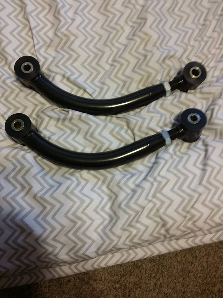

                          • Well, my custom camber arms are here! Still awaiting my custom toe links from the same company, they are about a week behind due to a late build start on these compared to the camber arms. I should be able to hit -10* or more in the rear but in order to do that I need to rebuild my wheels, or reverse mount?
                            • Your SSRs cannot be reverse mounted. Your SSRs are also probably welded barrel-to-lip, so take that into consideration.
                              • Originally posted by Oh Damn, it's Sam View Post
                                I just read up a little more on the reverse mount process, which I now see why I couldn't just flip them and rebolt the faces. I know they are welded, part of the reason I haven't rebuilt yet. I find it a little hard to swallow $400 fees to cut the lip and barrel apart to rebuild. That's 2 new lips on another set of wheels.
