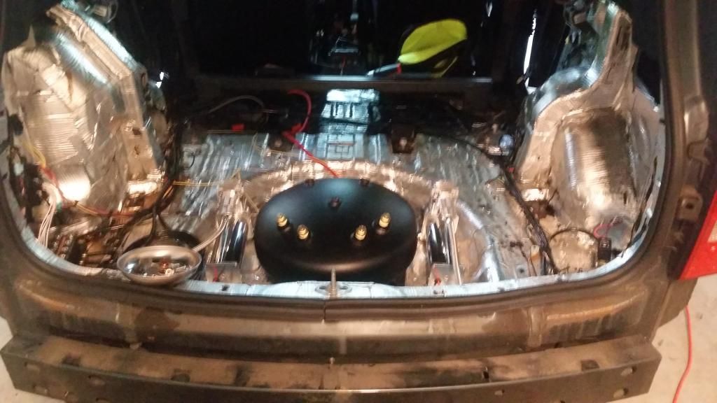

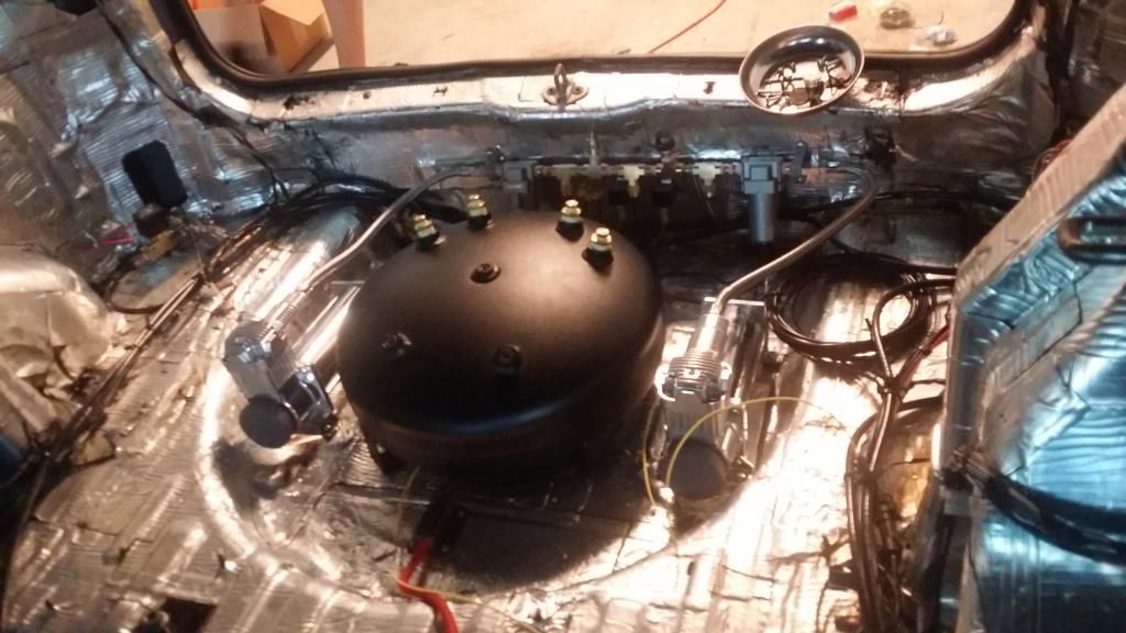

Today we got most of the electrical system wired up, just a few more ends to button up like grounding the vu4, mounting my tank down, leak testing, and run the wiring for the rear bags. Then install all 4 bags and turn it on.
It's not "difficult" per se if you take your time. The downside is its very time consuming. I've had a friend helping me for 9 hours and only got the wiring partly finished, had I've put 6-7 hours in it prior to today.
I'm attempting to take my time attempting really learn the system. Once everything is functional I'll start moving things and cleaning it up a little bit but for now function is the biggest problem.
