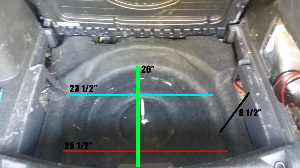

      • Went out and took some measurements of the trunk, also for the time being I think "if possible" i'd like to run one single tank and then eventually expand when I'm ready.

                          • So if the bank has deposit envelopes when I get off work, I'll be purchasing my dual 444c compressors and the pancake tank today or tomorrow. It'll get me started on the trunk area and then I'll go from there. I'm going to check with Bagriders again and see what they recommend for bags again, just to see if the air house 2 and the aero sports are still the best option.
                            • Awesome!
                              If you're going to plug all the top ports on the pancake tank and just do everything through the bottom, consider using flush plugs like these: http://almabolt.com/pages/catalog/al...ssureplugs.htm
                              They'll net you another 1/4" of space on the top, and they sure look a hell of a lot nicer than regular NPT plugs.
                              One other thing to think about: the bottom port on that pancake tank is going to be challenging to get to, depending on how you orient your tank. You may want to think about some kind of remote drain, whether that be a fancy electric one or just mounting a standard drain on a hose that runs out underneath the car or something.

                                Those plugs look really nice, and might make the tank pop a little more. I'm feeling the bottom mount of the tank but unsure of how to make it happen really. And will air flow be a problem?
