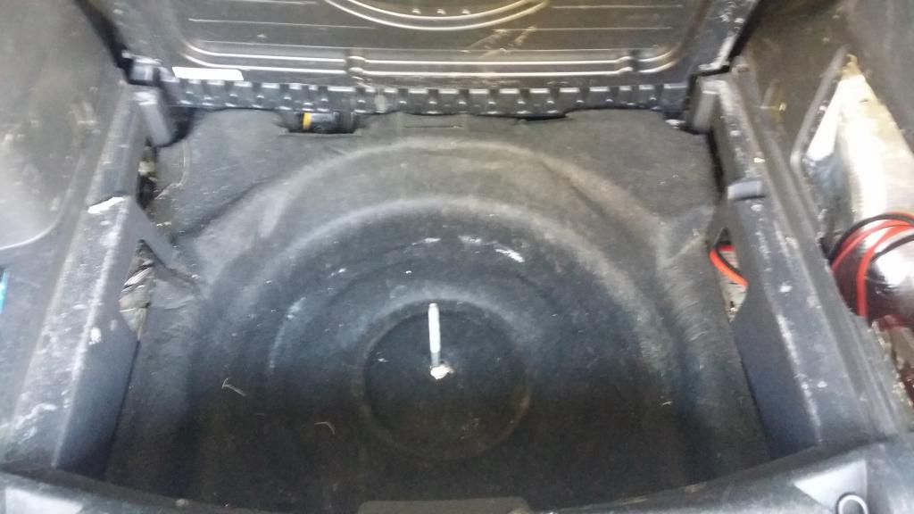

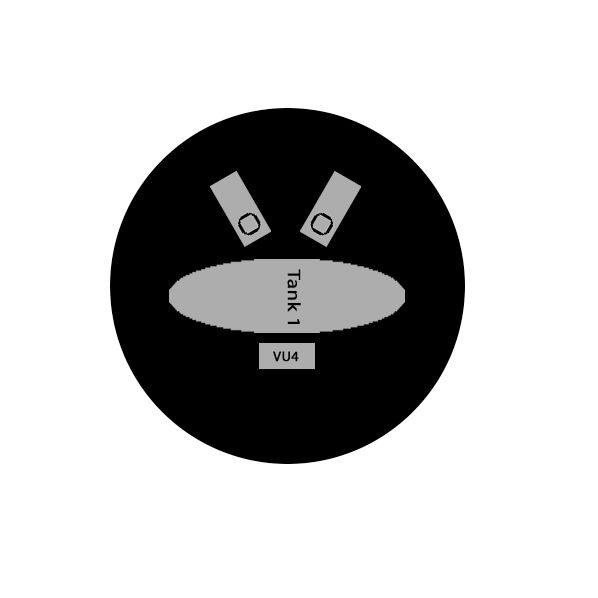

                          • I'm just going to throw a few things out and see how it goes. I'm torn between going one tank 5-7 gallons or two tanks 2.5-3 each.
                            Space where I've decided the setup will go, I'll grind down the post in the middle when the time comes. I just hope this the false floor will close!
                            One tank idea:
                            Two Tank idea:
                            • Are you going to display the components, or do you want them hidden?
                              You might consider the Air Lift Pancake Tank for that location: http://bagriders.com/modlab/products...CAKE-TANK.html
                              • Originally posted by Oh Damn, it's Sam View Post
                                Part of me wants hidden, while the other part want's to clean the rear hatch area up and make it "showy". I think for the time being, I'd rather get it in there and tucked away, and once I get the car to another level, go back and start doing hardlines, and clean up the rear end to get that covered. My rear plastics are beat up really bad, and that awkward cutout from when I was 16 and felt like that was a great idea to install a subwoofer behind that panel (which blew) so that's a little more than I can handle money wise right now.
                                The pancake tank may actually be a good call, I'm worried with a circular tank the false floor is not going to be able to close.
                                My concern is nowhere it lists it's max PSI.
