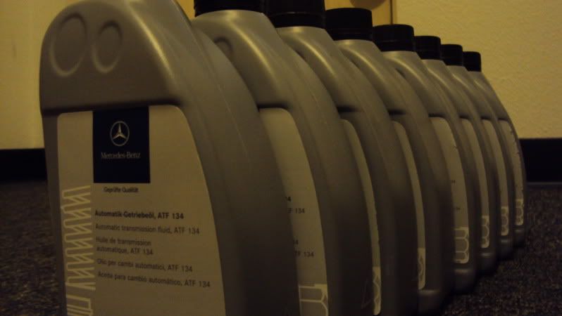

    It had a major tranny leak from a loose torx bolt from the previous owner, so i had to buy plenty of ATF until i built up the courage to do so. i also bought a flat hood badge because i didnt want anything on the hood and i replacement mirror for the drivers side because it was broken.

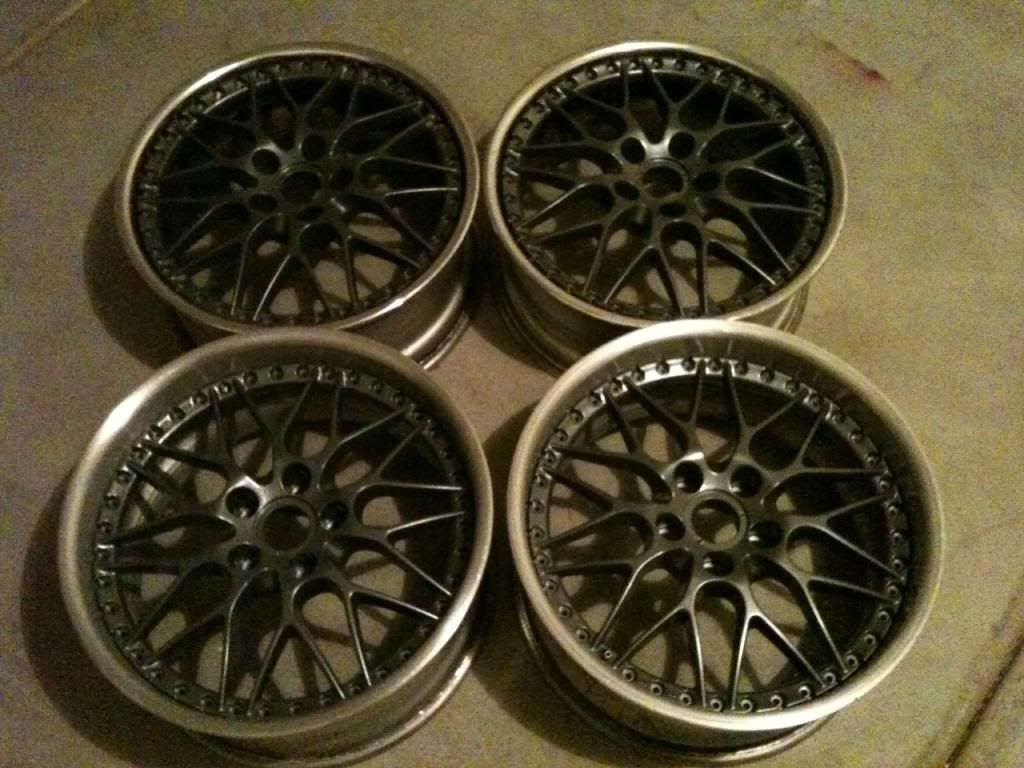

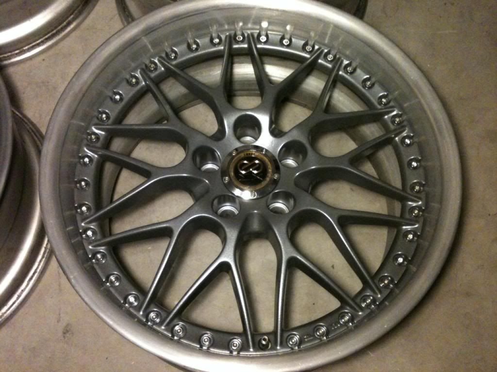

    18x8 +38 Enkei Aegis 2 Piece 5x112 rims

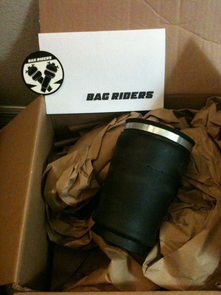

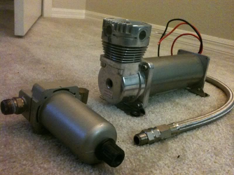

        Thanks for the love fellas . I also forgot to mention i am piecing together a air ride kit for the car. So far i got the compressor which is a viair 480c 100% duty cycle with water trap. 4 tapered bags from bag riders and a 5 gallon air tank.
        I need to figure out if i should run 8 seperate valves vs a valve manifold so i can go FBSS.

            I can already tell this is going to be good. Will this be at wuste in june ? And not to nit pick your build apart but are you sure that the tapered bags from bag riders are going to be able to lift your car appropriately up front? I was told, and mind you my W202 is slightly smaller and lighter. that the tapered sleeve bags , and the firestone sleeve bags that they carry are cutting it VERY close in terms of how much load they can take. I was informed by others who have bagged older mercs and thru emails with bagriders that on our cars or the type of suspension that these older mercs have that it is better to go double bellow. Such as the re5 or ss5 front and rear. You get a higher PSI rating on the bag and it has a higher load rating. Just some food for thought. plus I know that the double bellow bags have a smaller compressed height so that means. MOAR LOW!
                Thanks for the concern man i appreciate your opinons. I tried contacting mr "sideways asian" about his w210 sedan air ride setup but came unfruitful. I used context clues from his for sale thread and found out that he got his setup from bag riders which were 4 tapered bags from airlift company. I contacted John from Bagriders and he told me with the amount of contact around the spring (1 inch from front/rear shock and 1inch from frame) the best selection would be firestone 7076 or tapered bags.
                BUT.. he also said with the firestones the may be an issue with rubbing inside the bags when deflated thats which leads me to my choice of tapered bags. I will need to make some brackets to compensate for the stubbyness of the spring :P.

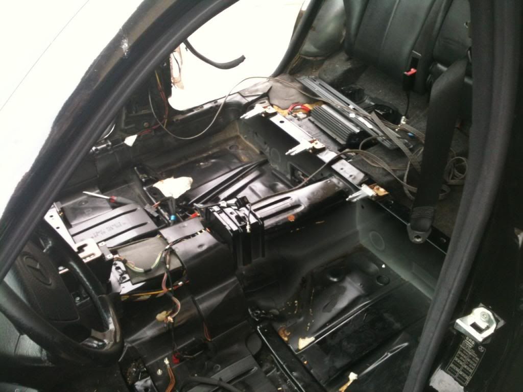

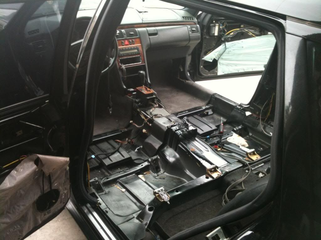

                      Was fed up with the lack of technology in my car so i upgraded the sound system to a Kenwood Headunit.. Has BT and AUX but no cd player since cds are now dead tech. Ill post pictures of that once its installed. Here are some removal photos...

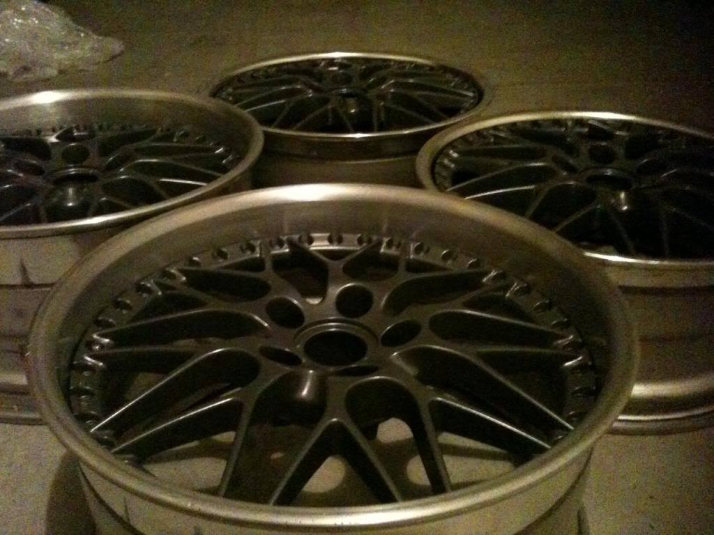

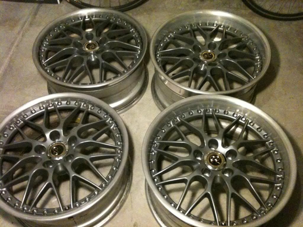

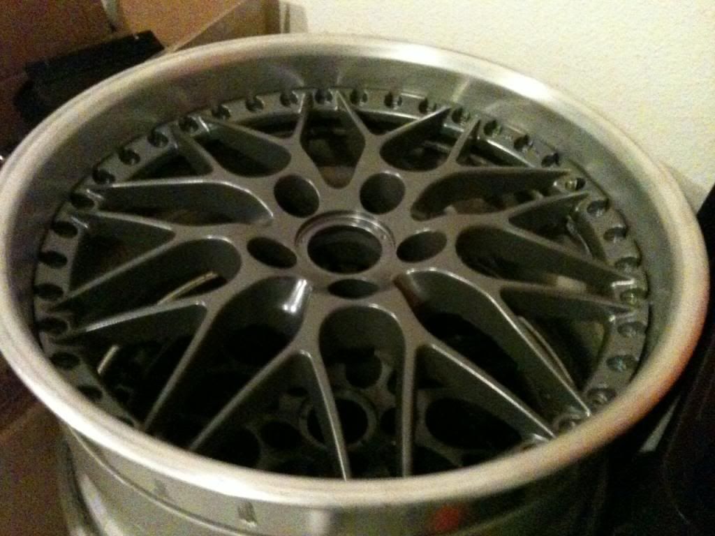

                      And i got these rims put together finally. I wish the polish on the barrels were better but this will have to do for now.
