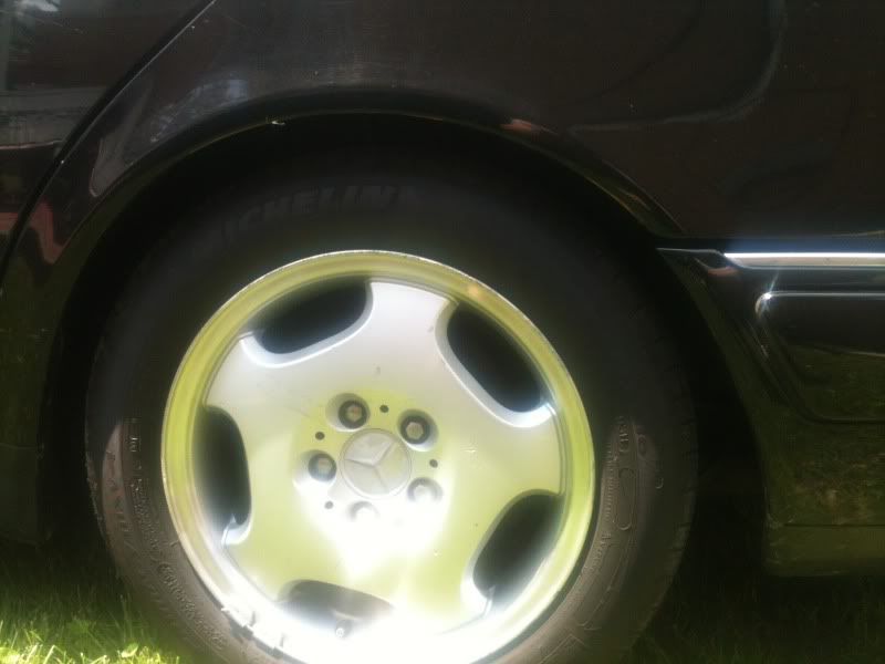

    those porsche twists are sexy as fack!
    • #32
      what porsche twist ? Those are OEM mercedes alphard rims.

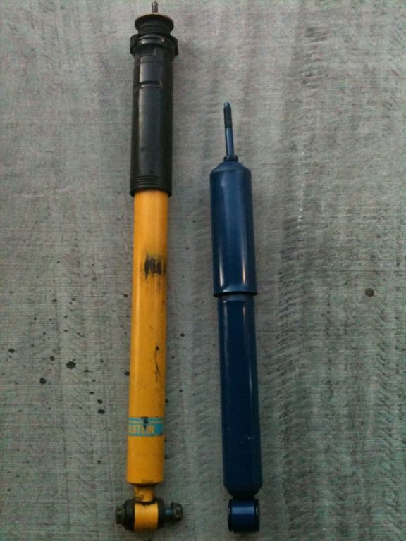

              I got a pair of 1970 Dodge Challenger Front Shocks from O'Reilys right meow that im ready to mount on the rear. I almost forgot that the rear springs off wagons are SLS springs so they have a softer spring rate. So im going to order some aftermarket Eibach springs all around so the Monroe shocks wont bottom out and to balance out the ride on the wagon. (just for a good daily, those cut H&R springs were a bouncy nightmare)
              Bro your car is amazing. Im always on it constantly looking for updates
              EDIT:
              heres what i bought. Monroe front shocks from a 1970 dodge challenger
              This is a side by side comparison with a bilstein sport shock off the front of a w210

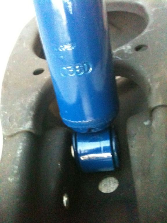

              Here is the monroe shock mounted on a w210 sedan rear lower control arm w/o SLS
              As you can see theres some space between the mount. Can anyone help to solve this space between shock mount and Control arm issue? i was thinking washers.

                  I think washers or rubber grommet on each side would work. I like where this is going!

                    nice ! for sure some washers should clear that gap right up. Let me know how the ride turns out plus some shots of the finished product after install. Im interested in what you're doing. i wanna know how much lower these will drop it than the factory shocks.

                      ill head to home depot tomorrow and stock up on some washers. thanks

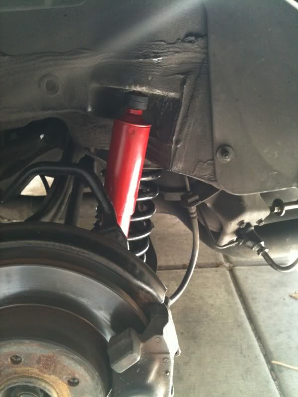

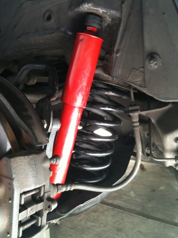

                            OVERALL! the rear sits 2 inches lower than the front because of the shorter shock. Next in line is 95 ford ranger shocks. Wish me luck

                                these are the only pics at the moment. ill get some better ones later and here is the new rear setup:
                                - 2000 e430 sedan rear lower control arms
                                - 2002 e430 sedan rear springs
                                - 1995 Ford Ranger Front Shocks 2wd 4cyl
                                or bilstein 4600 for ford ranger
                                Free Shipping - Bilstein B6 4600 Series Shocks and Struts with qualifying orders of $109. Shop Shocks and Struts at Summit Racing.
                                this is the current ride height. as you can tell from the stock images in the first page, the rear now sits a little lower than stock. To balance out the front ride height i kept the eibach springs and the bilstein HD shocks.
                                Now the power steering lines connected to the SLS rear shocks will need to be re-routed or completely removed. I chose the lazier route and capped off the accumulators with a large bolt (from my bucket of bolts so i dont know what size sorry ) and re-routed the lines connected to the hydraulic shock.
                                the lines that were routed to the rear hydraulic shock were re routed to itself so it is in a continuous loop. kinda like this picture but mine looks a little different:
                                overall the car does ride a WHOLE LOT smoother than with the rear hydraulic shocks only because the accumulators were shot (even after a hydrualic/ps fluid flush it rode like dirt.) Obviously putting more weight in the rear now causes it to sag like a normal vehicle but thats alright with me.
