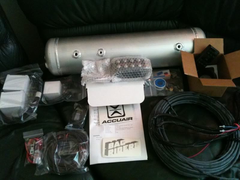

        I wanted to adjust each corner so i got the analog adjustment
        and 5 yards of this stuff Thanks China haha
        i just ordered 2 more Slam specialties Re-5 air bags for my fronts. All i have to wait for is for some more cash and someone to fab me up some brackets.

          this is good ! the bracket fab work should be super easy. all you need to do is get one of those fabricator bracket kits and youre set. any decent welder / fabricator should get it done. just make sure he plates off the lower control arm up front and rear. and you will have to notch out the rear spring cup for air line that or run the bag upside down and airline can be passed inside of the rear lower control arms. that is how it was done on my buddy's W203 wagon I didnt like that idea though.

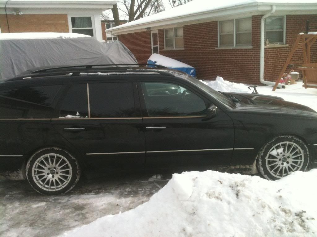

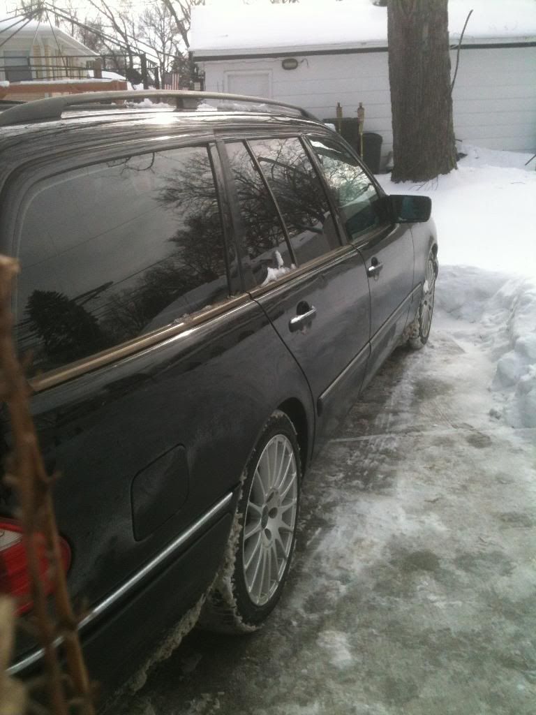

                    just because i gave it to my dad doesnt mean ive given up!
                    - fixed the rear noise. turns out it was just a loose shock
                    - 17x7.5 5x112 +38 OZ superturismo (winter rims)
                    - sold every single air ride piece. funding my current J30t
                    crappy iphone pics (too cold outside):
                    Needs low, but my dad uses it for daily purposes. enjoy!

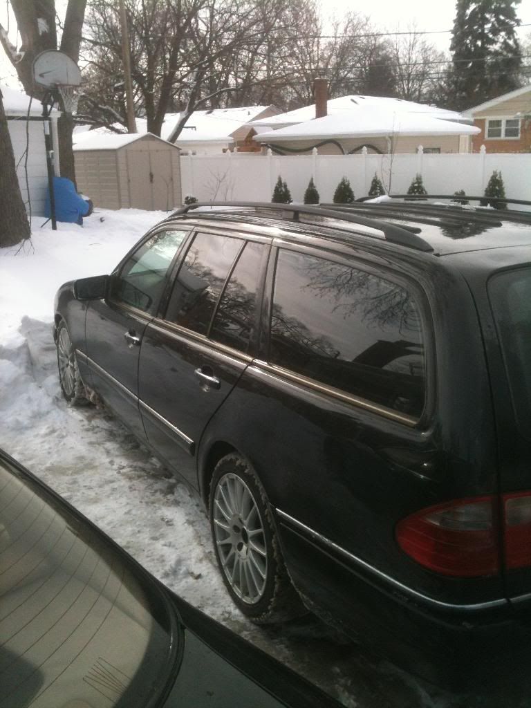

                    • #70
                      It's looking quite nice, I only feel sorry for the underside with all that salt that goes up there...

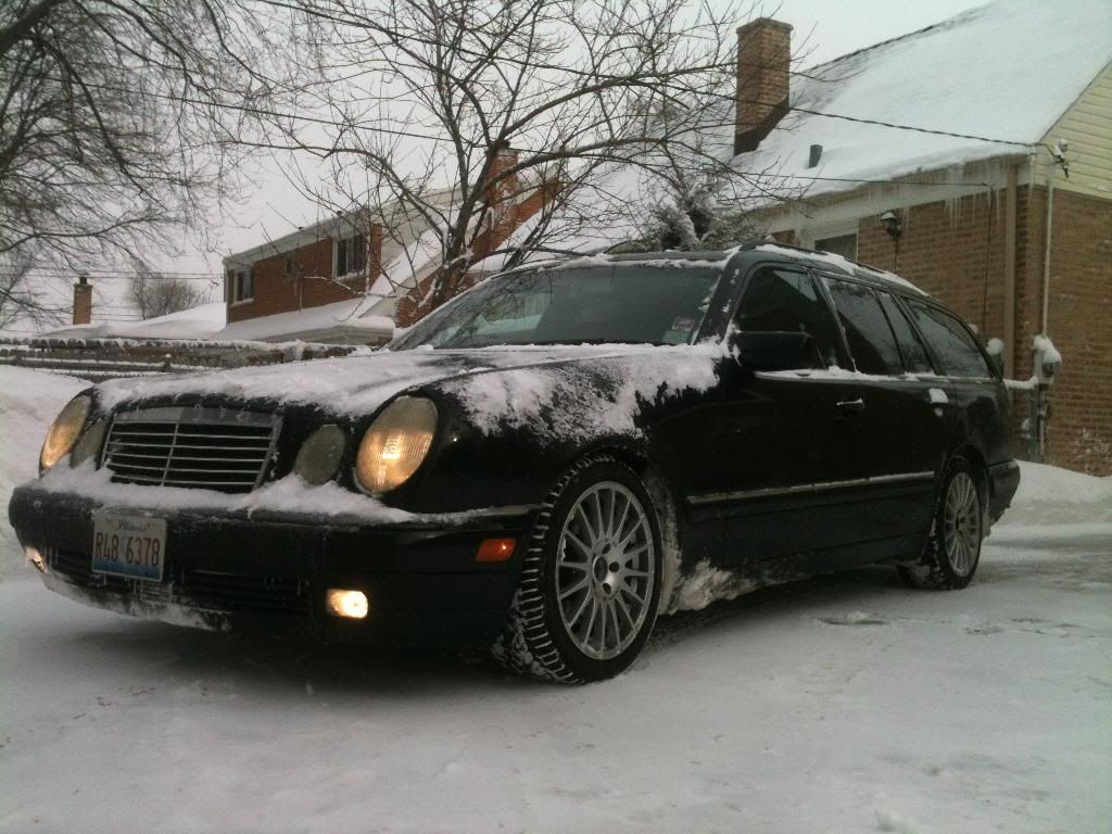

                      • #71
                        5 inches of snow + Rwd + Blizzaks? No prob!

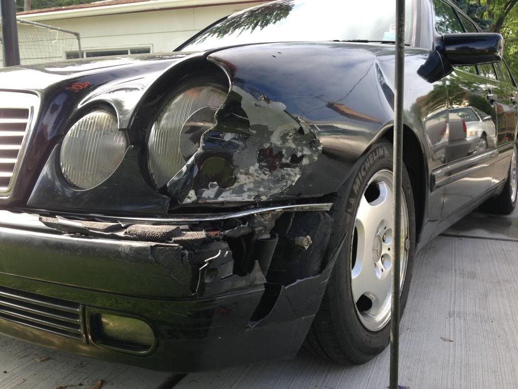

                          • #73
                            damn 18 y/o kids
                            luckily my dad was fine.
