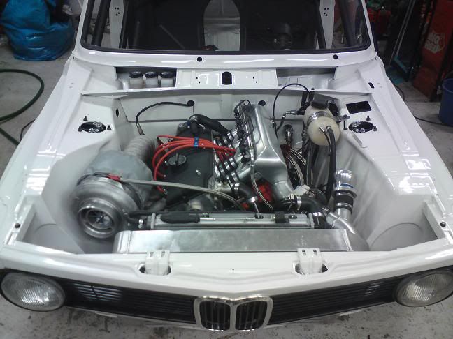

                  • #69
                    holly cow that turbo!
                    But i like the steelies!
                    IG @RobthaBavarian
                    • #70
                      I love the steelies to but in order for me to keep them for a while, in going to have to have a turbo that big to make them roll lol. 20lbs a piece before tires
