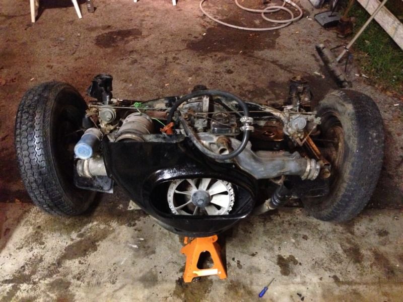

          Got under the car. Got to looking and realized that pulling the rear out was way easier than pulling individual pieces. So a few bolts later and we had this.
          Then started it on the ground to verify it ran.
          Ted approved.

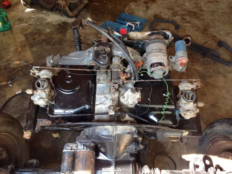

                          Ok. Got some more work done tonight with the help of a roommate and Airkooled.
                          Dirty engine.
                          A little cleaner.
                          Not too worried about it looking nice for now. Plan to build a engine out of the other and will make it look nice.

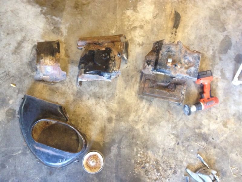

                          Measurements for the cutting of parts car.
                          Cutting the manual shift rod bracket out of the parts car.
                          Gone.
                          Just what I needed.
                          The two shift rods together.

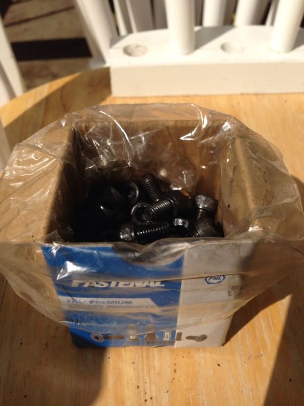

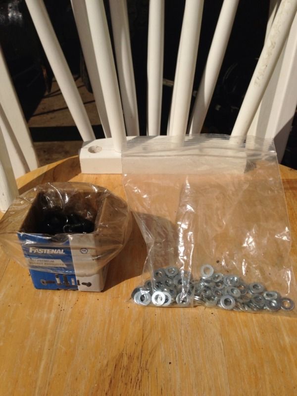

                              I bought some new allen head bolts and some washers. The flathead screws are terrible.
                              And then I got back to work.
                              Not much to see just got most of it put back together. Still needs exhaust, a belt, some plugs and wires, change the oil and a few things to be complete.

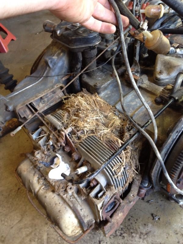

                                Got some stuff bolted back up today with Brennan.
                                Needs some wires and gas lines. Bleed the brakes, battery. Etc etc. but getting there. Hope to get it running then drive to get it painted before it gets too cold.
