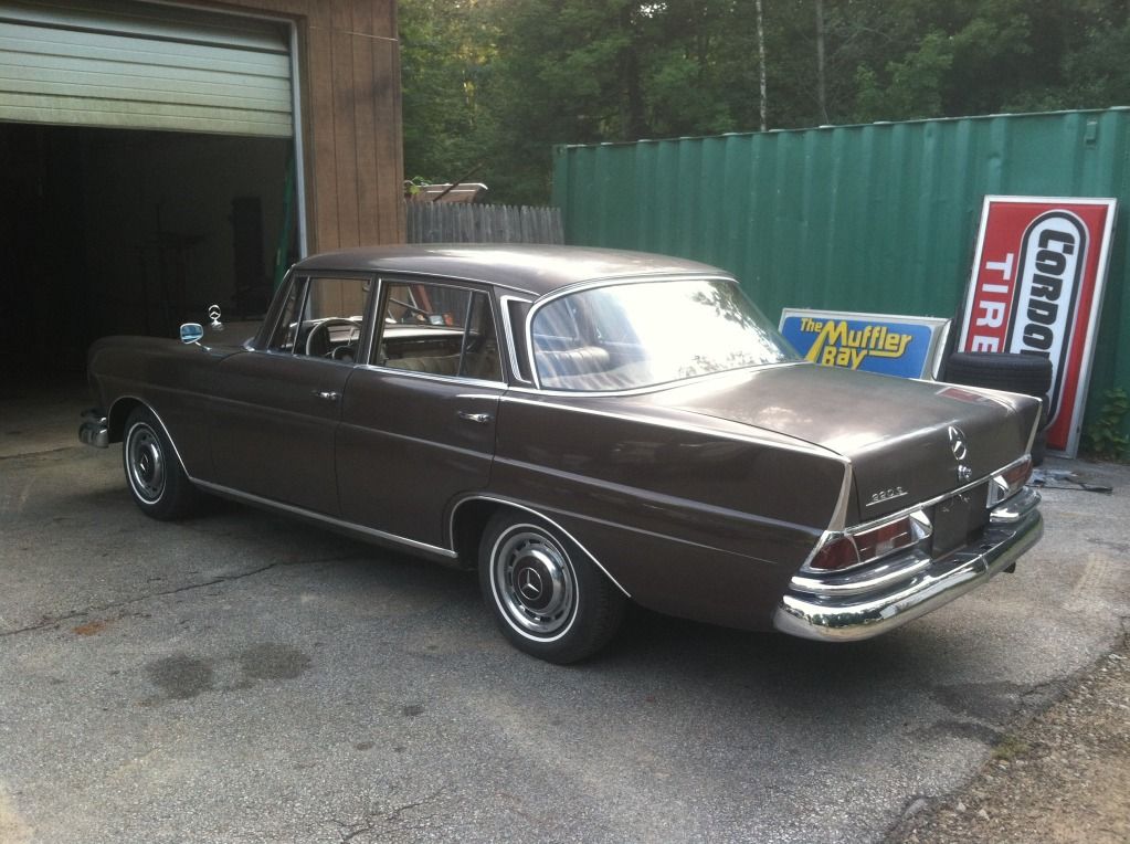

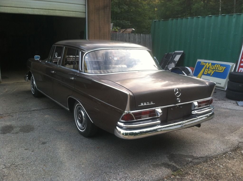

                      Today I drove her down the road for the first time. Shifted smooth, clutch felt good, went down the road awesome.
                      Being behind the wheel of this car going down the road is amazing, driving my 1969 felt awesome, but this one has a character all it's own, and I have already fallen in love with it.
                      We took a video of us heading down the road in her, I'll have to upload it tomorrow or something.
                      For now, I just took a couple of her outside the garage for the first time in a week.
                      A week isn't so bad for the amount of work that has been done in the amount of time per day we got in on it.
                      Bags came in today, fun stuff happening soon.

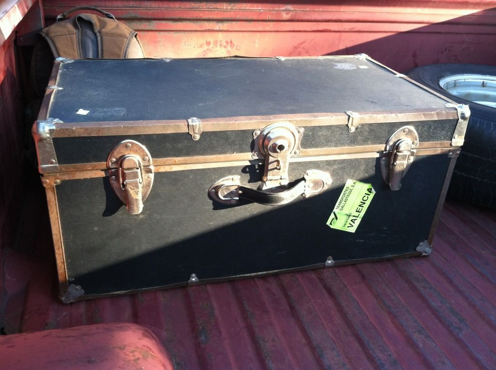

                        I picked up what Im putting my tank, compressor, valves etc in today.
                        I want everything inside so when you open the trunk to the car, it's nothing but the old trunk chest, and the original 0 mileage bias ply spare tire in there.
                        It's coming together just the way I want it to, and I'm pretty happy so far.

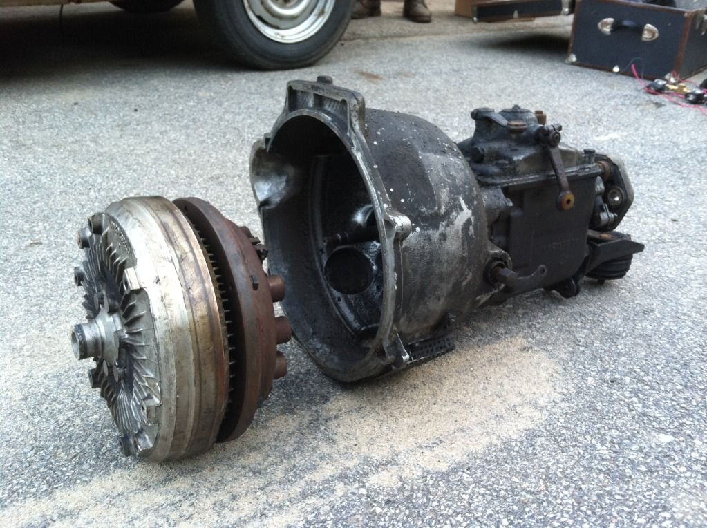

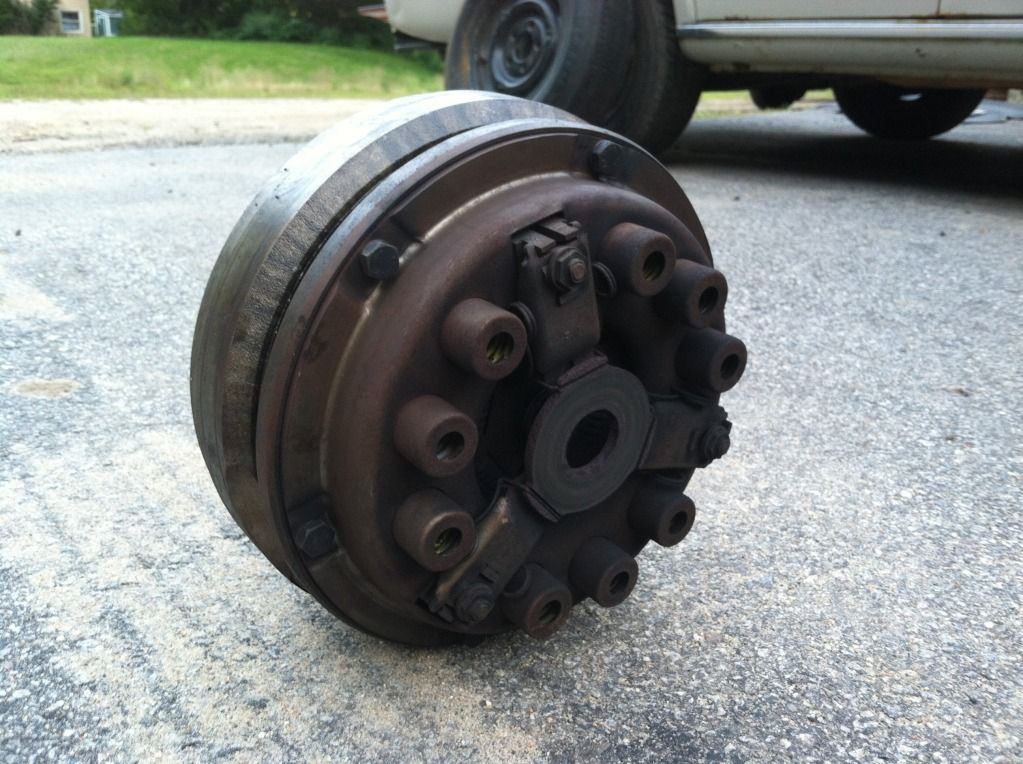

                          Also, here is another look at the original Hydrak transmission that was in the brown tail,
                          The "auto clutch" coupler which acts like a torque converter, holds ATF fluid, self contained and fits inside the bell housing.
                          The transmission itself still holds gear oil.
                          So it still has a pressure plate and everything... on the back side of an outer space-designed "automatic clutch coupler" haha. Wild.

                            that thing is an engineering abortion and innovation at the same time lol.
                            and I love the idea for the trunk in the trunk. switch box is gonna be rad as well

                              haha yea it certainly is, I'd like to know what their thought process was.
