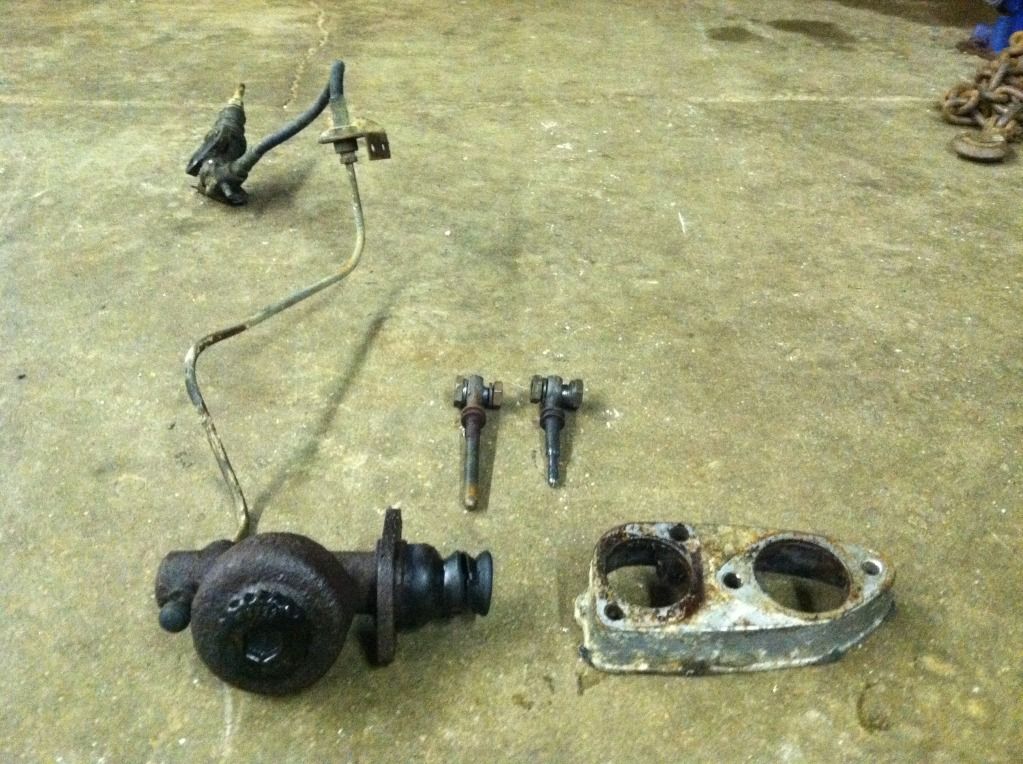

Last night we got the clutch master cylinder, slave, and the mounting bracket on the firewall that both the clutch and brake masters bolt to.
Luckily, the rods were individual from the cylinders and the pedal cluster, so they came right out.

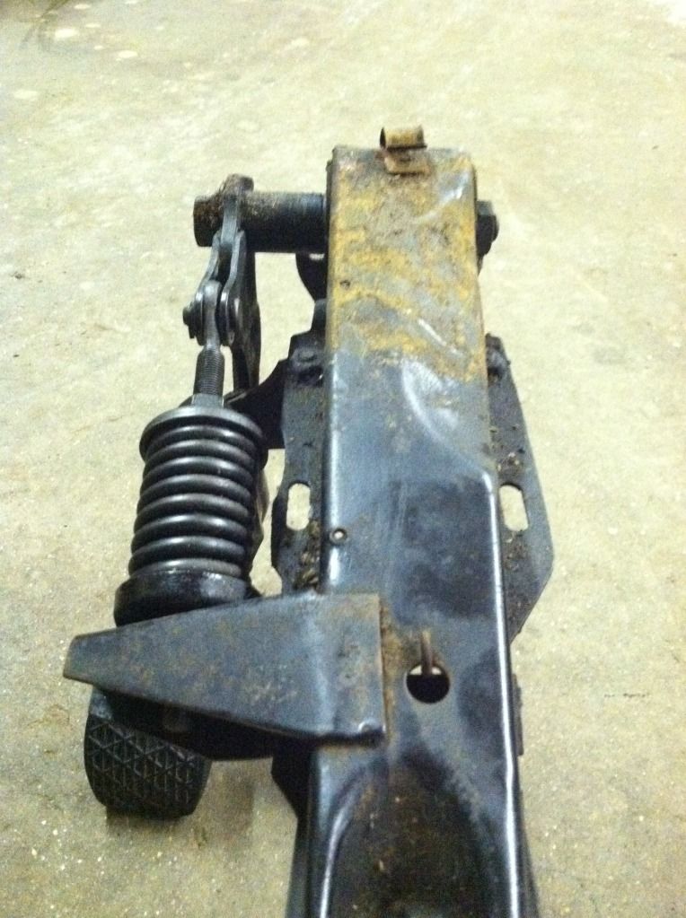

Then came the pedal cluster.
We thought we could pull just the clutch pedal assembly along with the spring and bracket, and there was only one reason we couldnt do that...
This one little bracket shown here that hold the assemblies together.
Otherwise the brake pedal assembly could have accepted the bolt at the pivot point also shown here, and bolted on. Thus, an entire pedal cluster swap.

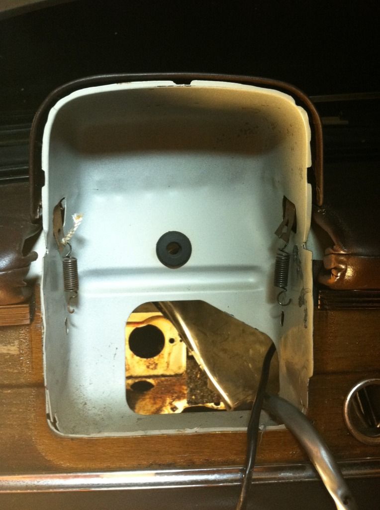

For anyone who has ever or will ever try to pull a w111 cluster, THIS IS HOW THEY COME APART.
The face gets unbolted from underneath the dash, THEN, the top piece.
It is held in with springs and gizmos. Why? I don't know. But that's how it is.
Then, by the grace of God, our dreams came true.
I was hoping the top dash cover was an individual piece, and the entire 53 year old wood dash would not have to be pulled.
Found the secretly hidden screws and out she came.

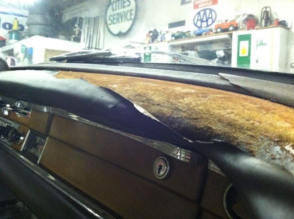

The White tail must of been kept inside its entire life to save the leather dash, it looks new..
And my brown fin tail has 100% clean body and undercarriage, real good interior, but had a terrible terrible dash.

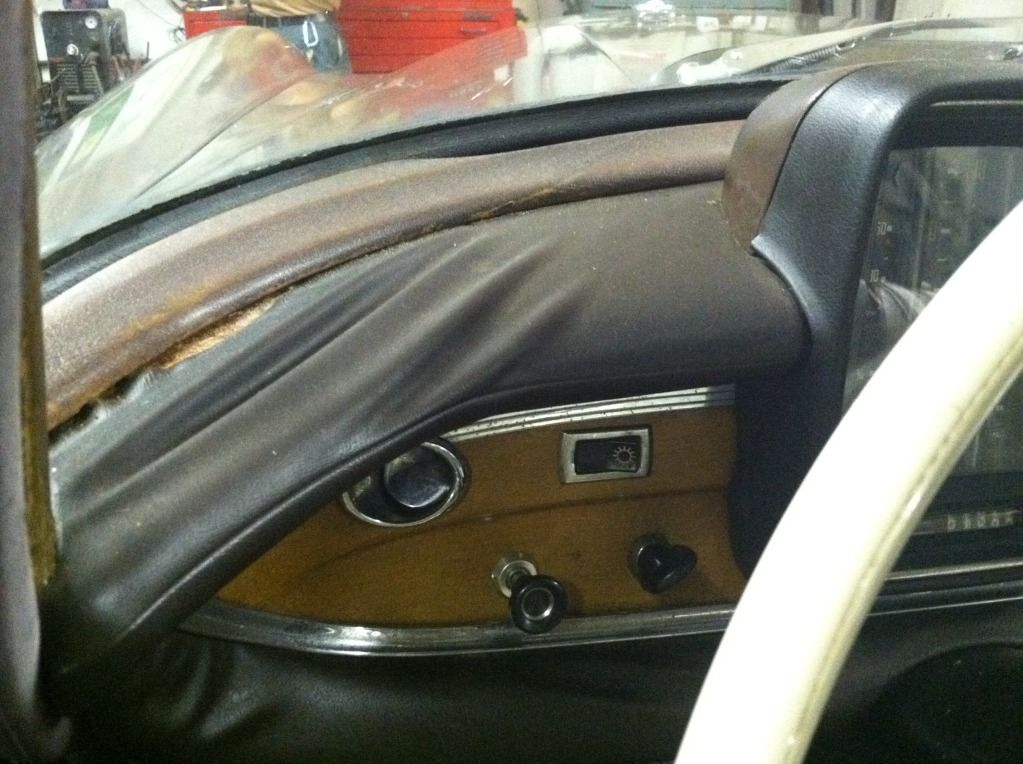

Last night I pulled the steering column out of the brown fin tail.
Everything under the car is in and ready to roll.
First I removed the panel over the tunnel and under the passenger side dash shown here, it even still has the original speaker and speaker box from the factory.

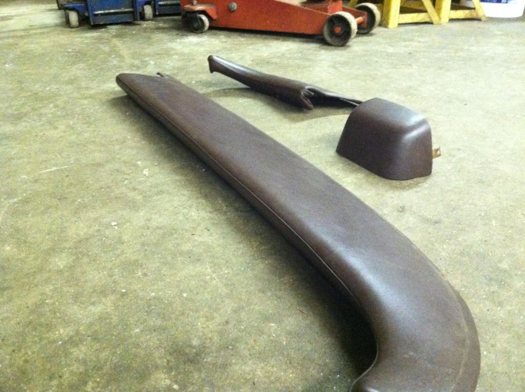

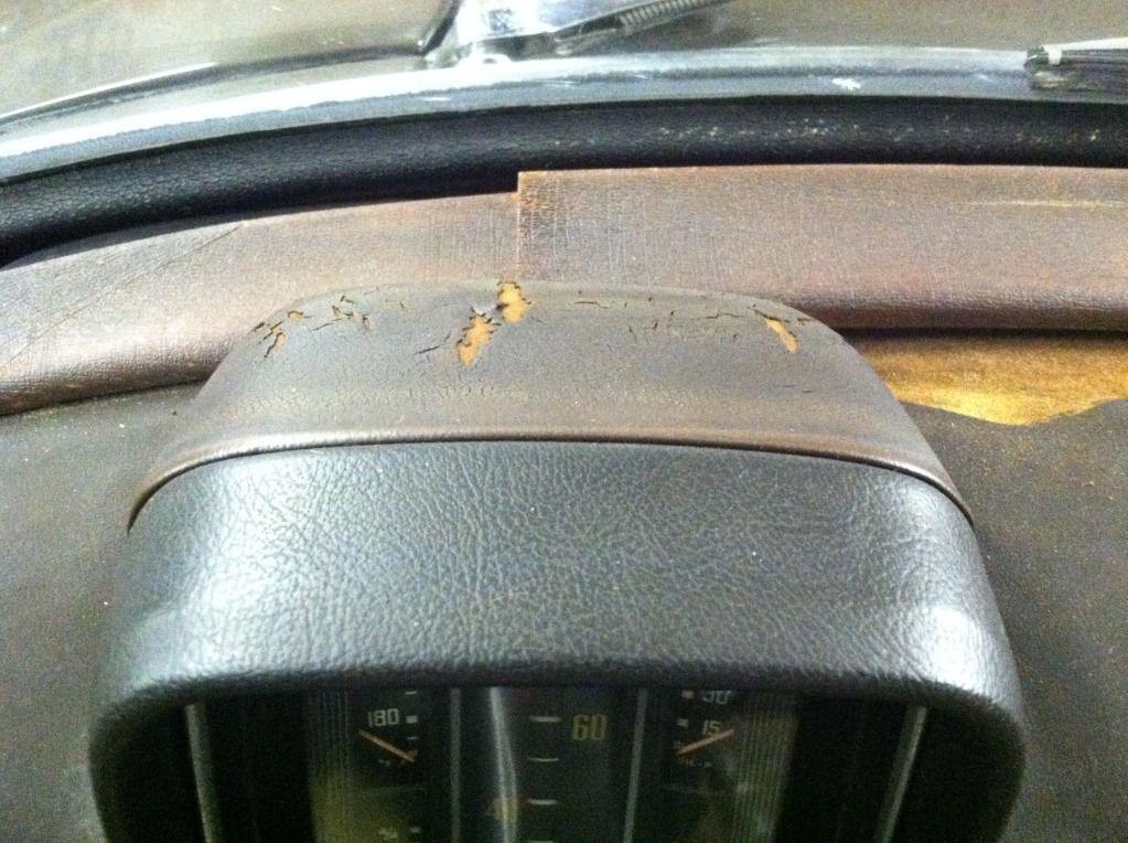

After getting the column pulled, it was time to pull that ratty dash
Got the dash and cluster cap out, big difference.
So on a different note, I have a color deficiency. Not completely color blind, but can't differentiate between similar colors well, at all.
And I never realized the two dashes were different colors.
Oh well, Im sending it anyway, that old dash had to go.
It's already making a huge difference...
