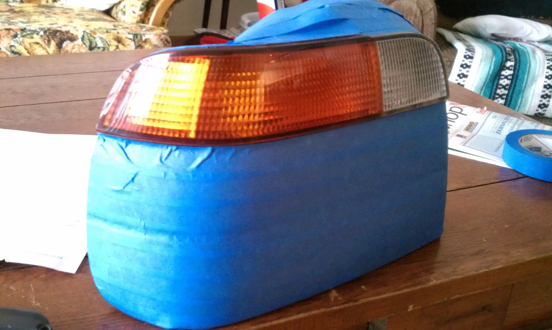

I've been contemplating making a set of all red tails. I then remembered that I am getting a NOS set of amber tails. I figured since my current tails have some minor spider cracking, why not hit them with some model paint? So I did. I used Testors 1605 Candy Apple Red paint with Testors clear. They turned out really well. I just need to wetsand and buff them.
Started off by masking them off:
I then layed a nice even coat of red. Somehow it only took me one coat to achieve the color that I needed, and I had no runs.
I removed the tape on this one to ensure that it matched well. I also wanted to compare a before and after.
It looks slightly off in the pictures due to it being a more matte finish at the moment, and I couldn't get a heads on shot.
I then taped up the second light to be able to shoot color and clear right after one another.
Then I just buried them in clear with a heavy coat. I wanted to put enough on to make a nice thick layer, but have no runs. It worked out really well.
I'm going to let them dry for a day or two, and then do the wet sanding and buffing.

I didn't go out to the shop yesterday because I couldn't figure out what I would do. I instead went home and finished the headlights. I also got the tail lights almost finished. They just need to be wet sanded and buffed=) I didn't get any pictures of the other head light finished, but I did get a picture of the tail lights.

Thank you. They came out a little dull so the wet sanding and buffing will make them look great=)Originally posted by DinanDave View Postthose tails turned out great man!
