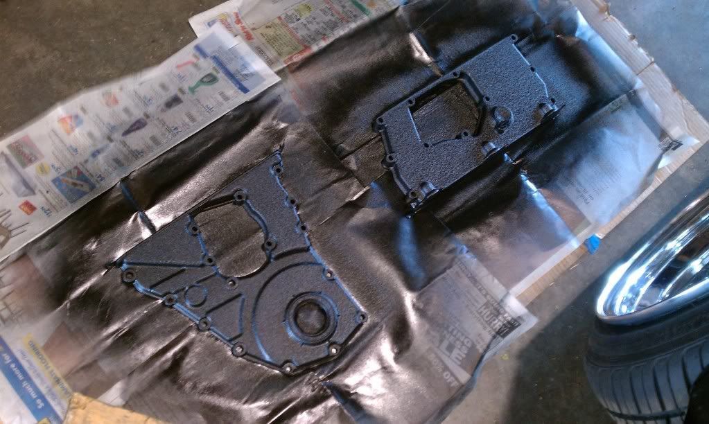

      • I decided to focus on the engine this Saturday.
        I started off by cleaning up the timing covers.
        I had bought a can of VHT Wrinkle Black to do my valve cover and intake manifold, so I decided it would work well here too.

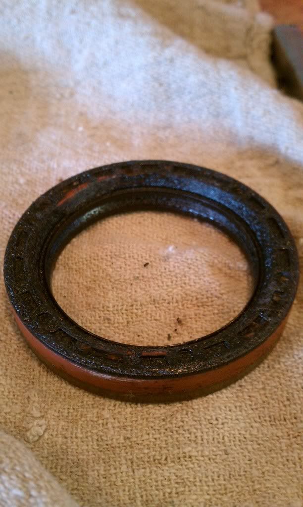

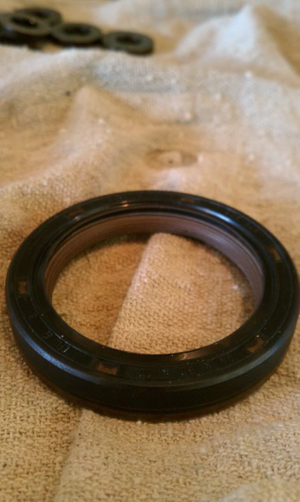

        I cannot believe how well it turns out being from a spray can. After two hours had passed, I removed the old front main seal and installed the new one.
        Old:
        New:

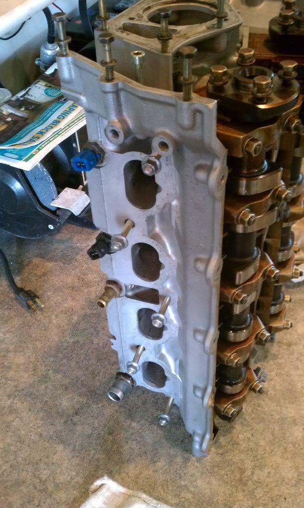

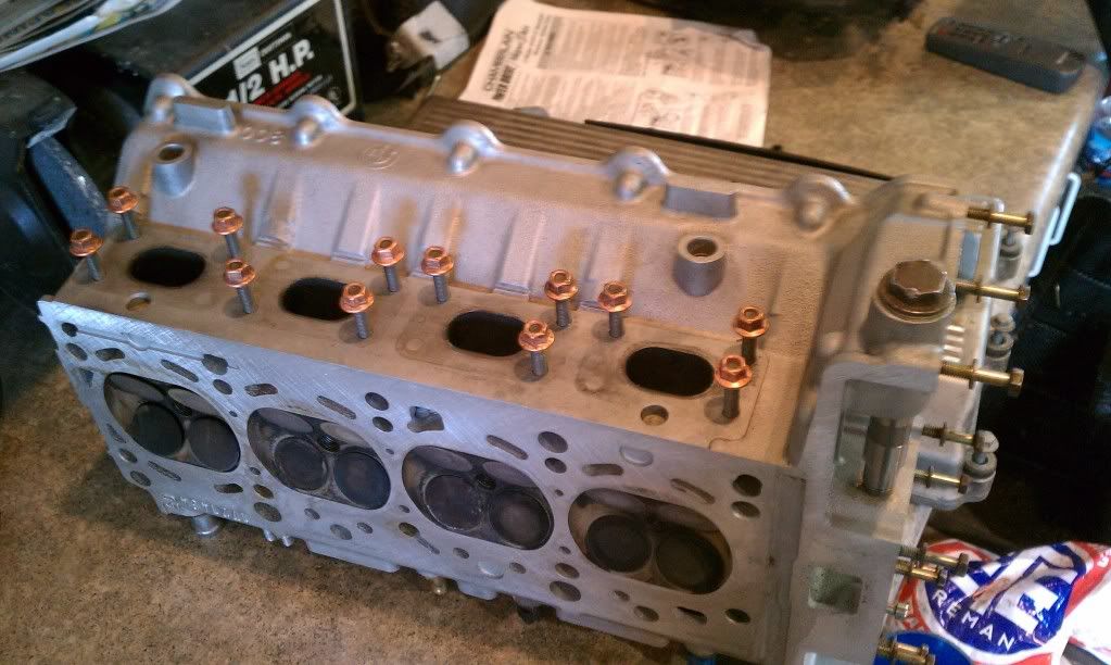

        I cleaned up my head and installed new intake/exhaust manifold studs.

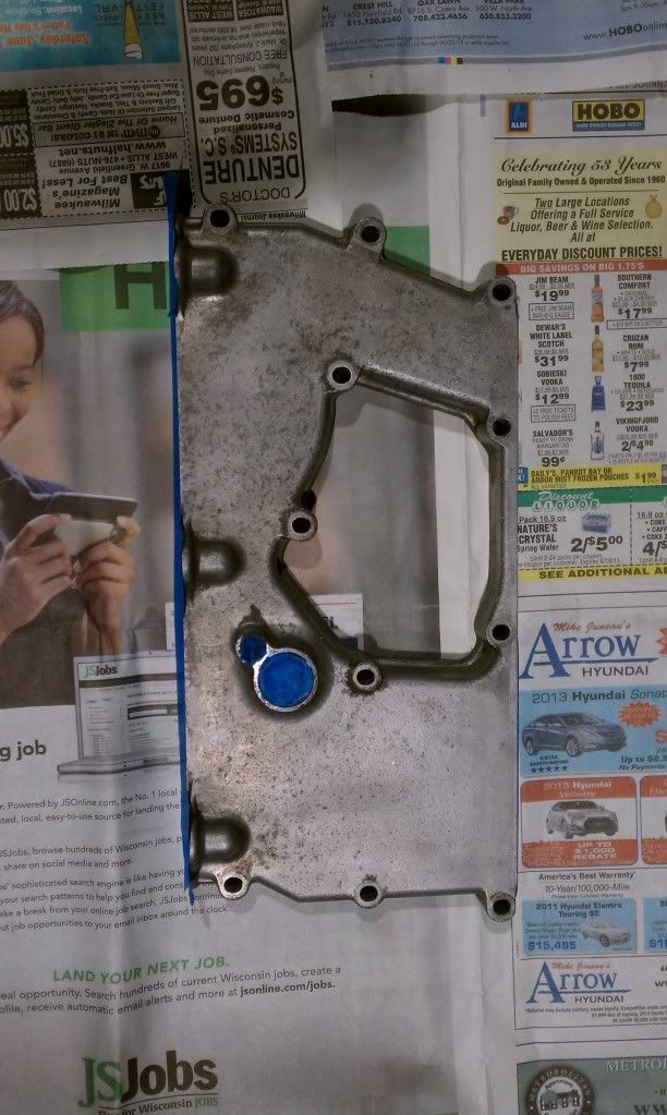

        I also cleaned and painted the rear portion of my timing case. I was going to just clean it up and leave it raw, but it was stained and just didn't look good enough to me.
        Before:
        After:

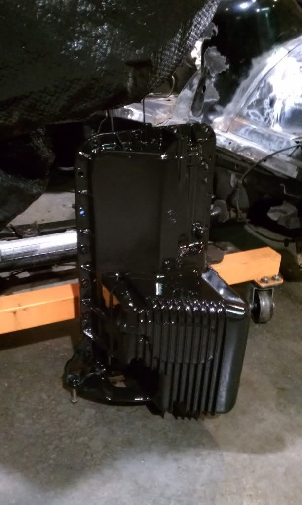

        I then tackled the oil pan. The front was covered in oil and road grime. After I got it clean I was also going to leave it raw, but I was not satisfied with how it looked. I sprayed it with engine primer and then put on two coats of gloss black caliper paint. I didn't want to waste my VHT Wrinkle Black and the caliper paint can withstand up to 600 degrees so I am not worried.

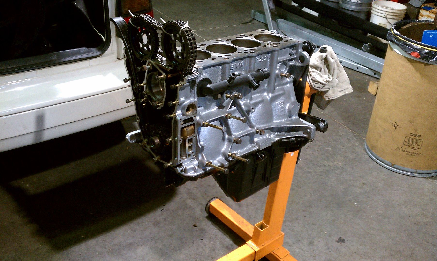

              • Got a smidge of work done yesterday.
                I got a picture of how the thermostat housing turned out.
                It is a tad wrinklier than the timing covers but it matches well=)
                Blasted my bottom end out with brake kleen and air to remove any debris from scrubbing the pistons.
                Pulled out my new pan gasket.
                I coated smeared permatex silicone on both sides, stuck it on the block, and snugged all of the bolts down.
                Hopefully it is leak free=)
                I also cleaned and sprayed my oil filter housing.
                I sat for a while while it cured to see how the wrinkle would turn out. It seems like it might not turn out as well as I would like so I may need to strip and redo it. We will see once I get there Saturday.
                My timing chain guide will be installed Saturday and I have a lot more brackets and such to paint. I am hoping to get all the painting done Saturday and get my rear arches sorted out.
