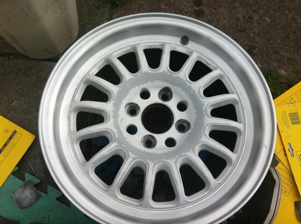

Started the refurb of the Rota's. Lips are spidered and corroded and the paint was getting re-done anyway.
Usually take stuff like thids to a professional, but thought i'd have a crack at it myself. Results are completelly by hand, no machine polishing or buffing.
Started on 120, 240, 400, 600, 800, 1500 and then finished on 2500. Then ther are only two coats of meguiars metel (tub) polish. Shine is gettig bette with every coat.
And a picture to show before and after. By far not perfect, but most if not all curbing removed and 99% of corrosion got to and sorted
Will crack on with the other three in the next few days and get them ready for paint.

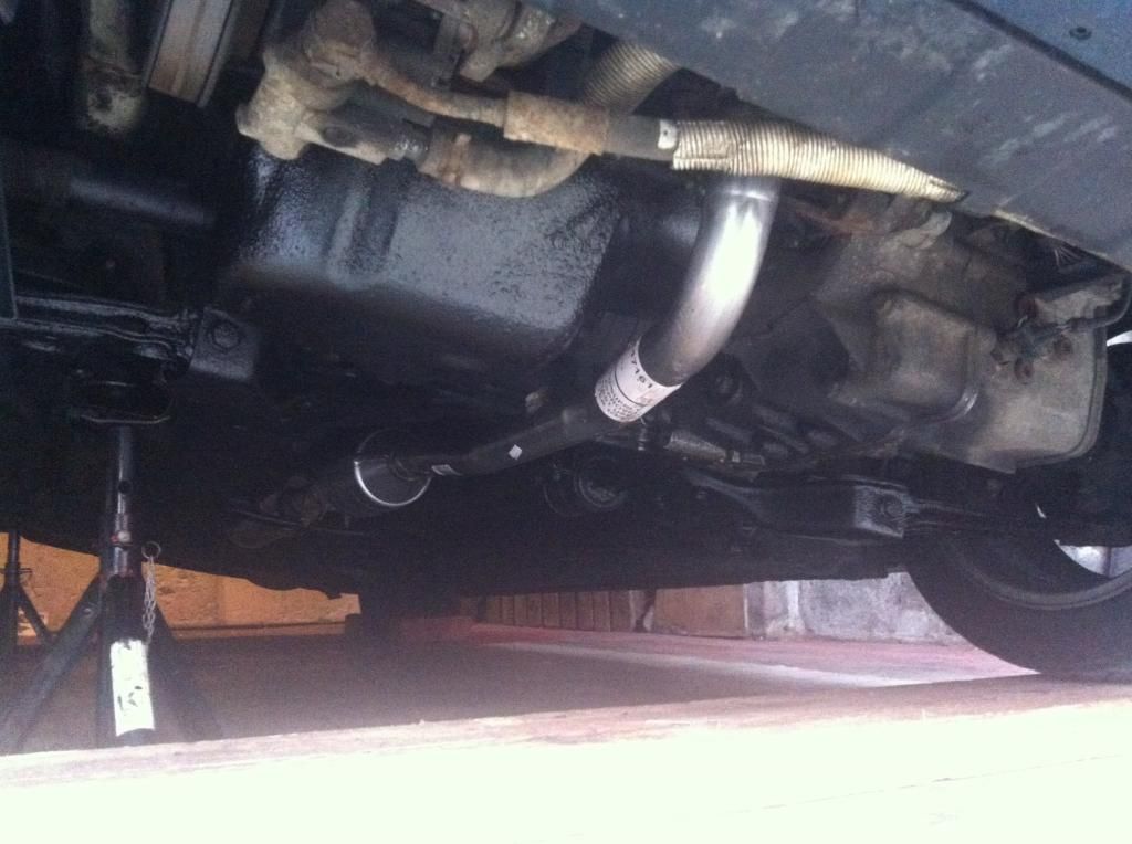

Had to fit a new Downpipe/Flexi/Cat as My flexy was completelly shot and shounded like i had a Spitfire under my bonnet. Yet another cost I don't need trying to get the car back to former glory!

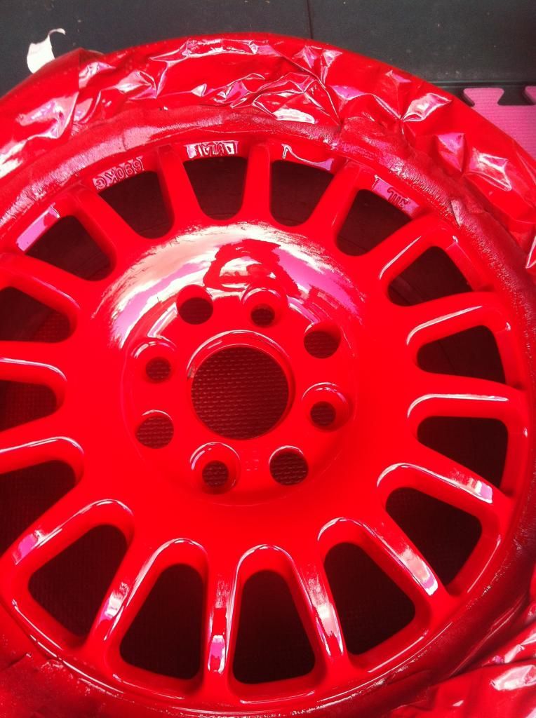

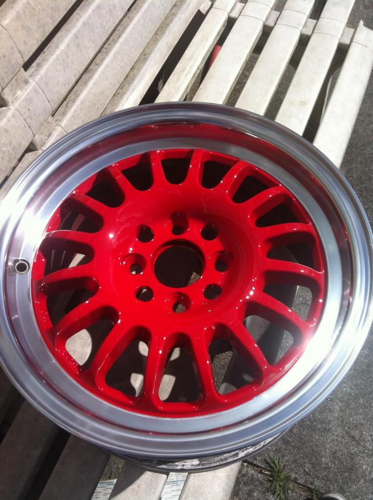

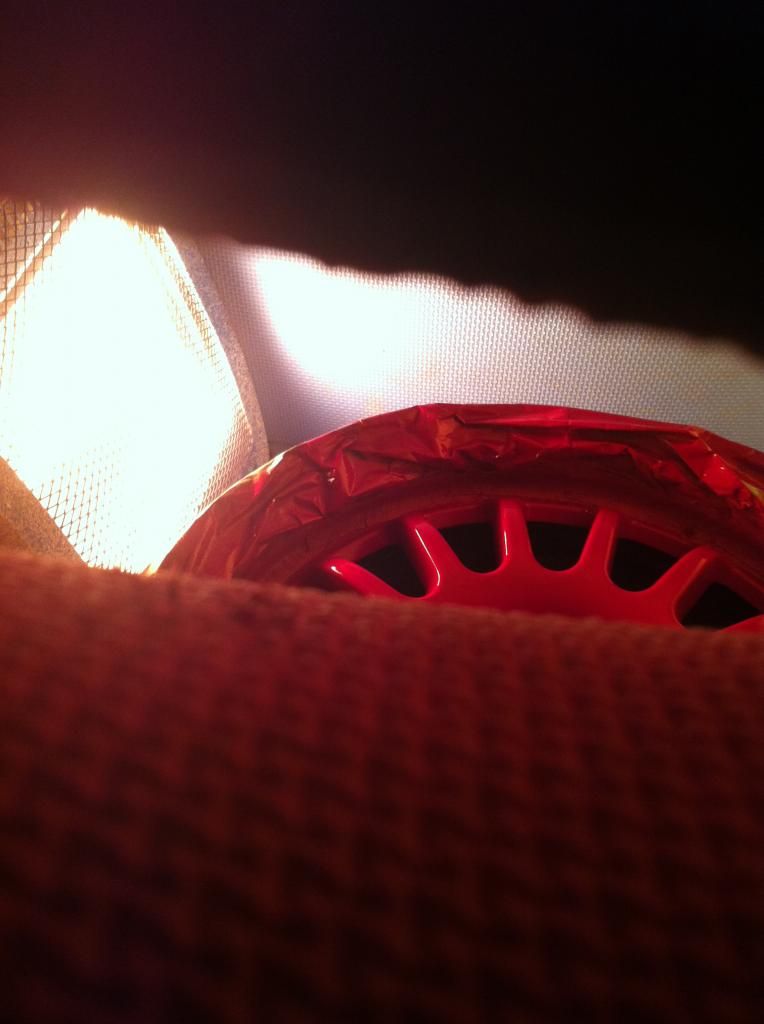

Also.. Rota's are now a complete set of freshly polished and painted wheels. By far not perfect but for hand polishing and aerosols the finish is more than good enough for me.. I've ordered new lettering for the centres of the wheels and am still waiting for them to arrive. No more fake stickers like the last owner put on them, clown.
Also started to re-colour my cage to match the wheels. Just need to get to my local Hellfrauds to get the paint to finish it.

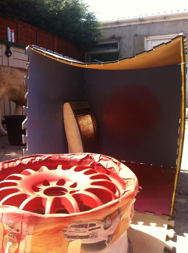

Pictures.. DIY Spray booth was the tits!

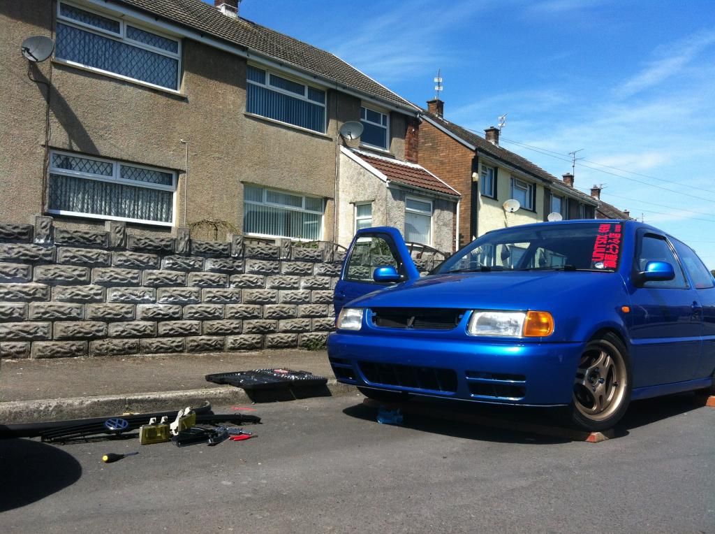

Car getting taken apart ready for paint..
