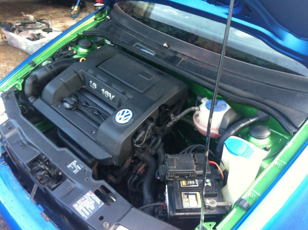

              For those of you that haven't seen on Facebook..
              Freshly painted bay..
              More coming soon

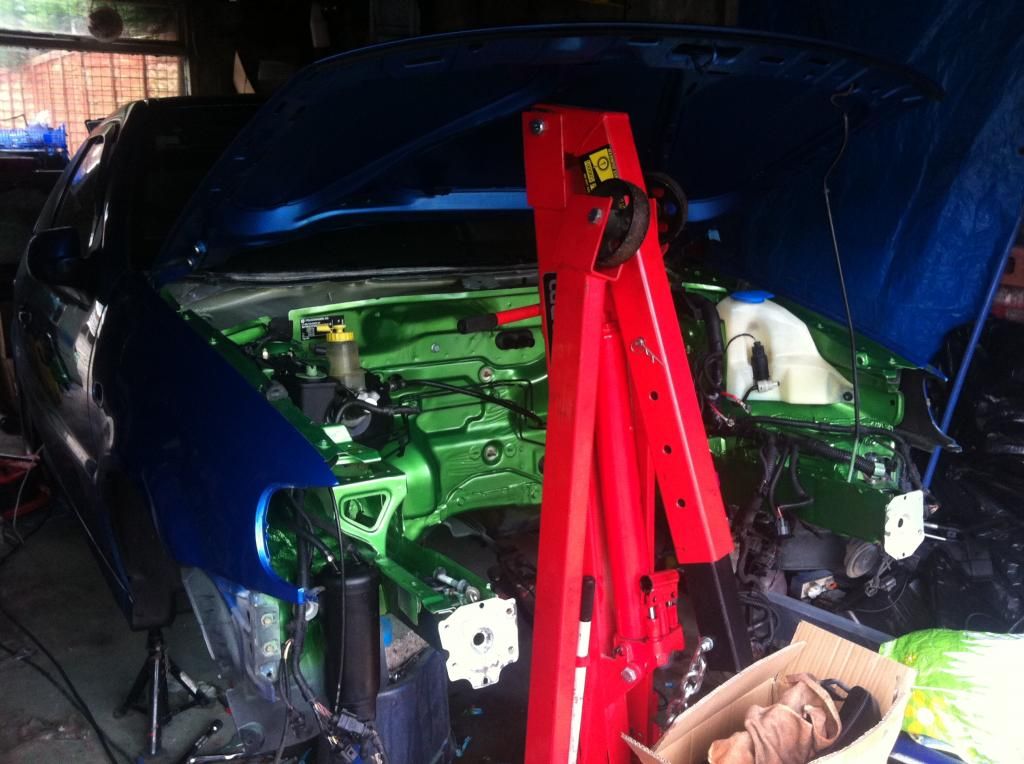

              • #82
                Current progress..
                Interior Loom - Check
                Engine Bay Loom - Check
                Heater box - Check
                Dashboard in - Check
                Fuel pump - Check
                New Timing belt - Check
                Engine painted black - Check
                AC Removed - Check
                Gearbox Painted black - Check
                Subframe painted black - Check
                Subframe Fitted - Check
                Steering column - Check
                Pedal Box - Check
                Full engine service - Check
                New Clutch - Check
                New Disks & Pads all round - Check
                Rear disk conversion - Check
                Exhaust fitted - check
                Engine/Box Fitted - Check
                Bay Painted - Check
                Handbrake swapped - Check
                Calipers Painted - Check
                Lots of swearing - Check
                Injuries - Check
                Almost there.. I'm soo hoping it will fire on the first turn!
                Left to do:
                Front passenger brake
                Headlight Wiring
                Slampanel & Radiator
                Interior
                Dash trim
                Brake & Steering Fluids
                Bleed brakes
                Coolant
                Not bad considering ive done everything apart from the timing completely and utterly ALONE in my garage with no guidance. Never done this size of mod before!
                Fingers crossed.

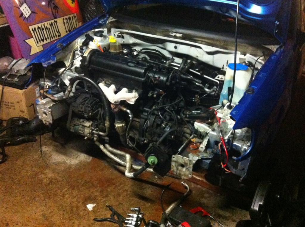

                      SO... Its in... Still stuff left to do such as a few tiny wiring changes, tightening bits here and there but its in, it runs and its been driven.
                      Not an exciting engine change, but its a step up from the crap 1.4 8v
                      Done 95% of the work completely alone in my garage. Not bad for someone who didnt have a clue right?
                      ​Almost alive again <3
