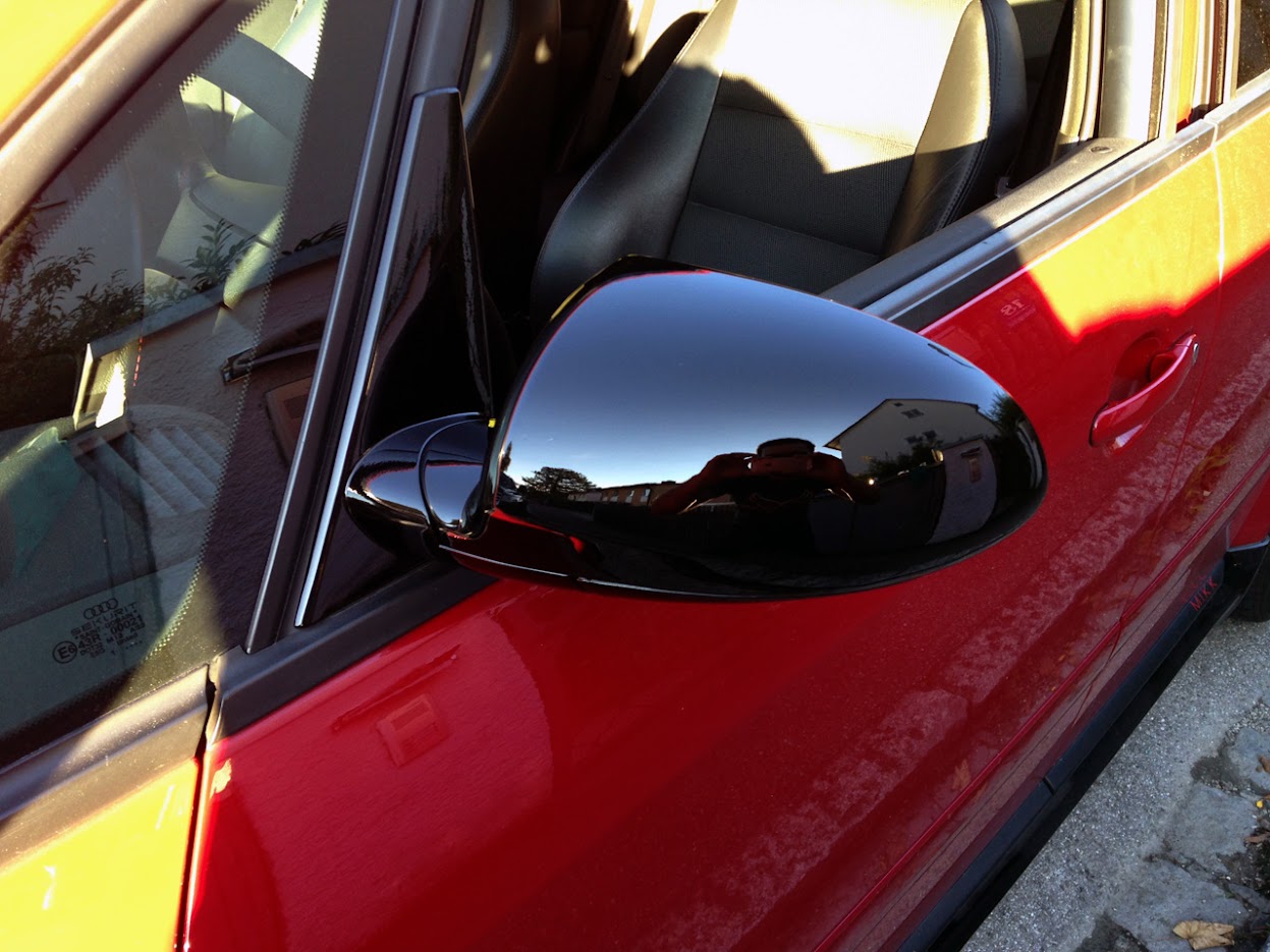

Since I am following the red/black theme I thought it would be a good idea to blacken the mirrorcaps including their mountings.
So here you see them after a fierce battle of removing them. And thats why I **** working on "new" cars. To remove the mirror mountings I had to remove the door trims (which are a combination of screws and clips), the upper speaker, a trim cap, and some dampening material. Why Audi, why?
Car without ears:
Then I gave them to a body shop which I absolutely don't know (but is quite close to my home) in hopes that they deliver some good work:
