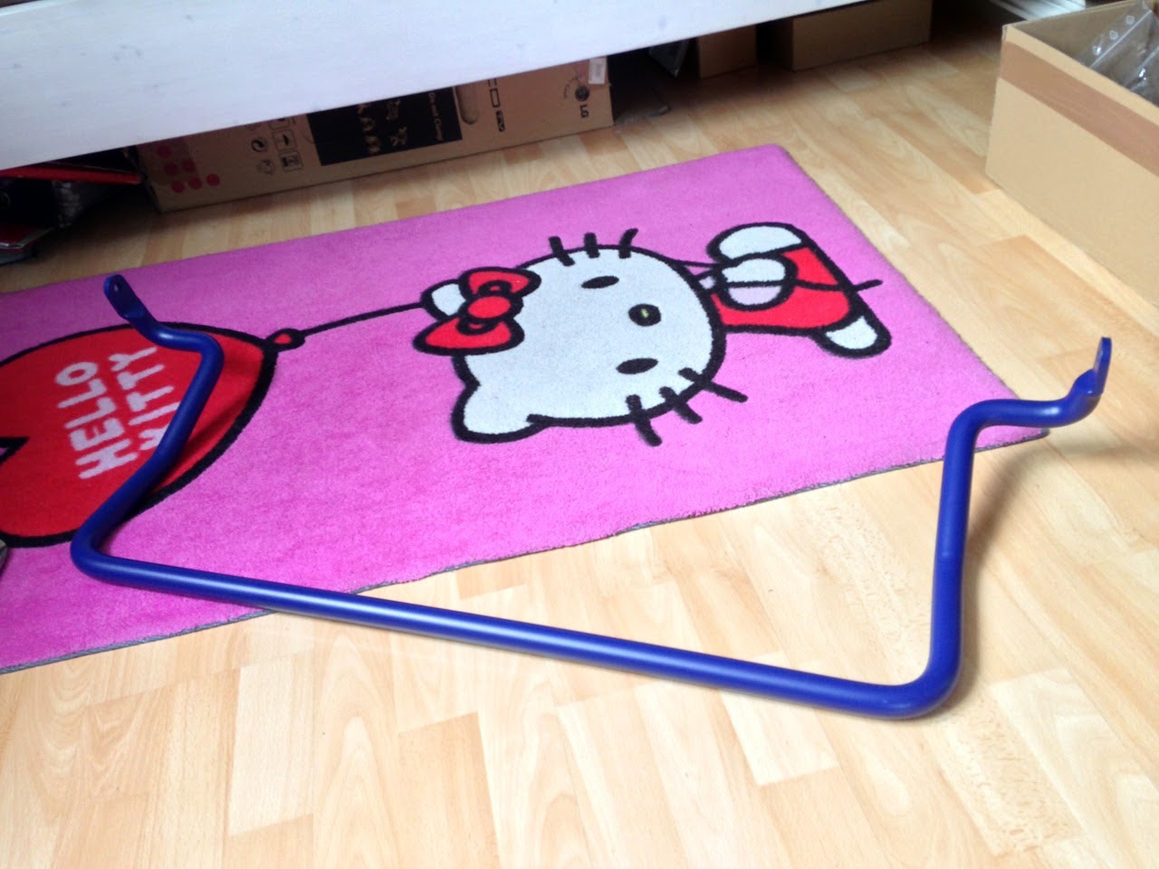

      • Well, I neglected this thread quite a while now. Lemme see. Ah, yes! The anti-roll-bars:
        Here some shots from the box, its contents and the loveletter from H&R. Also some superpro goodness.
        First of all: I will never ever call a car my own with no aftermarket anti-roll-bars. The handling of the car vastly improved beyond my wildest expectations. Mucho love back to H&R!

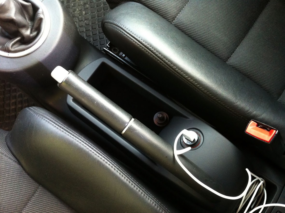

                          Second: Then after that some luxury on the inside: Steering wheel with new leather, Audi-S5-Style-speedometer (with hanging pointers! ), cupholder in the back and a tray below tha handbrake lever.
                          Hi...your car is very nice! I've already take this car.
                          Can I ask you where you have bought the Audi-S5-Style-speedometer (with hanging pointers! ), cupholder in the back and a tray below tha handbrake lever?
                          Thank you so much.

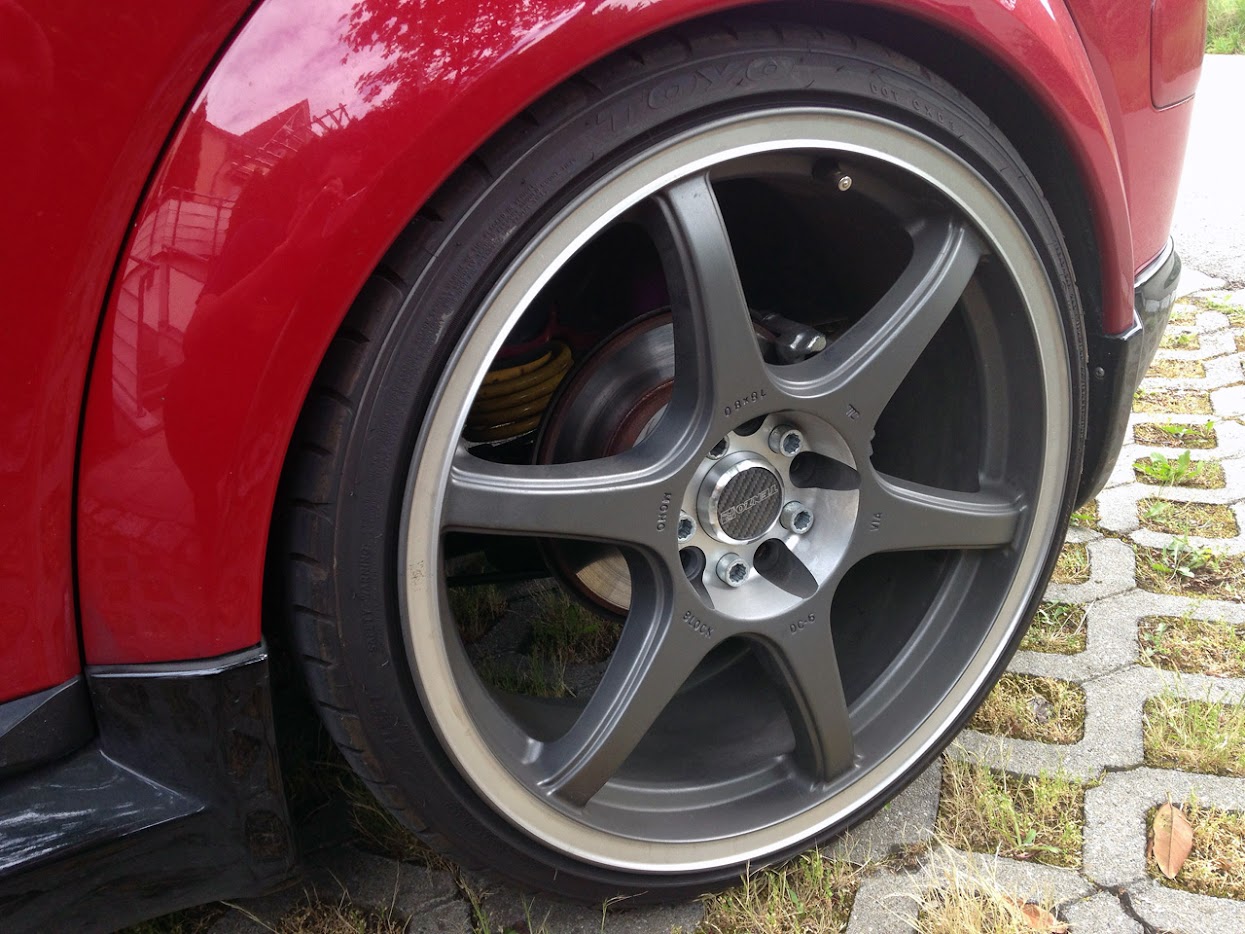

                          • Originally posted by Nagah View Post
                            Next step accomplished. Rear brake drums are out and brake discs are in. In order to do so we needed to swap the whole rear axle.
                            It is basically possible to swap just the mountings but this would have lowered the with of the axle for a centimeter (0.4 inches) on each side causing my winter wheels to not fit anymore. This would suck.
                            Thats why the swap.
                            So now we have the rear axle from the 90hp diesel in it which came with rear discs from factory. Since I needed massive help from a friend with that I was again not able to take pictures of the process because I tried to help as much as possible which does not include lazily taking pictures.
                            Sorry!
                            So here the result, I am pretty happy with that.
                            For mounting the rear axle 90hp, what changes did you have to make?
                            • You only need to swap out the both rear handbrake cables. You can keep the lever and the first cable.

                              • Originally posted by speed.triple955 View Post
                                Thank you so much.
                                I got the speedometer dials from here: https://k-tec-carconcepts.de
                                For the hanging pointers you just have to put them on in the 6 o clock position, no further changes are needed.
                                Cupholder and tray were genuine from the Audi dealer.
