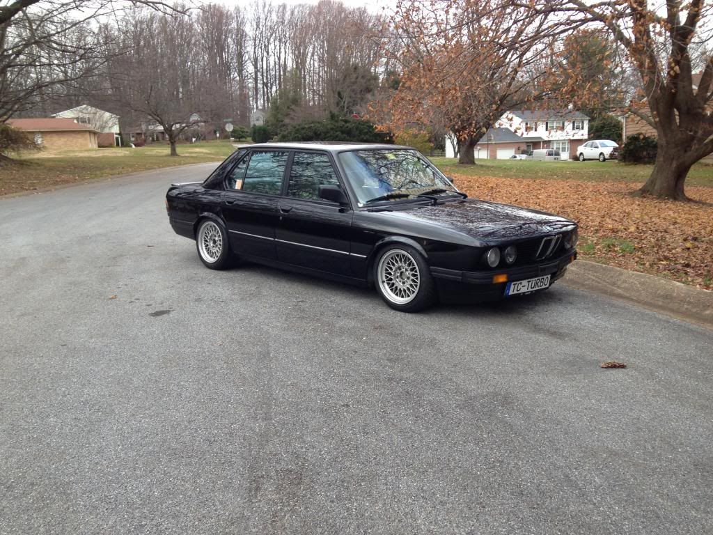

    they are 45mm all around. with the springs i needed a 3mm spacer up front, so you would need 48mm. with coilovers the 9.5" wide wouldn't fit up front, I got the 8.5/9.5 setup. I ran 56mm up front (+0 effective offset) and 50mm rear (et6 effective offset).

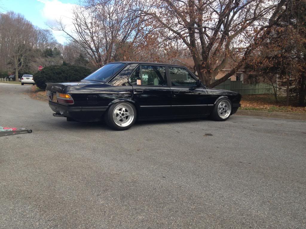

      I ended up selling a set of tires to pick these wheels up which worked out nicely. just 16x8 "style 5's". only problem was... they didn't fit up front with the coilovers. I ran out of time over thanksgiving break so had to run my adapters up front to get back to school.
      sweet fitment, I know. I ordered 20mm spacers to run all around so will be sitting at +3 all around... that winter stance. I raised the car up a few turns both front and rear.
      I put a feeler up for the Gotti's, I really like the mesh look on the style 5's so far, thinking of getting into a multi-piece mesh wheel. we shall see. I'll probably change my mind.

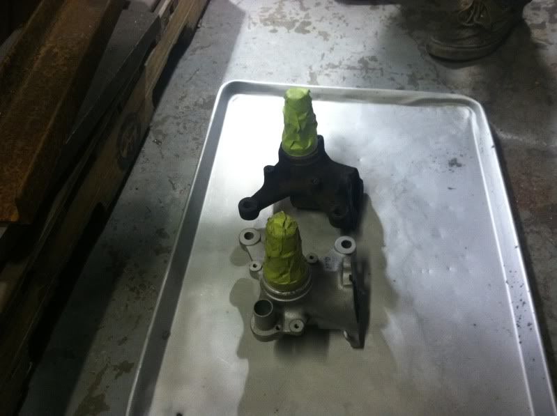

                Did you just cut off your old strut houings and weld yournew on? Ive been trying to look around and see but no ones really given a STRAIGHT answer
                instagram-brandonmckiernannn
                • #68
                  for the Nex, you do cut MOST of the housing off and weld on the new. i forget exactly how much you keep on

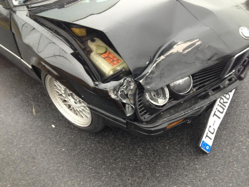

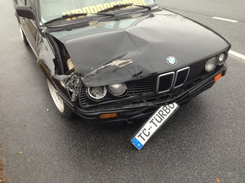

                            Going to update this. As some of you know, this happened back in december:
                            I was obviously quite upset. I would have loved to fix the car asap, but I am a full time student and live 3 hours from where i generally work on my cars. So i needed to get something to replace it for the time being.

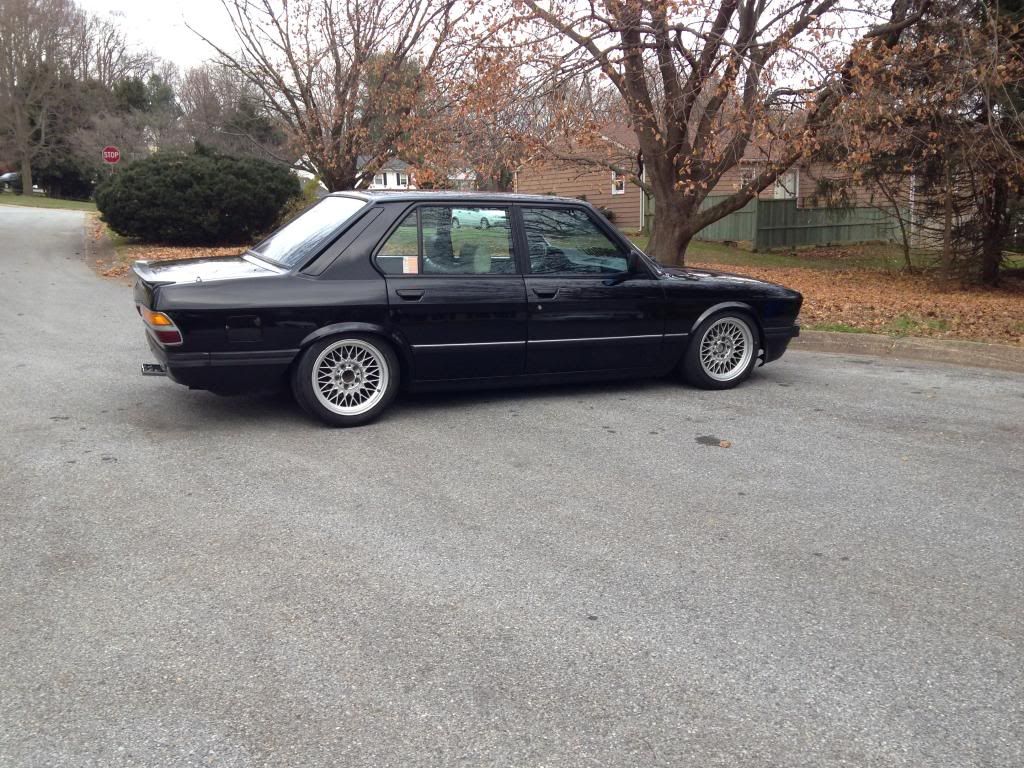

                            Sorry for a late response. Next time I am near the car, I can try to get you some most detailed pictures. It is pretty straight forward. You need two sets of the rub strips. one off of the car, the other off another car.
                            I am going to try and figure out something better for the rear of the car if I do end up picking up another E28 or fixing mine. If I get another, I am really curious as to how Riley Star did his bumpers, which I think produces a little more "clean" "factory" look up close. I liked how mine looked but up close they were not factory clean. those are seen here:
                            And the sawblades on the 9.5 with springs I used 45mm rear, 48mm front. The 9.5's rubbed the collars on my coils up front when i switched to coilovers, so I sourced a staggered set of sawblades instead.
