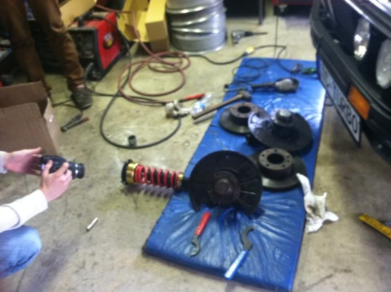

    • #32

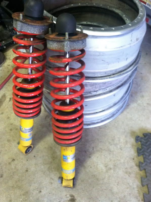

      out with the old...
      in with the new
      my buddy cutting the struts:
      sandblasted

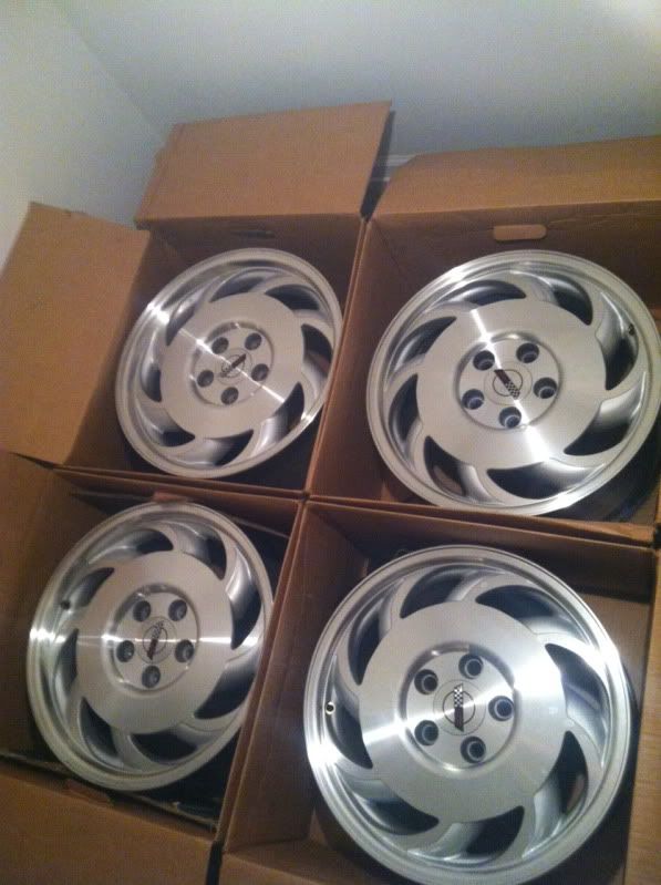

      I sourced a set of 8.5 and 9.5 blades, my buddy is picking them up tonight and i'm trading my set for those

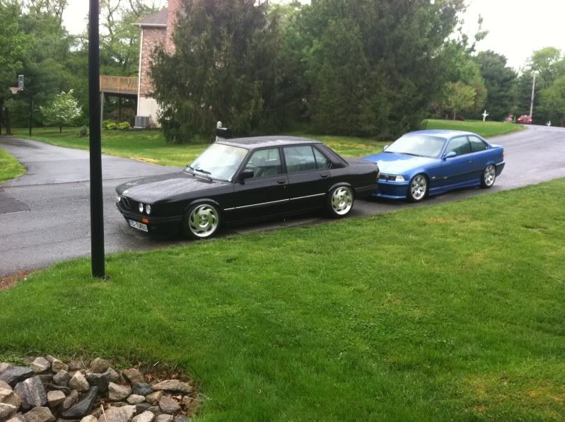

          thanks man! I just got the word. Car will be on silver staggered sawblades this weekend, eventually getting color but I leave on a boat again for 3 months in like 2 weeks, so I am trying to get the car together this weekend for the Tristatetuners Spring Meet and then just to enjoy until I put her away for a few months

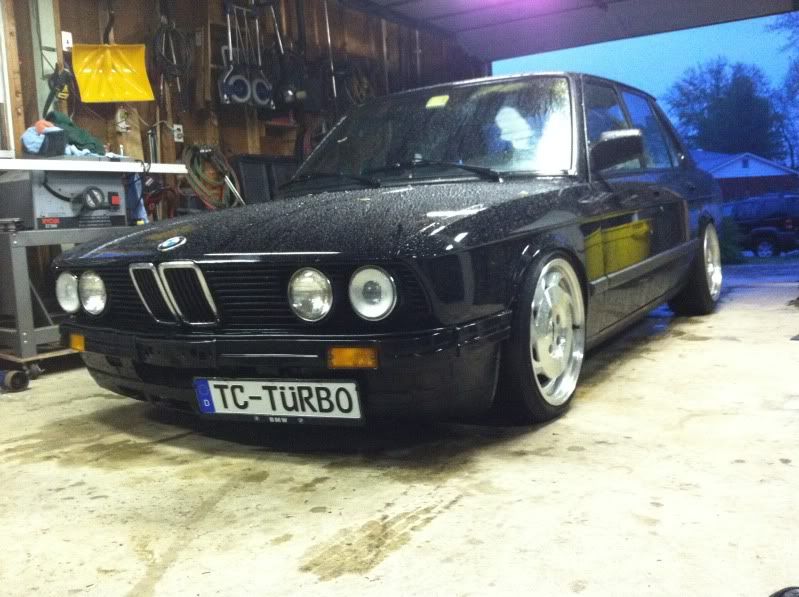

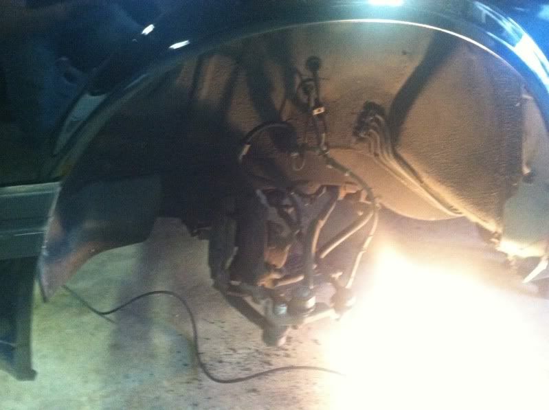

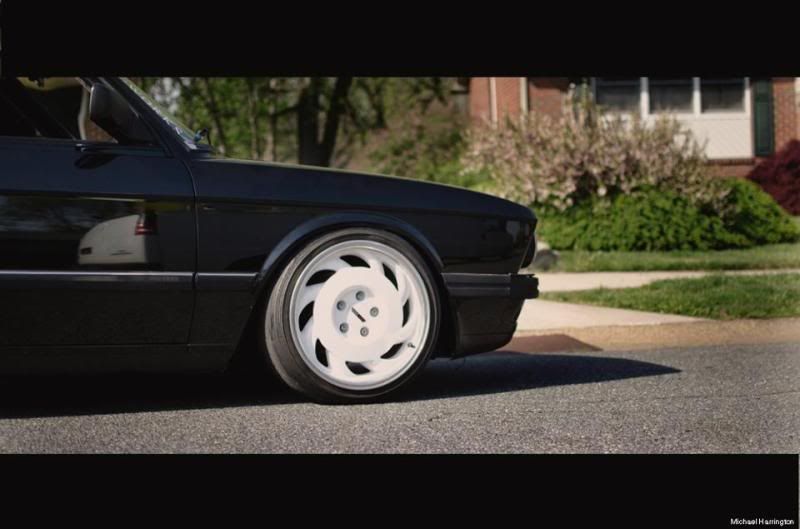

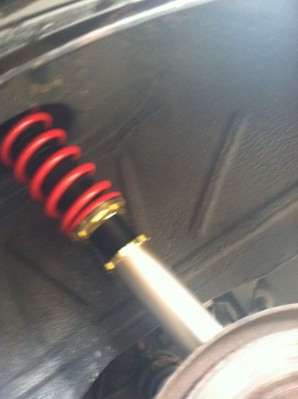

                  So this weekend I got the wheels on, rolled my front fenders a little (just eliminating the lip on the inside, not flaring them at all), dialed the coils in, and attempted to build a skid plate but ran out of time.
                  the wheels

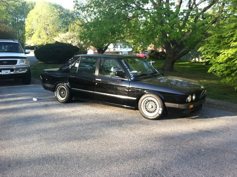

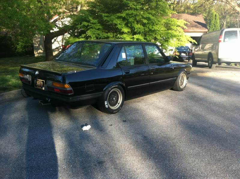

                  when I went to swap the tires I had the car sit on some 14" BBS with old Hoosier race slicks that came with my car when I bought it
                  then I rolled the fenders and swapped the wheels on. They are sitting at 17x8.5 +0 Front, 17x9.5 +6 Rear
                  Proper shoot coming. I leave in about 2 weeks so this is where the car is going to be at for a while. I think it ended coming out clean.

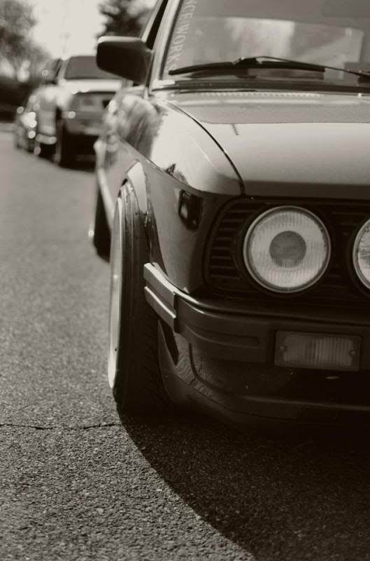

                  • #39
                    I haven't really had a chance to look at an e28 up close but I never thought those wheels wells were so big! I'm surprised that an 8.5" wheel with 0 offset isn't poking out of the front fender, awesome. Car looks great btw.
                    IG/TWITTER @alloydhiggins
                    • #40
                      yeah they can take alot, its proving the vette wheels are just too high of an offset for the car.

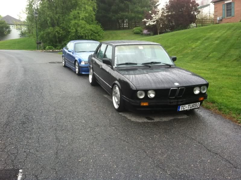

                        • #42
                          the tires are 215/40 up front, 225/45 out back. the rake is a bit much so eventually i want to get 205/40's up front and 215/40 out back.
                          I like the silver better than the white now that I have had them on the car for a few days, make the car look a bit cleaner
