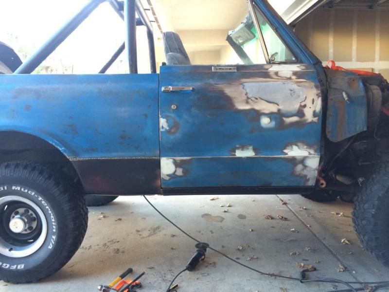

so i commissioned a side job for a friends dad doing a partial restoration on a 72 k5 blazer that he bought dirt cheap, well there was definitely a reason it was so cheap.
here it is after i got the front end stripped down.
and the PO thought it was a good idea to fill the gaping rust holes with expanding foam and then brush thats right BRUSH bondo on about 2-3" think on top of the foam.

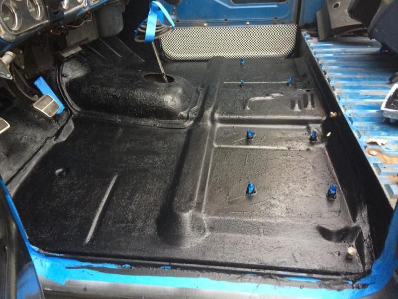

the floor, outer rocker panels and parts of the kick panels had to be replaced.

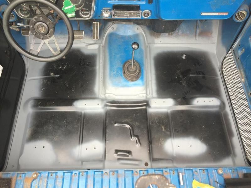

so i commenced bracing the body and cutting things apart.
new floor in

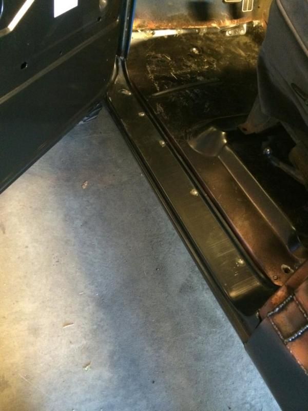

doors fitted and outer rockers and rocker boxes and quarter patch panels welded it on both sides.
seam sealed and primed
bed lined
