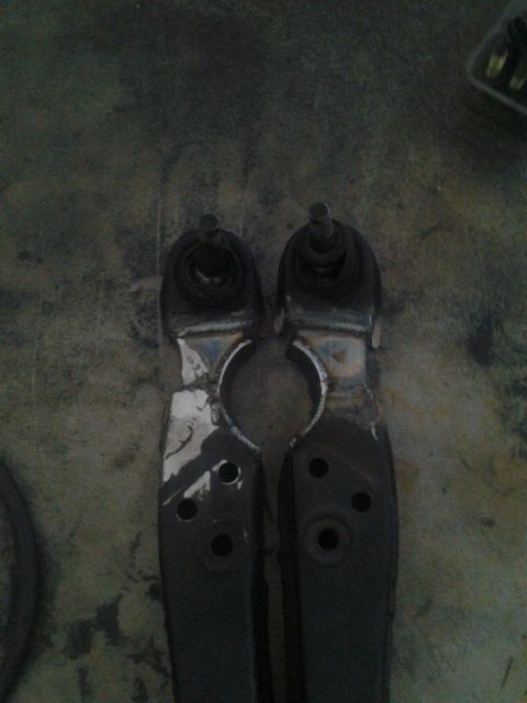

so i added camber and steering angle by lengthening and pocketing the LCA's
and its slight but i kicked the lower ball joint forward to add some more caster.

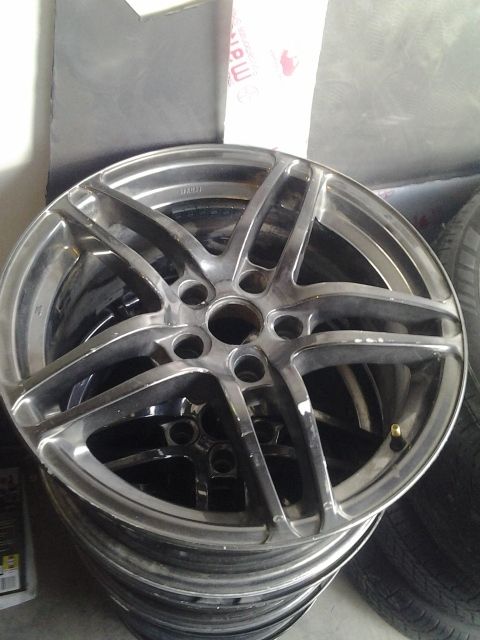

bought some drift spare wheels

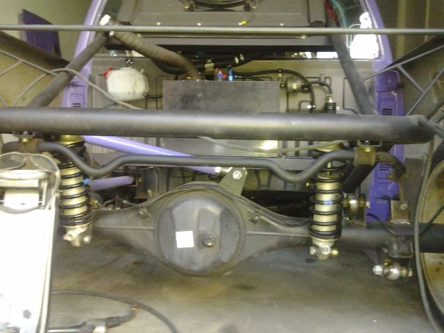

and now i can say i have a mazda part on the truck haha, fc rx7 front sway bar mount in the rear of the beast. also put my 350lb springs on and turned the dampening down a couple clicks.
How much movement do the 350lb's have?When in doubt, cut it out...

hmmmmm do a little more r&d so I can decide on which im gonna go with hahaWhen in doubt, cut it out...
http://www.stanceworks.com/forums/sh...ad.php?t=39445 <<<<<<< Check out my BUILD!!!!
Well your truck weighs more than mine. Back when it was relatively stock I had 450lb springs on and it was great
