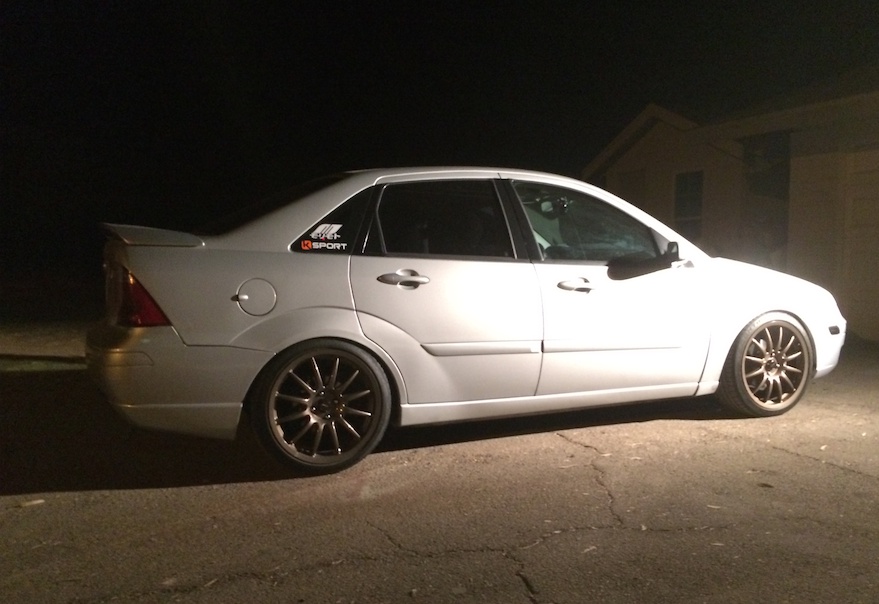

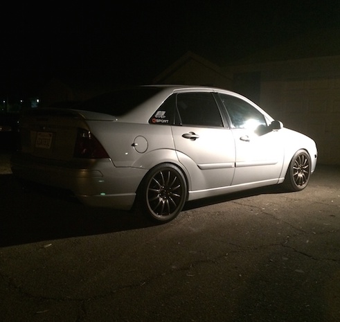

                • Dude sick! Finally seeing another focus. I have an 05 ST. My build is coming along slowly but surely. I'm on Ksports and 18x8 Team Dynamics. I am rubbing like a bitch on dips even after having my fenders rolled. I think it's just the liners, but I'm not 100% sure. Did you remove your liners?
                  Here's a couple pics of mine if you wanna see.
                    Also a sound clip :P
                    https://instagram.com/p/4uecyZSkip/?taken-by=jacobdoty
                    Very good-looking car! I like the TDs, but if I were you I'd bring the tail up a little bit to get rid of the uneven gap.
                    I never specifically removed my fender liners, I just sort of ran them over.

                    • Yeah I was thinking of doing that, but to be honest it's settled a bit up front from that pic and isn't as drastic as it looks.
                      Yeah I just hear a terrible sound that I assume is just fender liners. One of these days I'll chalk them up and see where I'm really rubbing.
