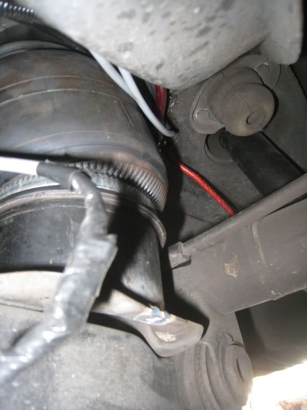

Here are the best shots I could get of the brackets (with no jack aside from the lame fty one is hard to get good shots)

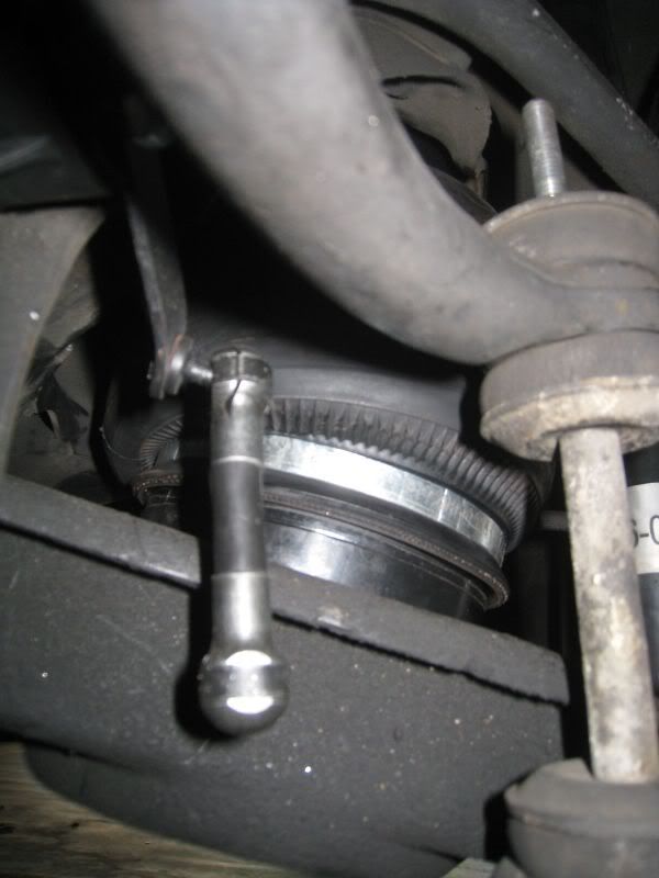

The rears

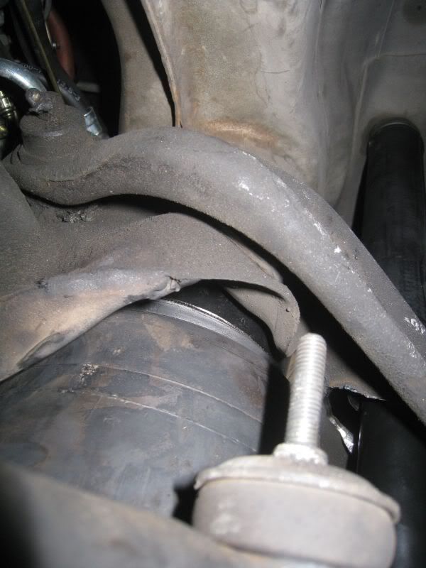

The top of the rear shows the notch in upper bracket to run line to the bag, the line runs up those ventilation holes in the trunk floor straight up into the air management system (no cutting!). These look to be around 2.5"

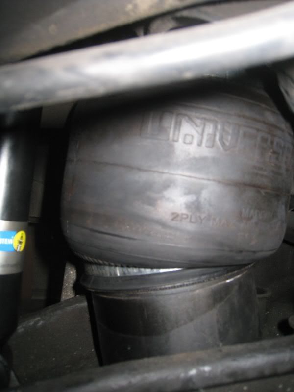

Rear lower brackets look around 2.5" - this could be made lower however the way my system was set up was to retain close to factory specs so when the air suspension is at it's regular ride height the axle's etc are on the same angle they would be with its standard geometry - if you made these lower you would get a bit more drop, but when at ride height your swing axle would be on a slightly more extreme angle - places a bit more stress on it. It also means when you air up to ride height you will have more air in the bags, which makes a harder/bouncier ride its hard to explain as the psi is higher.

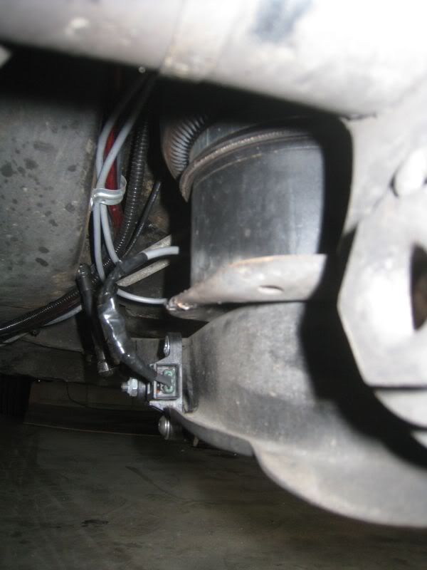

Fronts
Front as very similar to the back - you can see here some guys angle the lower bracket I believe but mine as simply straight - in this photo the car is aired to 90% height - as it settles back to ride height it levels out a bit. Lower bracket looks to be around 3" high

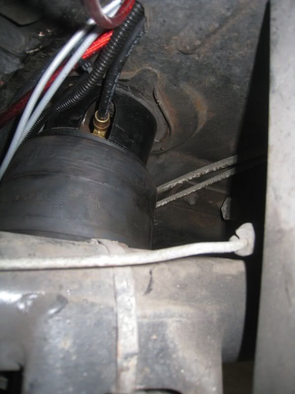

Front uppers are hard see but look to be about 2.5" high
