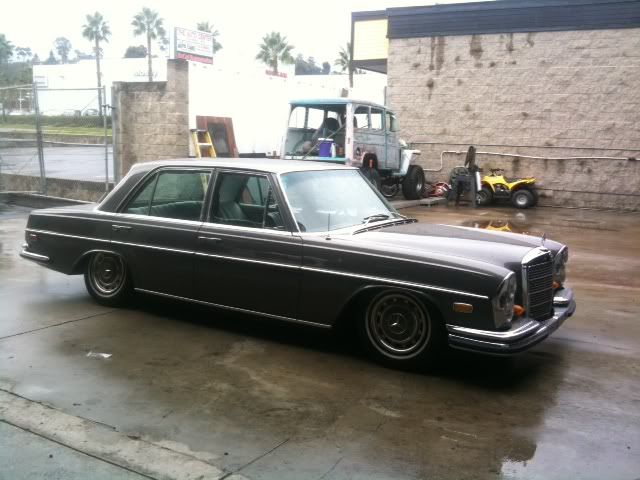

  • wow......car i crazy, also got to be one of the best colours ive ever seen on a car
    • Loving every thing about this car so classy makes me want to find one of these cars hmm....
      • Originally posted by MTW View Post
        cheers, its the original paint code of 172G Anthracite. It was repainted by previous owner in this original colour a couple years ago.

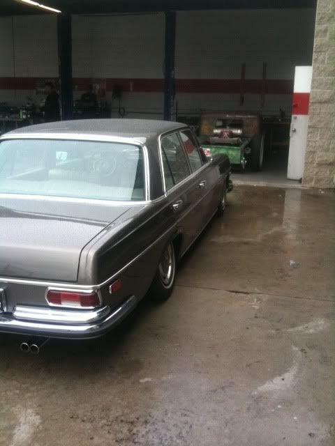

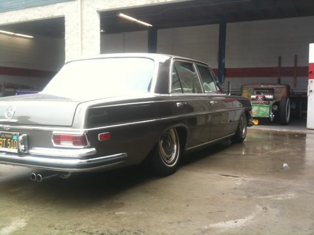

                  • so after having the air in for a few weeks it's back down at socal suspension having a check over and tweaking any areas that need attention after the settle in period.
                    installing front shocks (tried running no shocks but too bouncy)
                    removing or trimming bump stops
                    trimming inside edge of upper control arm in front to give some more clearance for the bag
                    tidying up some wiring in the trunk
                    alignment - was pulling a little to the right
                    secure rear bag brackets on lower control arm, seemed they were shifting a little sometimes
                    replace accuair keyfob, was working intermittent
                    off camping next weekend so might have to wait until the week after to pick it up. lame day in SD raining like crazy...

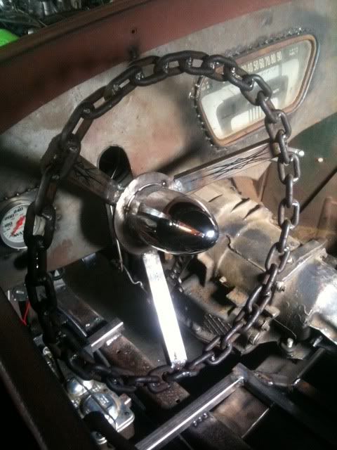

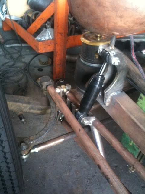

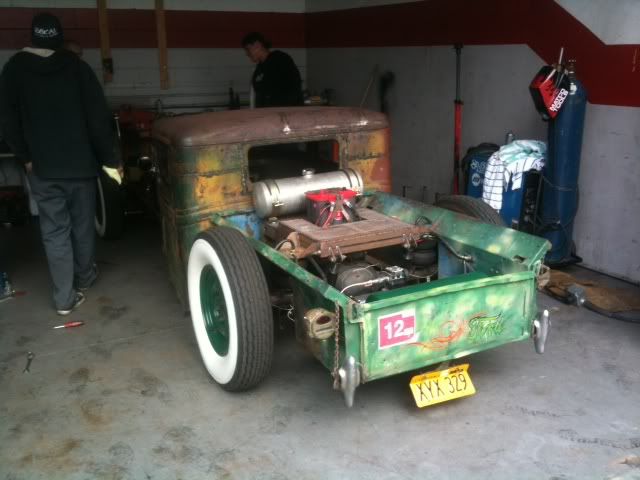

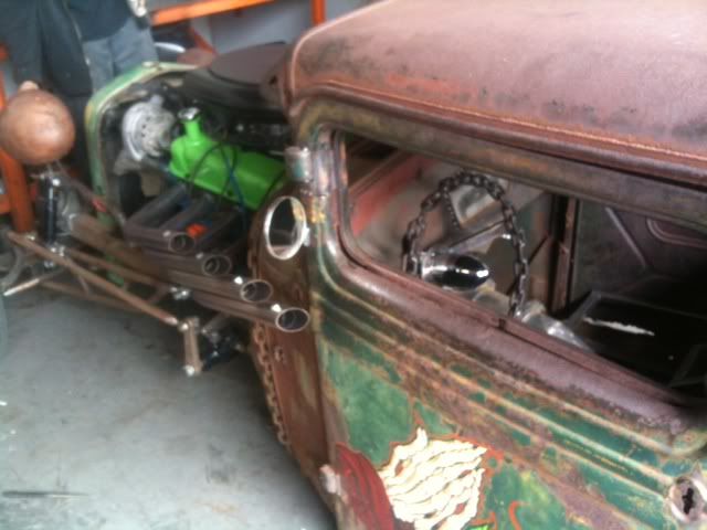

                    this is Jose's car, he is the one doing the work on my car. there is some earlier build shots earlier in my thread to see the progression
                    He built the chassis, mounted the motor, all custom shock mounts etc, made the steering wheel, just built out the setup in the rear tray, he just needs to do just needs floors and a windscreen now. amazing he got this thing registered! its so loud its insane.
