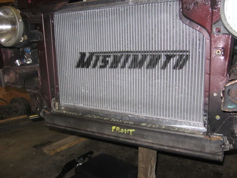

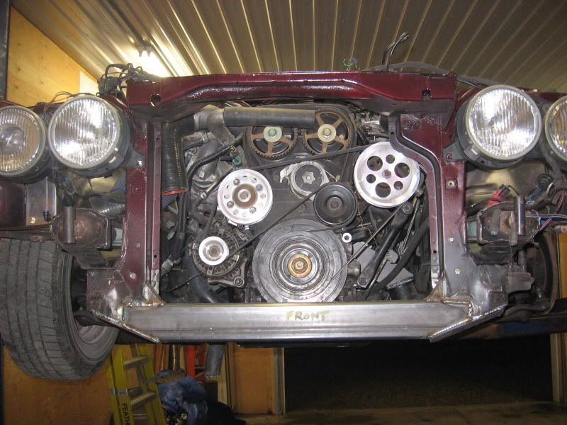

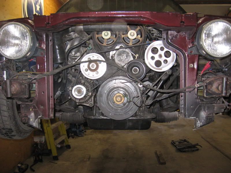

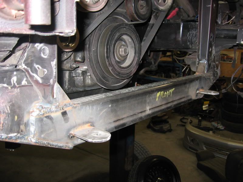

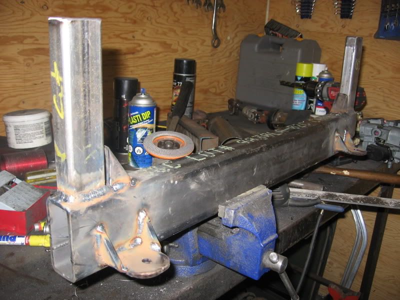

So I had been debating a good way to mount my intercooler and build a skid plate...and after pondering for some time, I decided that a new lower rad support would be needed. So thanks to Hooowybrow, the work began
bye bye oem rad support...

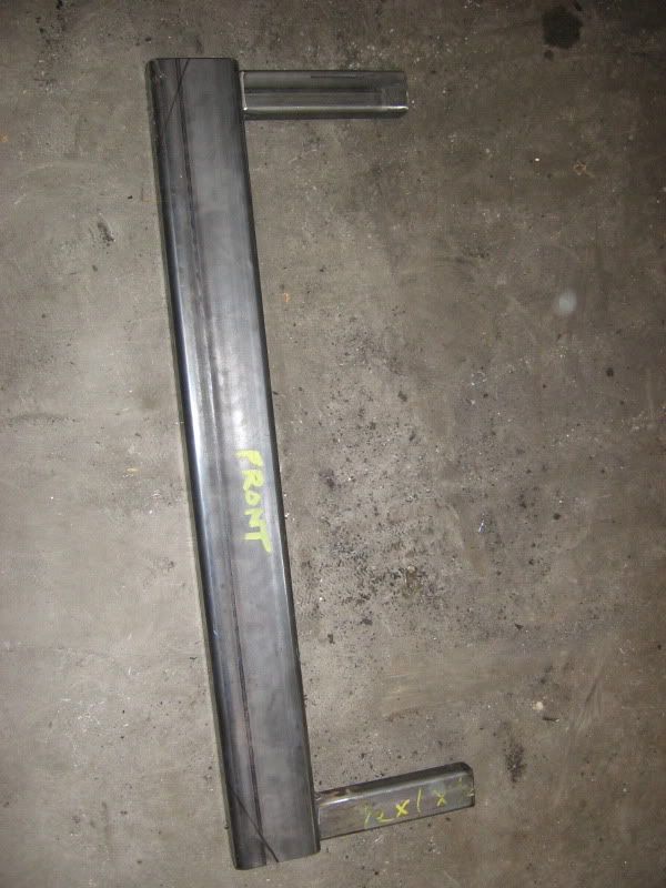

this is the basis for the new one
rad mount tabs
installed and boxed in

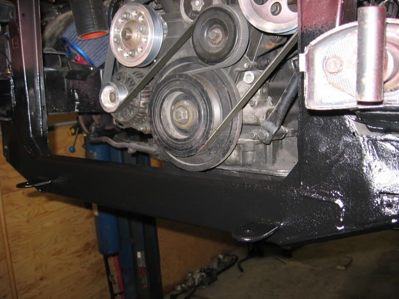

intercooler tabs
all finished

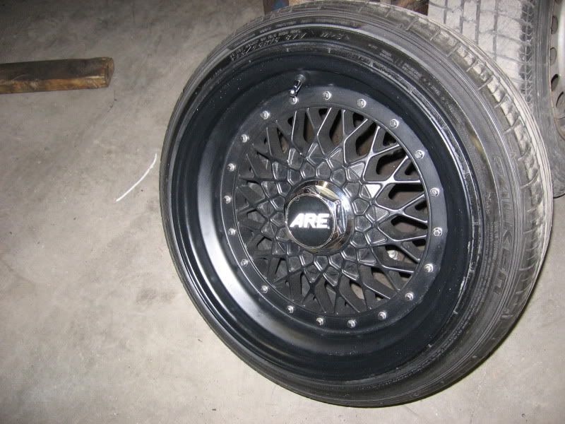

while jeff was doing the fab work, I was bored so i polished the rest of the paint off of my center caps
then this happened
