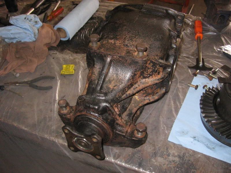

I guess I'll upload some pics. of my diff build.
the pumpkin

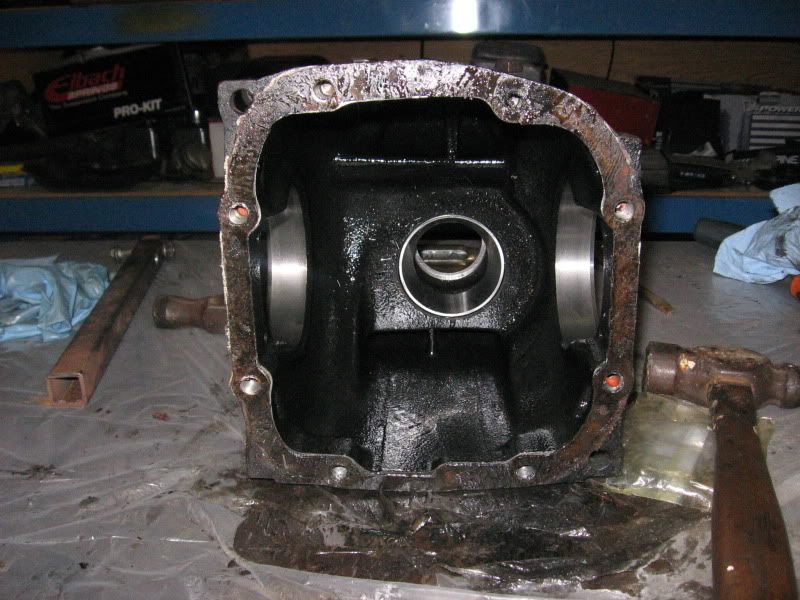

carrier/pinion out
new races in

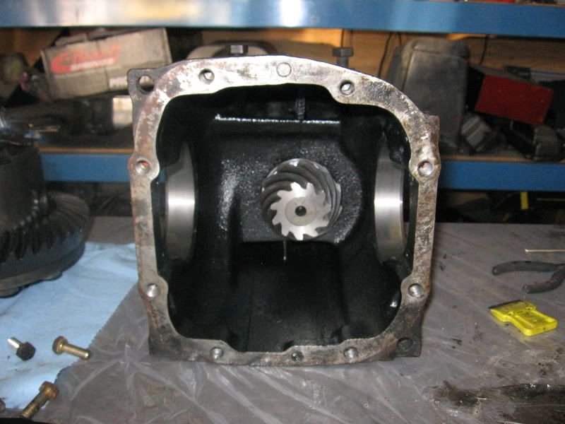

Pinion installed

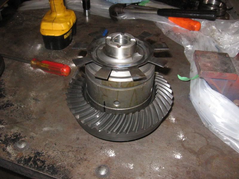

an the new carrier with the graded bolts and washers, and the ring gear and speed ring installed

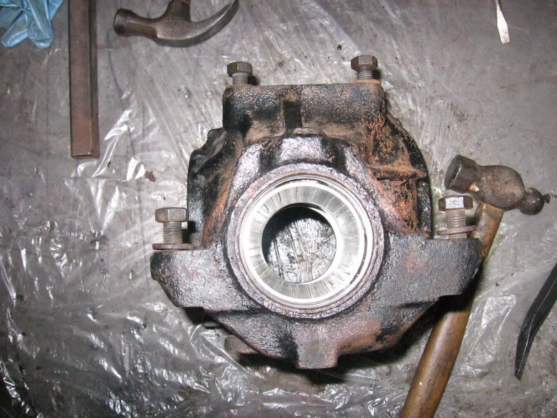

I then pressed on the bearings, took some measurements and had some custom shims made up as the e30 diff shims are no longer available. And the rear end is all together again.
