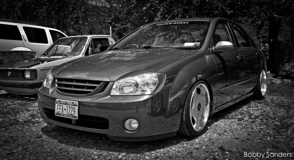

              • Saw the car at SoWo and my jaw dropped. Never thought I'd see a stanced Spectra. I only took one pic, but here's a quick edit of it
                Flickr Photostream | My Build Thread | Stalk me on Instagram, yo!
                • Originally posted by 98z24ragtop View Post
                  Thanks a lot dude. Thanks for the pic!!

                    • No problem! and a quick black and white version too
