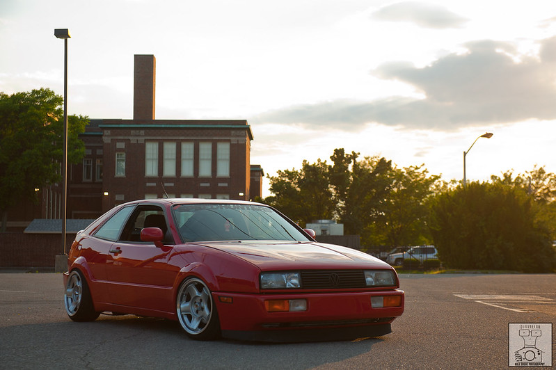

Went out yesterday and shot a few photos of the corrado. I planned on taking more but I left this location and the starter solenoid throught suicide was a the best way out and the starter motor was spinning constantly as I was driving. Got the car home and got the battery disconnected once I figured the problem out. Luckly I have a warranty on the starter so I'll just pull it and have another one ordered.
love it, new wheel look 100 times better. cant help but think that front lip doesnt jive with the rest of the car. i think i smaller one, would make the car look a lot cleaner.
i think you just missing sideskirts and that's what throwing you off
Sadly they never cam from factory with any type of side skirt (USDM or EDM). I can do an ABT rep skirts (textured or paint matched) but they really not make the sides look that much lower. I may pick a set up a textured set at some point
I have been thinking about swapping the stock g60 lip back on and see if I like the look since the car is much lower now than it was last year when it was on for a day.

Thanks man!
I did have a set in the same specs on red just with flat caps (which I'm ordering for this set soon). In all reality the corrado has become Red 2.
All the plans I had for Red just went into this car.
Yeah the more you spin it down the closer it gets to the cv boot. right now mine are about as far down as they can go before they will hit the cv boot. I'm hopeing to switch to Broadway's soon and have the shortest body possible so I dont have to worry about hitting the boots as much.
In other new new starter will be here today. I'll get that swapped in and swap out the front lips just to see if I like the look of the US lip instead of the huge 90mm lip. (May switch to a spoonfed 70mm lip, best of both worlds)
