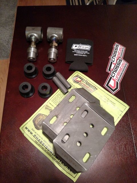

So due to the lack of space to run a typical 4 link setup in the rear and my unwillingness to carve up the Stude, I've been designing a parallel 2 link system with maybe a pan hard bar(if it needs it) that consists of poly bushings at the original front leaf spring mount with a section of tube running to a plate with holes for u bolts welded to a wristed tapered bearing spindle that runs perpendicular to the axle tube.
Wait what the hell am I talking about, it might sound confusing but it's really no different than those pivoting leaf spring mounts 4x4 guys use to gain articulation.

I have all the parts ordered so just waiting until they arrive.
