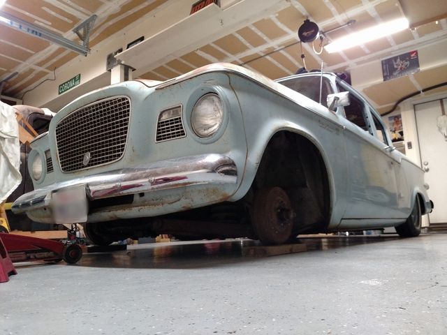

    This is my build of a 1960 Studebaker Lark I picked it up maybe a month ago and have been cleaning and freshening up some areas that needed attention.
    The overall plan of the build is bags, interior, wheels, and a little bit of paint here and there but keeping the original exterior patina.
    It runs well so I'm keeping the original flathead inline 6 but going to build a split header and probably 2bl manifold for it. Not doing a full teardown because it really doesn't need it.
    The day i brought her home...

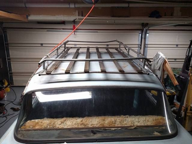

    Second thing I did was pick up this rack off craigslist and slap it on there

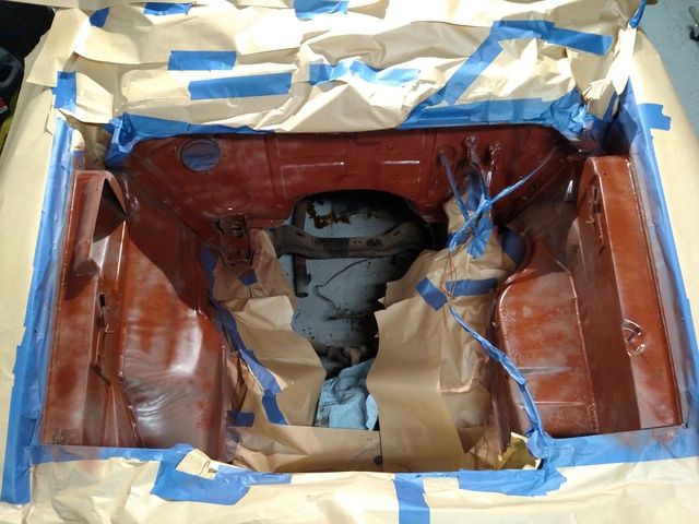

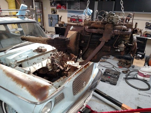

    Then I pulled the motor and trans to begin cleaning them up along with the engine bay.

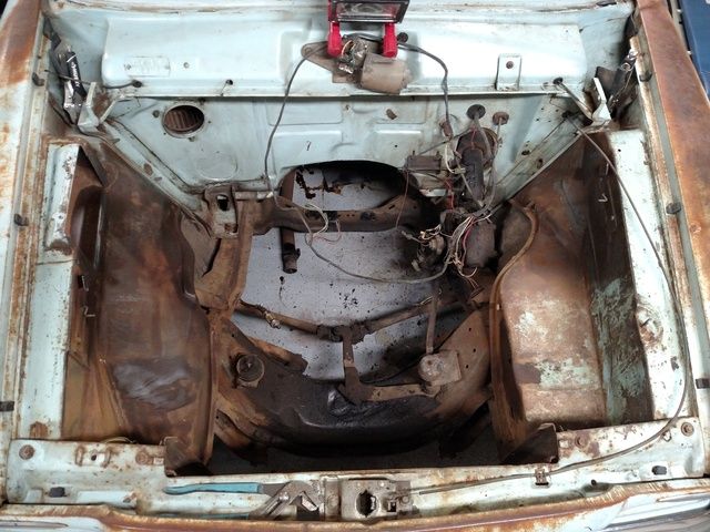

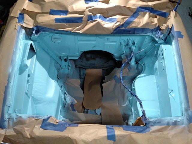

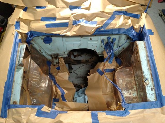

    Taped it off and began sanding, then primer, and finally color

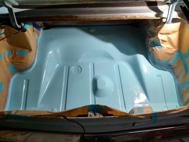

    I also cleaned and painted the trunk floor, there was a lot of oil soaked rust which took some effort to clean but came out nicely.

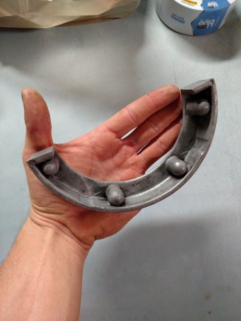

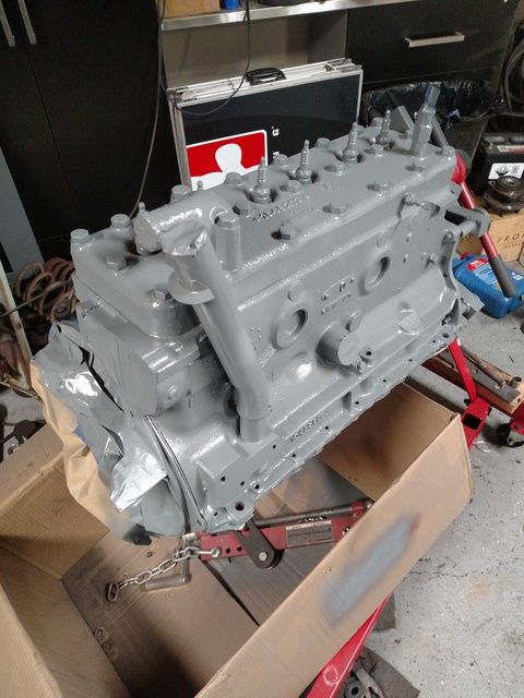

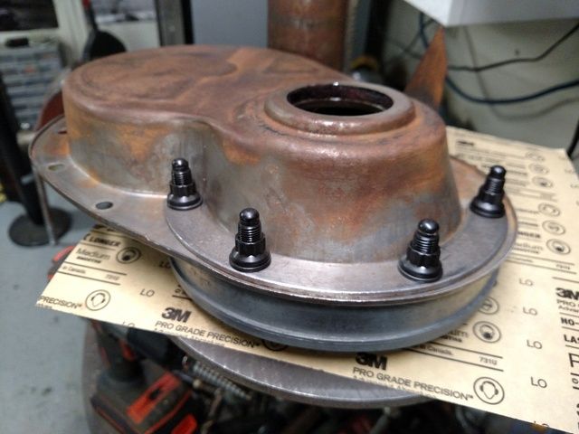

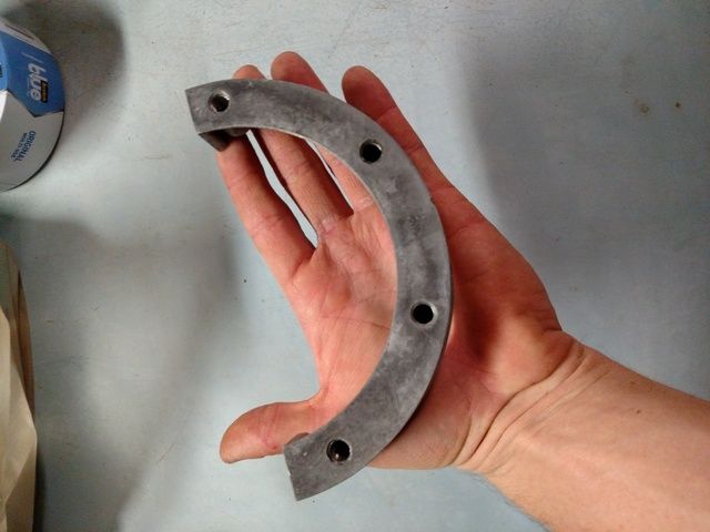

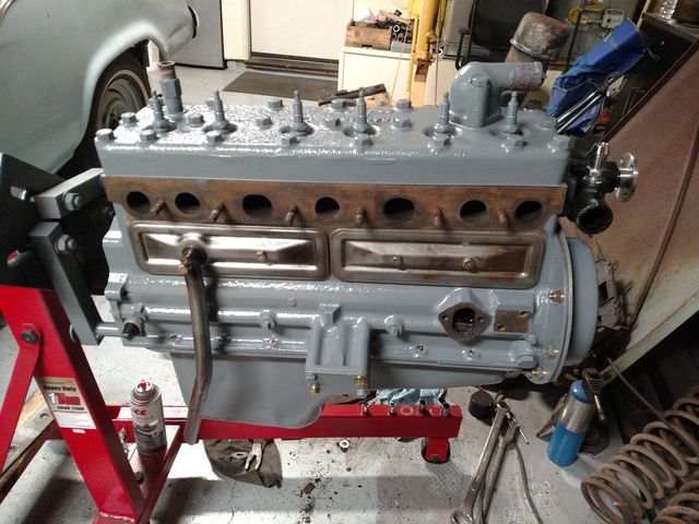

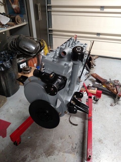

    In addition to cleaning the motor up I installed a bunch of new gaskets and had to repair a piece that had stripped threads.
    This part forms a seal between the timing cover and the oil pan but all four threads were stripped so I drilled and tapped them to 3/8-16 and installed four ARP studs from a small block chevy header kit.
    Then after getting it all back together and cleaned up I painted it with some machine gray enamel and swapped most of the hardware with zinc plated grade 8 stuff.

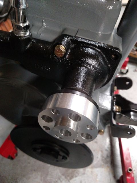

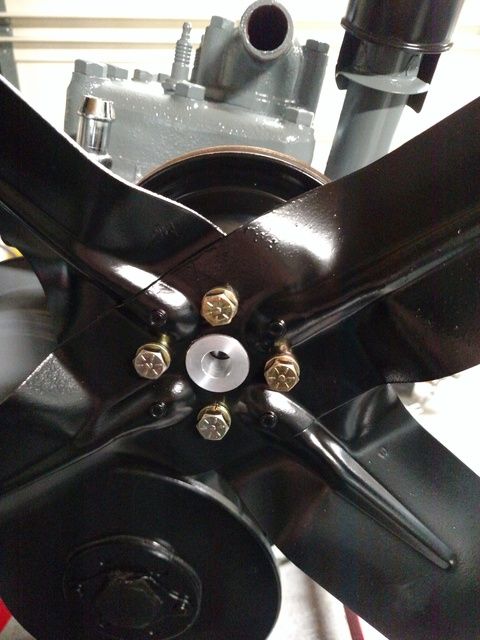

    I also had to machine a fan spacer because I ordered the wrong water pump which was too short.
